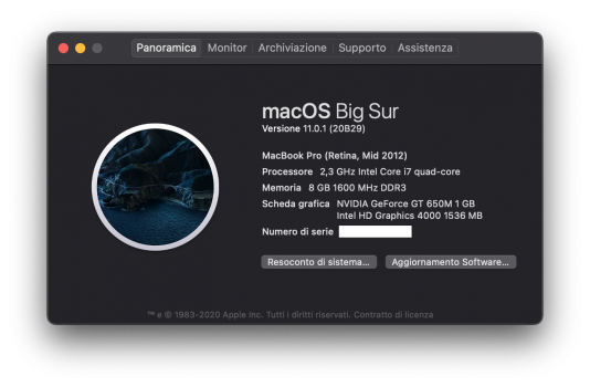

Yesterday I've performed the BS installation on my MBP 15" Retina OG, all works fine! Got an upgraded BT/WiFi card, so: wifi, handoff, Watch unlock and everything works great!
Only issue (known, as it was reported in the micropatcher readme): discrete GPU is active all the time (as you can see in the screenshot) and battery drains fast due to that.
Thanks to barrykn and all the people involved in the developing!
