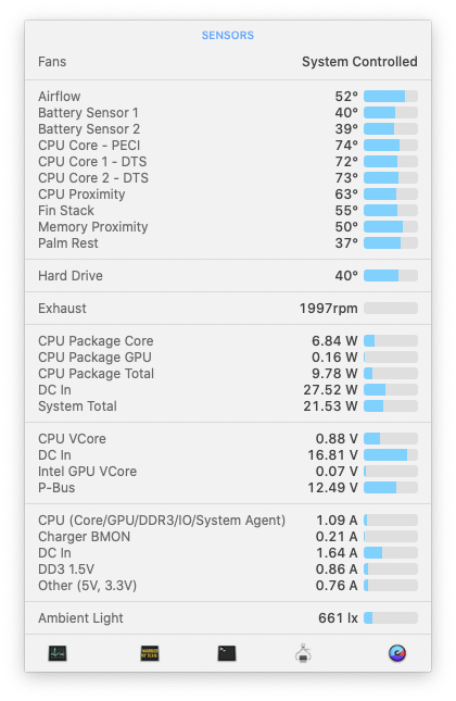

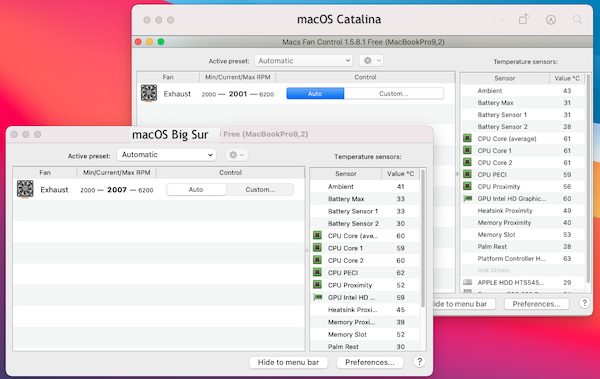

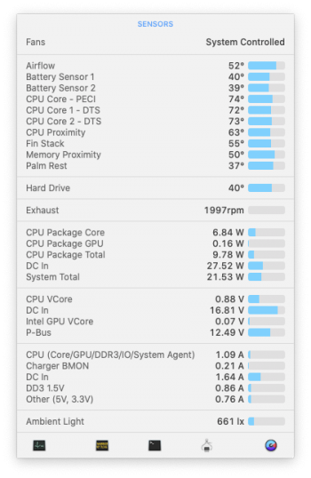

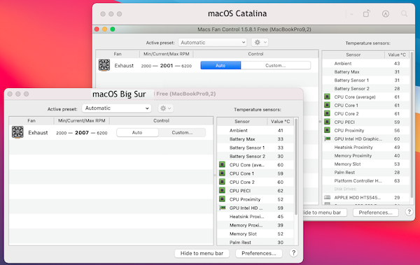

For MBP mid-2012, they have found temperature changes between Catalina and Big Sur?
(it has been mentioned in the thread, problems since BS b1)
I have applied the jackluke instruction, the keyboard does not heat up quickly anymore.
wi-fi... and smc??
I'm still on Catalina. I'm just browsing... nothing more or apps in. the background.
