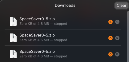

Is anyone else having trouble with video playback in the TV app? On streamed videos It will play a second or 2 of the video and then just drop back to the main app screen. For downloaded videos in my library it is audio only and black screen. This is on a 2011 IMac with an 860M video card. Everything else seems to work fine including youtube videos.
Reactions: TimothyR734
Just downloaded it again. Works fine
Not here...

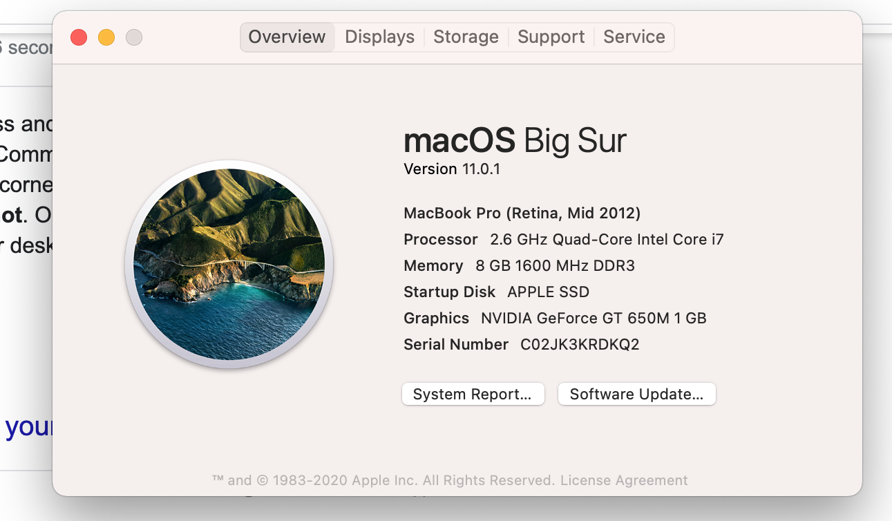

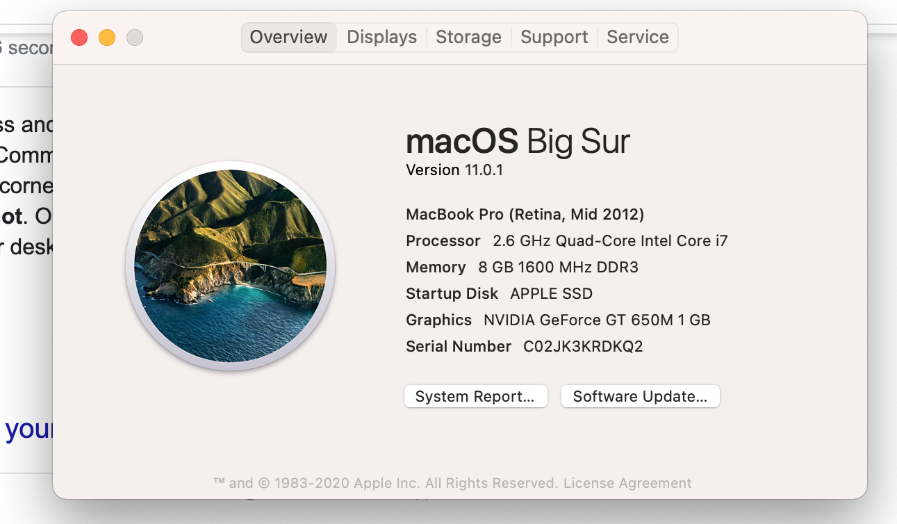

A tip (if you're interested)
Your about this mac page shows that you are running the Nvidia card, as was mine. It seems it's stuck on that card but there is a workaround from post 3255 in this thread by member @ribero (thanks to him)
If you run the following in a terminal
Code:
sudo launchctl stop com.apple.displaypolicyd
it will revert to the Intel graphics and graphics switching is restored :)
However you'll have to run that command after every reboot.
If you ever want to reverse this then the command is
Code:
sudo launchctl start com.apple.displaypolicyd
And mine :) 👍
Code:
Code:

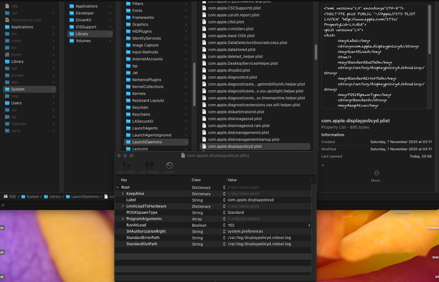

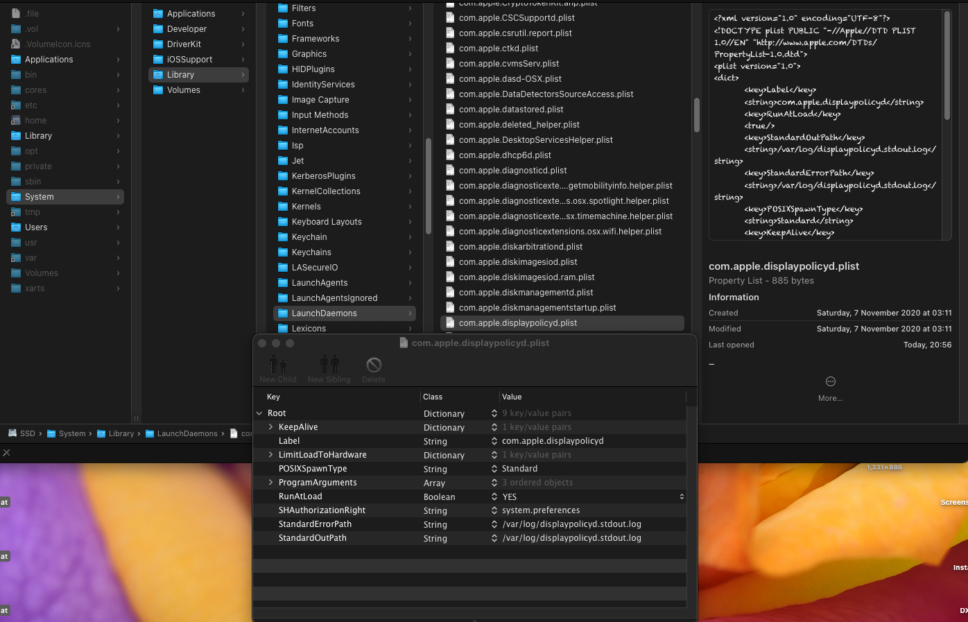

See this...
Guess what, you can edit the plist file so that it doesn't run at load.

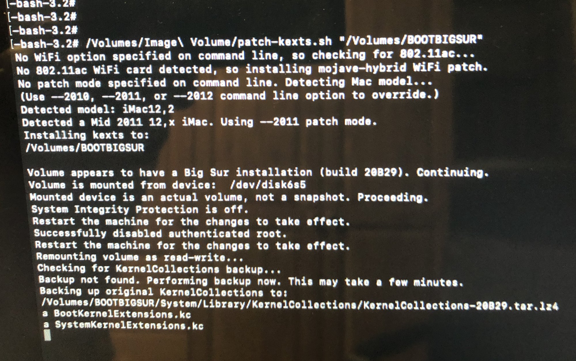

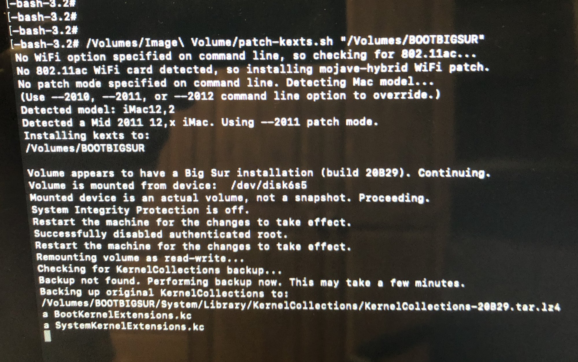

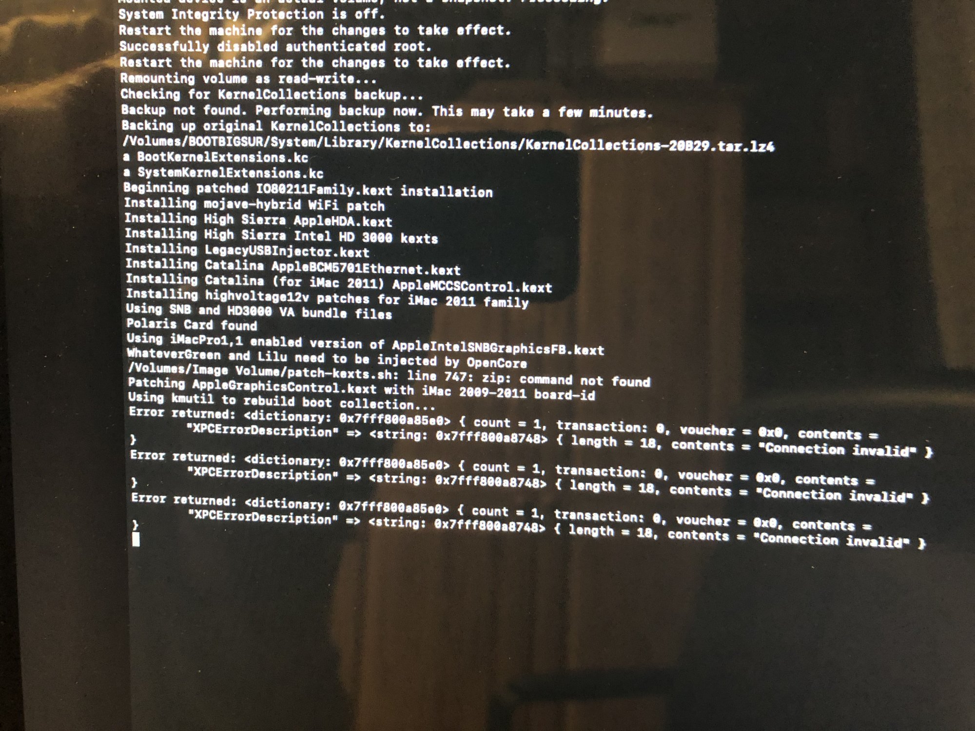

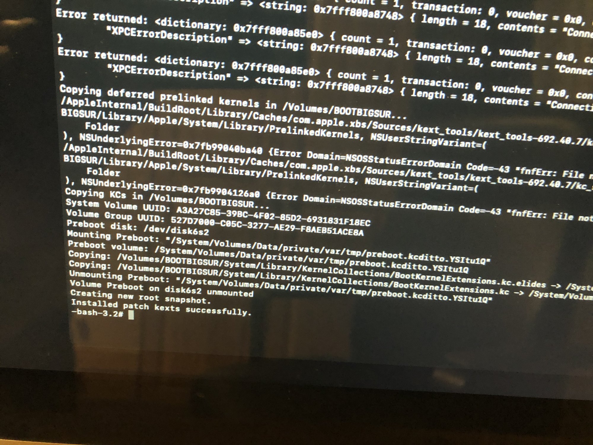

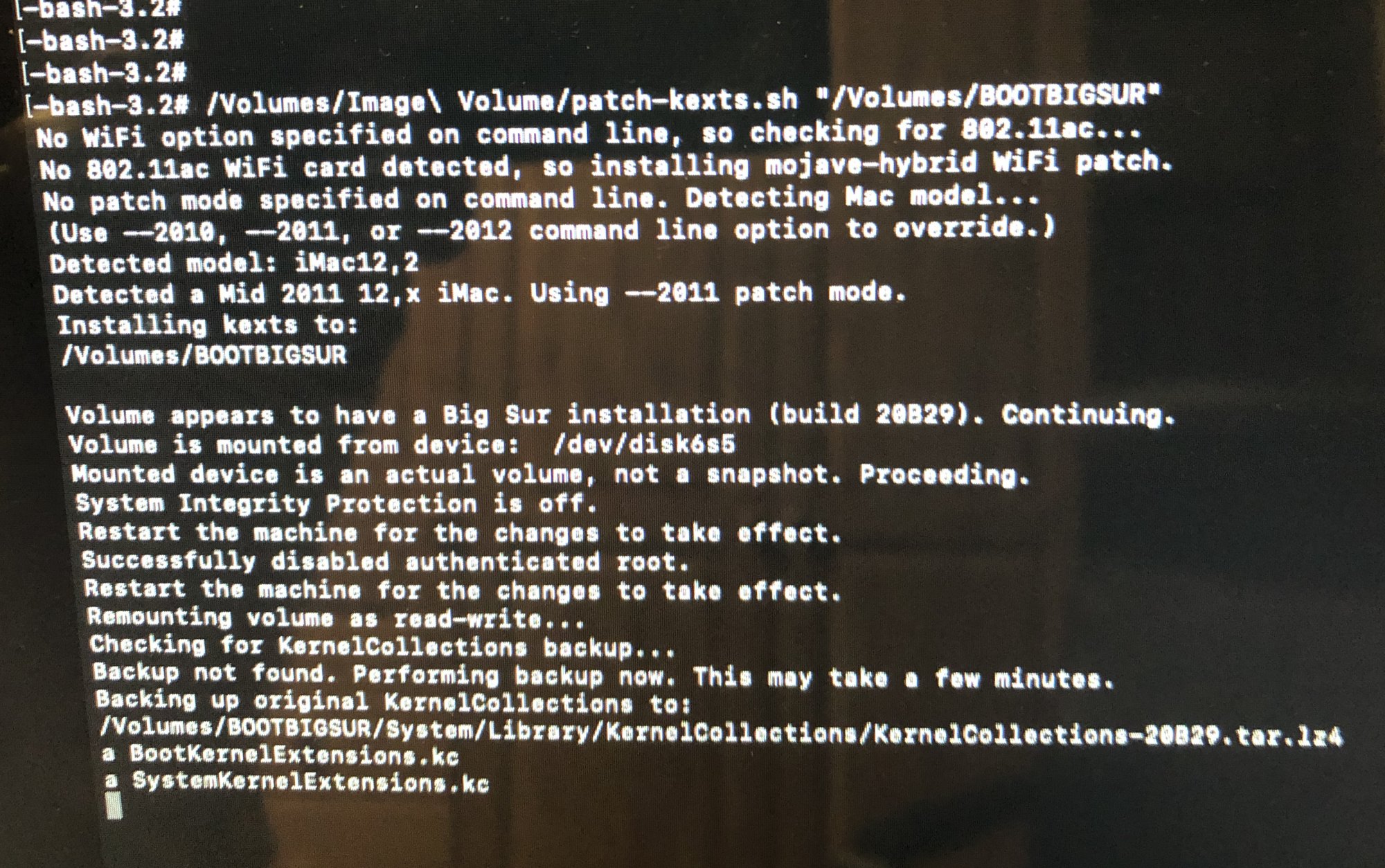

Hi!
This is not the correct way to use the micro patcher as of version 0.5.1 with a GPU modded iMac 2011. Please start the patch-kext.sh -u again to get into the original state and reboot. You can do this from the Terminal app while booted into Big Sur.
Then redo patching without the --2010. There is a auto detection of your model and the GPU and you would get all the necessary patches needed for this particular model. You can do this from the Terminal app while booted into Big Sur, too!

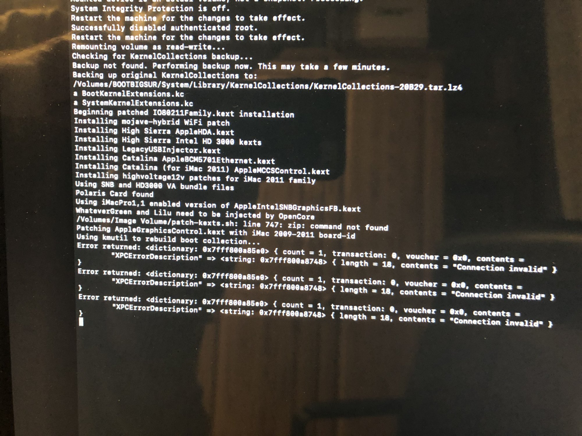

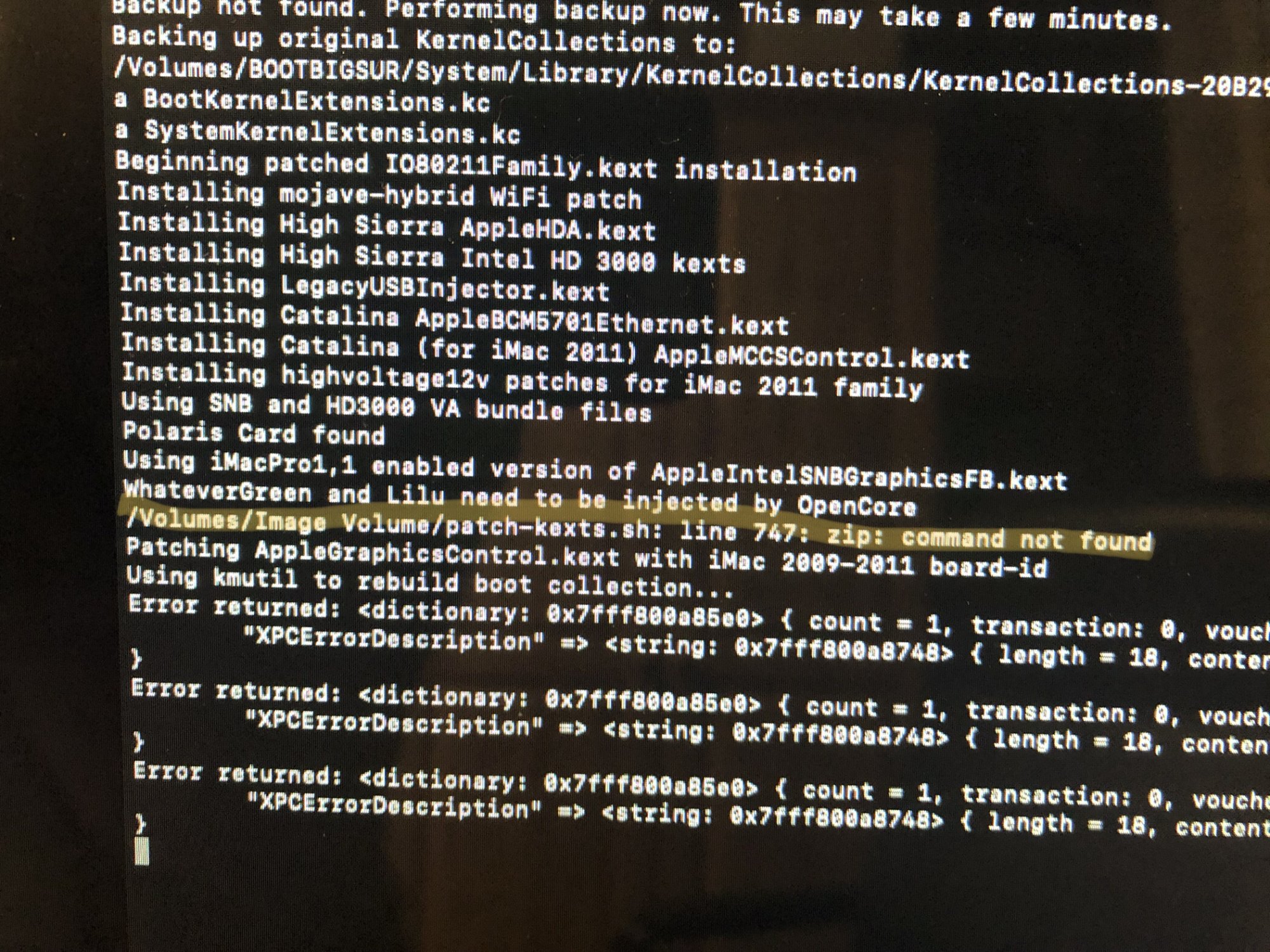

@Ausdauersportler :
to be sure to have a good system, I reinstall everything. I erased the target disk and even recreated the USB key.
but I have an error in the script patch-kexts.sh :(
Code:
[...] /patch-kexts.sh: line 747: zip: Command not found
it's the line:
Code:
zip -q -r -X AppleGraphicsControl.kext.zip AppleGraphicsControl.kext
Here is the beginning and the end of the shell script for information:
and some others errors:
Thank for your help

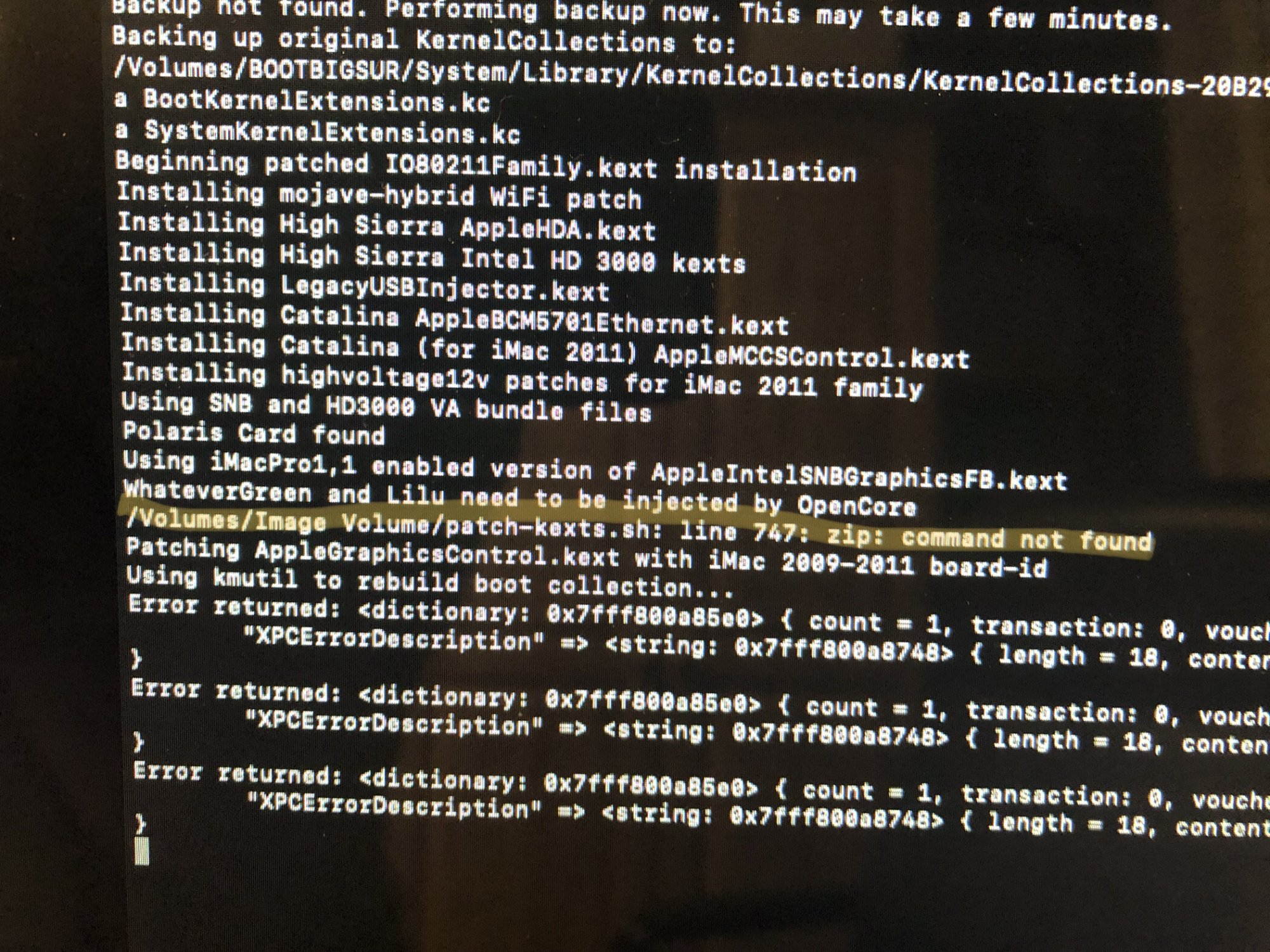

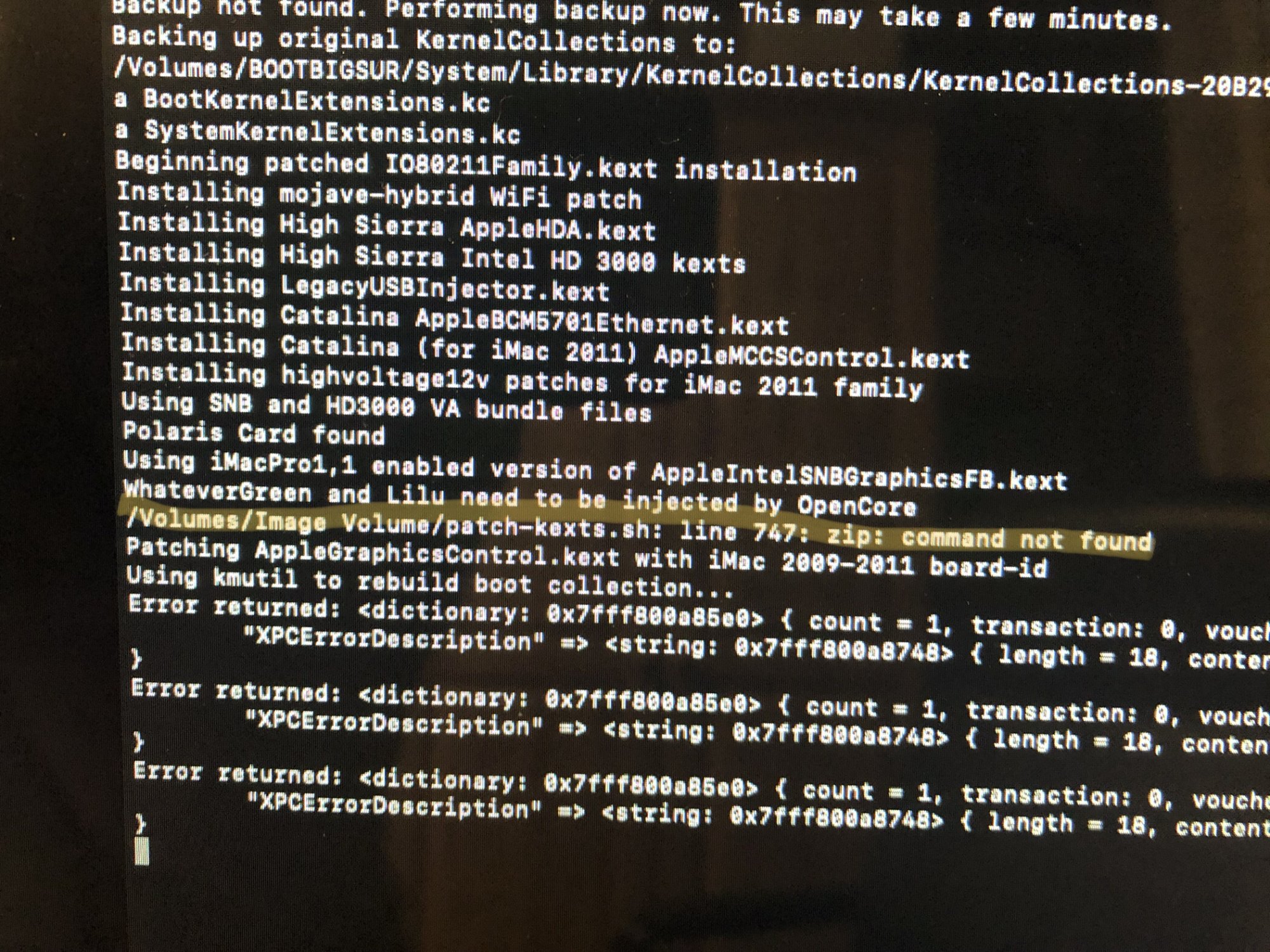

@Ausdauersportler :
Code:
it's the line:
Code:
Thank for your help
This was no clean install. For some reason you already patched and unpatched and deleted somehow (patcher bug) the AppleGraphicsControl.kext. The script tried to recover from the archive which failed because there was no archive any longer.
Please do a fresh installation and let the script run only once.
If you want to patch several times please just undo patching by patch-kext.sh -u.
And use the script I attached here. It has some error fixes...
In case you miss your AGC take this.
Ignore the other errors...I have seen them since Beta 3.
P.S.: Version 0.5.2 will fix these errors...

I'm also getting the same error reports from kmutil when executing patch-kexts.sh. They seem not to harm, the resulting system is always fine in my case.
However :
- I delete the patched install USB key
- I recreate the patched install USB key
- I delete the disk use to receive Big Sur installation
anyway, I will try tomorrow with your new file 👍
Thank, i try tomorrow and I will post the result
best regards :)
