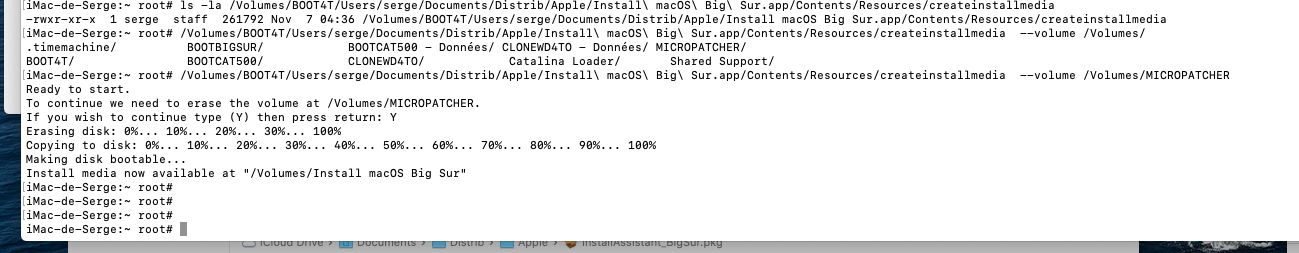

2) You must create a USB key with the image and the patches (adapt the commands with your own directory names).
- image creation:
Code:
/Volumes/BOOT4T/Users/serge/Documents/Distrib/Apple/Install \ macOS \ Big \ Sur.app/Contents/Resources/createinstallmedia --volume /Volumes/name_de_la_clef_USB

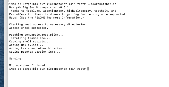

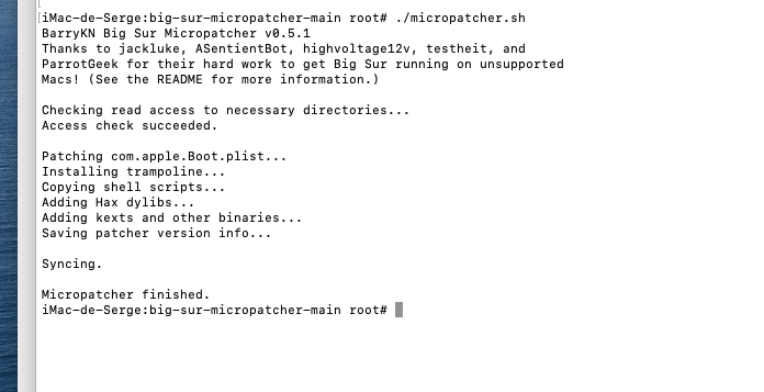

- run the first patch command:
Code:
./micropatcher.sh

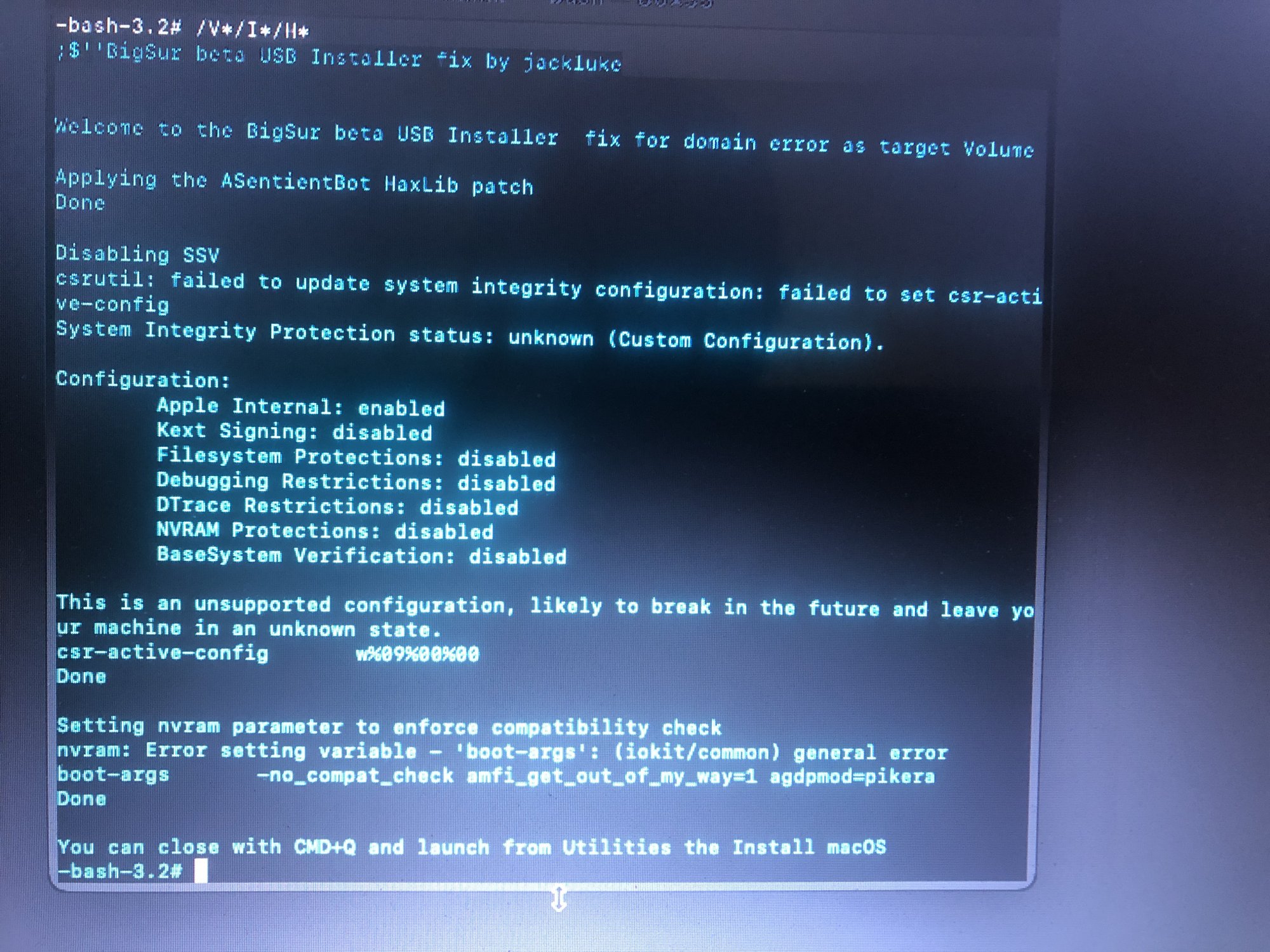

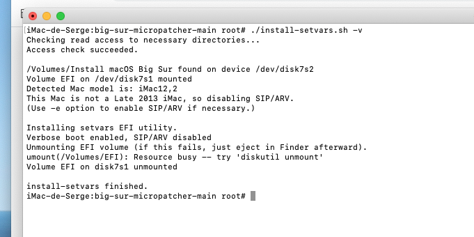

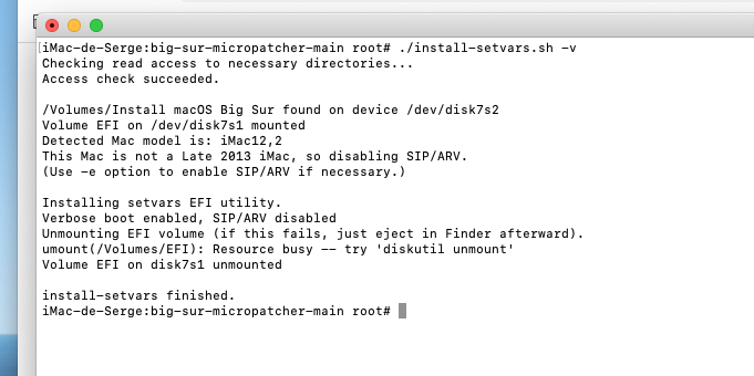

- then launch the command:
Code:
./install-setvars.sh

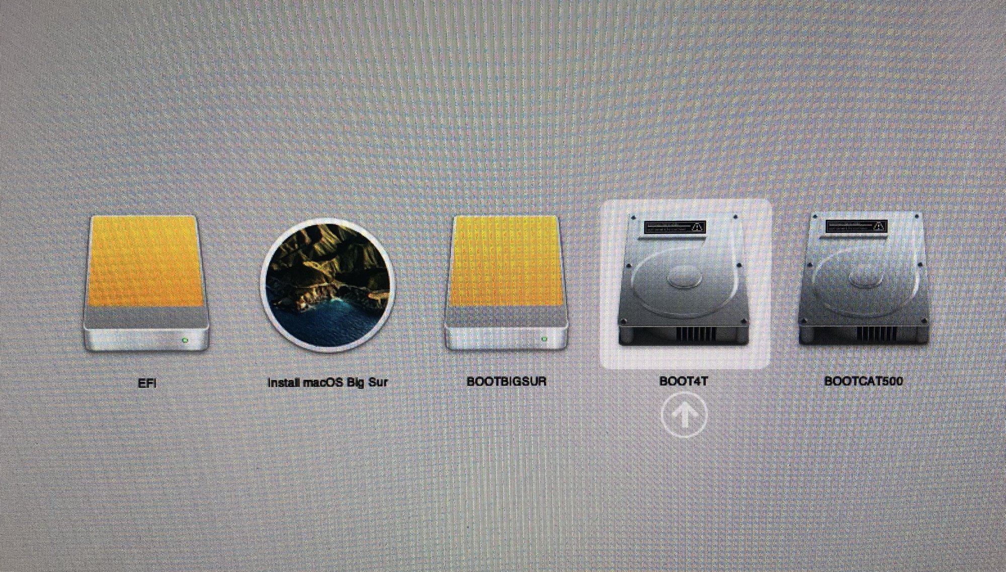

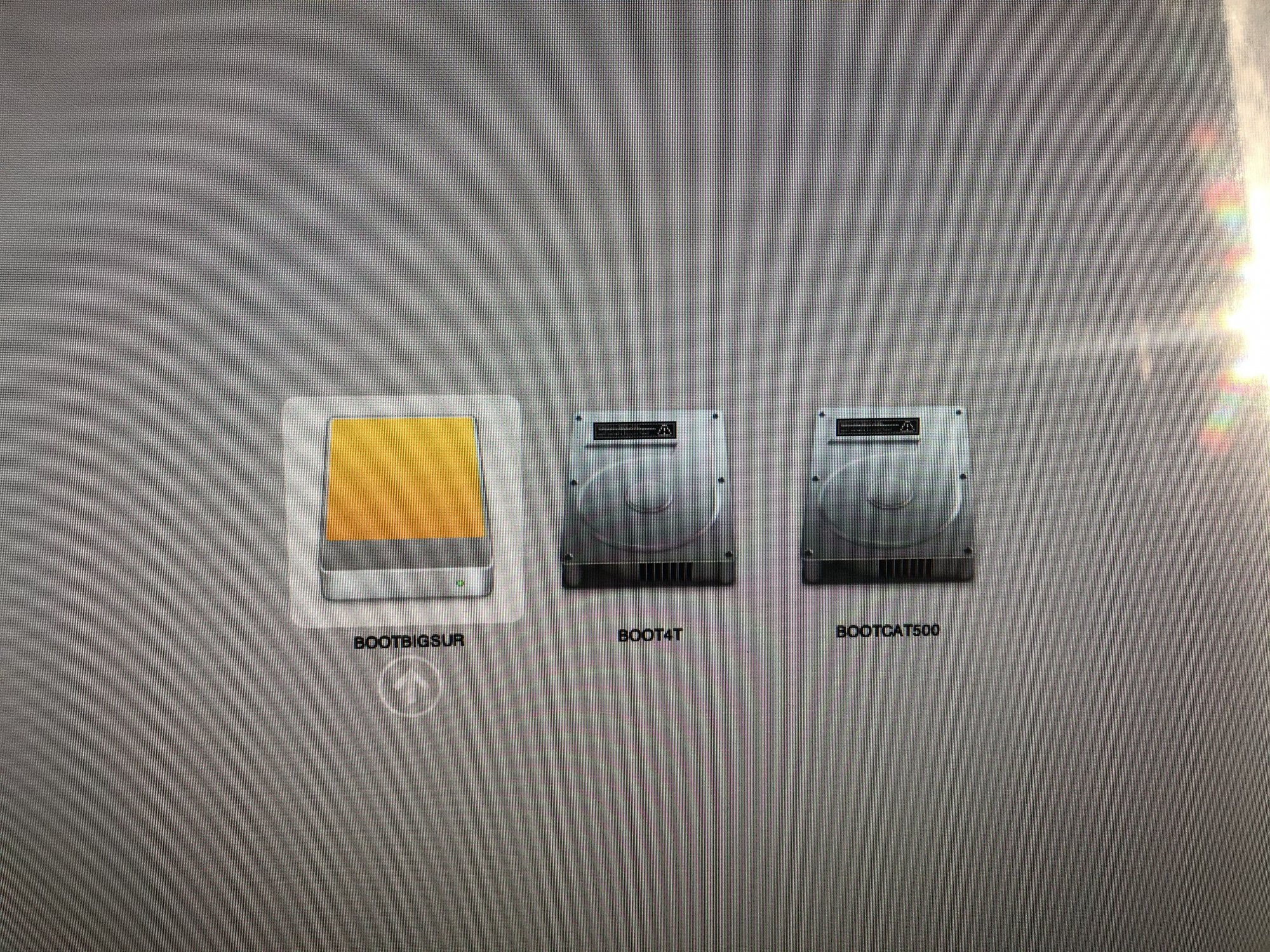

3) You must use the "Catalina Loader OC 0.6.3" (see here) with plist for my Dell WX4130 card, beware version 0.6.2 did not work on my iMac.

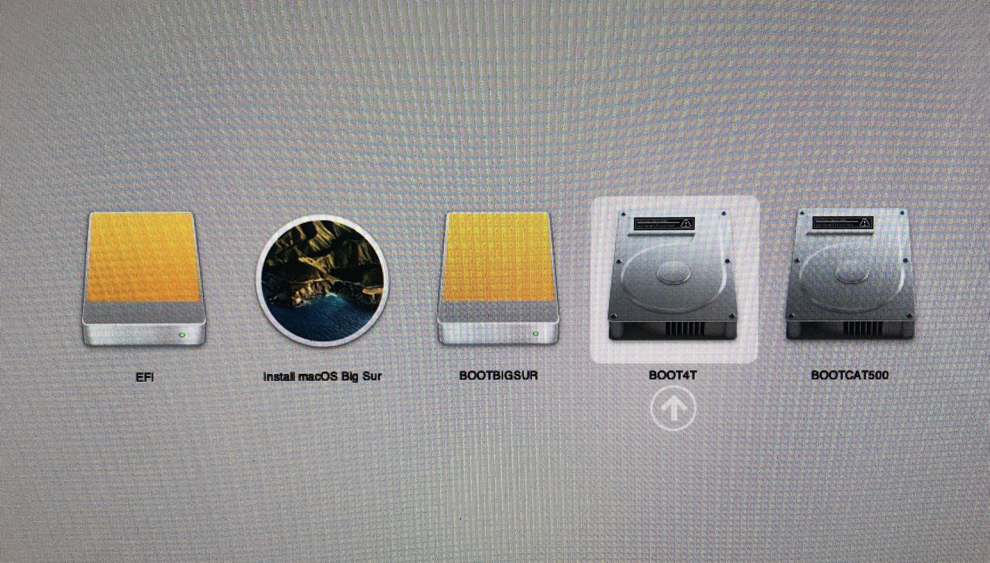

4) Reboot on the key, you should see your usual internal drives and 2 other choices: "EFI" and "install macOS Big Sur"

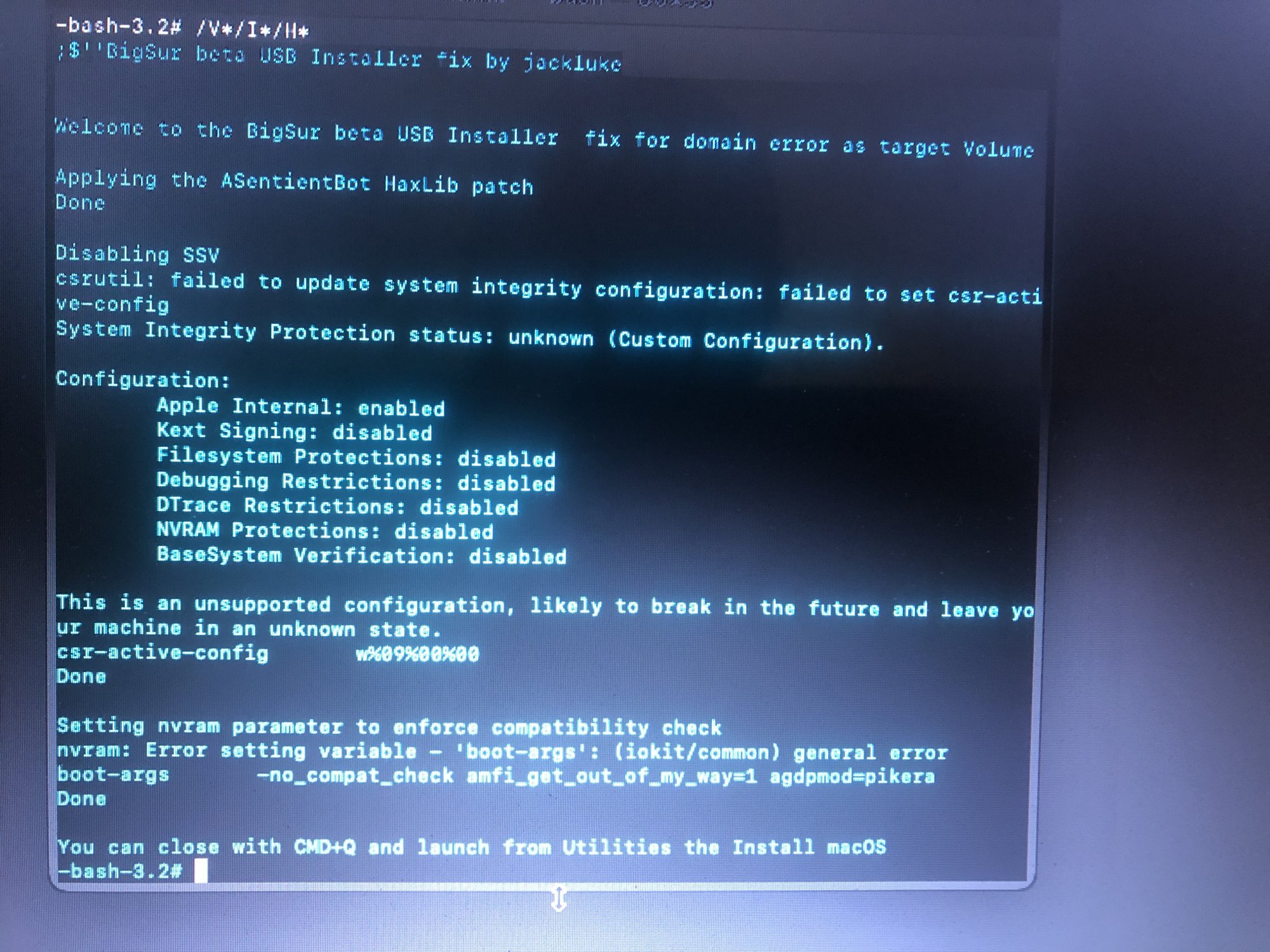

5) You must choose a first boot on "EFI", at this time; the iMac shuts down almost instantly, this is normal.

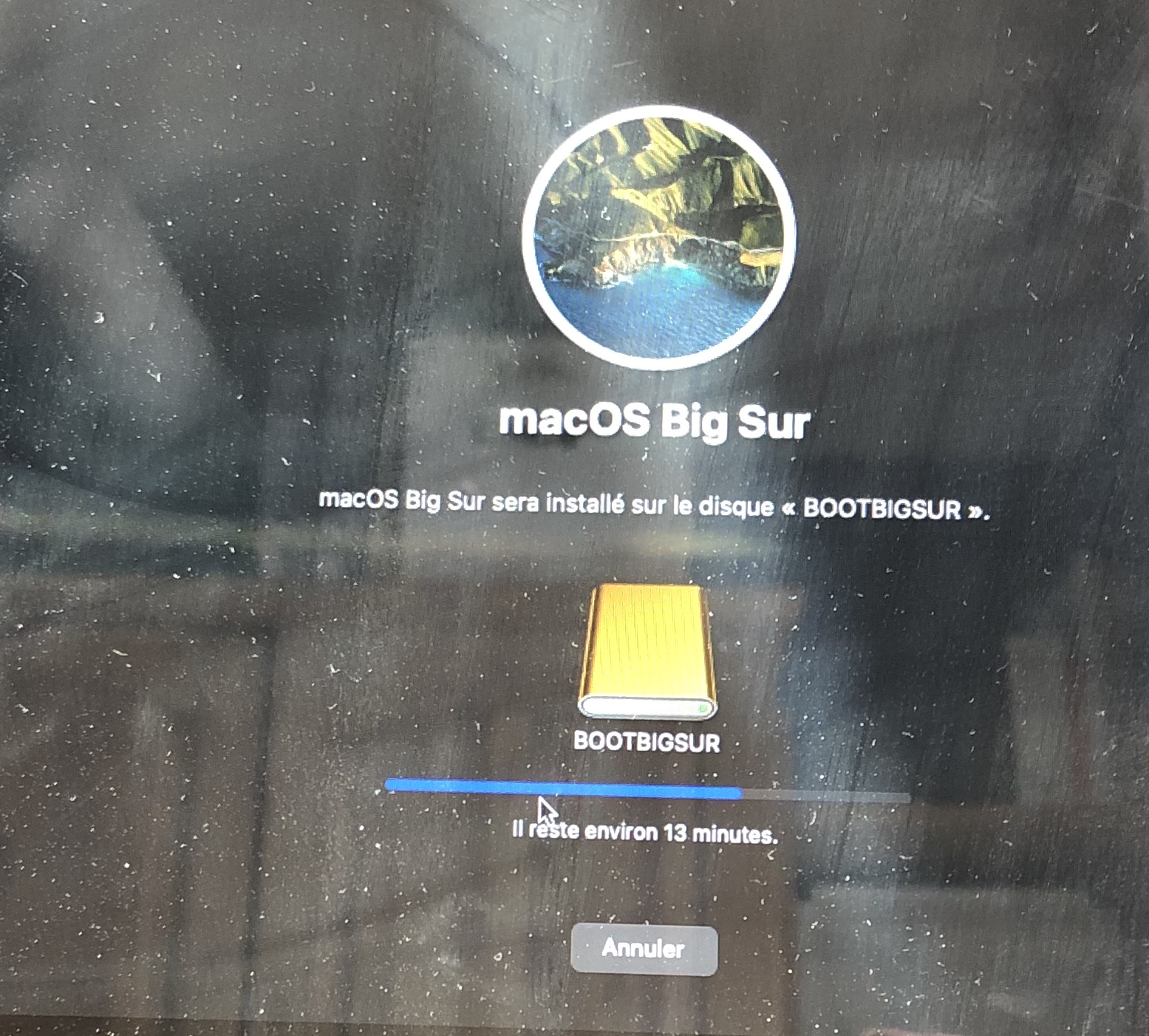

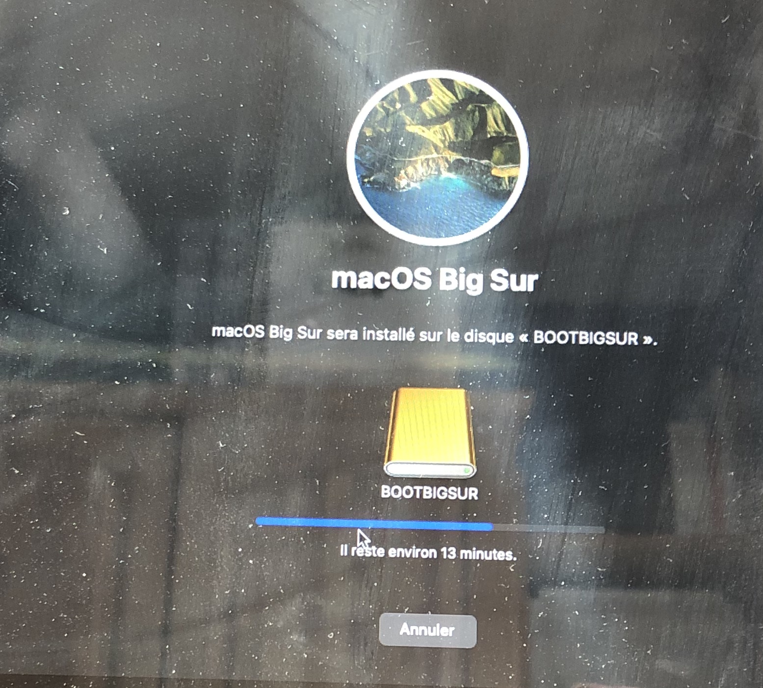

6) Restart and choose this time "install macOS Big Sur", you must then have the classic screen of an installation:
If you do not have the installation screen, but the no-entry sign, the micropatcher documentation indicates that you have to redo point 5 several times.
I had formatted the disk in APFS but strangely the selection of this disk was not possible, the installer asked for a disk in "Mac OS Extended (Journaled)" !!!!! So I had to stop the installation and reformat the USB drive to "Mac OS Extended (Journaled)". Of course, during the next installation this disk will be converted to APFS.
The installation takes quite a long time, around 2 hours, with several reboots.

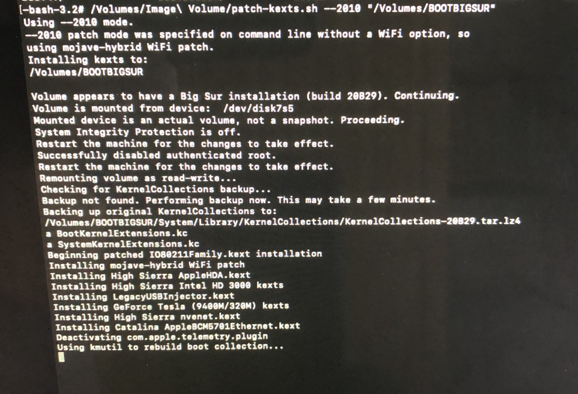

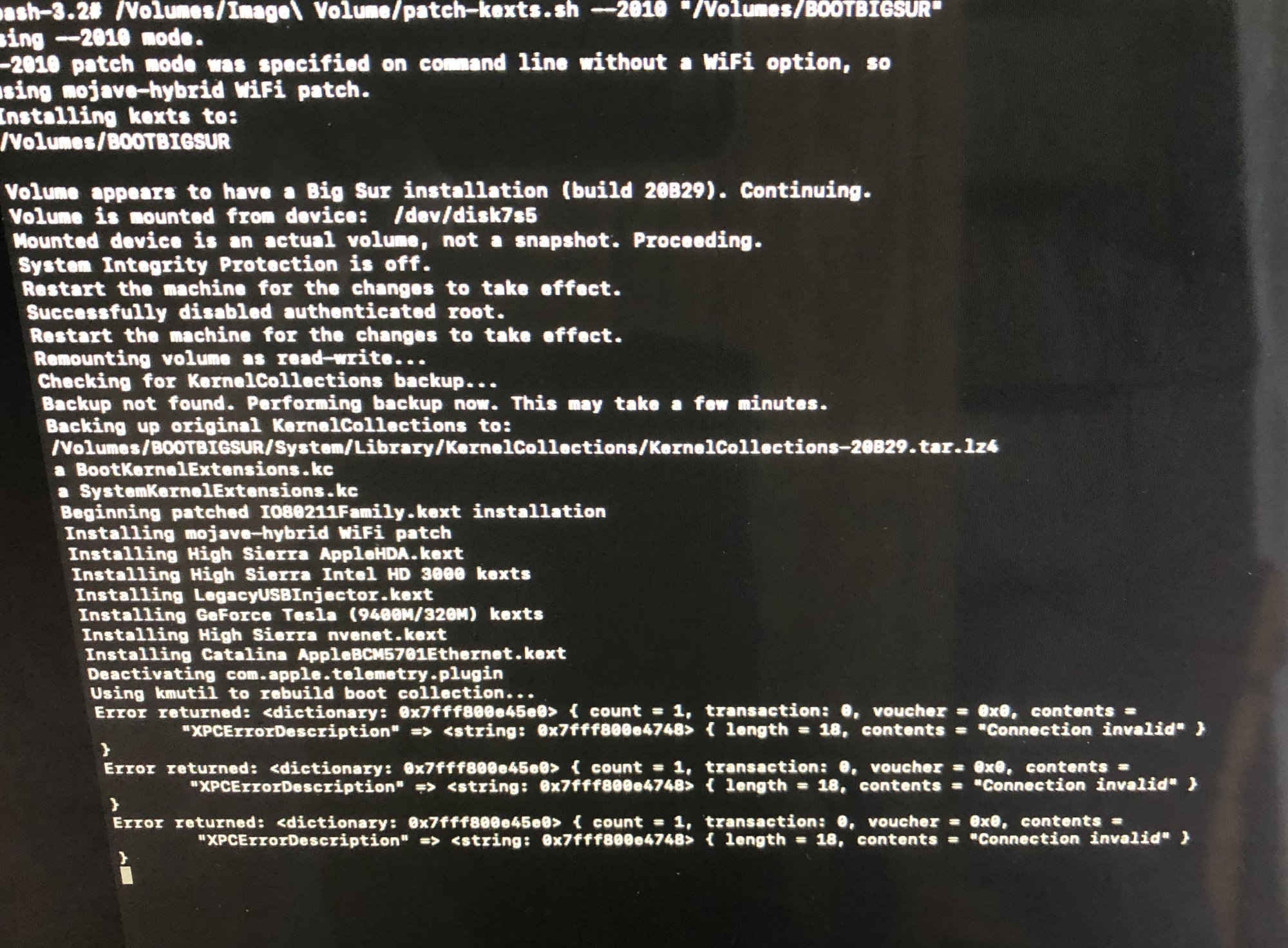

7) After a while, you will see a classic configuration screen appear (language, CGU, etc.). After answering these questions, there is still a patch to launch (Ethernet and WIFI are not available elsewhere before this last patch). You must therefore restart on the micropatcher key and then launch a terminal to launch the last patch command which will install kernel extensions:

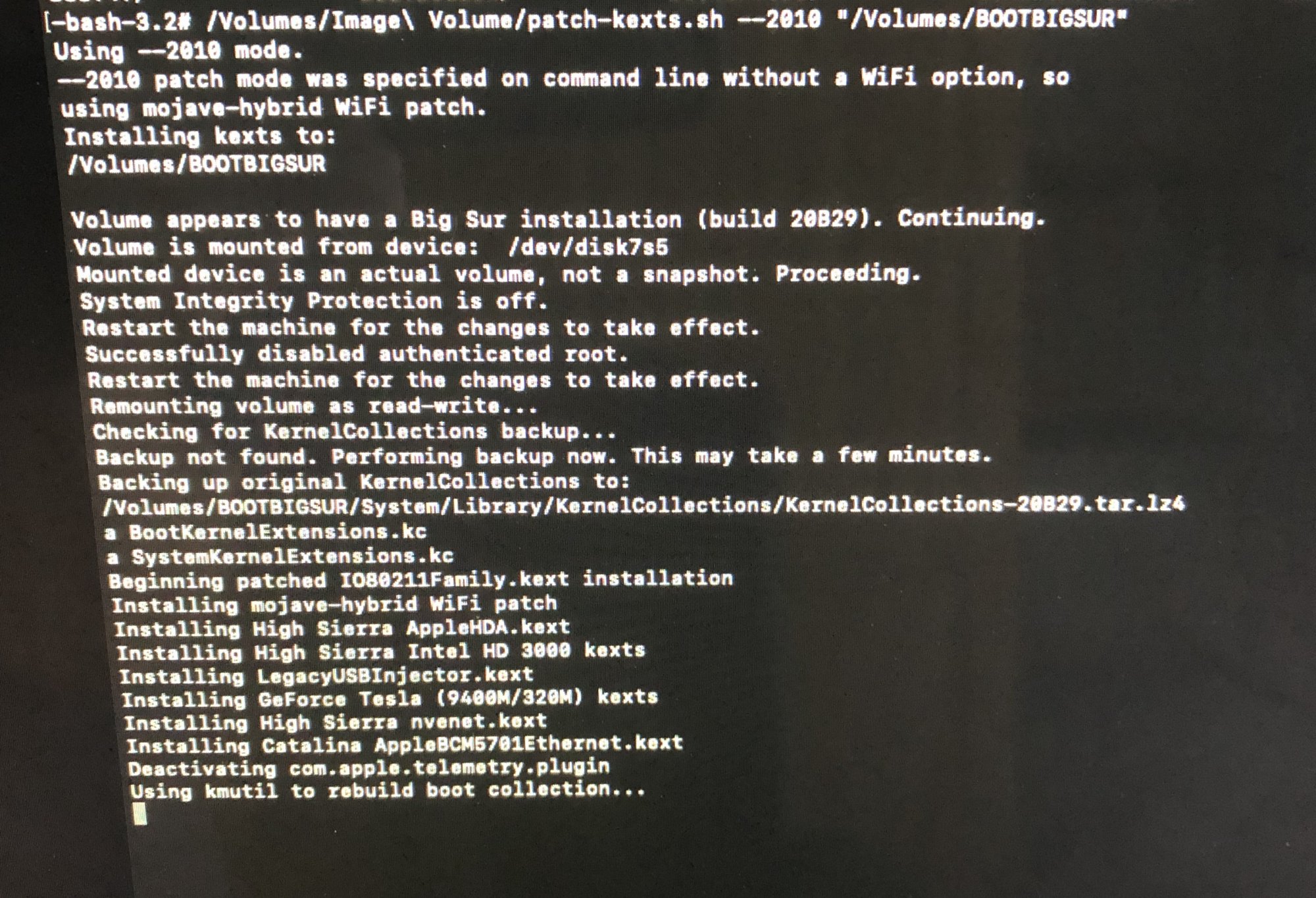

Code:
patch-kexts.sh --2010 "/Volumes/name_of_your_big_disk_on
EDIT 18 november : I make a error , no --2010, the right code is:
Code:
patch-kexts.sh "/Volumes/name_of_your_big_disk_on

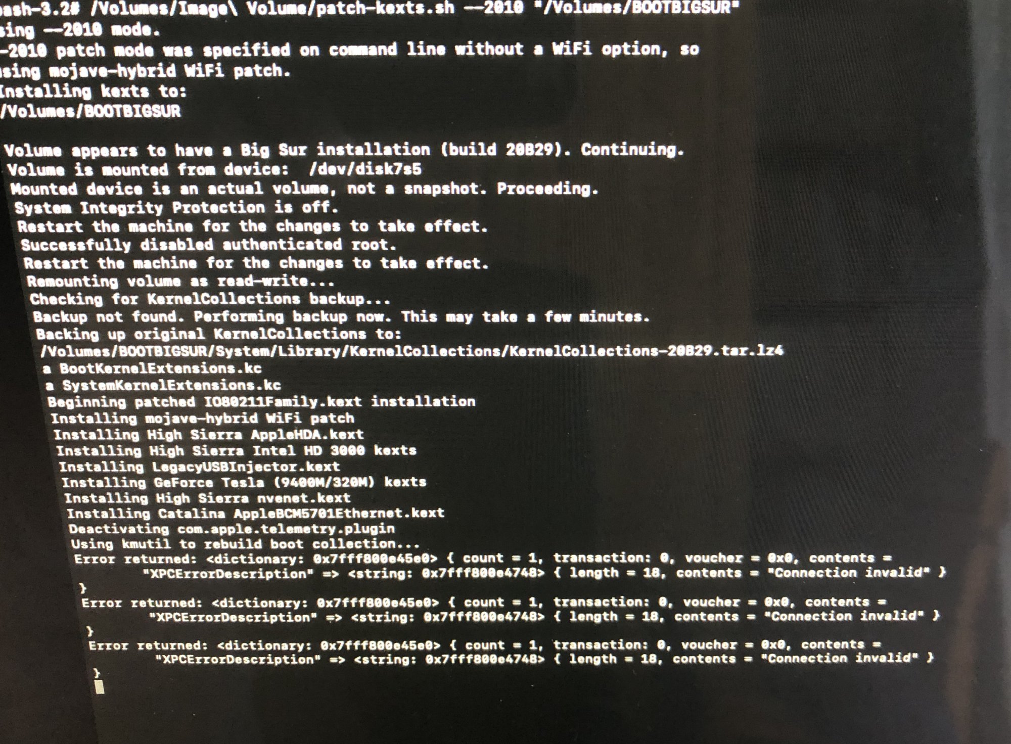

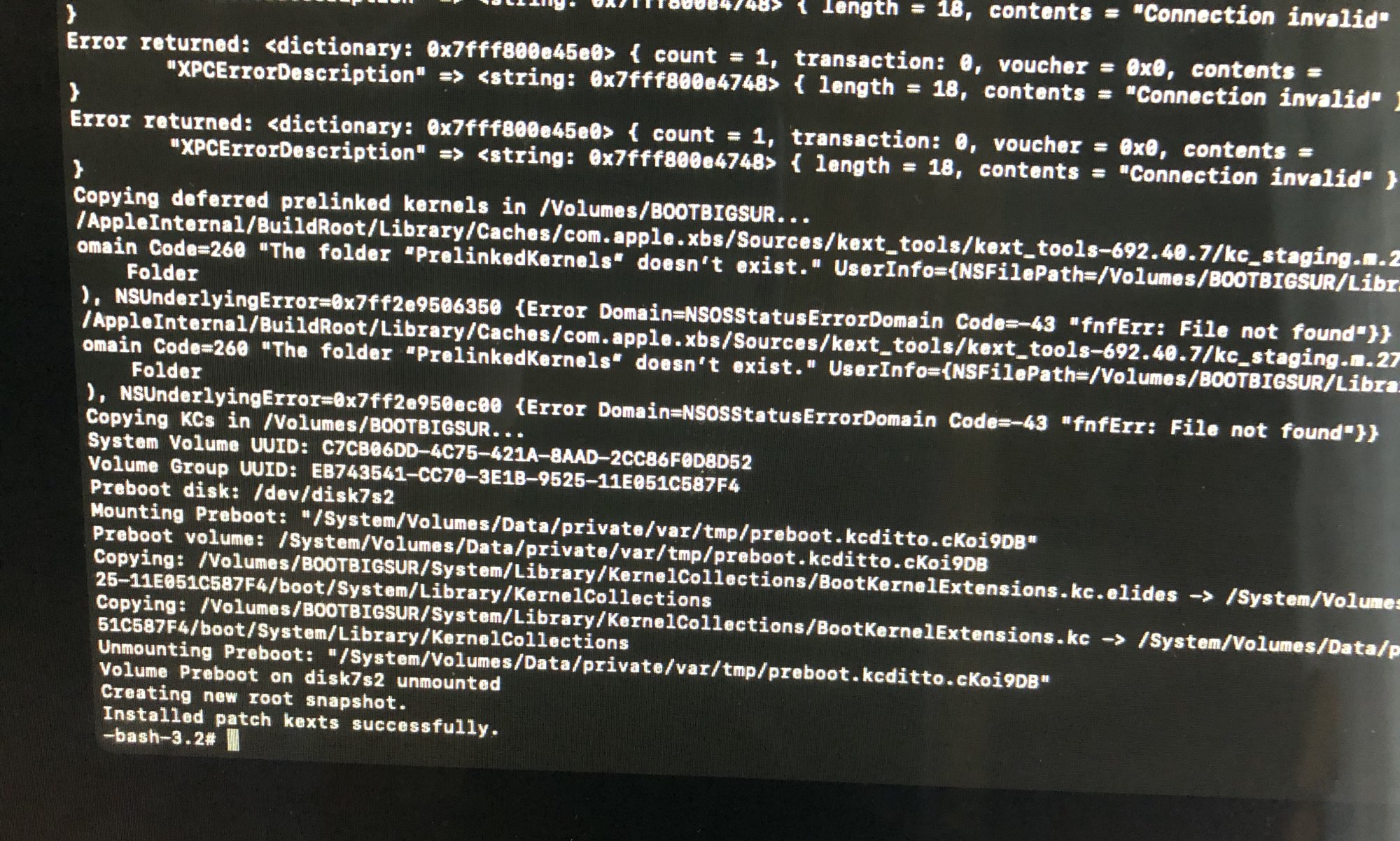

There is a auto detection of your model and the GPU and you would get all the necessary patches needed for this particular model.

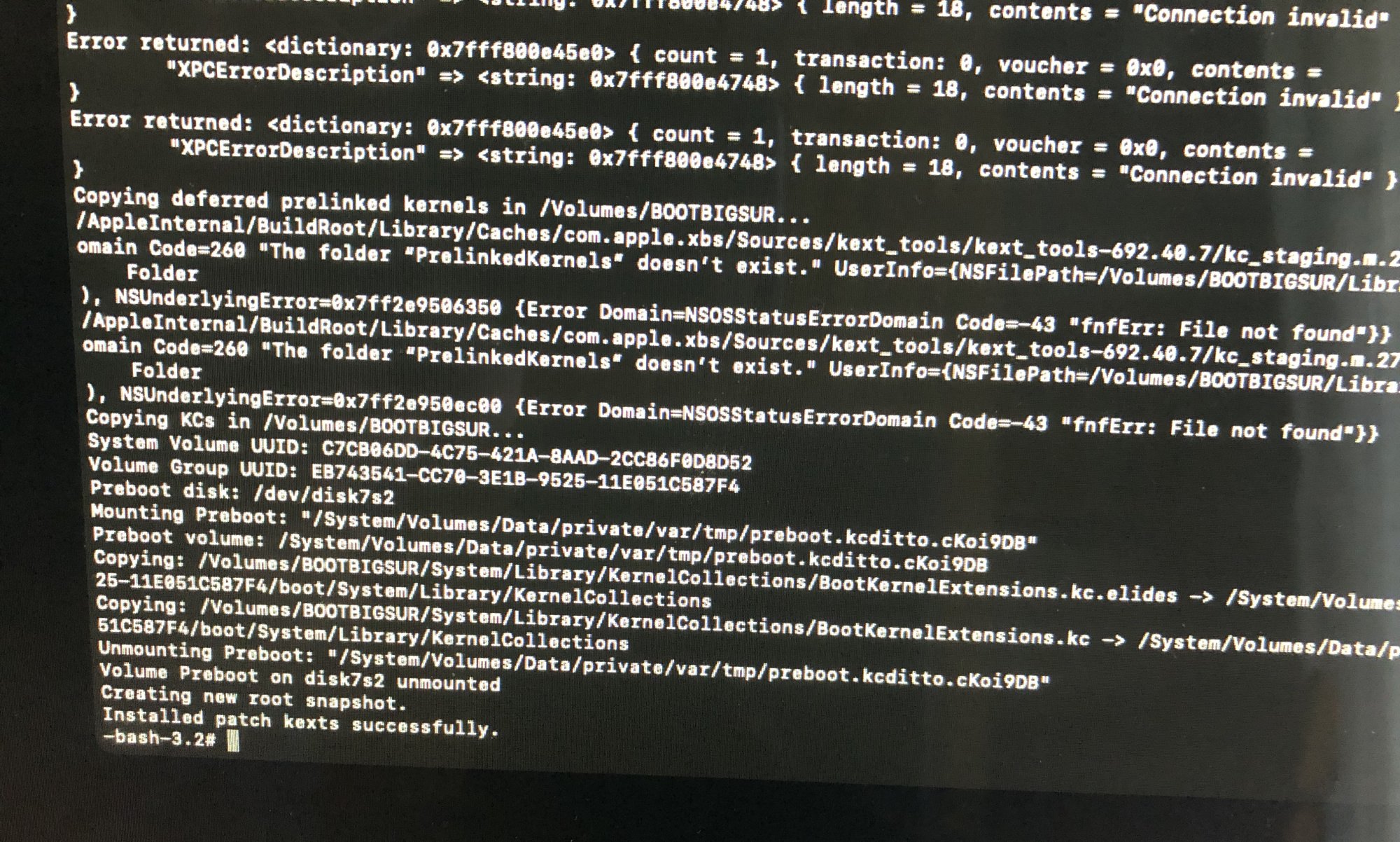

here is the result:
There are some errors but at the end it says "Installed patch kexts successfully". I will try to find out the meaning of these errors anyway. Someone had a idea ? 😳

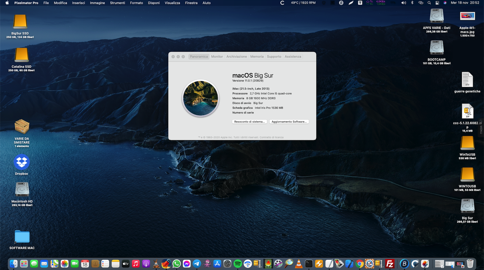

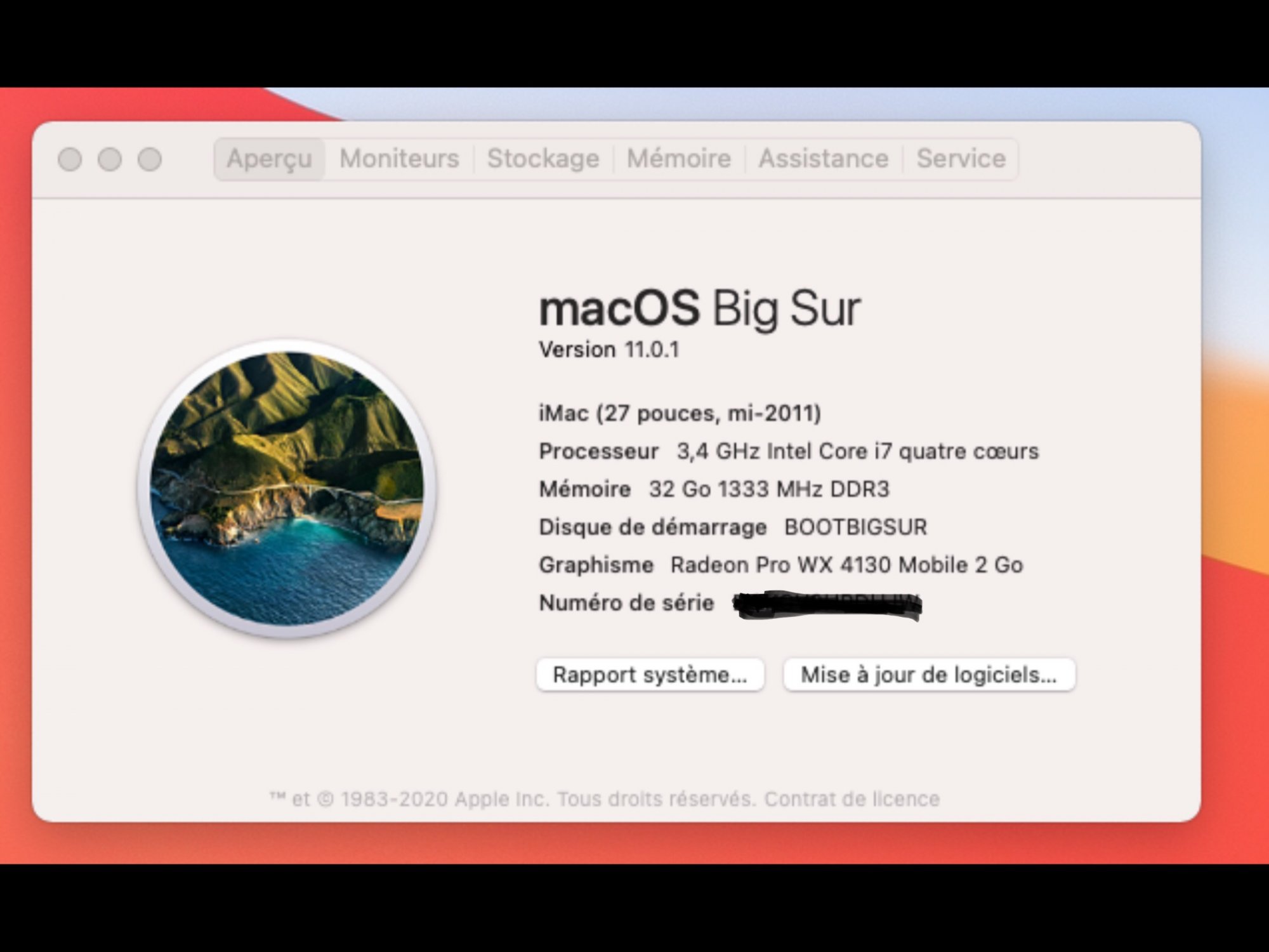

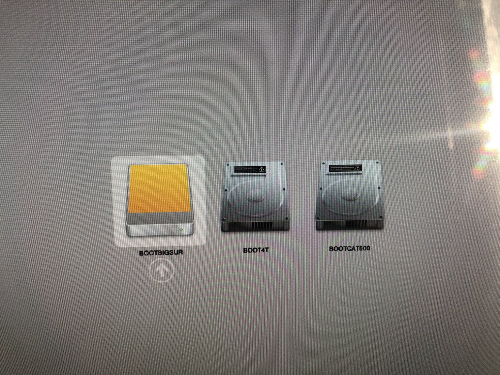

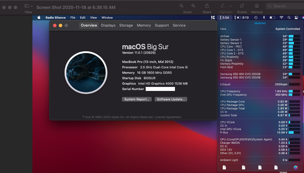

After a last reboot, we can therefore choose the boot in Big Sur:

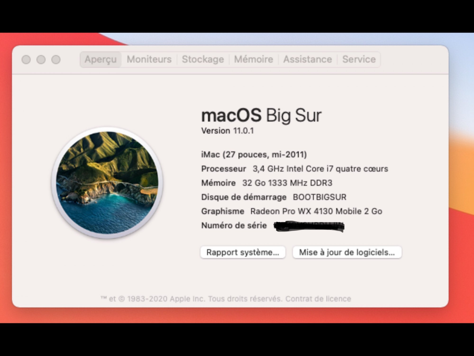

The "About" is there 🙂
many thanks to @Ausdauersportler, @Barry K. Nathan and others peoples 👍

Hi!
This is not the correct way to use the micro patcher as of version 0.5.1 with a GPU modded iMac 2011. Please start the patch-kext.sh -u again to get into the original state and reboot. You can do this from the Terminal app while booted into Big Sur.
Then redo patching without the --2010. There is a auto detection of your model and the GPU and you would get all the necessary patches needed for this particular model. You can do this from the Terminal app while booted into Big Sur, too!

Hi!
I really need some help with those kernel panics.
iMac 2011 with K2100m, clean install Big Sur with Micropatcher 0.5.1.
Wifi is working and brightness also thanks to OC 0.6.2.
I used this command line: /Volumes/Install\ macOS\ Big\ Sur/patch-kexts.sh --useOC /Volumes/Macintosh\ HD
Now I'm having kernel panics during the night.
Thank you in advance.
Process name corresponding to current thread: kernel_task
Boot args: -no_compat_check -amfi_get_out_of_my_way=1 agdpmod=pikera shikigva=80
Mac OS version:
20B29
You are simply using the wrong config.plist on your OC - rename the NVIDIA version. Using the AMD version you are spoofing the iMacPro1,1 ID and sleep fails. Move of the 0.6.3 and rename the file. Read the post I made about this.
I wonder how you got it working before with Catalina ....
P.S.: Next time put the panic.log into SPOILER Tags...
Hi!
I understand my error I have read on the readme of micropatcher "If you're going to use the installation on a 2010 or older Mac ..." , my mind (French) thought otherwise, you are right 😉 Imac 2011 is not OLDER . Thank, i do what you say 👍
Everything is ok, but please ignore the flags like --2010 and --2011 - it is just a vehicle for system currently not detected automatically ....
You iMac needs special patches with will be only installed if you do not overrule the patcher. Let it simply doing it's work ... we hope to deliver a *complete* working system auto detection and patch selection in near future. At least for the iMac 2009 to 2011 having a new Metal GPU this should work right now...

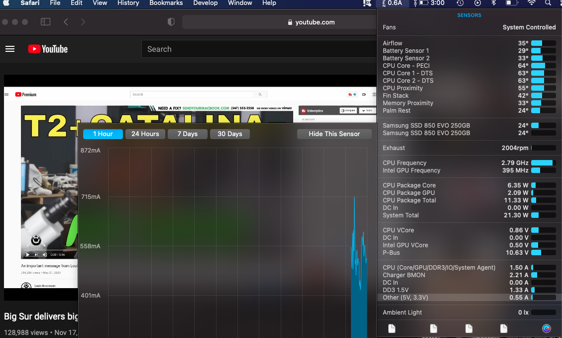

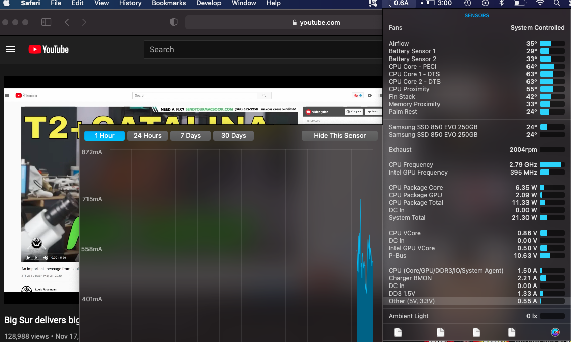

Thank you very much for the answers! I have these temperatures browsing the web and playing Youtube. Sometimes even higher. I don't see it very normal. Install Big Sur with Patched Sur app. What I can do? Thank you!

Is my issue to do with this? - with b10 I can't delete the remaining snapshot from Recovery. Even with the BS System volume mounted and R/W, I get 'Error -69863: Insufficient privileges'. I've managed to delete all snapshots manually up to/incl b9.
After I updated b9 to b10, the usual 'com.apple.update...' sort of snapshot was listed - but with 'Purgeable: No' this time around. I added a newer snapshot and zapped the Apple one with Barry's script. The remaining one I added stated 'Purgeable: Yes' but it still just won't delete.
Any thoughts anyone?
EDIT: I just reapplied the full Beta10 Installer over the injected-into-b9 delta b10 update and I 'can' now delete the initial update snapshot from recovery, leaving none (even though it was flagged as 'Purgeable: No').
It's probably easiest to boot into Recovery mode using a USB installer stick, if getting to the BS one doesn't work with Cmd+R (mine never works because I've got 5 OS's installed, so maybe the mac boot screen firmware has a meltdown knowing which one to select!).
I still get the 'Error: -69863: Insufficient privileges' message while trying to delete snapshots. I can delete all but the most recent one - which always gives the error message on my cMP 2010.
I've ended up living with snapshot booting and with not being able to mount the BS System volume in BS. If I need to swap over or add a file to any BS system folders, I do it in Mojave, then boot into Recovery, mount the BS System volume as read-write and run (NB. change 11.0 to whatever your BS is called):
kmutil install --volume-root /Volumes/11.0 --update-all --force
/Volumes/11.0/usr/sbin/kcditto
bless --folder /Volumes/11.0/System/Library/CoreServices --bootefi --create-snapshot
reboot
The above commands seem to update the BS PreBoot volume and kext collections with the chances made in Mojave and start BS off from a fresh snapshot including the changes. The '--force' is recognised as a more-or-less deprecated command but I've found that my Mojave changes don't stick unless I keep typing this in.
Also, didn’t you say here “I 'can' now delete the initial update snapshot from recovery, leaving none.” So did u get an error or something?

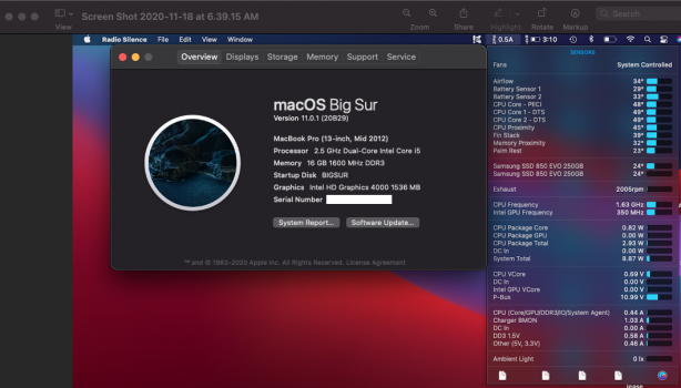

Hi All,
Many thanks for all the useful posts and work done for the unsupported macs.
Apologies if its a stupid question
I have managed to install big sur on my late 2012 MBP pro but i am unable to find the "post install" app on my machine or the hard drive i used to install the OS. where can i find it?
What patcher did you use? And what instructions did you follow?

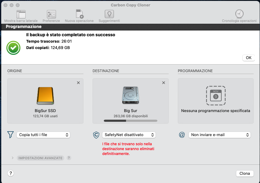

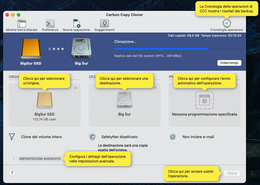

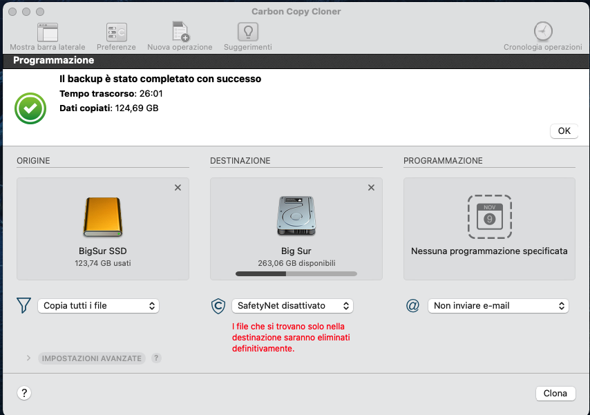

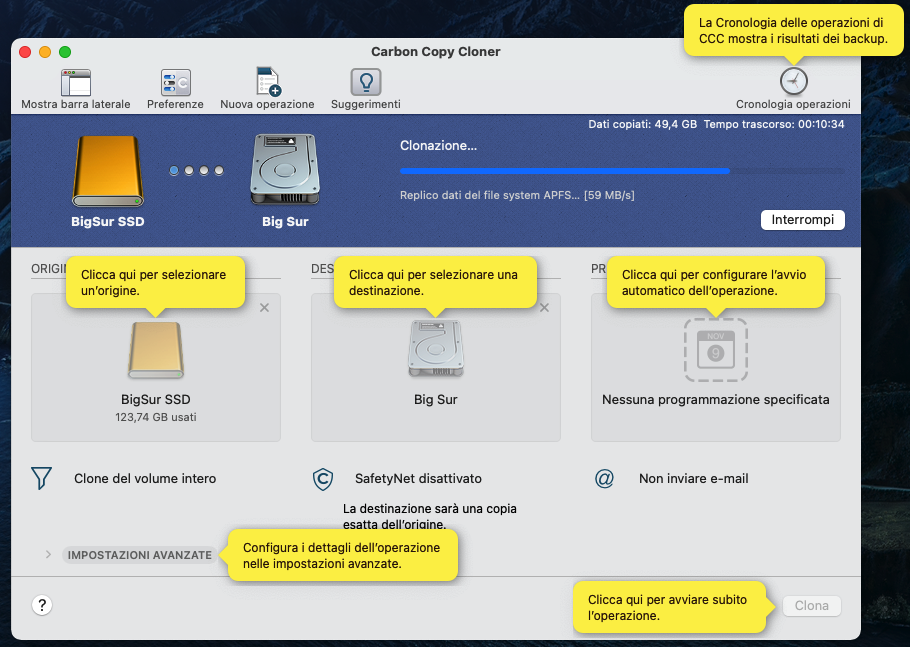

Carbon Copy Cloner 5.1.23 should FINALY make bootable clones of Big Sur! Download 5.1.22 then check beta updates.
Just trying to clone @jackluke patched BigSur SSD 11.0.1 (20B29) on internal iMac 2013 hard disk 🙂
I tried out the CCC 5.1.23beta yesterday and the 11.0.1 clone backup drive booted up just fine on its own. The method Bombich is implementing is that the destination drive has to be fully erased by CCC first, so backups (so far) can’t be incremental ones, just full ones.
