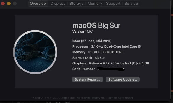

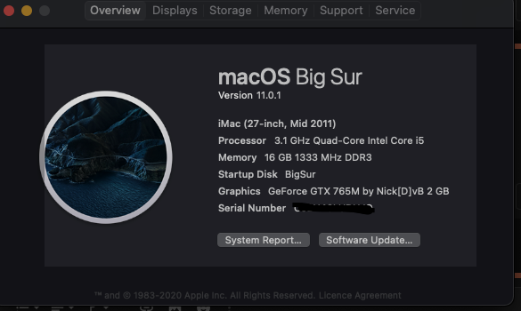

Finally after a lot of perseverance got the BigSur working fully on the iMac mid 2011. Siri Audio works and post patches went well with wifi working. I used the Micropatcher installer of BarryN followed by post patches.sh. Thanks to @jackluke and @Ausdauersportler specially for extra help.
Only major issue I am facing is iMac does not show desktop after startup chime. I have to restart, Start, fresh boot the machine by pressing Option/alt key of the keyboard.
Please provide solution to this ongoing issue. Thanks😉
Nearly perfect!!
Did you save the patch-kext.sh output in the terminal?
You meant after startup chime the iMac shows a blank screen, you already had this issue during Catalina, also in selecting a startup disk for apple startup manager, I guess your issue it's mainly related to your non EFI GPU flashed firmware.
Yes true I had this issue since Catalina, then it got solved when you released the opencoreafsloader 2nd version I guess and I just inserted the usb and booted the mac normally and first the white screen came with some scripts running fast and it bought me to the login page. All was well but recently this issue cropped up.
No wonder after every boot of bigsur I had to manually force shut the imac the press option key to continue with installer.
Now whether I restart or initial boot the machine I have to use option key. How do I solve this.

That was an internal opencore version that used BOOTX64.efi from EFI internal , anyway try this directly from BigSur normal booting:
Code:
sudo bless --folder /System/Volumes/Preboot/*/System/Library/CoreServices/ --file /System/Volumes/Preboot/*/System/Library/CoreServices/boot.efi --setBoot

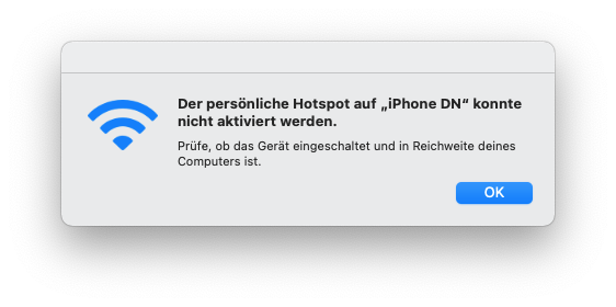

Hi guys,
first of all many thanks to everybody for this great work. Without you I never could install Big Sur in my iMac.
On saturday I finally installed Big Sur on my late 2012 iMac.
Everything works great, except my instant personal hotspot. I already searched this thread but didn't find a solution. Sorry, if I ask again.
I can see the hotspot in my WiFi status. If I select it, I can see, that the hotspot is activated on my iPhone. The switch toggles instantly and WiFi switches to LTE. But then I get a message on my iMac that the personal hotspot could not be activated.
On my 2015 MacBook everything works fine.
I tried two iPhones and two users with different iCloud accounts. Both with same result.
Is this problem already known and is there a solution for this problem?
Many thanks for your help!

First things first:
Your GPU has been flashed with the BIOS @Nick [D]vB published here. It has a approx 5-10s boot delay and will show the boot screen aka the progress bar only after this delay. Unfortunately most fast SSDs boot the complete MacOS in this short amount of time and you see no "boot screen" - but it is always there. The first thing you get is the complete login screen...
Als long as you can force the boot selection to come up on boot with alt/option everything is fine and works as designed!

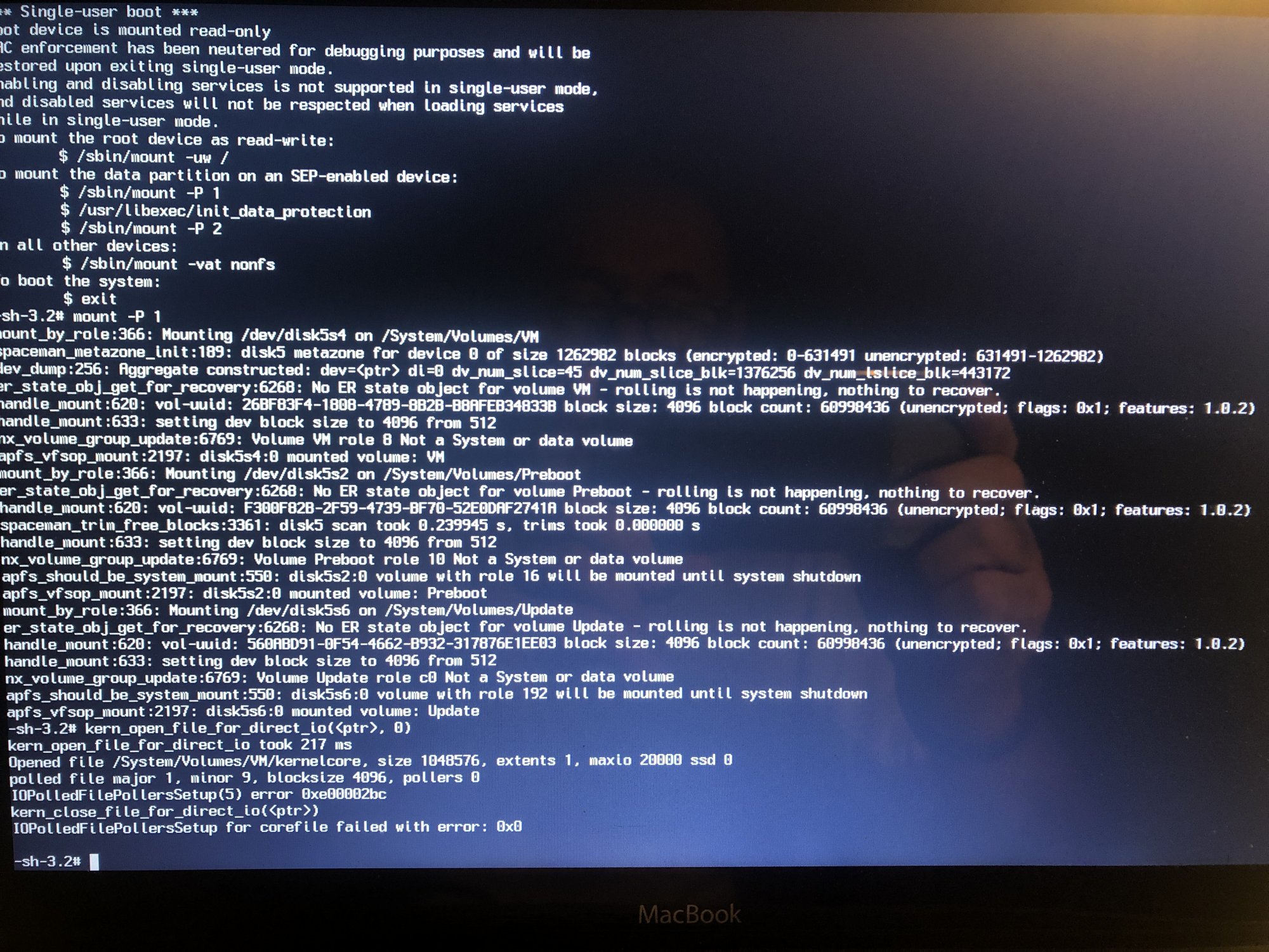

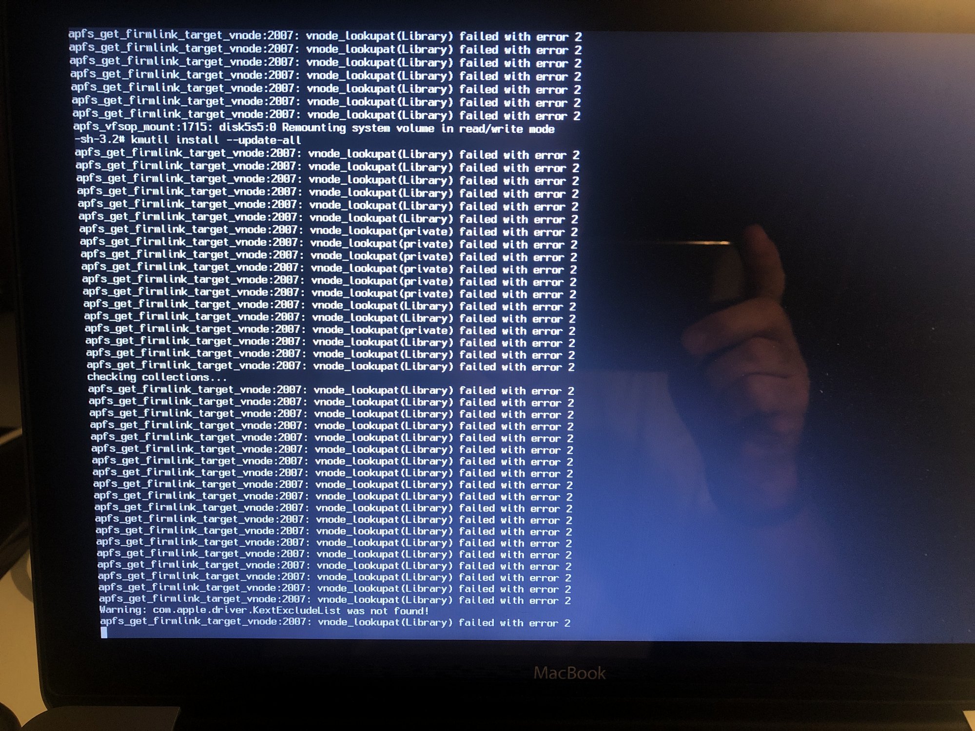

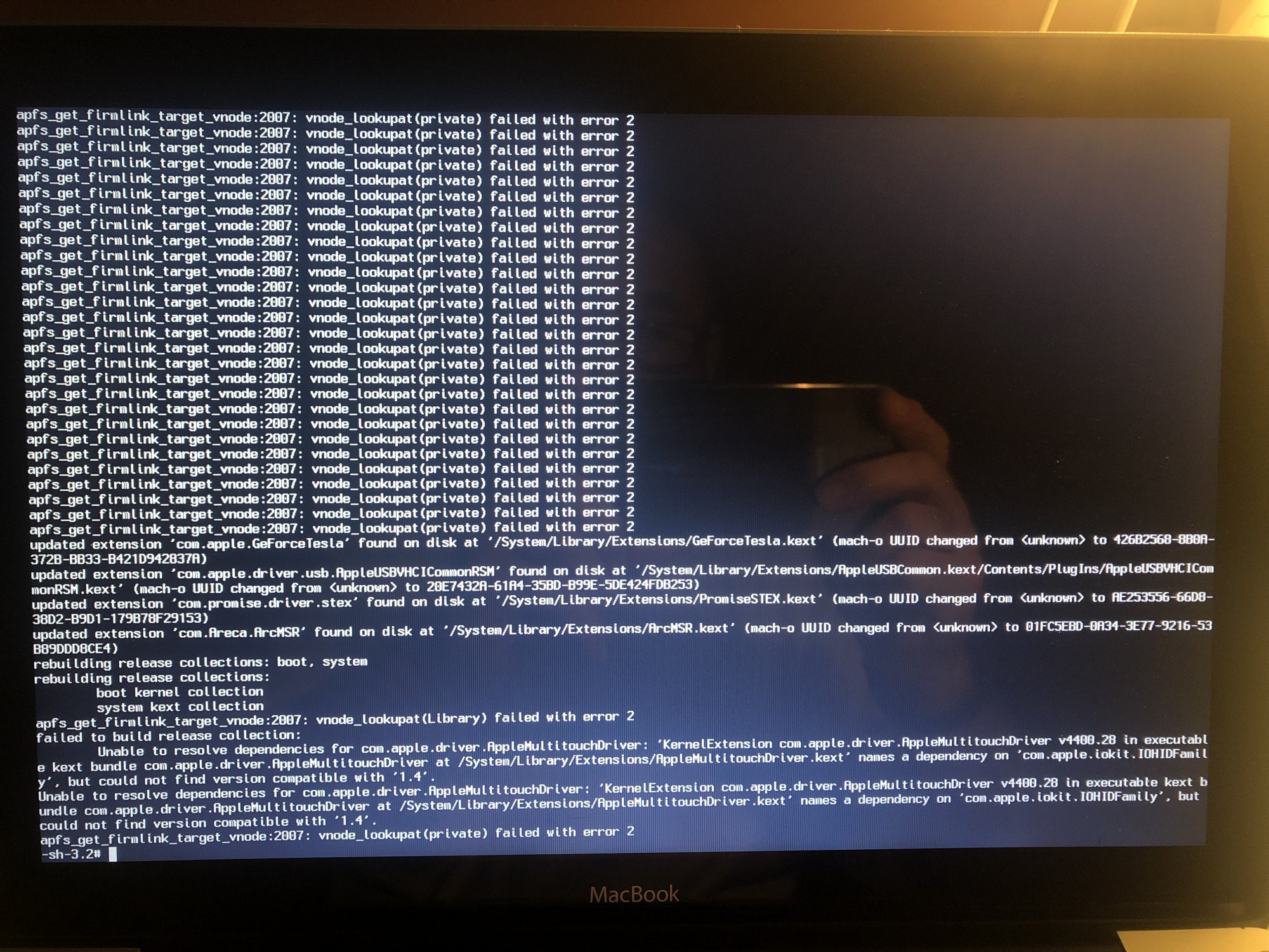

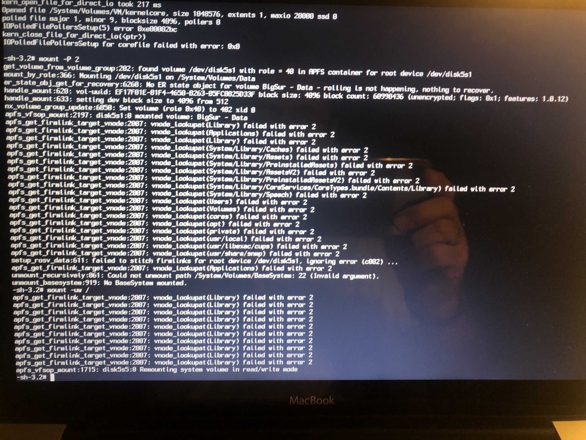

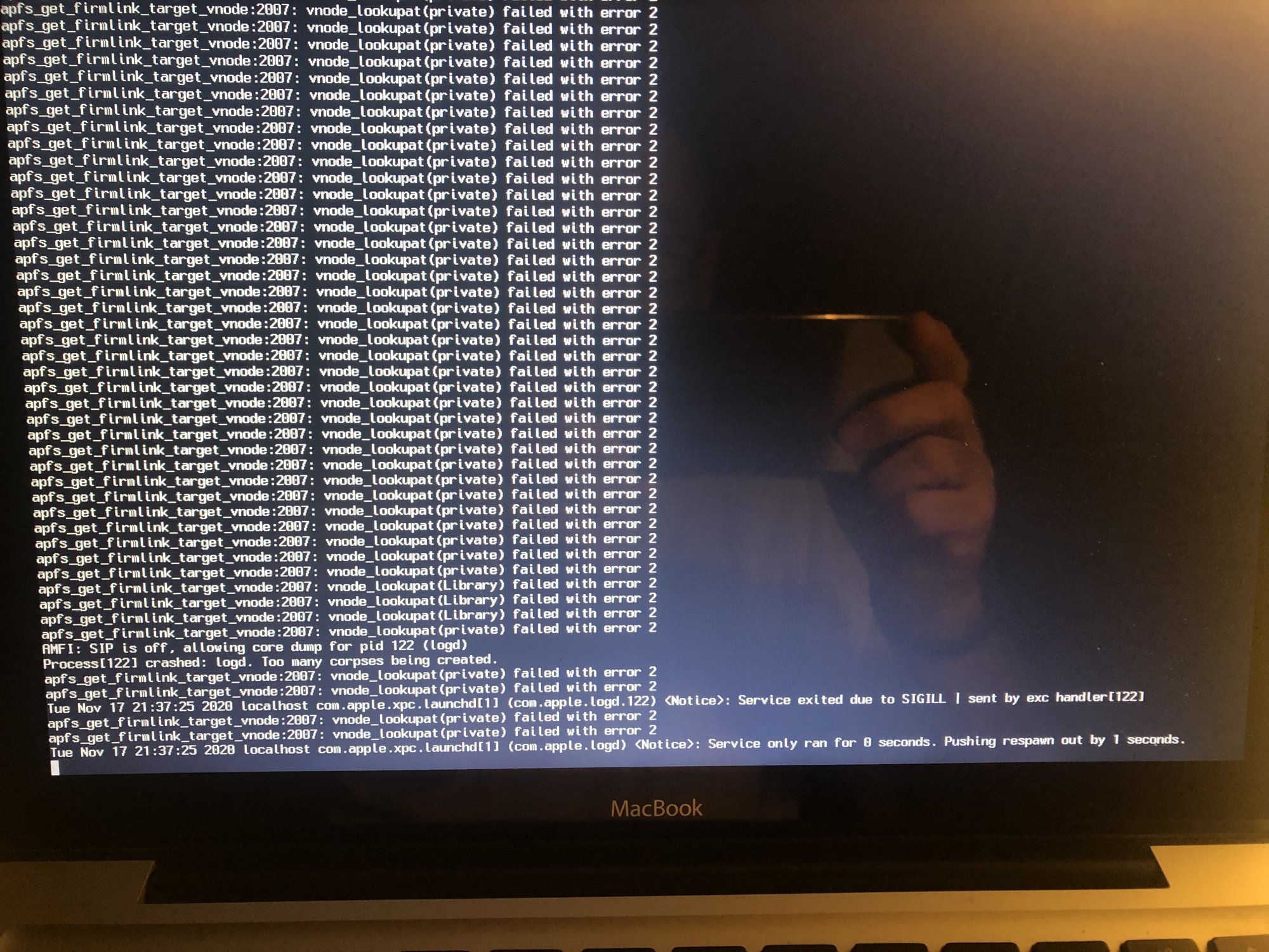

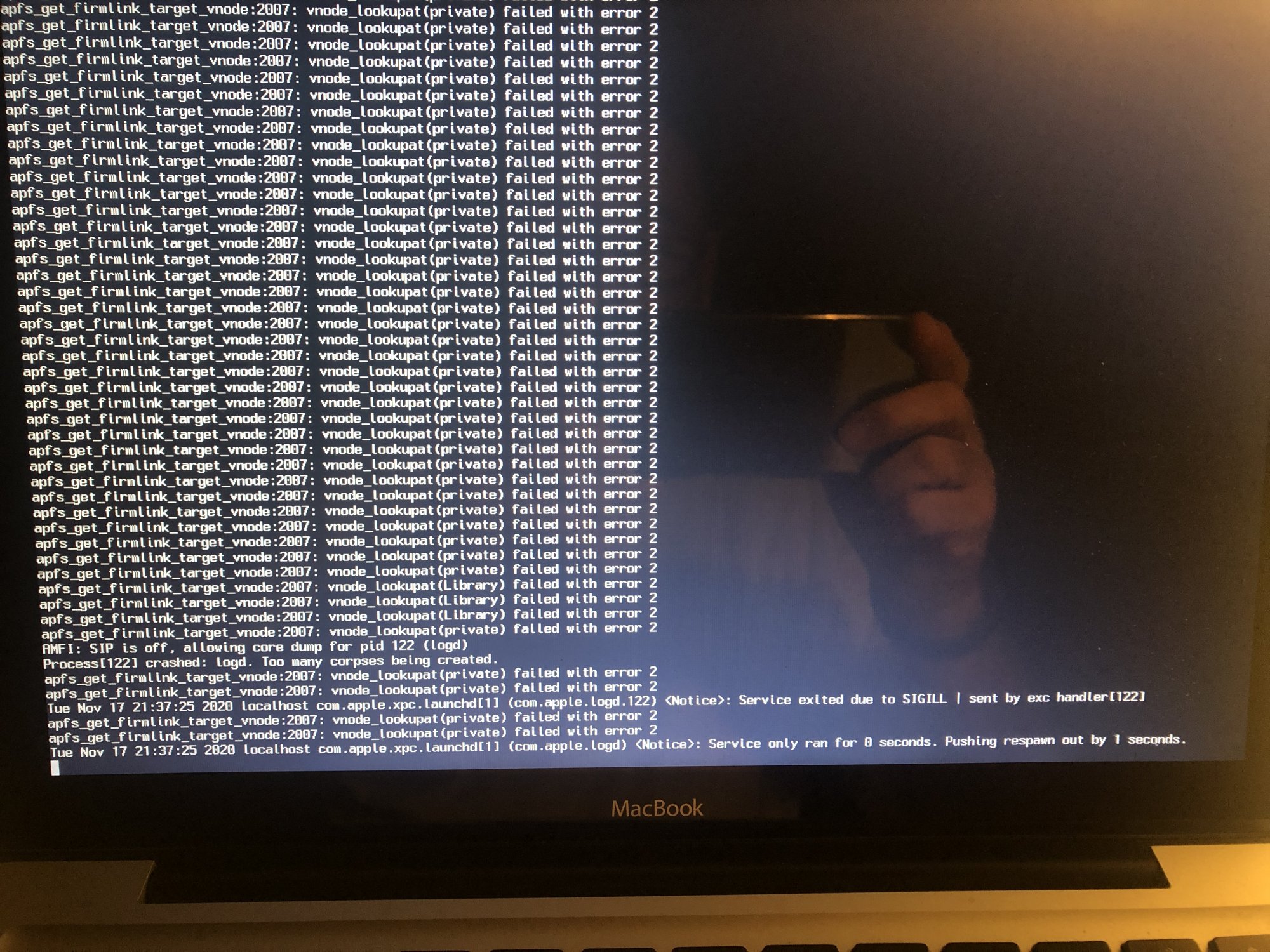

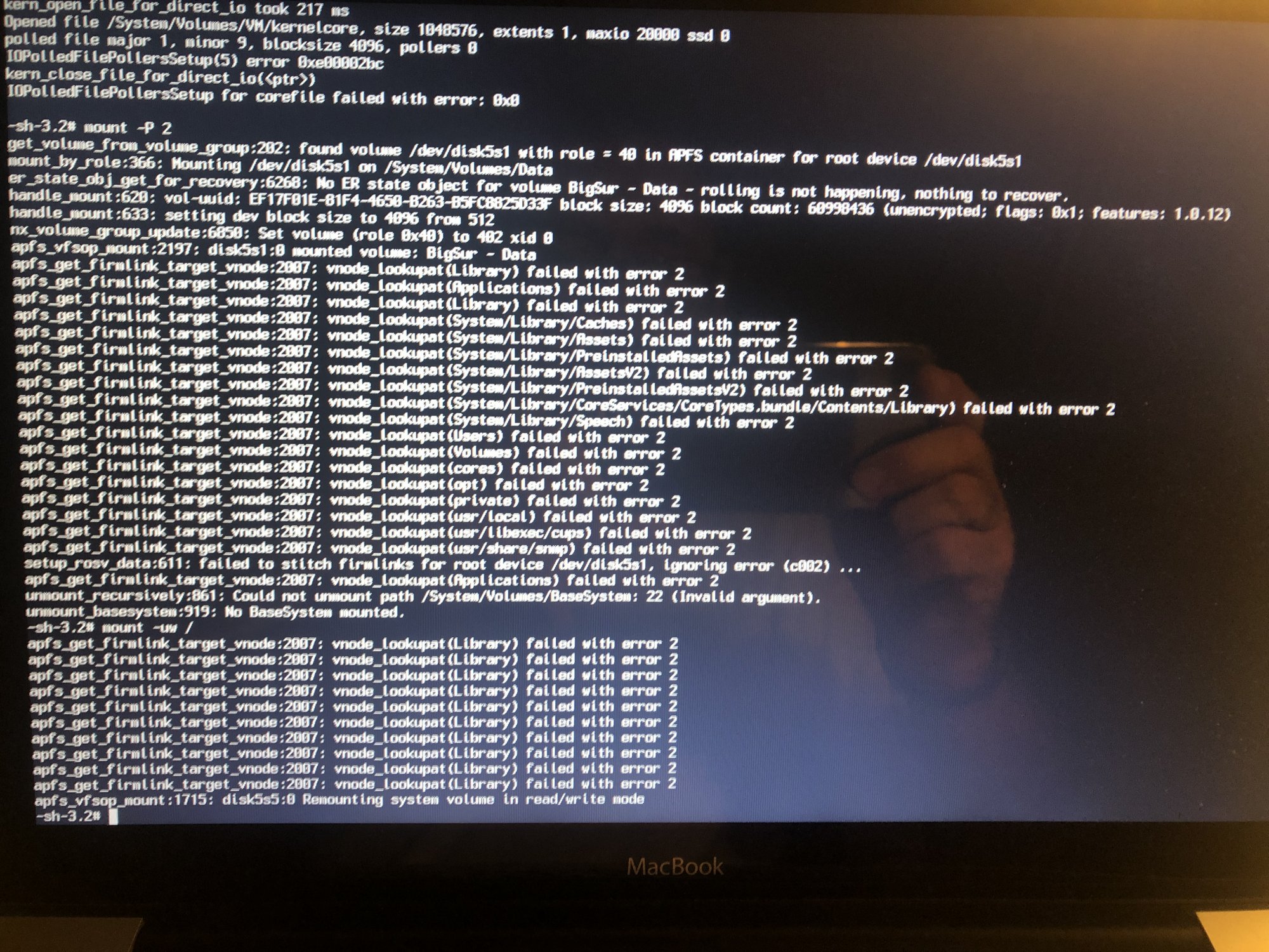

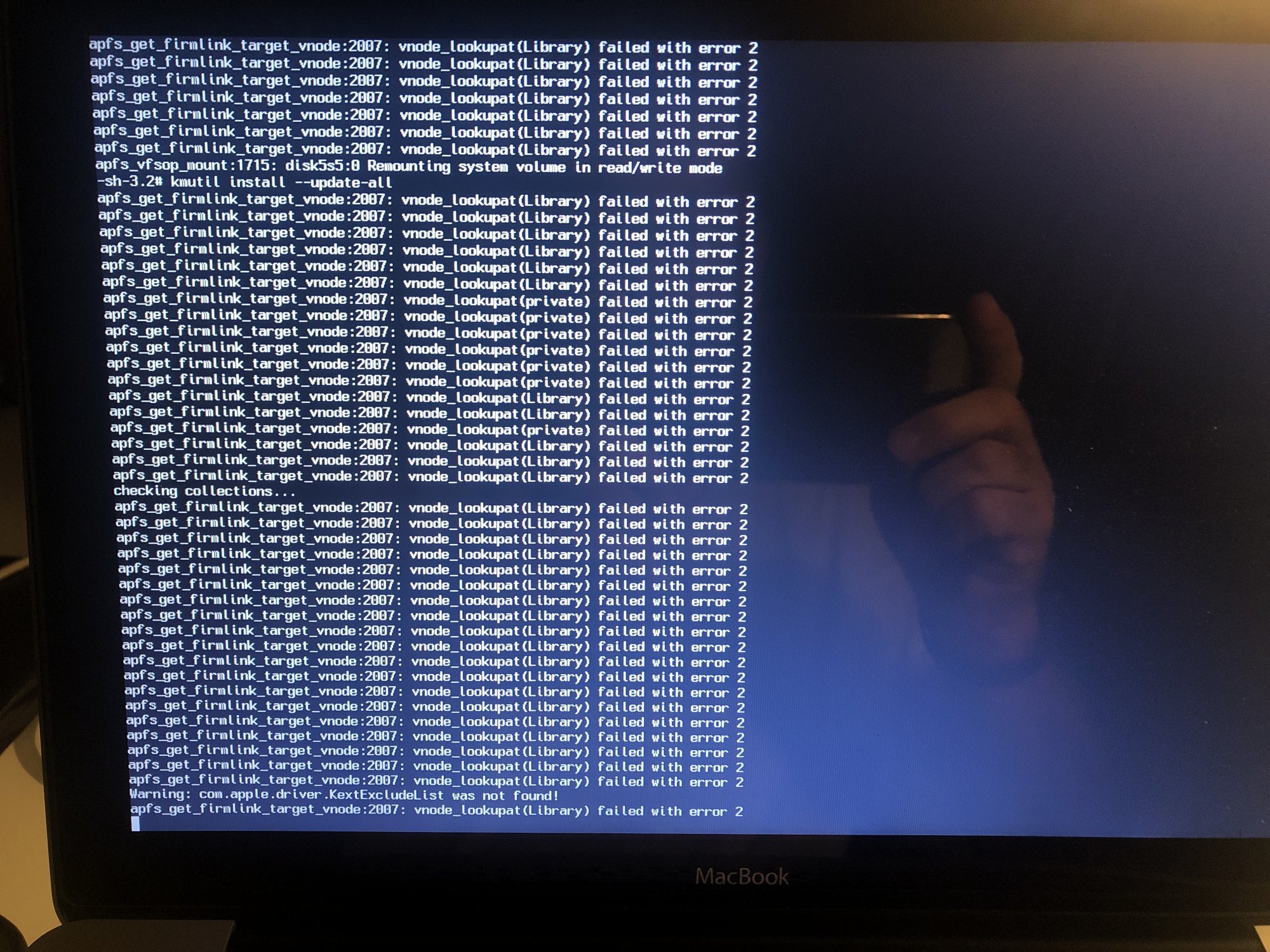

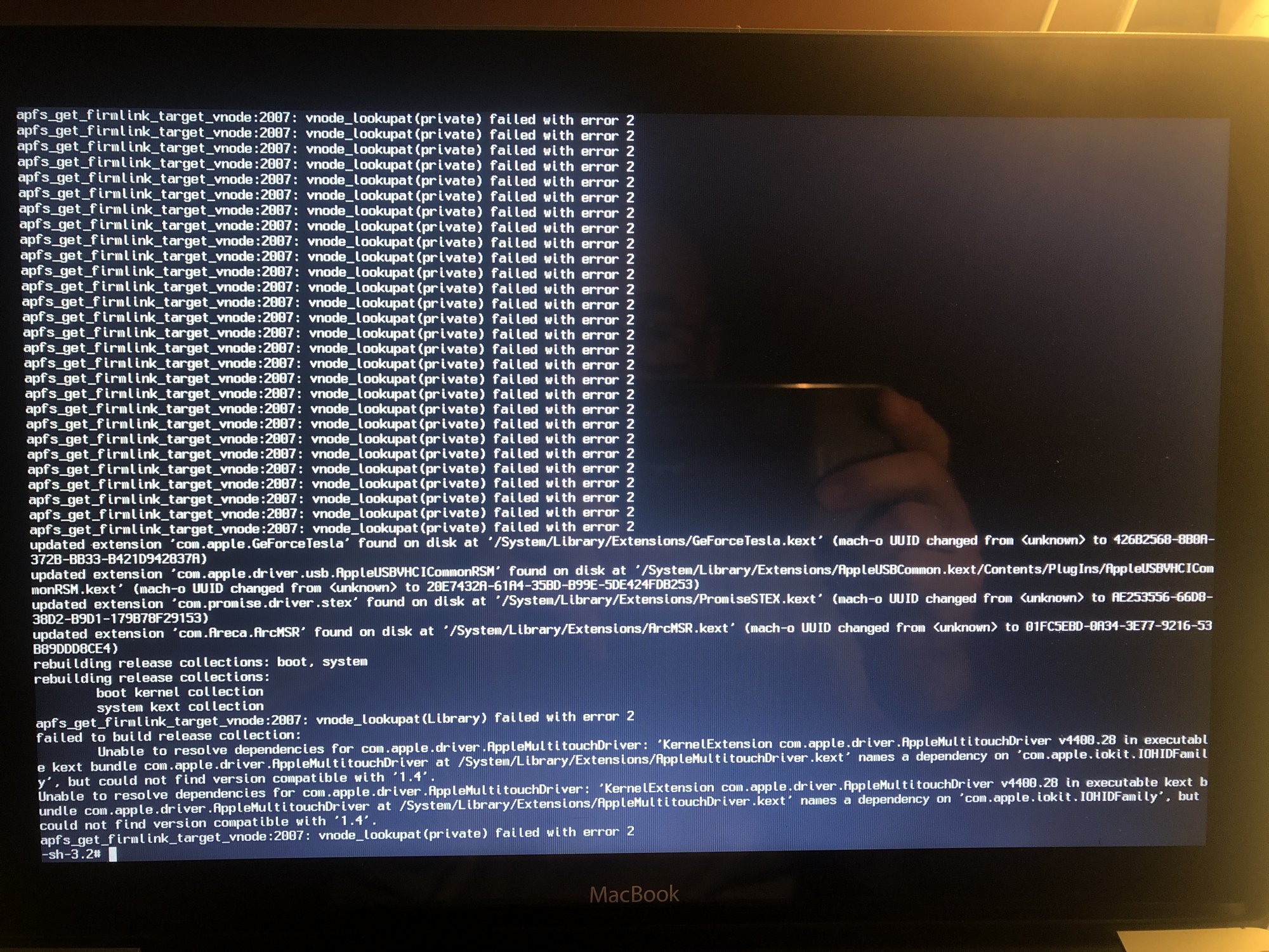

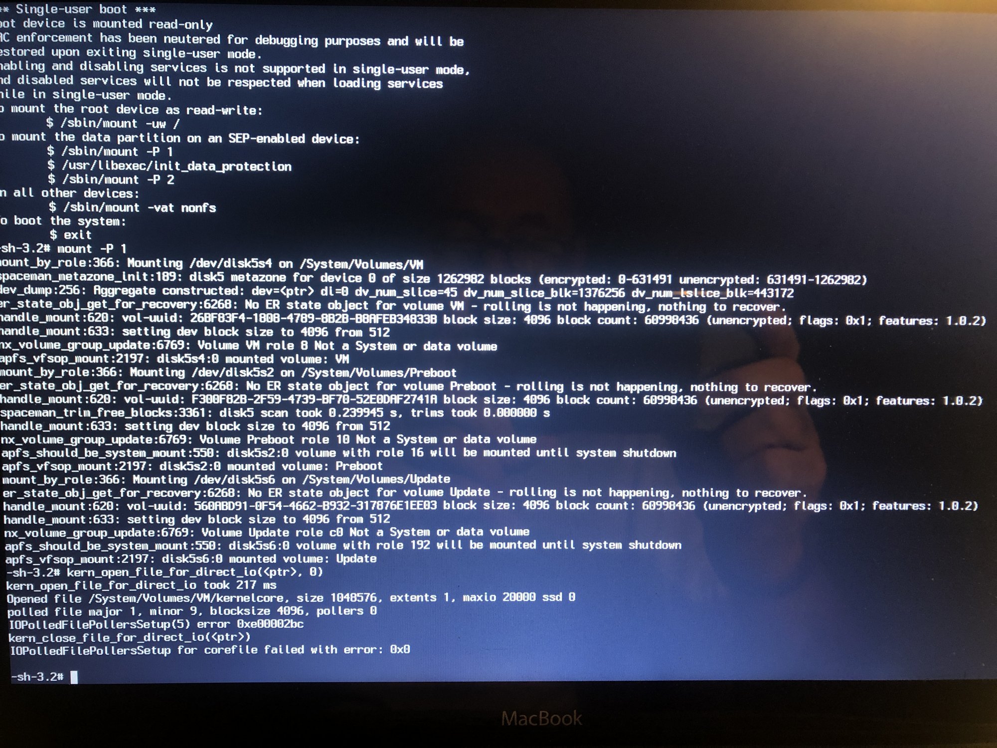

That's issue ARV error it's weird because "csrutil auth root" is disabled (even if I still using a patched boot.efi from previous beta, maybe I should use the new 724 KB boot.efi), ignoring this ARV issue, another attempt, after you used disable snapshot (or delete snapshot), rebooting BigSur with CMD+S from its shell type:
Code:
mount -P 1
mount -P 2
mount -uw /
kmutil install --update-all
kcditto
reboot
then reboot targeting BigSur with CMD+S, type "mount -P 1 ; mount -P 2 ; mount -uw / ; exit"
The first four attached pics are related to the 5 commands provided separately., the last is related to the string of commands. I turned off when the "core dump for pid" reached the value of 400.
Reactions: TimothyR734

First things first:
Ok. As long as it will not destroy anything I will use option/alt key to boot the machine. But I was able to get the login screen very fast without the black screen. Just recently this issue happened.
Code:
Get following error after using above terminal command.
Can't load /System/Volumes/Preboot/usr/standalone/i386/apfs.efi
Could not load apfs.efi data from /System/Volumes/Preboot/usr/standalone/i386/apfs.efi
