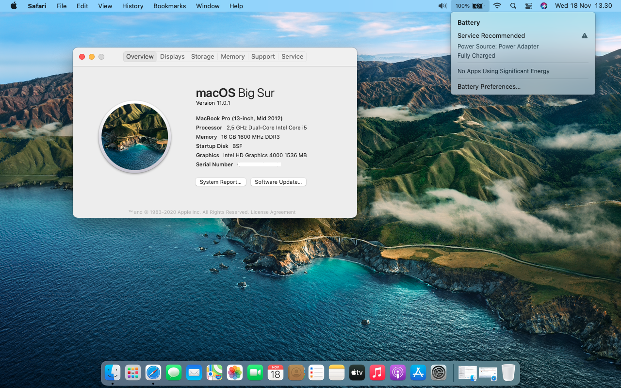

I Got notif " Battery service recommended"
MBP 2012 13 NR clean install miropatcher dual boot w catalina
how to fix it?
You continue to use your laptop; but you've been served notice that the battery doesn't hold as much charge as it used to. So, sometime in the future (when it holds very little charge), you may want to replace it. If you really want the notice to go away, put in a new battery.

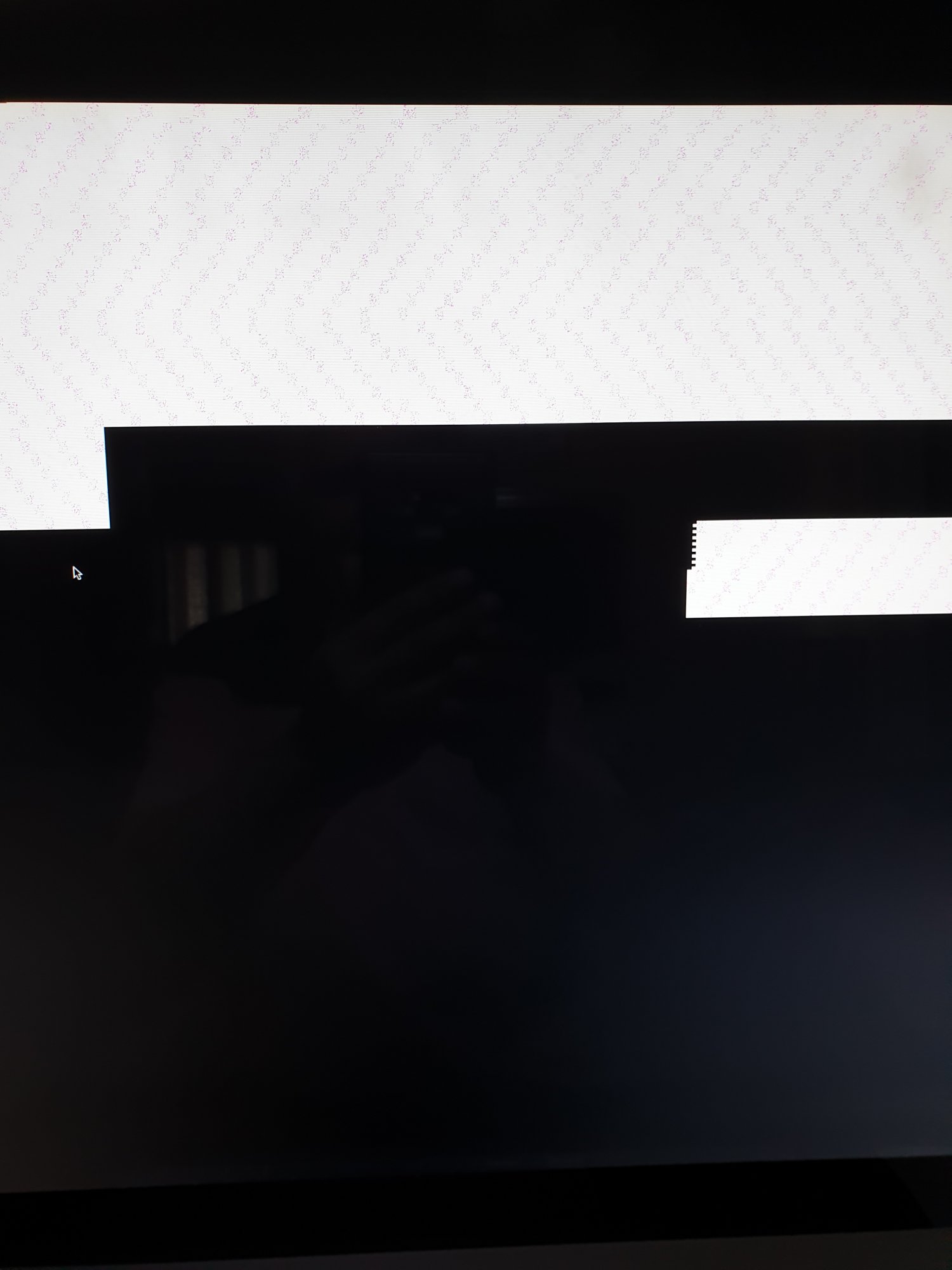

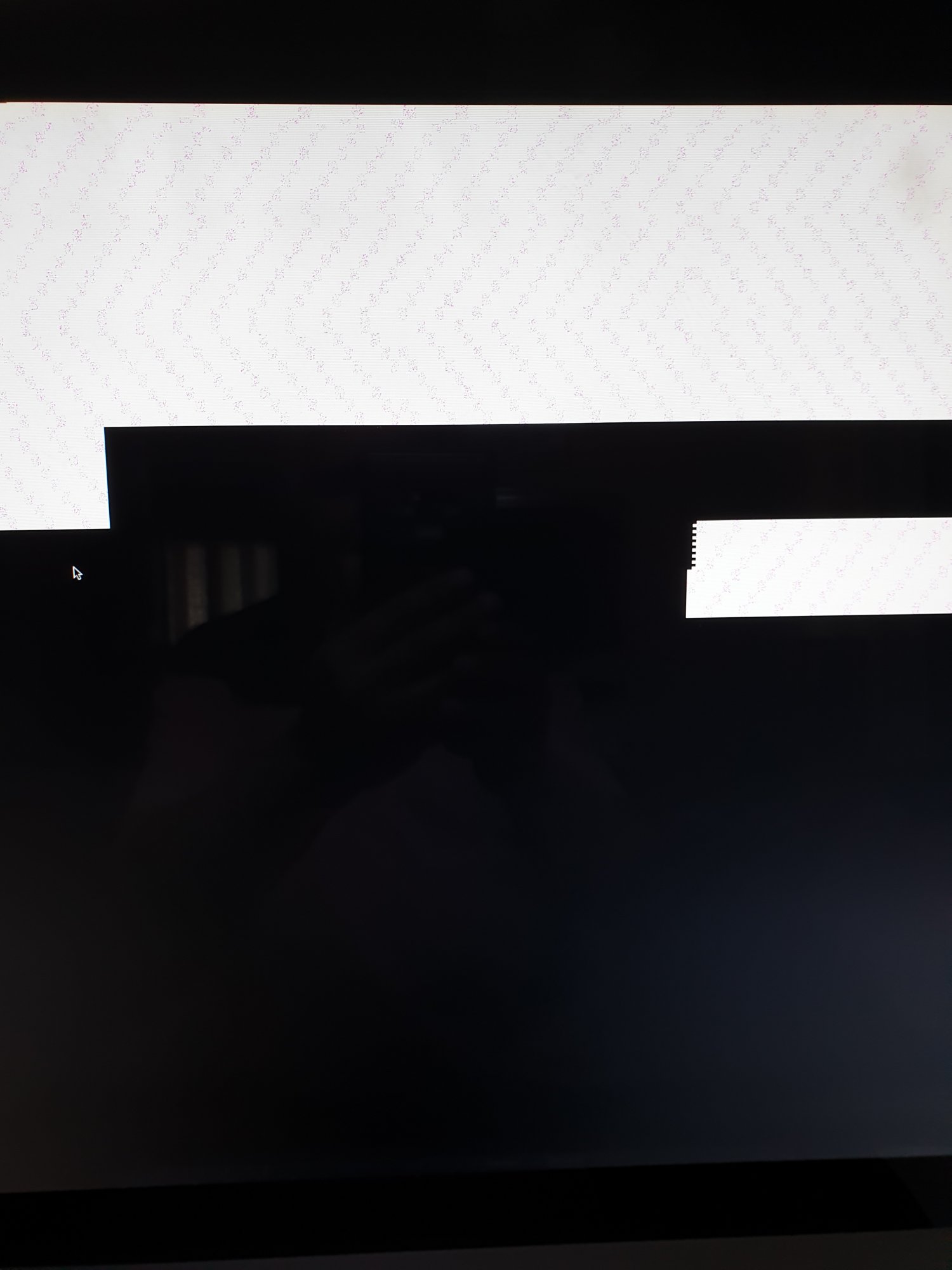

😱😱My imac display crashed suddenly after going though all the good things 😳. Suddenly the screen flickered, then starting black and white, then got horizontal lines and then no movement nothing.
Edited.
After few hours same issue. I think my display card or the display itself is causing issue. damn.

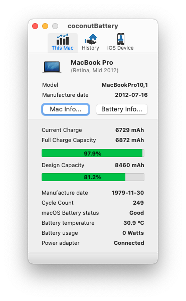

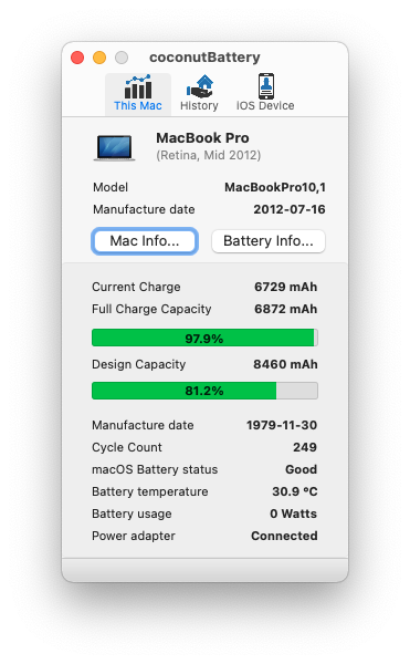

Had the same issue with BS betas 9 and 10, I wrote to Apple Support to ensure that this warning didn't involve any safety issues, they confirmed that the battery capacity and performance were decreased, but it was ok to continue to use it. They suggested to run Apple Diagnostic (in my case Apple Hardware Test) but is not working anymore on my mac since installing BS (i didn't keep a partition with Catalina).
Coconut battery was not showing any issues (battery status: good) but as you can see the my battery had the 81.2% of its original capacity (alt+click on battery icon on status bar doesn't show the cycle count anymore).
Anyway, now the warning has disappeared!

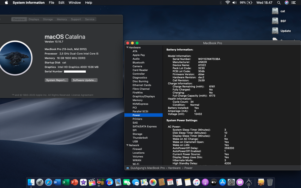

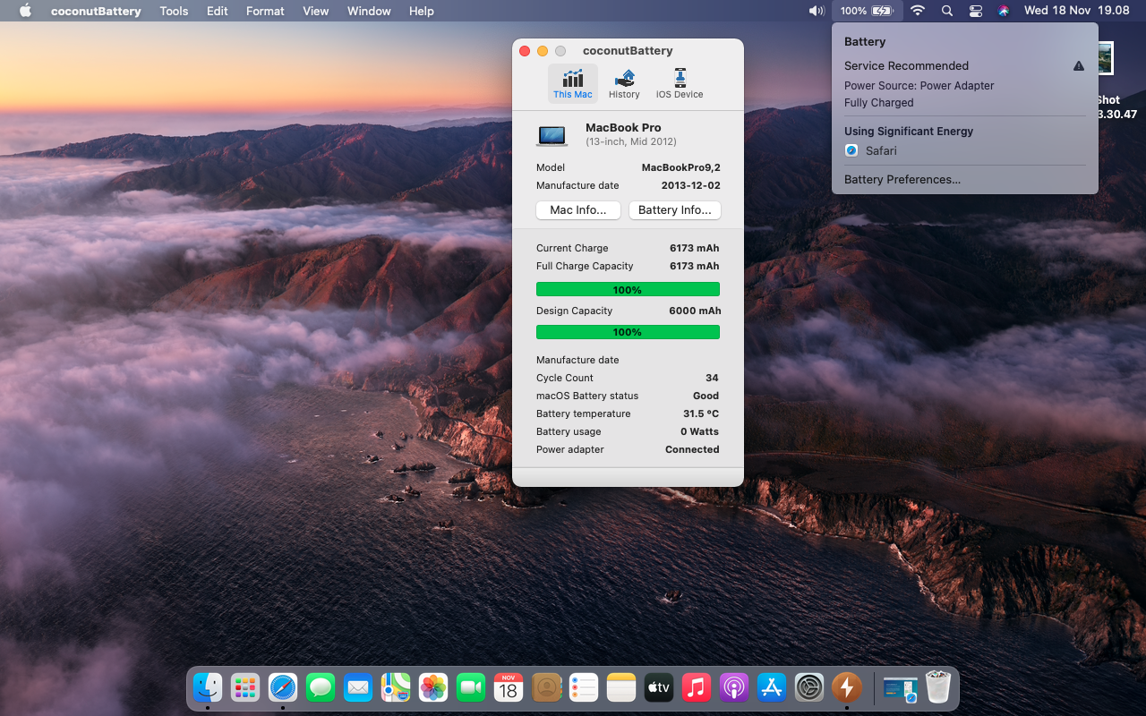

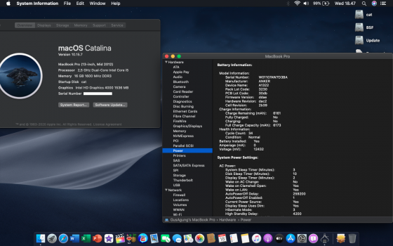

Catalina status batery is normal, maybe bugs system OSX Big Sur
maybe bugs system in BS
