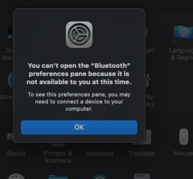

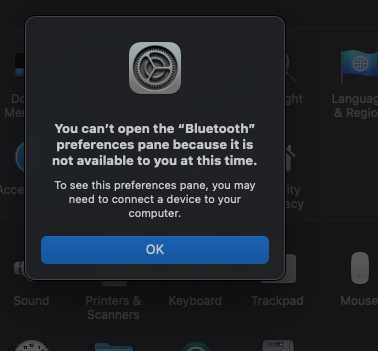

While login into Bigsur my blutooth has gone missing and I cant use keyboard or mouse except for wired. When I try to slide the bluetooth toggle on it shows my devices but bluetooth keeps going off. When I click on preference i get following error
Edited. Fixed the issue, some wire got loose inside the imac related to wifi/bluetooth card.

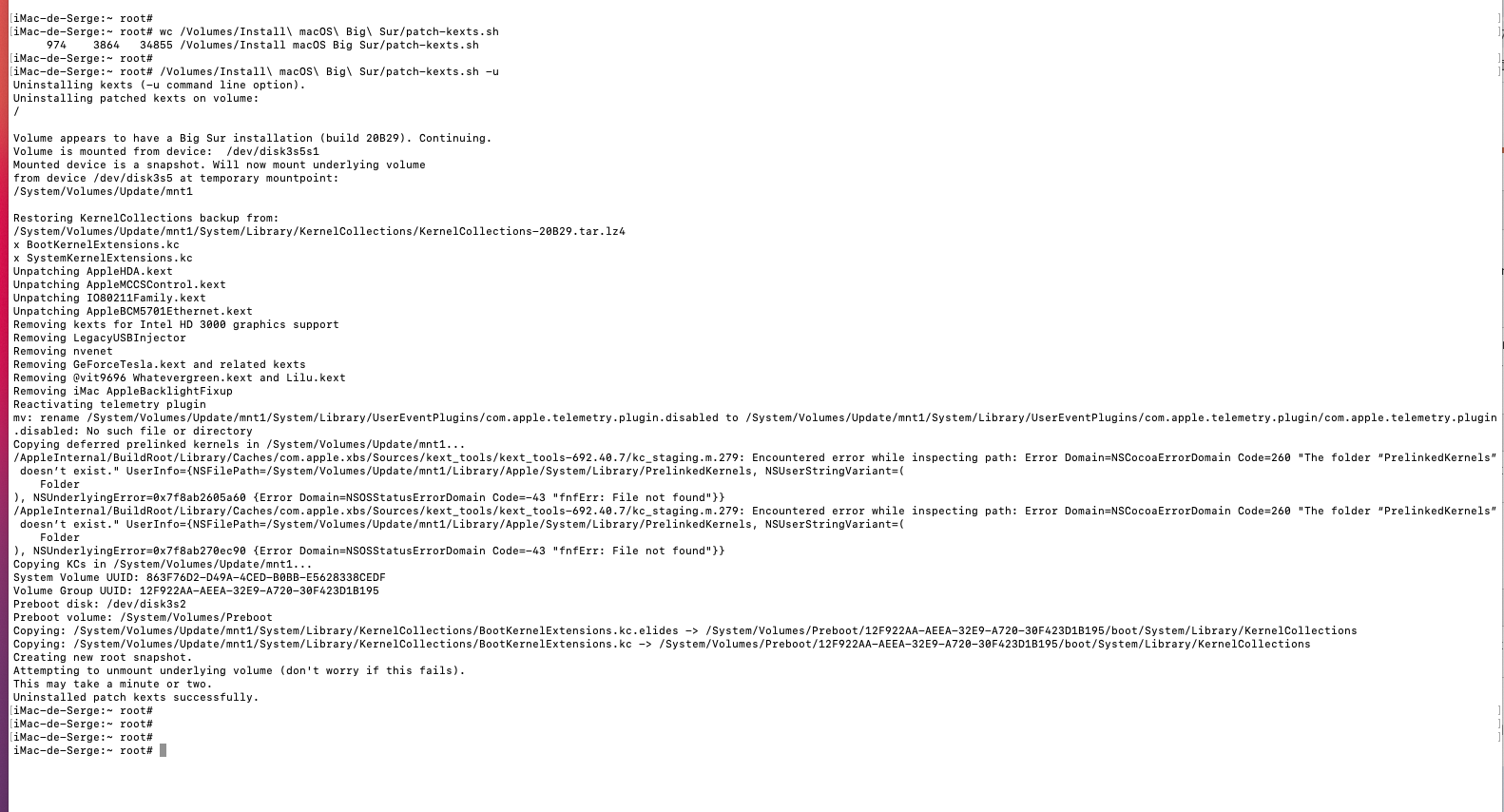

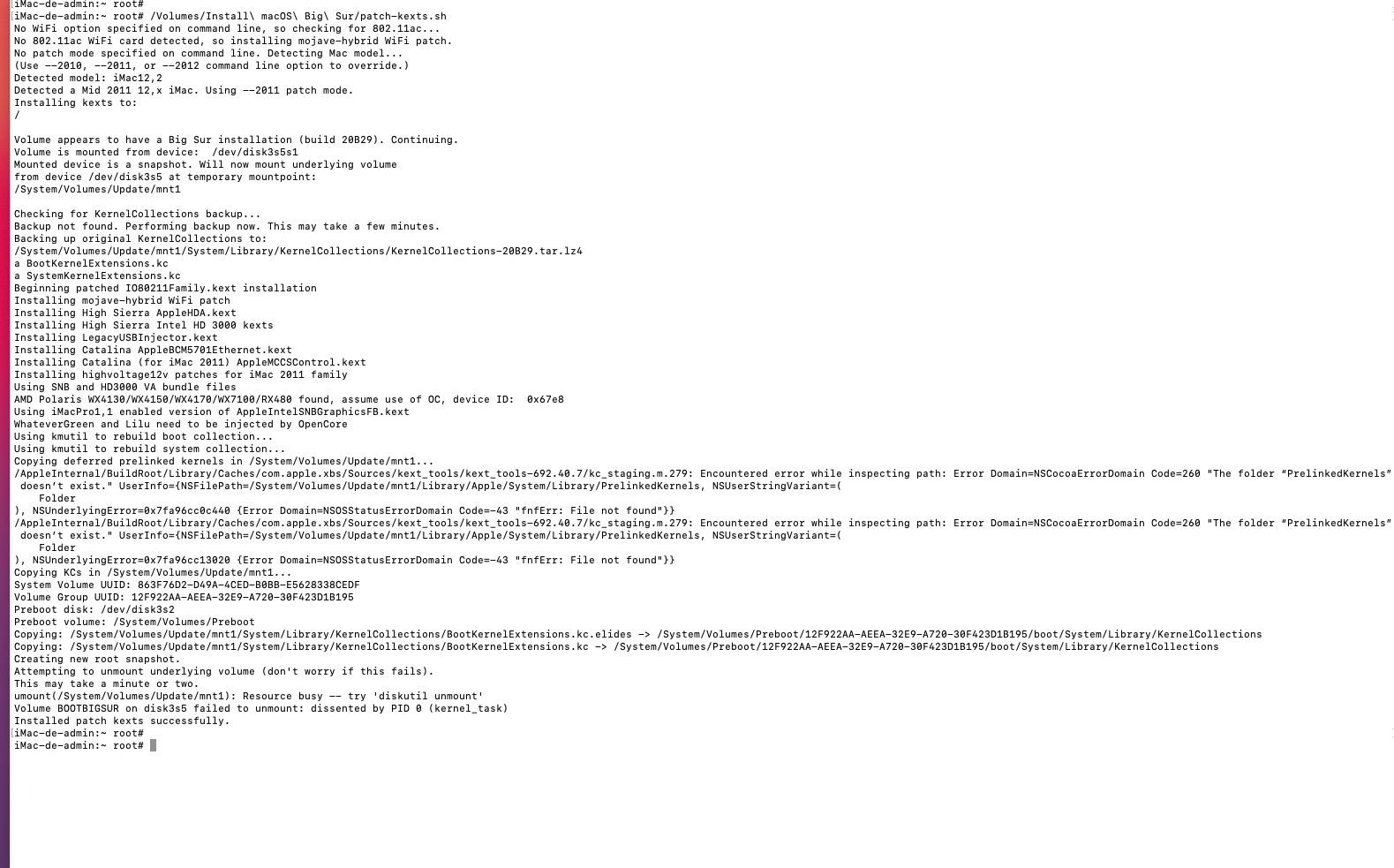

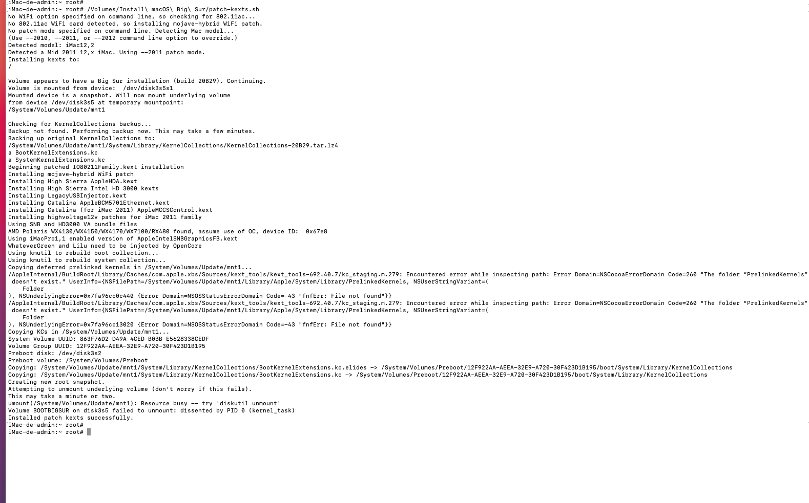

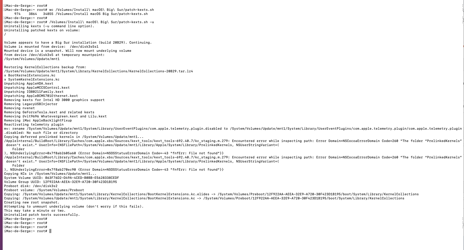

If you want to do my a favour check this version of the patch-kext.sh made for the 0.5.1 micro patcher. Replace the old version on you USB Installer. Boot into Big Sur, open Terminal app and call:
1.
Code:
/Volumes/Install\ macOS\ Big\ Sur/patch-kexts.sh -u
2. reboot again into Big Sur
3.
Code:
You can do the same from the Recovery booted into the USB Installer using you VOLUME name of your Big Sur installation according to the docs of the micro patcher.
  • patch-kexts.sh.zip
With pleasure :)

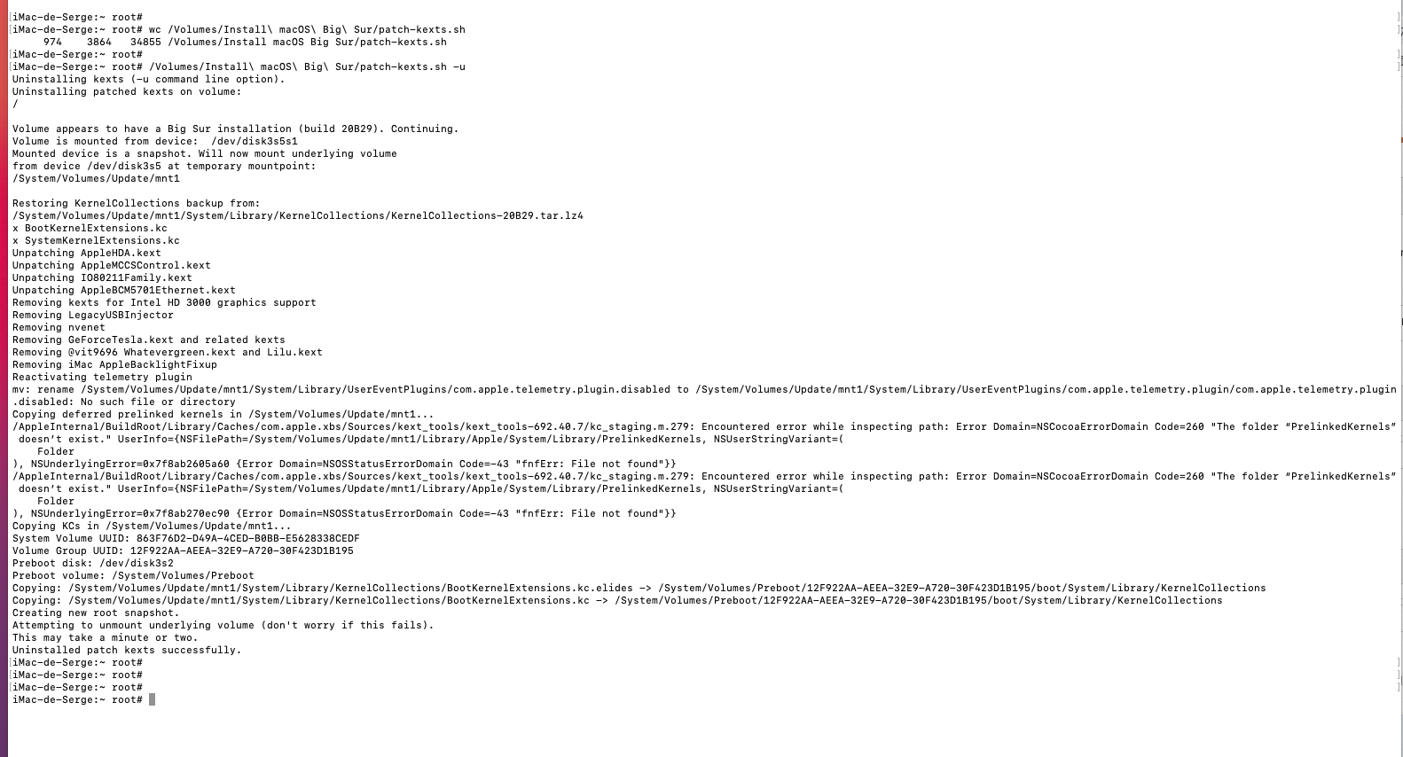

1.
Code:

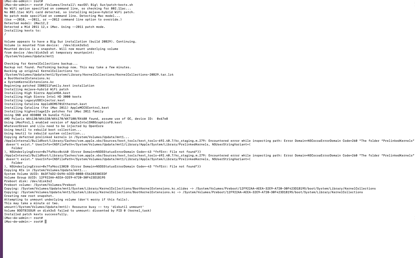

Reboot OK
3.
Code:
reboot again to have Ethernet / WIFI ;)
