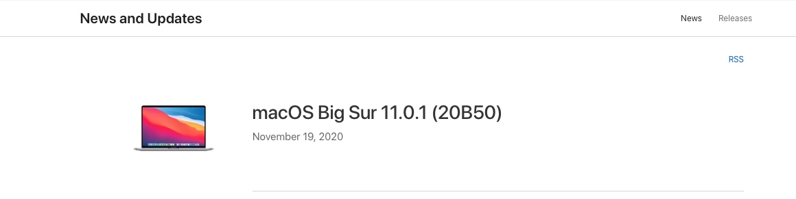

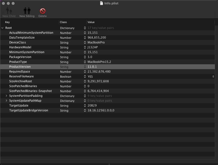

Nope...I don't think so, odd actually, this was updated recently, a new 11.0.1?
Yes, it is the new 11.0.1. Apple today released a revised version of macOS 11.0.1 Big Sur, which appears to be available for some Mac users who had not previously installed the macOS 11.0.1 update.
Probably fixes problems with bricked M1 macs after restoring, makes sense.

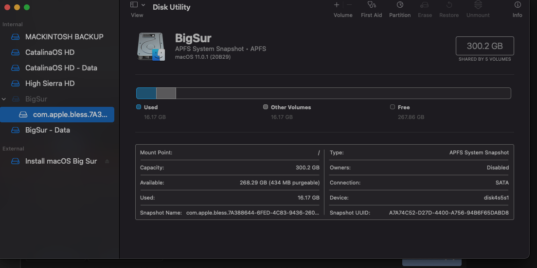

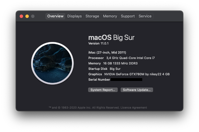

Thanks @Ausdauersportler & @jackluke for your help & support. I have finally got the iMac mid 2011 27 inch running perfectly with Big Sur though It crashed multiple times because of some loose connection while I had swapped the drives.
1. I have a question under big sur in disk utility I see com.apple.bless.. some numbers. Is it supposed to be like this or can it be renamed and whether it will cause any trouble.
2. AS the iMac has 3 internal Sata ports 0,1, & 2. O is attached with internal manual hybrid drive as backup.
Since I have my internal ssd attached to the optical port bay internally with 3gb/s speed (So far all is running great)
3. I also read that testing by the OWC lab with a 6Gb/s SSD on all three 27" models showed only 3Gb/s speeds on all three ports.

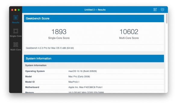

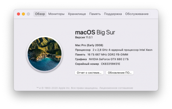

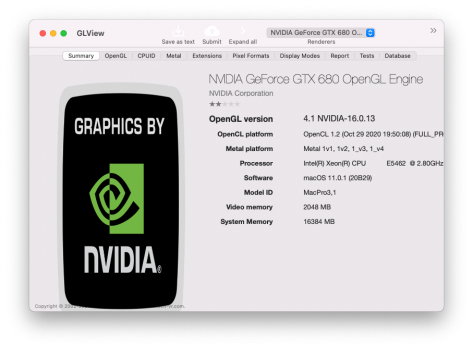

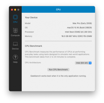

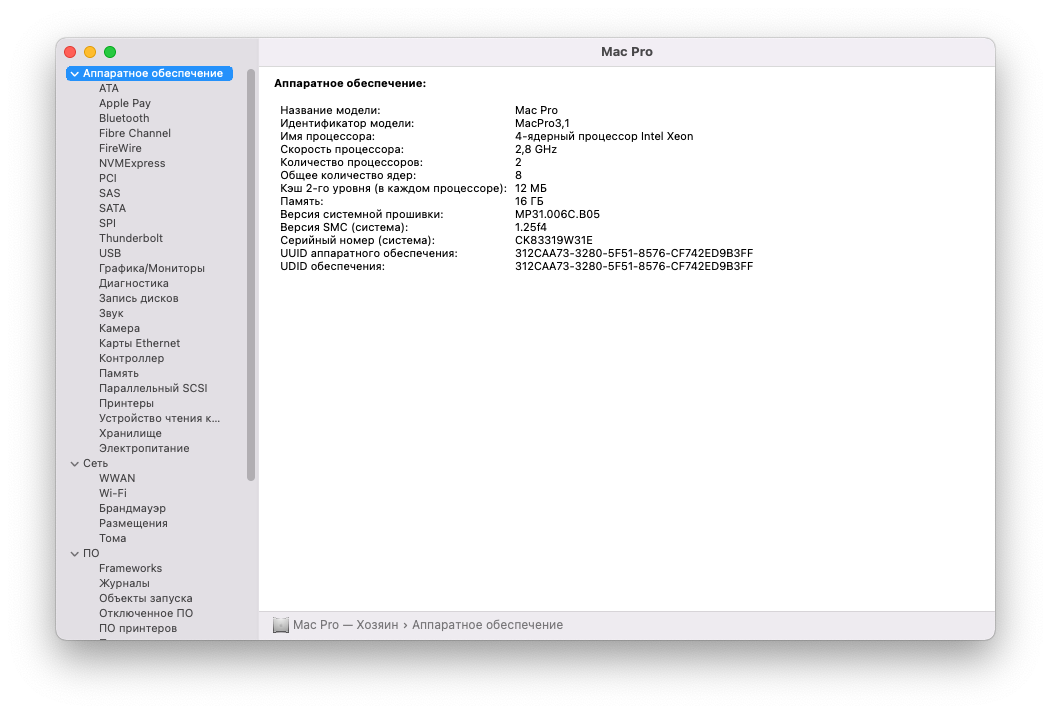

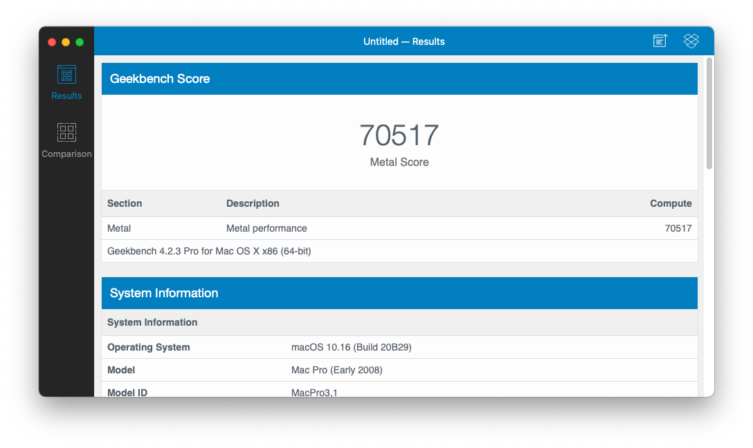

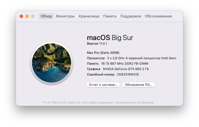

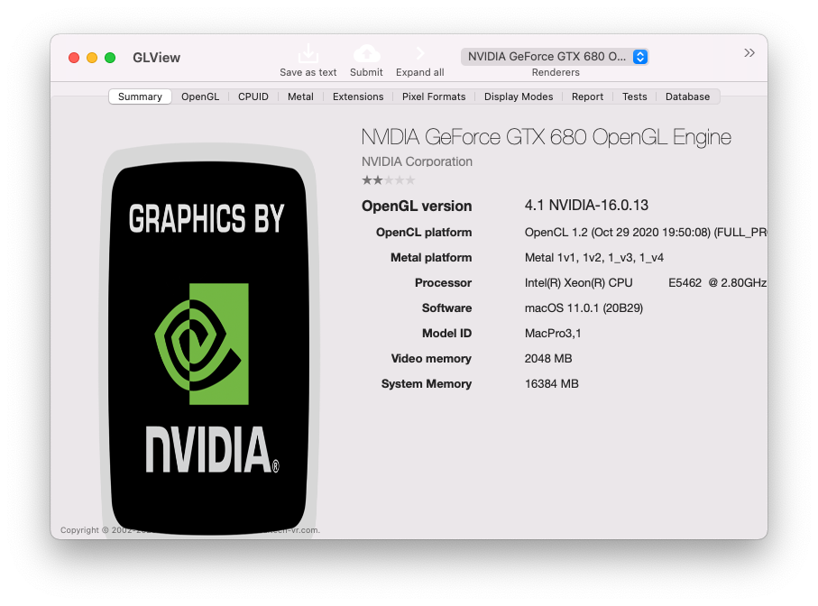

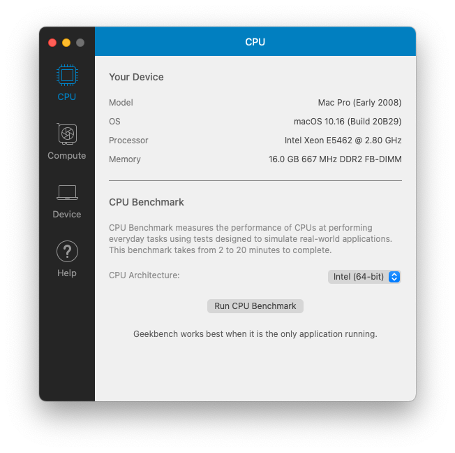

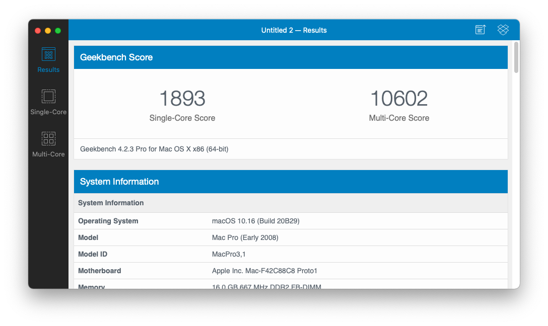

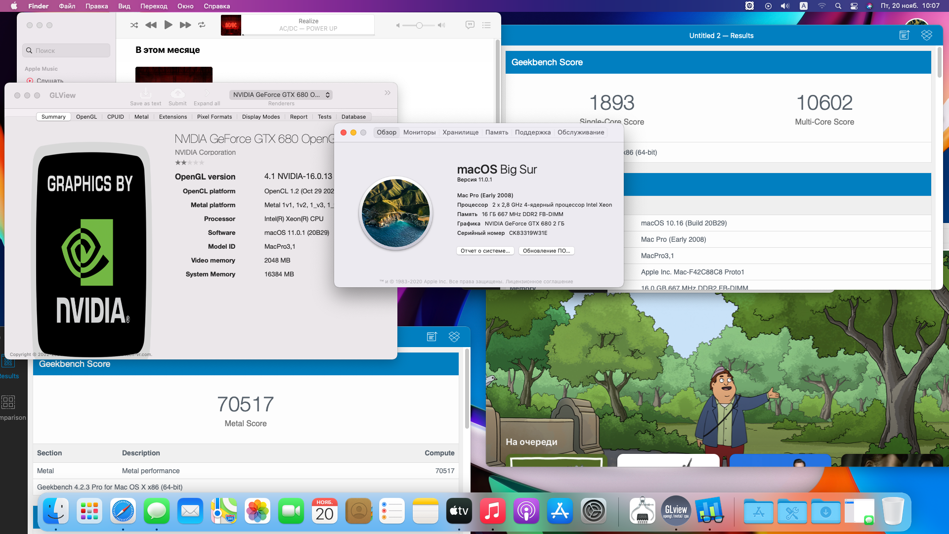

My second Bild of old Big Sur installation on Mac Pro 2008.
Mac Pro 3,1 (early 2008)
2xE5462 (QC 2.8)
4x4GB DDR2 5300F
NoNamed SSD 64GB
GTX 680 2GB (Flashed Mac EFI)
Installed by create partition on Hard Drive and creating install media, patching by Micropatcher and Jacklukem USB fixes 1 and 2.
After installation process, perform BigMac postinstall from MacOS Catalina and USB legacy patch from BigSurFixes Menu from Recovery mode (install media).
All work good!
Not opencored.
P.S. Old 2005 Bluetooth card should be removed.

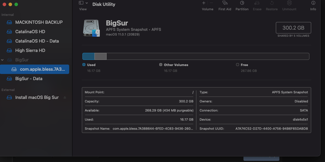

1. Ignore this snapshots
2. 2011 has two ports 0 and 1 with 6 gbit/s, check out system report
