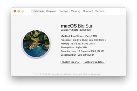

No issues. Micropatcher 0.4.4 with CoreBrightness added.

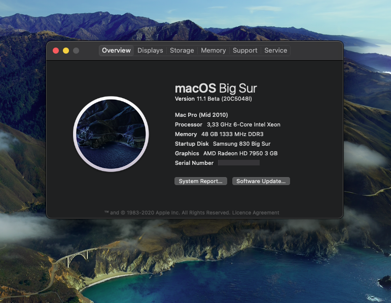

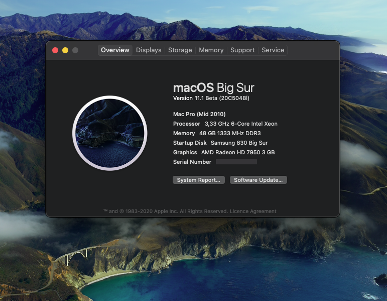

Updated from 20B50 to 11.1 build 20C5048l linked by @jackluke, on a cMP no issues at all with micropatcher v0.5.1. Same goes for my 2012 MB1 9,1. Have WiFi working on both.
I've checked briefly, most important feature request woul be a Softwareupdate fix for delta updates ofc. I remember with Catalina Patcher a fix came up after a few .xx point releases, still hope thats feasible. Also I'm missing Night Shift on the cMP but not the MBP. Just FYI @Barry K. Nathan, thanks for all you've done so far.
