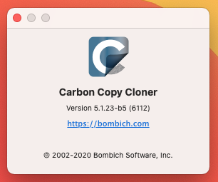

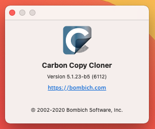

hi where can I download the beta version of CCC?
Do you have a paid CCC application on your hard drive (or SSD)? If so you can find the download from:
Launch CCC,
In CCC Preferences, at the top select Software Update,
Select "Inform me of beta releases" box, close the window,
Then under Carbon Copy Cloner in the menu, select 'Check for Updates...",
You should see the beta.

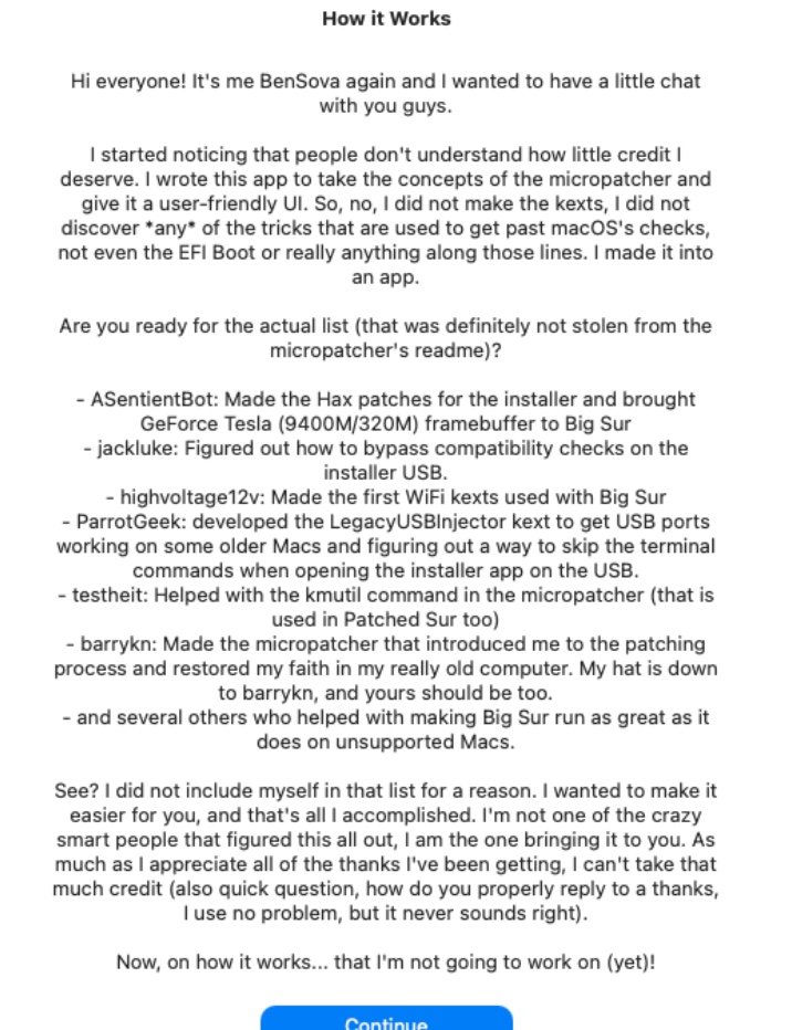

I don't know if it will work in your application but Bens patcher creates an app installer that runs the kexts

This is not a patcher, it is just a GUI to run the @Barry K. Nathan micro patcher. If something goes wrong you have to go back and read the real docs.
I realize that , I am referring to app for lack of a better word that Bens creates after it has installed Big Sur , it automates the process of the kexts
What Ben has done is make a simple GUI that is not available in Barrys patcher

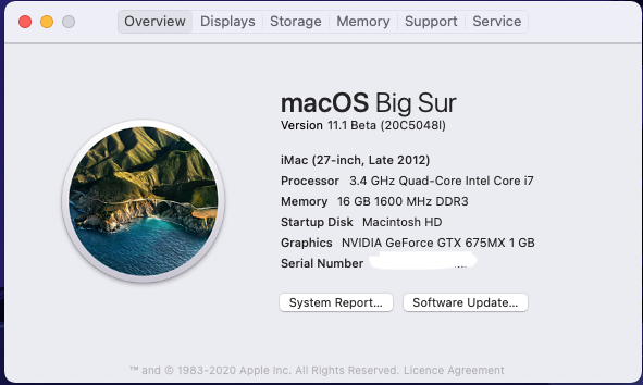

Download gibMacOS-master at GitHub. Run GibMacOS.command in Terminal. After switching catalogs you can look at the url, download the sucatalog, look at in TextEdit and search for the pkg.
And ... just to be precise, the version is Beta 11.1 (20C5048l). It is not a final release -- just the first of probably many betas for 11.1.
