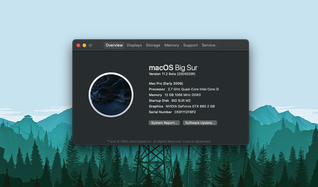

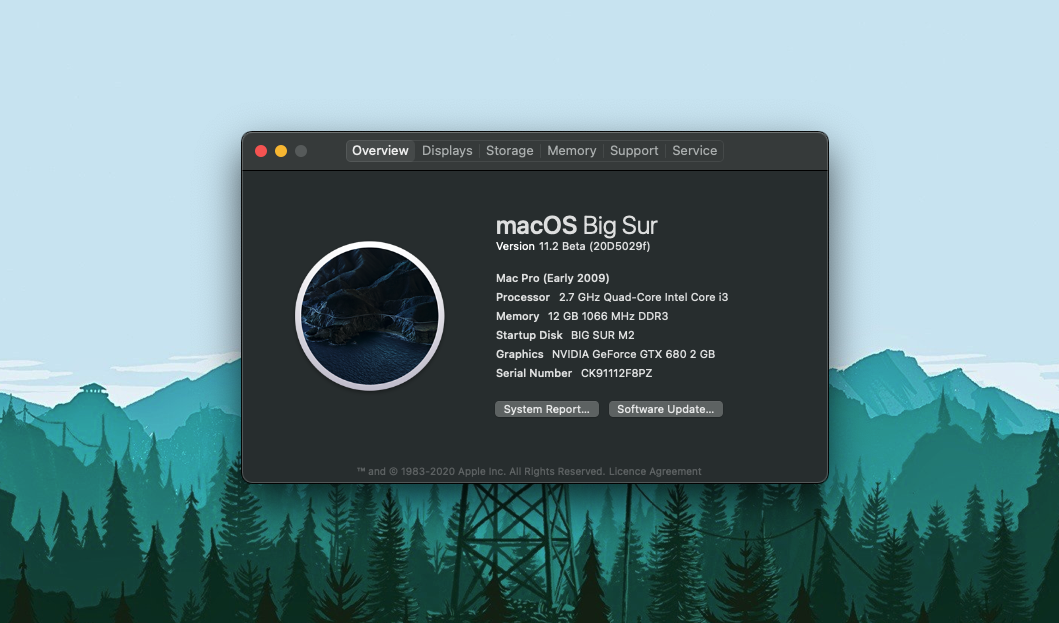

I vote for opencore, easy to configure, OTA updates with no VMM flag or spoofing with the correct package
Reactions: iMac-iPad
