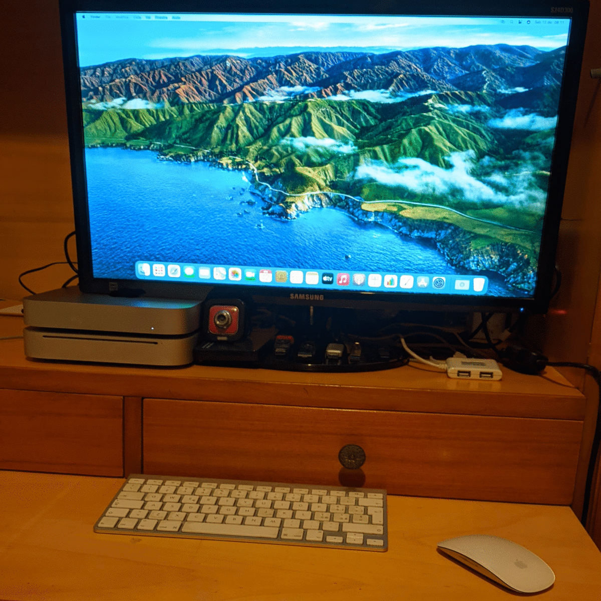

Happy Holidays @dosdude1 @jackluke @ASentientBot @Barry K. Nathan @parrotgeek1 Thank you for your valuable support as ethical hackers of Big Sur! My perfectly working iMac 2013 with masterfully patched Big Sur logic board is dead, ONLY due to a killer USB 3.0 7 ports Cinese Hub (according to Apple Store support, a damage of 600€!) so I have bought a Mac mini M1 that's incredibly fast and surprisingly compatible with Mac x86 and Windows 10 ARM x64 Insider Preview apps thanks to Rosetta 2, Parallels Desktop M1 16.3 preview and some very useful tricks that I have learned IN THIS FORUM :)
But I will continue to follow this trend hoping that one day my Mac mini 2010 Core 2 Duo Penryn will have accelerated graphic on Intel Big Sur.
