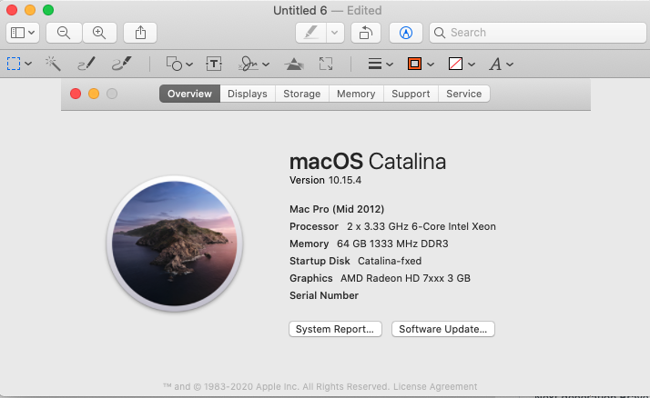

OBJECTIVES:
Assess the risk of upgrading my 2012 cheesegrater from Catalina to Big Sur.
Restore ability to boot to the startup disk manager
Restore ability to boot to recovery partition.
SITUATION
I am incredibly grateful for the fantastic support I got over a period of many months as I patched my 2012 cheesegrater to run Catalina. I used dosdude's patcher.
REASON UPGRADE TO BIG SUR IS DESIRABLE
Every now and then, I need xCode for something. My perception is xCode will not upgrade to most recent version unless the system is running the latest update of macOS.
REASON FOR HESITATION ON UPGRADE TO BIG SUR
I have held off pulling the trigger on updating to Big Sur, because I read somewhere that a possible result is irreversible damage to the UEFI, bricking the box. Bricking this box is not life and death for me, but close enough.
KNOWN ISSUES ON MY CHEESEGRATER
I cannot boot to the startup disk selector or the recovery partition. I can pick a startup disk from system preferences -> startup disk. I had huge scare where I picked a startup disk that booted into high sierra, but I could not remember the login password. I was saved by a hard drive with a partition I could boot into, by removing all the other hard drives.
Any recommendations or comments you might have would be appreciated immensely.
Thank you.

You should flash your graphic card, otherwise, it won't give you the boot screen, and the boot manager won't work (not even in blind).
You cannot boot to recovery partition for Dosdude Catalina. The recovery partition isn't patched, therefore, your cMP is not supported, and can't boot to it. This is the expected behaviour.
If you need to run multiple macOS (including Catalina or Big Sur), I highly suggest you flash your graphic card. Then install OpenCore to gain Catalina / Big Sur support. So that you can boot to their associated recovery partition.
Reactions: MacCanick
Ok, thank you for the tip. True that I have not been seeing the gray apple boot screen when starting up Catalina. I did not know that is significant. By flashing the graphics card, and enabling the boot screen, will I get access to the startup disk as part of that?
Thank you for explaining.
This I do not understand. I do not especially need to run multiple macOS. However, I have been doing upgrades of major releases, such as High Sierra to Mohave, as new installations on new partitions. I did that as protection, so I could boot to my known working version if something went wrong with the upgrade. That seemed the most sure-fire way to me. I changed that when installing Catalina, which went in as an upgrade to the mohave partition I had been running every day.
I had been depending on the ability boot into the startup manager, now I understand I lost that when I installed Catalina with the patch.
Once I flash the graphics card, I think I will be ready to install Big Sur. Do you know anything about the risk of bricking the machine in that process? Unless I learn it is a bad idea, my plan is to install Big Sur as a new installation on a new partition. I would be really really bummed if doing that bricked my box, now allowing a boot into the Catalna I have been running for that last 18 months (going back into Catalina beta.)
Yes, that's one of the main usage for flashing the graphic card.
If you do that via my OpenCore 0.6.4 package for cMP 5,1, should be very safe. Many users use that to install Big Sur already.
N.B. For your graphic card, you should flash it to gain the boot screen. My OC package aim at providing boot picker for newer AMD graphic cards on cMP.
