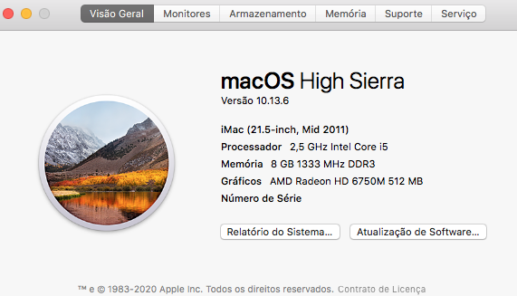

Hello everybody.
Please! Is there any way to install Big Sur on iMac Mid 2011?
AirPort Extreme (0x168C, 0x9A) Firmware: Atheros 9380: 4.0.74.0-P2P
Thank you!

Hello everybody.
Thank you!
No real chance! You can use patcher option #6 from the first post but since your iMac had never support by @dosdude1 with Mojava and Catalina the very same is true with Big Sur. The Radeon 6xxx series sucks. Stick with High Sierra or exchange your GPU - first link of my signature.

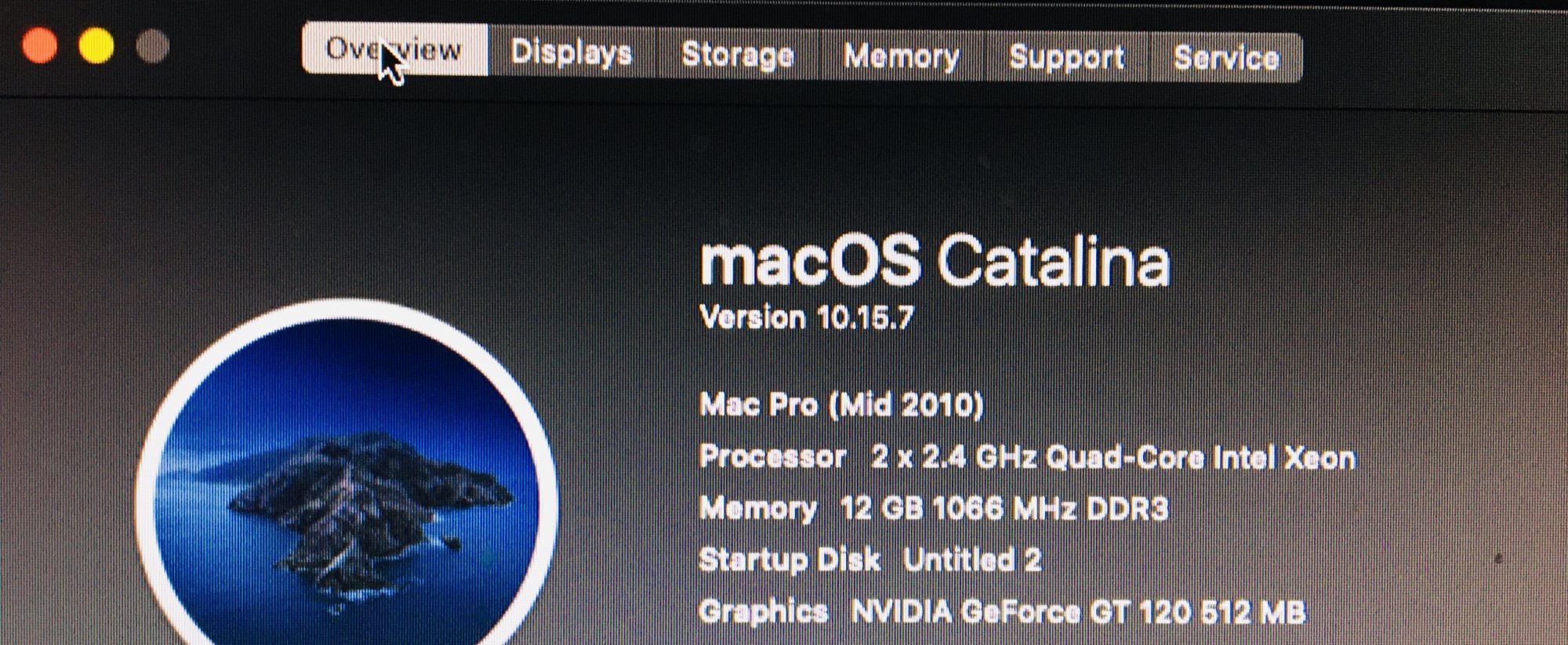

I have officially been boomed. Im going for Big sur on a gt 120 in a 8 core mac pro 5,1. Its running mojave decently fine (patched) rn. hehe gt 120 go boom

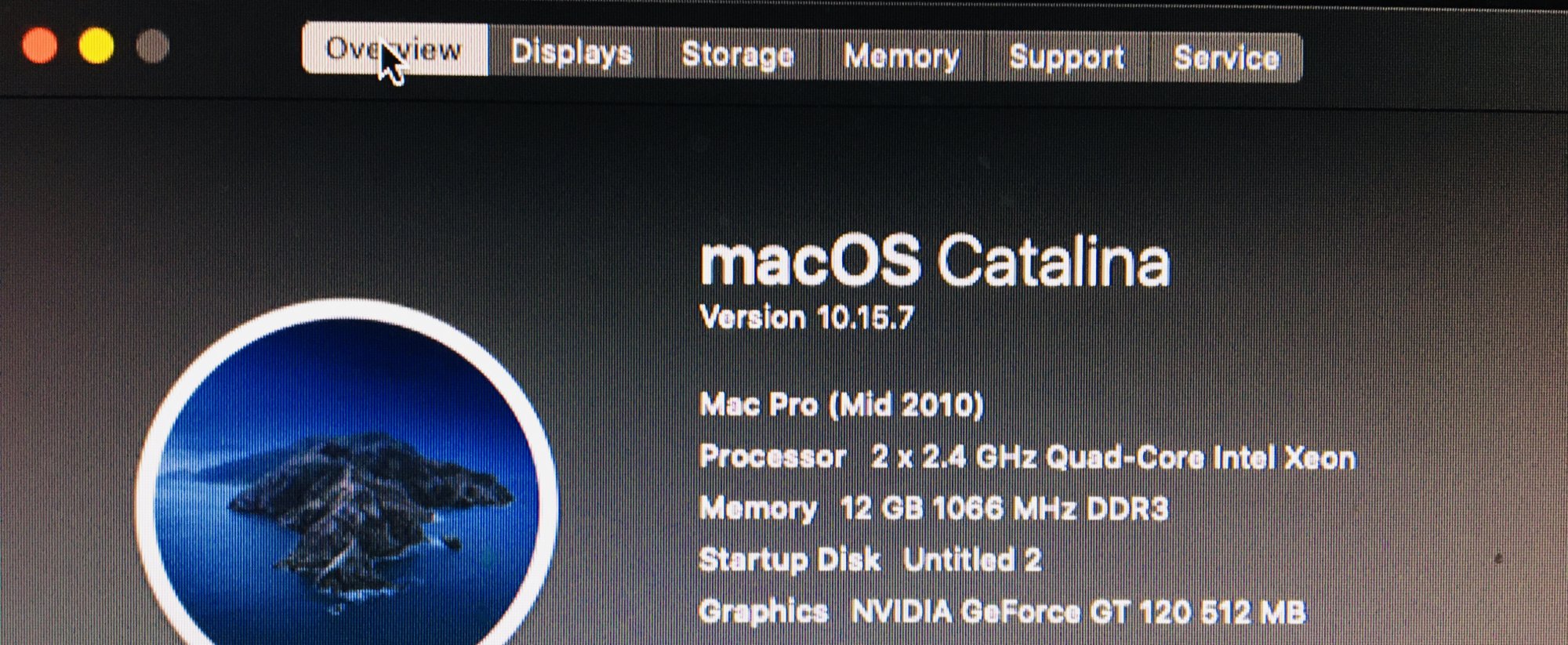

I did it!!!!!!!! I finally got Catalina installed on my Mac Pro 5,1, dual cpu, with the gt 120 😂, its actually running better then Mojave (patched) at this rate. I’m going for the big win with Big Sur on this machine.
Catalina, going for Big Sur next!
