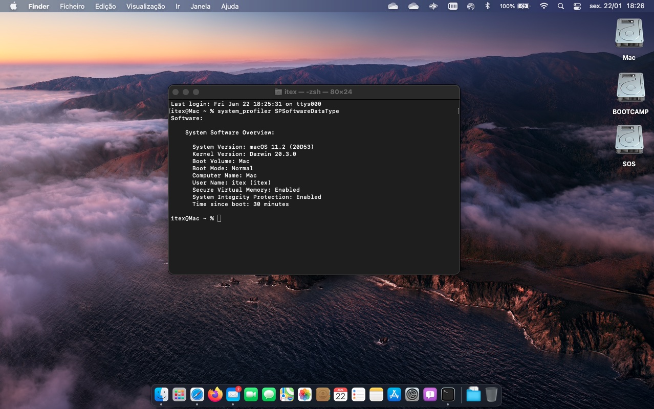

MBP 9,2 non-retina display, with opencore legacy 0.0.9 and OC 0.6.6 working fine macOS Big Sur 11.2 (20D53) until now the only problem is with boot-camp win10 audio not working all of the rest is perfectly working.

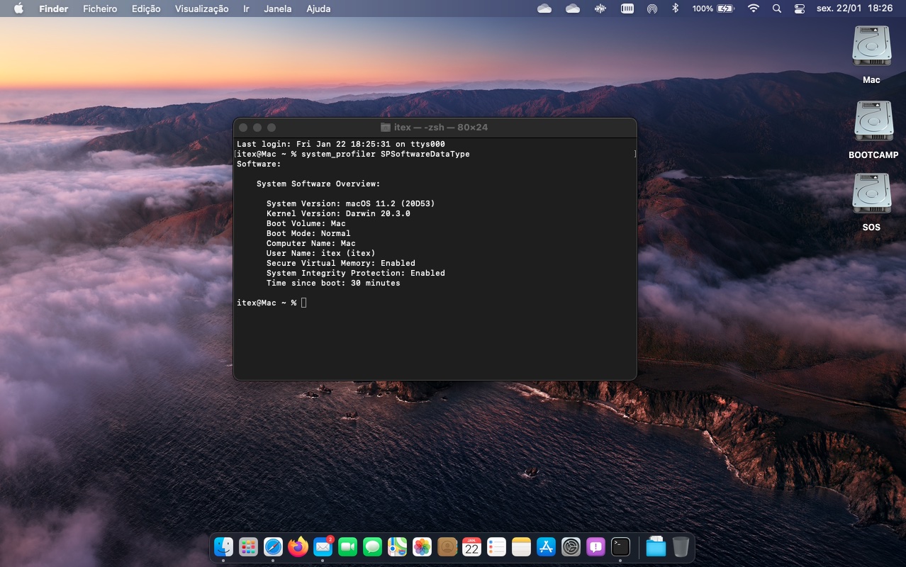

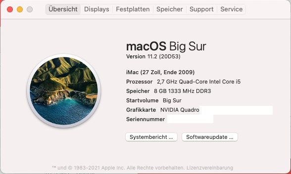

Micropatcher 0.5.3 using the integrated OpenCore option updated successfully (OTA) to Big Sur 11.2 (20D53). After completing the installation just called the patch script from the USB installer again:
Code:
/Volumes/Install\ macOS\ Big\ Sur/patch-kexts.sh --ns
The --ns just to enable Night Shift.
Edit: iMac 2010 and iMac 2011 updated the same way! Save your firmware before starting this :)

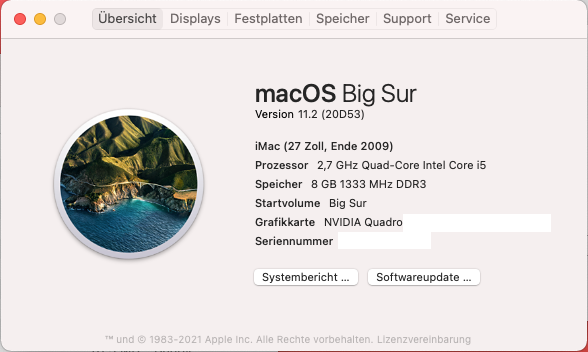

Code:
