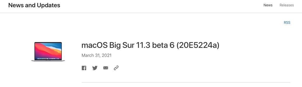

Reactions: StephN999
Updated to 11.3 Beta6 on Mac Pro 3.1 via OCLP 0.0.9 with freeze on self reboot about 2 times, after update works fine.
So it is doable with OCLP 0.0.9 on cMP 3,1 with GTX680 and BT/Wifi upgrade, despite the notes at the site saying an SSE4.2 CPU upgrade is required. Are there any special tricks to this?

Pri-est, where to get 0.0.9? The dev's github page only goes as far back as 0.0.12, or did you mean the latest 0.0.19?
Here's a link (12.23GB):
http://swcdn.apple.com/content/down...e2zfkdznl7cap9fo4j9wxoob/InstallAssistant.pkg

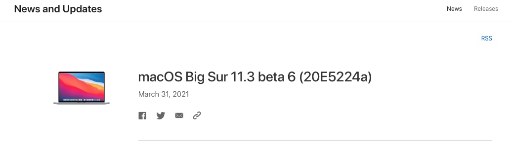

1. macOS Big Sur Beta 11.3 (20E5224a) - 071-21344 - Added 2021-04-01 17:13:31
Please report success, install method, and device info. Thanks!

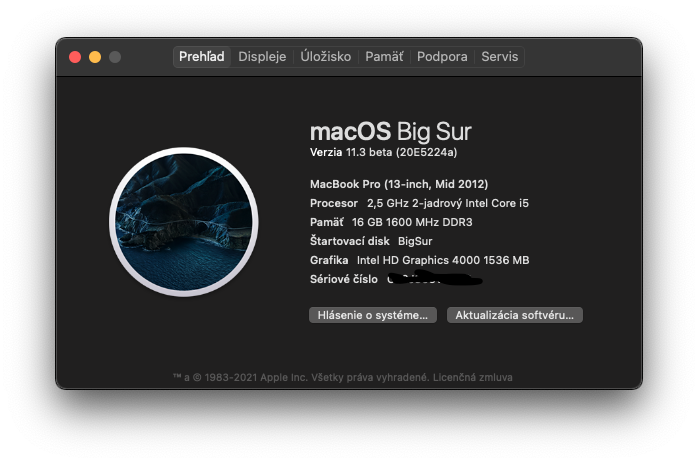

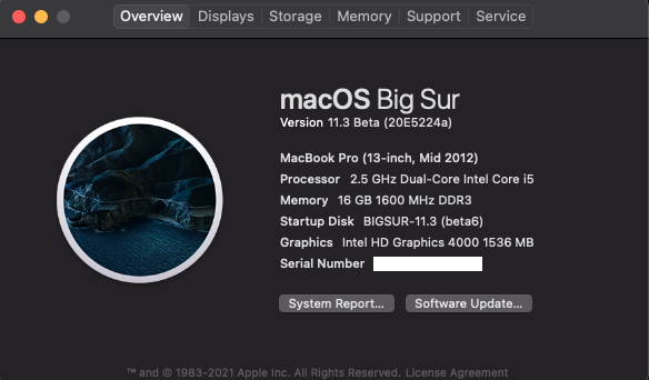

Hello,
I. *Reporting successful installation of Big Sur 11.3beta6 on late 2012 iMac 13,2 (1 TB Fusion Drive)
Method used: @Barry K. Nathan micro patcher 0.5.1 - see page 351 post# 8767 for installation details and cross-references.
Thank you to all developers.

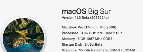

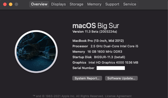

**Successful installation of Big Sur 11.3beta 6 on 17" MacBook Pro 5,2 (with internal SSD)
Method: BigSurFixes by @jackluke and @ASentientBot's Hax3lib - see page 351 post# 8767 for installation details.
All expected functions (for MacBook Pro 5,2) are available; graphic acceleration is still not possible.
Hope this data is of help

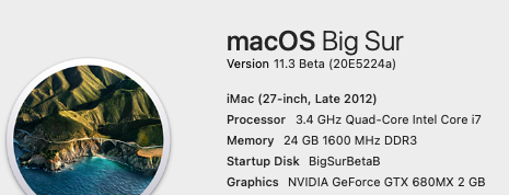

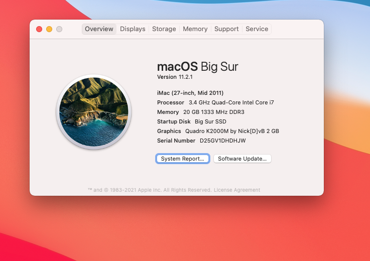

Okay y'all. Finally successfully patched Big Sur 11.2.1 on my 2011 27" iMac with a K2000m GPU. Lots and lots of trial and error, but the culprit was I had to use the internal monitor before the Big Sur Installer would initiate.

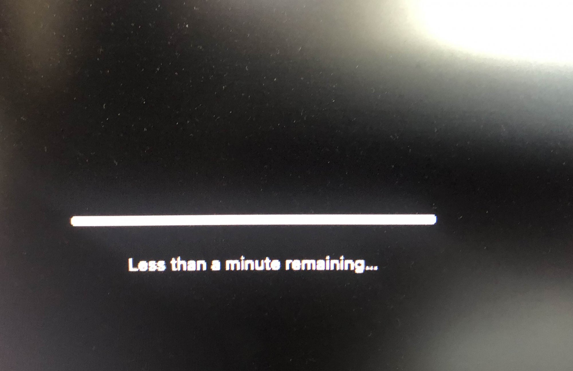

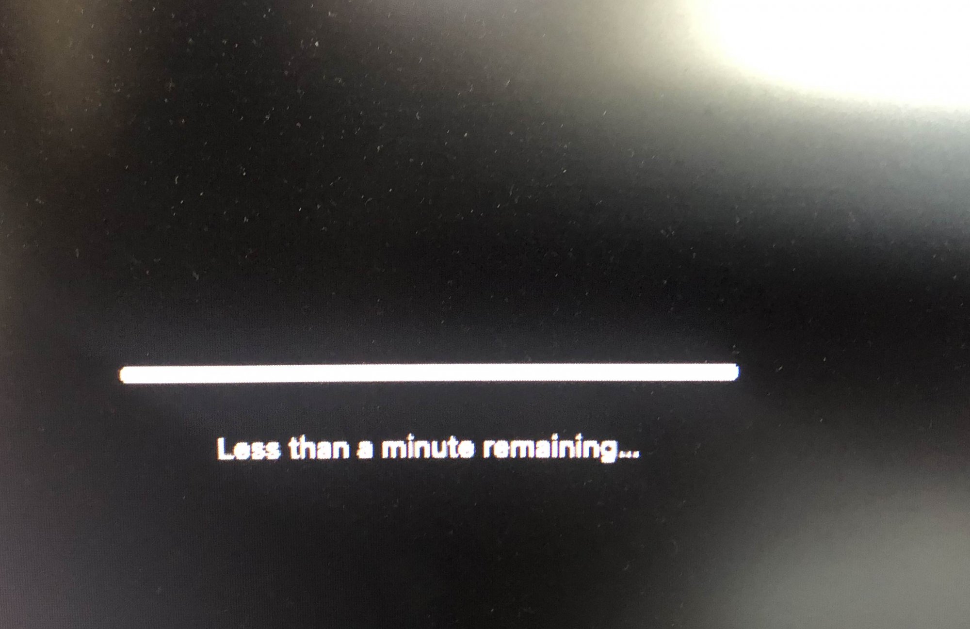

I finally managed to build an OCLP patcher for 11.3 beta 6 and have got 99.9% of the way through the install on the classic MacPro 3,1 listed below but it has apparently stuck at Less than a minute remaining...
This is the second try; the first time it did this I waited about 30 minutes but nothing happened, so I rebooted but the install destination disk was not visible as a Startup disk and nothing I could do with Disk Utility on another Mac would make it so.
How long should I wait at this screen before assuming it's frozen?
That makes some sense.
When doing this kind of thing, good idea to present as basic hardware config as you can:
- single (in-built) monitor
- disconnect external disks (accessories) that are not required
- use hardware keyboard, mouse
Reactions: 0607557 and Linburn
APFS Snapshots can take quite some time to be sealed, and if a user interrupts the process it will break the installation most likely. Generally recommend 1 hour for installs and sometimes more as Apple seems to heavily rely on AES for snapshots and crawls on older hardware because of this. Updates should be a decent bit faster however really depends machine to machine. My recommendation is leave it for 45min-1h before assuming it's stuck
For those curious, no OCLP cannot disable APFS snapshots. We require them for seamless OTA updates and best security practices

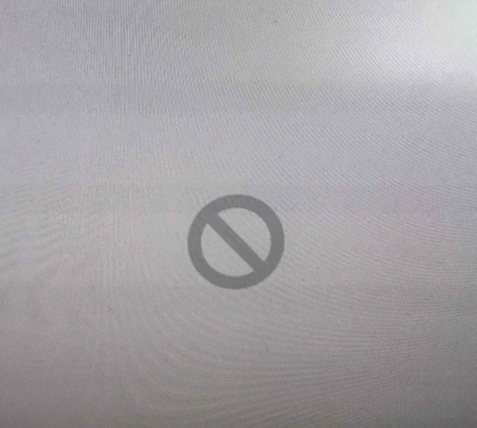

Thanks khronokernel. After waiting 2 hours and seeing the following, a few more reboots (3 or 4) got it to desktop,
Now to run post-install patch.
