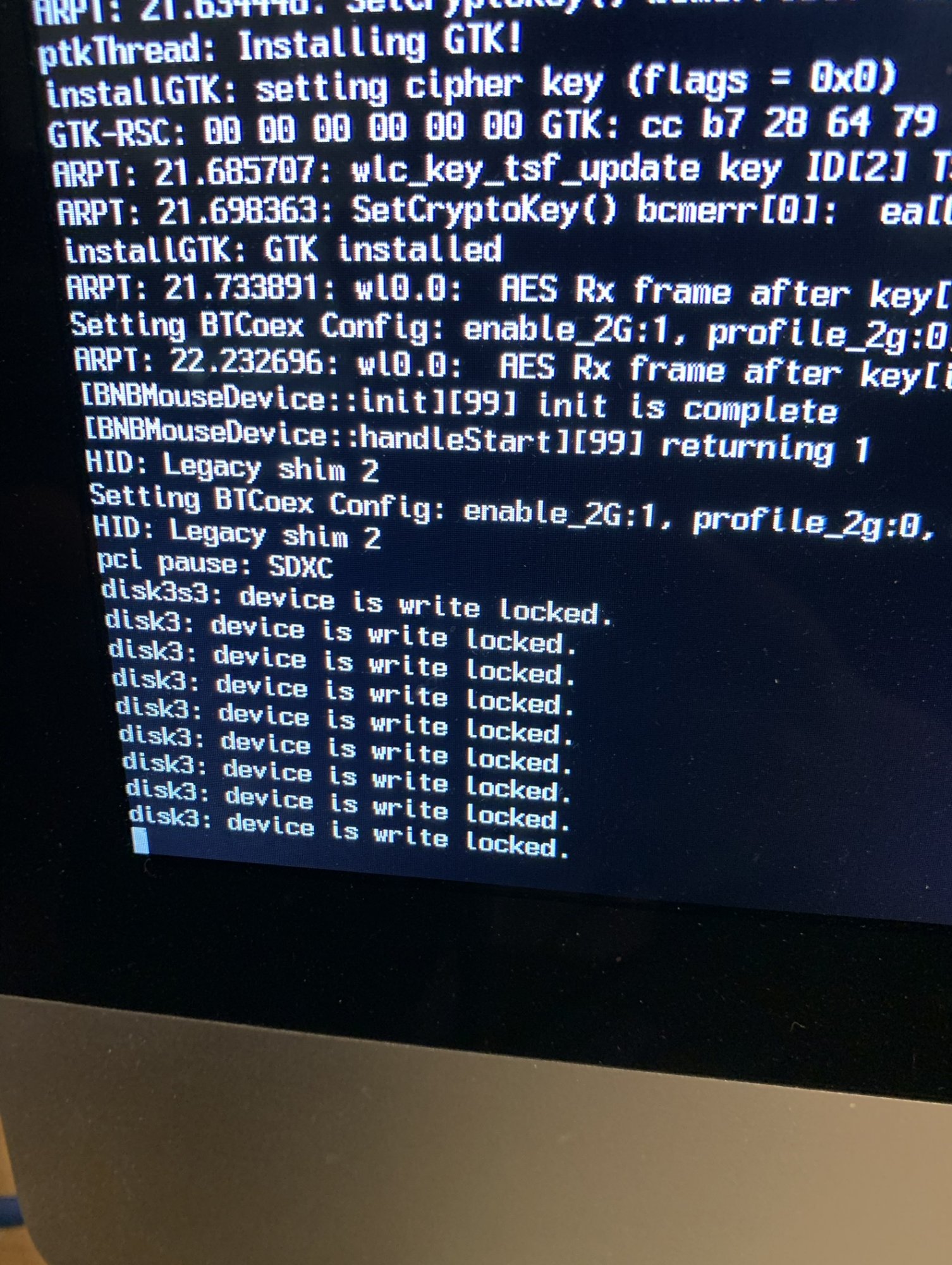

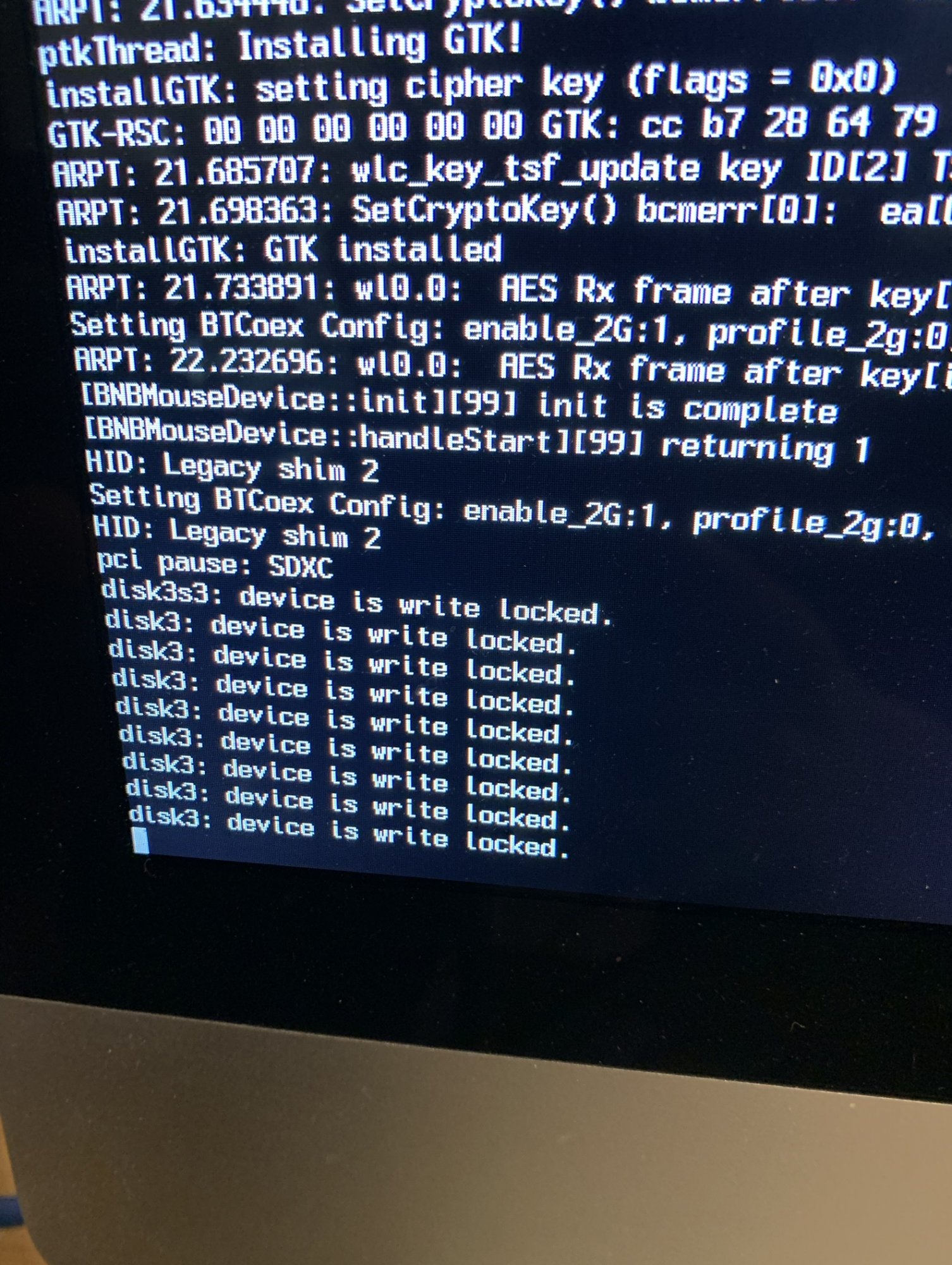

Anyone know why I am getting this error? I’m using the OpenCore Legacy Patcher. It has been sitting like this for over an hour now. It was stalling on the apple logo with the loading bar so I enabled verbose to see if I could see what the problem is and that is what I see. Any ideas? I have 2013 iMac (iMac14,2)

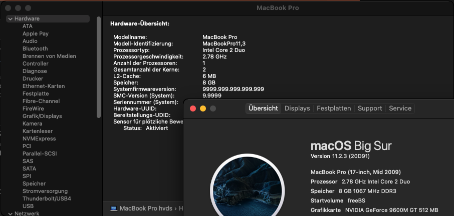

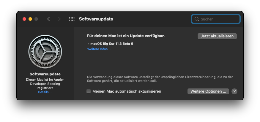

Installed 11.2.3 on a MBP5,2 with OCLP 0.0.21.
Smooth installation, booting, running on this LegacyUSB machine which now "feels" like a MBP11,3 as intended.
Clean installation on an external (USB) SSD. Migration assistant done OK.
OCLP is on a USB pendrive made from Catalina.
Installer made with createinstallmedia from Catalina, also on external (USB) disk.
Verified that I can boot back to Catalina which is my production system on internal SATA SSD.
Thank you!
Next step is to update OTA to 11.3b6, and more tests.
(as always of course, no graphics acceleration on BS).
