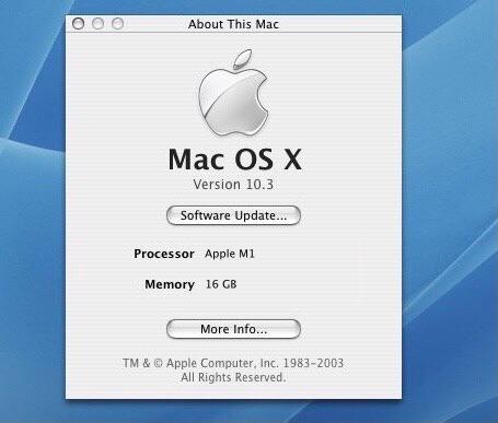

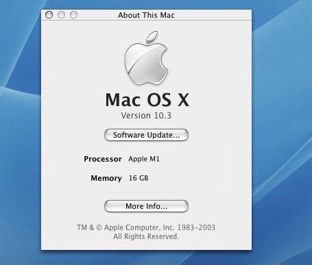

Thank you to all who make this forum work! Here's some nostalgia to remind us how far we've come: 10.3 to 11.3!
Yeah! Did you know I still have the install CDs, the first Mac OS X I bought for my iMac green, the original system was OS 8.6 in a 32MB CPU that I expanded to 256MB. I always loved to give extra life to old macs, Apple must love me... XD
  • Haha
Reactions: iMac-iPad
