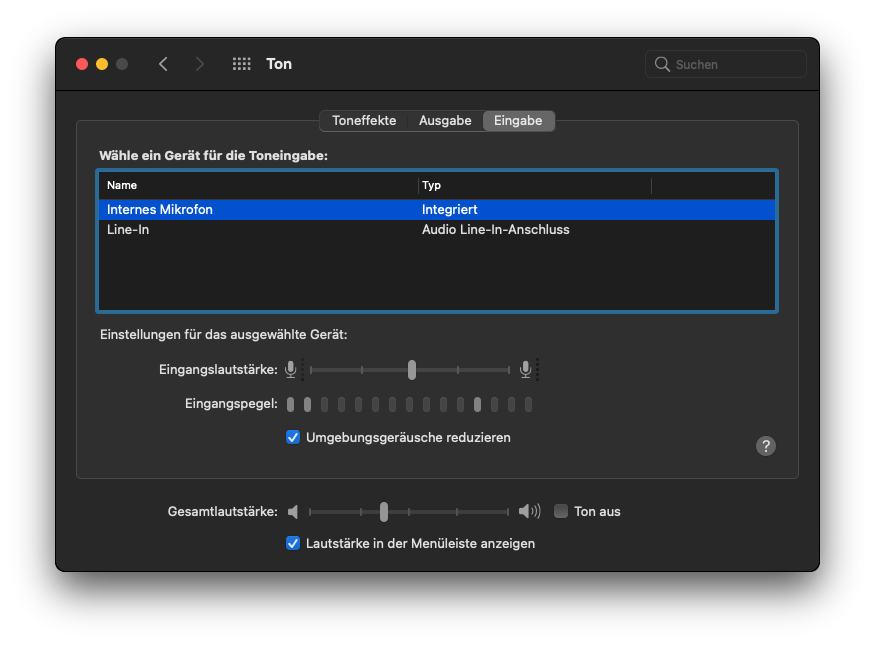

AppleALC is excellent, sounds amazing in quality🔉

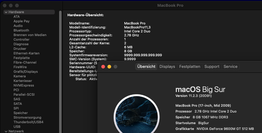

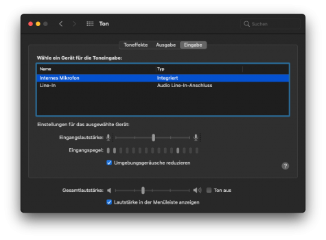

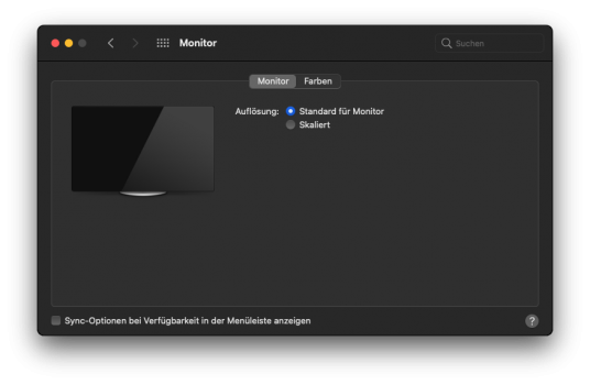

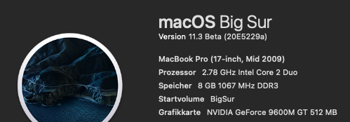

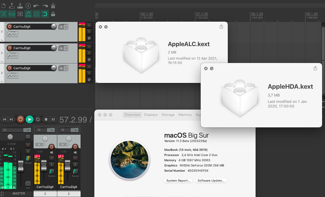

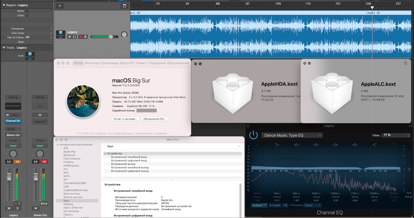

MacPro3,1 and MacBook7,1 downloaded InstallAssistant for macOS 11.3 20E5229a Beta 7 created a USB flash drive and installed it on top.
Thank you dosdude1, khronokernel, Ausdauersportler and authors developers, I only admire you🙌😊
Our favorite hobby gets even more interesting✨

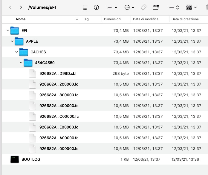

A) Thank you for your suggestion, @Ausdauersportler, I did it :)

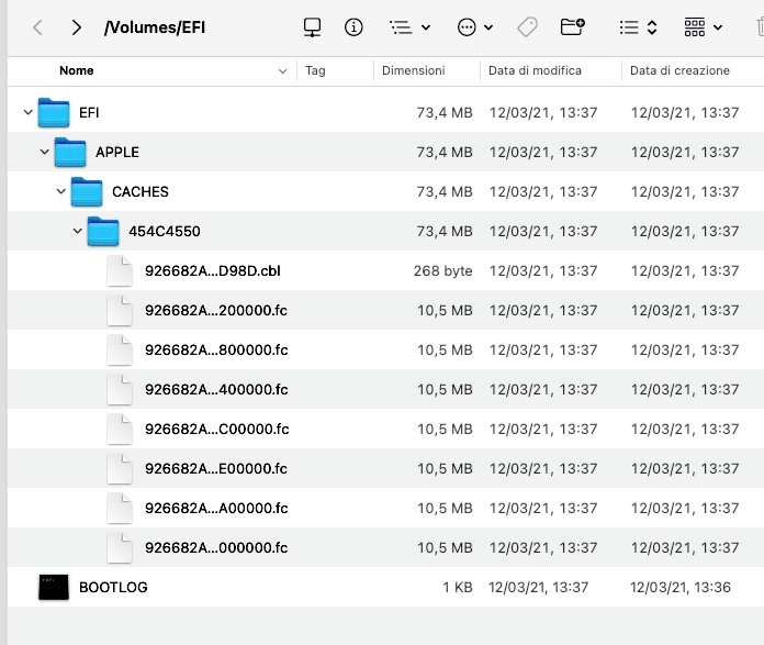

B) Uhm... You make me think... Initially I created a single APFS partition on external SSD, named "MacIntosh HD" and installed Big Sur with Micropatcher 0.5.1. After verifying that Big Sur was working fine, I disassembled the iMac, inserted the SSD with Big Sur in place of Fusion Drive's mechanical HD and, of course, I doesn't recreated the Fusion Drive again. After mounting the SSD and rebuilding the iMac, so, Big Sur booted-up fast on the first power-on. [Of course, I see also the internal 128GB Apple SSD now on Desktop, which used to belong to Fusion Drive and I use it to store the Windows VM and other files.]
Later, if you remember, since I was missing Recovery Boot, Safe Boot, etc., thanks to you ;) I found the courage to switch from Micropatcher to OpenCore Legacy Patcher. So! I created an installation USB key (original and unpatched), I reinstalled Big Sur with OpenCore Legacy Patcher EFI (I believe 0.0.12) and since then I have replaced the EFI partition with latest OCLP Main Build, almost every day. Do you think that doing so did not overwrite all the Big Sur installed with Micropatcher and so I should reformat the SSD newly, then redo a new installation with OCLP, from scratch?
The mystery is that Photo Booth sees and uses only two Effects (Quartz) while does'nt sees all the other Quartz effects. Friends who have replied to my post so far have the NVIDIA 775M card while mine is the 780M. Could it be that Big Sur's KEXT does not enable something on my 780M card and therefore there is incompatibility with many Quartz effects? Do you thinks I can try to activate OpenCore Legacy Patcher option 5: "Force iMac Metal Patch" or I could try other options? (e.g.: non-minimal SMBIOS, etc.). Obviously I tried to copy all the files *.qtz of the Quartz effects from the System/Library/Compositions/ folder to the Compositions folder of MY_HOME/Library/Compositions or to /Library/Compositions/; I also tried to create a new User, I tried to reset SMC and PRAM, etc.
C) I have a single OCLP (OpenCore) version installed in the EFI partition of internal SSD, totally dedicated to Big Sur as an original Mac. However I mounted all EFI partitions and found that in EFI partition of the 128GB Apple SSD (empty, without OS) there was an EFI folder and a file called "BOOTLOG" of which I copy the text here. I am also attach a clip of this EFI Folder. I obviously deleted both (EFI and BOOTLOG) and restarted the Mac, but Photo Booth always behaves the same way. What do you see from this BOOTLOG? We hope to solve this the Quartz's mystery :)
Code:
SlingShot: Starting Local and Network Diags/Recovery Session at 03/12/2021  14:36.
SlingShotL8LocalBootSetup: Didnt find a recovery partition for startup disk, startup disk may not be set, (Not Found)
NetworkFinishOSRSHostInfoLookup: Resolved OSRS Hostname [osrecovery.apple.com] to 17.164.1.12, Port 80
GetStationAddressViaIpAgent: Client IP Address: 192.168.1.33
GetStationAddressViaIpAgent: Client Subnet Mask: 255.255.255.0
GetStationAddressViaIpAgent: Router IP Address: 192.168.1.1
GetStationAddressViaIpAgent: DnsServer 0 Address: 192.168.1.1
NetworkFinishOSRSHostInfoLookup: Resolved DNS Address on interface with address 192.168.1.33
NetworkFinishOSRSHostInfoLookup: Got 2 Network Interfaces.
NetworkFinishOSRSHostInfoLookup: Handle 0 was used for successful DNS resolution of OSRS.
SlingShot: Got OSRS Info: Hostname osrecovery.apple.com, Host IP 17.164.1.12, Port: 80
SlingShotSetupAuthParams: Got MLB SN 'C02412601ABCD3EFG' (Note that I modified SN for privacy)
SlingShotGetRecoveryType: Error getting RecoveryType (Not Found),
NetworkResolveDomainName: Resolved IP Address for 'oscdn.apple.com': 104.77.185.58
DownloadChunkedAsset: Downloading 48 chunks.
SlingShotUpdateProgressUI: 30 sec avg 24 KBps, 6625 KBps new total, last total 0 KBps, now 3312 KBps
SlingShotUpdateProgressUI: 30 sec avg 1495 KBps, 8342 KBps new total, last total 8488 KBps, now 8415 KBps

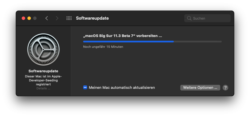

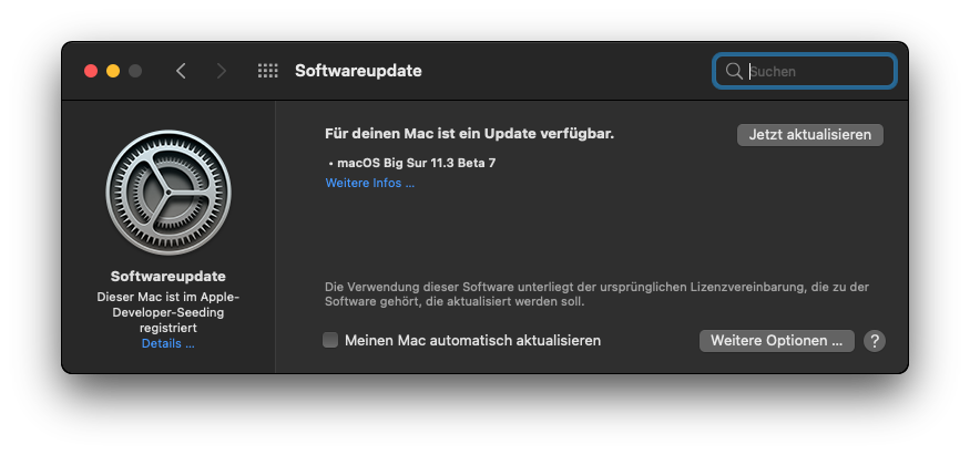

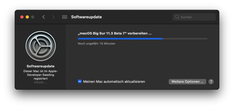

Successfully OTA updated 11.2.3 to 11.3b7 on MBP5,2.
Was using 0.0.21 first for b6 and b7. Installation seemed fine both cases, but couldn't boot into updated BS. Did boot fine now with 0.0.22 (without repeating OTA installation).
Although already successful, exercised OCLP release 0.0.22 a bit further on MBP5,2.

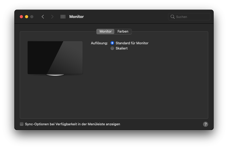

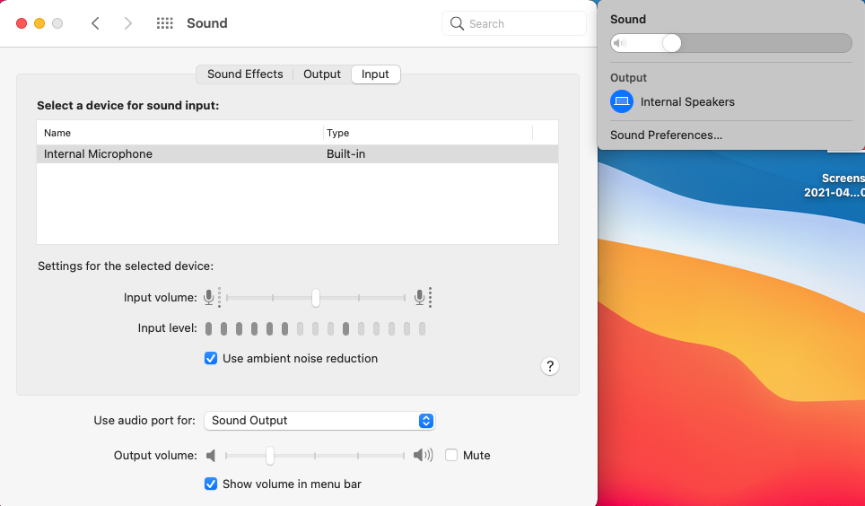

All involved media on USB (stick with OCLP 0.0.22, 11.2.3 installer, SSD with two separate partitions for BS).
1) installed 11.2.3 with OCLP, over an existing 11.2.3 made a while ago with jackluke's BigSurFixes (option 3 of other patcher options in 1st post). That worked well, subsequent OTA update to 11.3b7 did install, but couldn't boot; as also suggested in the README of 0.0.22. But maybe I just wasn't patient enough.
Could not install 11.2.3 over it, neither with OCLP nor with BigSurFixes. Then erased this partition.
2) clean install of 11.2.3 with OCLP with full migration of data/apps from Catalina 10.15.7. Worked well, afterwards OTA update to 11.3b7. Installed well, subsequent booting apparently hang for >1hr. Rebooted via OCLP, came a bit further according to progress bar, but hang again. Proceeded to login the third time.
Internal audio working OK.
3) clean install of 11.2.3 with OCLP to the other partition without migration, works well, subsequent OTA to 11.3b7 installs well, hangs once during booting, proceeds to config screens 2nd time.
No graphics acceleration of course, and Monitor Panel of system settings incomplete.
Good that OCLP works so well nonetheless with the MBP5,2. THANKS!

Updated to 11.3 beta (latest) using OCLP (0.0.22) without issue (I had issues with not writing the EFI update to internal drive thus needing the external USB, but once updated the OCLP config to the internal drive, all was well).
