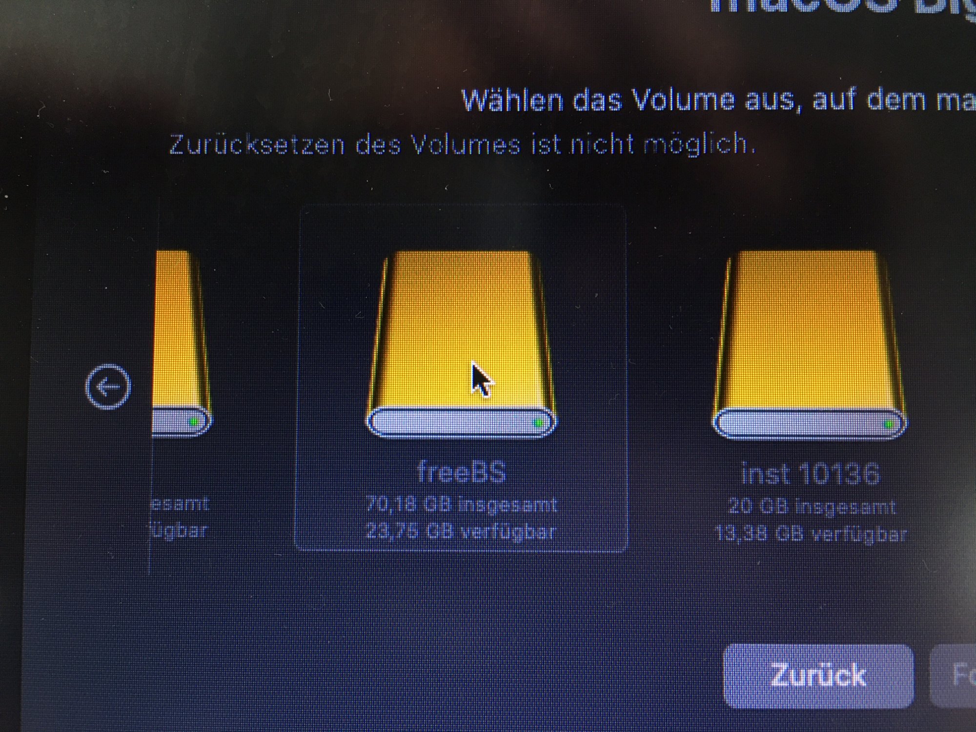

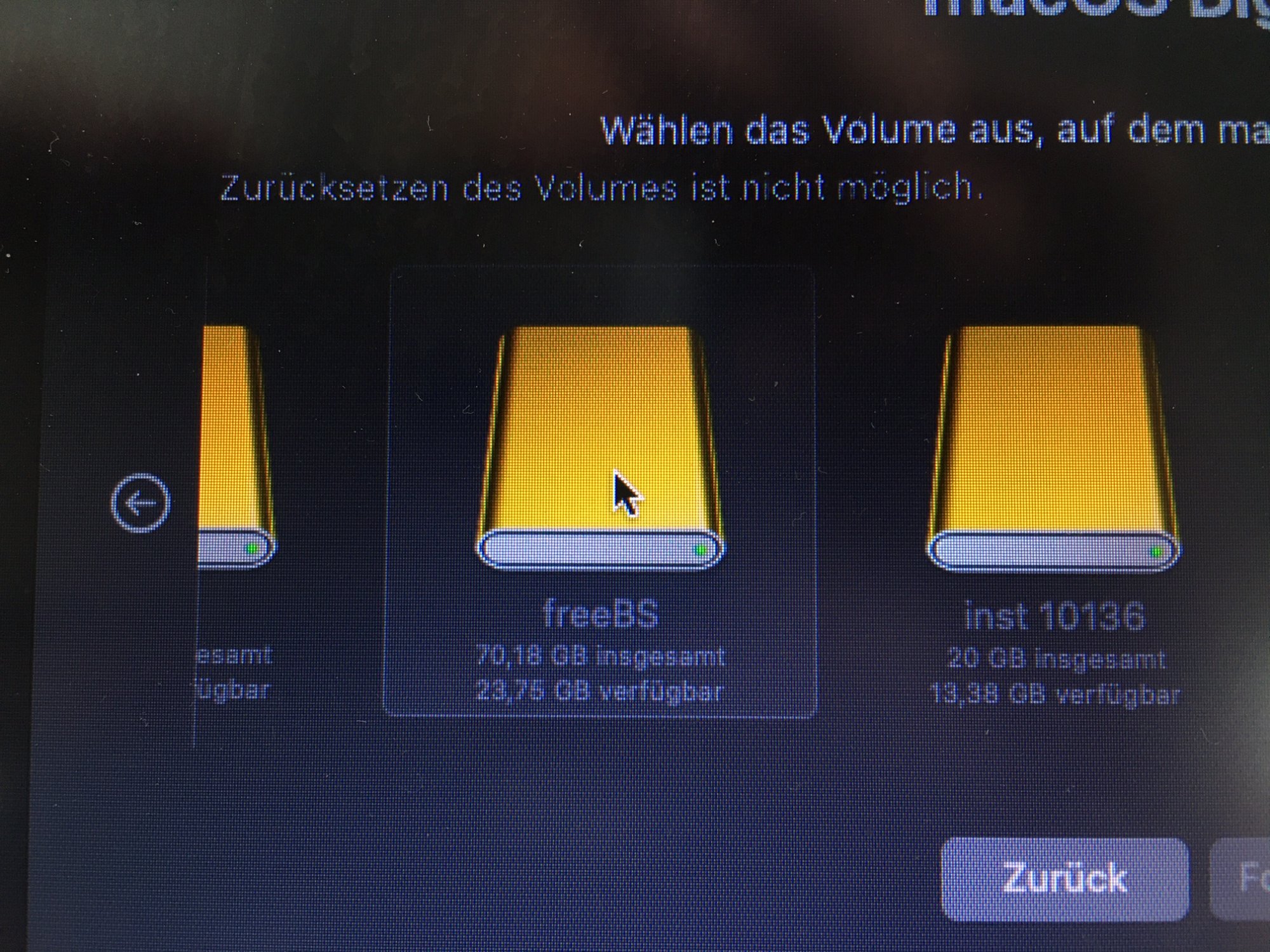

One more test, regarding the installation of 11.2.3 over 11.3b7.
Now that I have two working BS partitions with b7, ran the installer for 11.2.3. Both partitions are not available for installation ("resetting the volume is not possible"). This is when booting the installer via OCLP 0.0.22 or when running it via jackluke's BigSurFixes.
Made a new installer with createinstallmedia from 11.3b6. Booting this with OCLP, it now shows the two BSs as available for installation.
It seems one cannot go back from 11.3b7 to 11.2.3, at least on my setup.
Doesn't matter, just wanted to report.
It only mattered for me when I had the non-bootable b7 installation which I couldn't revive with 11.2.3 and had to erase (installing b6 over it with OCLP from full installer also led to a non-bootable system; but I may have been not patient enough, more booting attempts could have helped).
That is not possible unless you have another Big Sur 11.2.3 partition. You can install/overwrite it from there. You can't do it from recovery or from a USB installer. You may try installing from Catalina or an earlier partition. I haven't tried that yet.
Reactions: Ausdauersportler
Thank you, didn't know that one cannot do it from a USB installer. I'll give Catalina a try which is my main OS on the internal disk.
EDIT: it seems the BS partitions on the USB disk are not visible to the installer when running it from Catalina.
The next option then is to have a minimal 11.2.3 installation and run the installer from there. Will try this for future fallback needs.
EDIT2: made a clean installation of 11.2.3 on a small partition on my BS USB SSD. I confirm that when running the 11.2.3 installer on this 11.2.3, it sees the other partition which has 11.3b7. So could have installed 11.2.3 over it (but didn't).
IMHO a downgrade of an existing installation per es never worked and was never planned to work. I was recently really surprised that one can install the same Big Sur version (11.2.3 in that particular case) over an existing one preserving all user data and setting using the USB installer.
Yes, that works.
I did exactly that with 11.2.2 when swapping from micropatcher across to OCLP.
It is covered in OCLP guide. The wording maybe a bit vague on that.

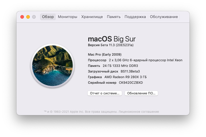

Updated to macOS 11.3 Beta 8 20E5321a; no problems

Do you all mean 11.3 Beta 8 20E5231a and not ...321a??? I had show up for mine and applied OTA (thanks to previous OCLP), had to boot initially from EFI to allow the upgrade to proceed and tada!!! No issues thus far...
Reactions: Pri-est

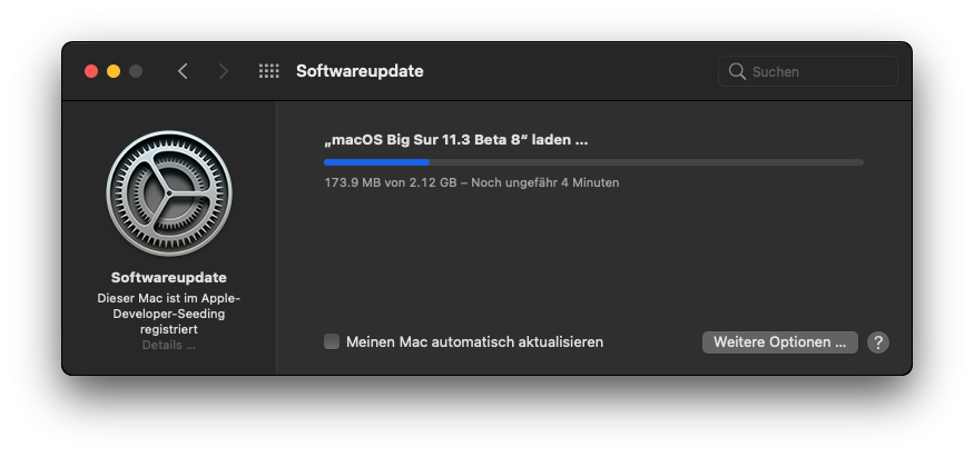

I just successfully OTA upgraded from 11.3 beta 7 to beta 8 (with OCLP 0.0.22) but when I first set-up this cMP3 I installed the patched efi partition to a USB stick, which is now required for booting. Is it possible to retrospectively apply the patched efi partion to the internal Samsung EVO SSD so the USB stick is no longer required? I tried but got an error saying report to the devs.

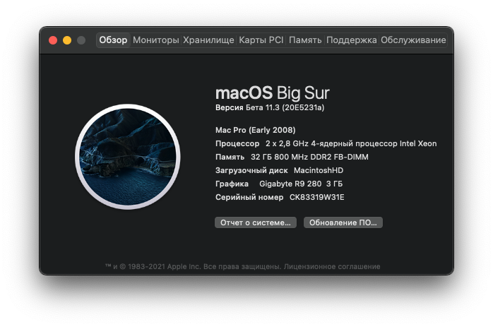

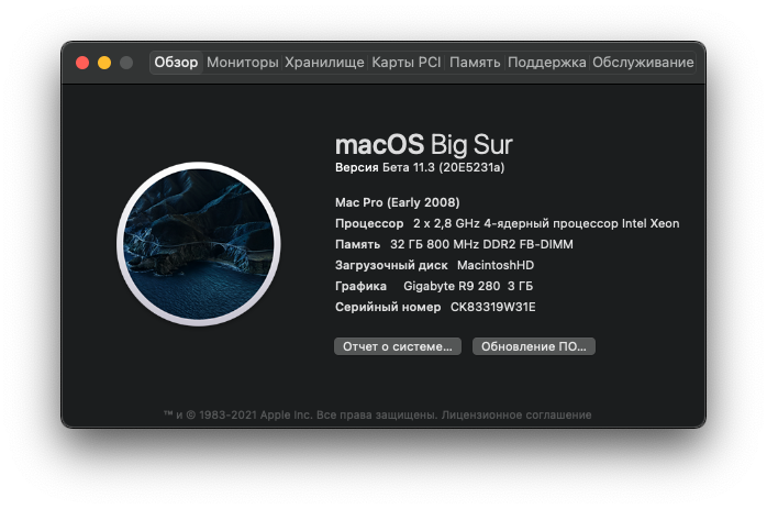

Successfully Updated 11.3 Beta 7 to 11.3 Beta 8 (20E5231A) on Mac Pro 3.1 (early 2008) using OCLP 0.0.22
Without Issues.
Mac Pro 4.1 Updated with one freeze after 1st reboot. After Update all works fine! (OCLP 0.0.22)
Greate work Guys!
Without Issues.
Greate work Guys!

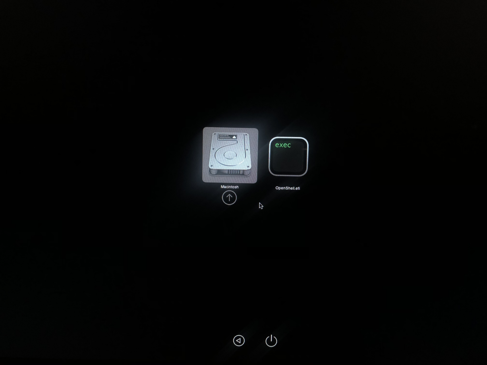

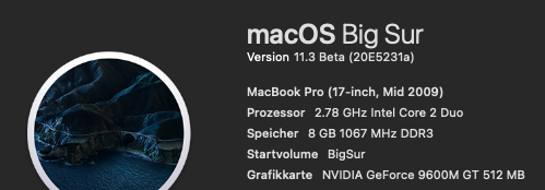

Also here on MBP5,2, successfully OTA updated from beta 7 to beta 8. Using OLCP 0.0.22. Target SSD is on USB.
One extra reboot (power off, Apple boot selector, OLCP) needed in last step of installation after hang, and one during booting the installed system.
Thanks to OCLP makers and supporters!

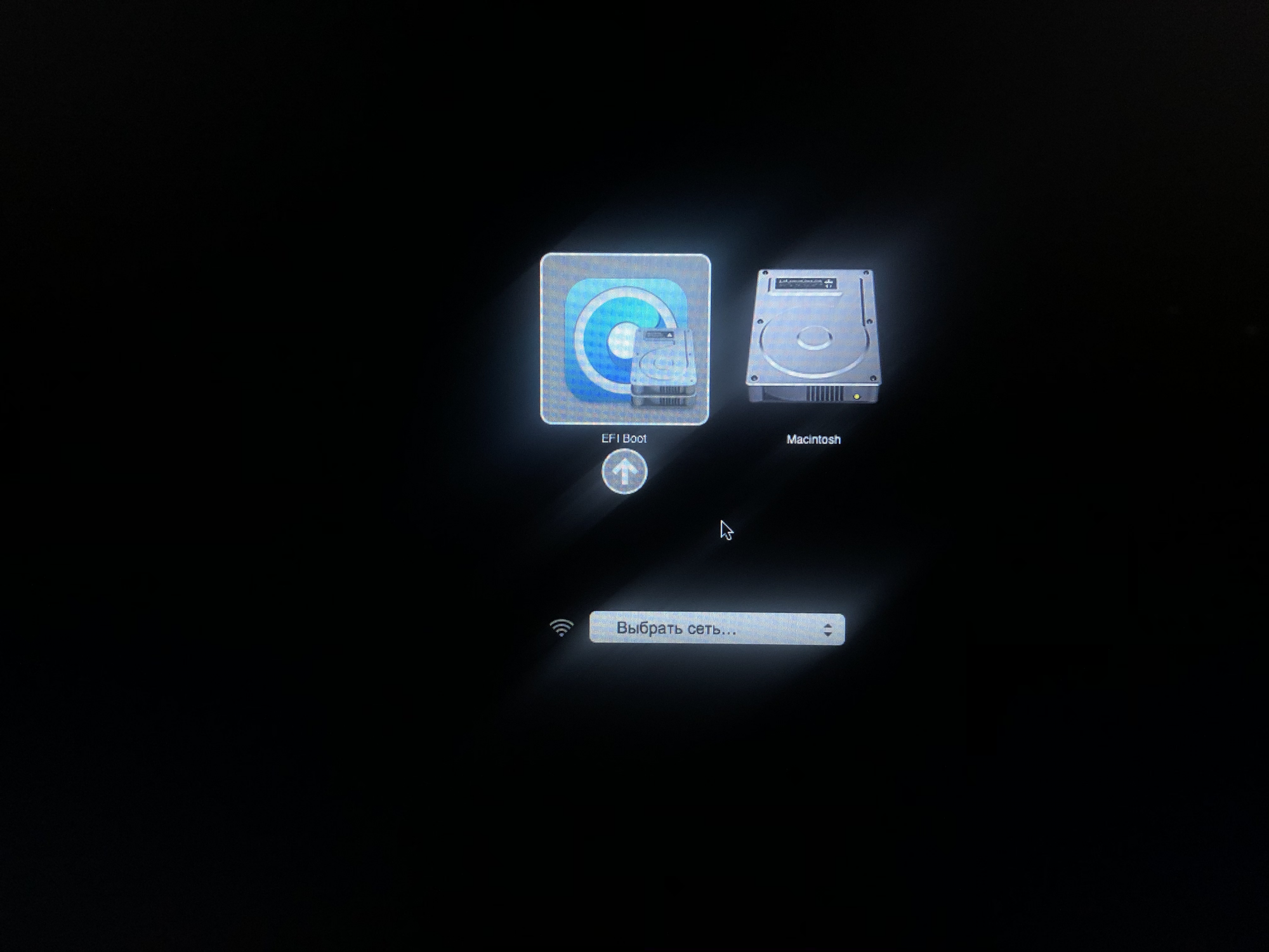

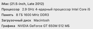

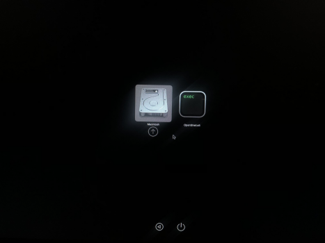

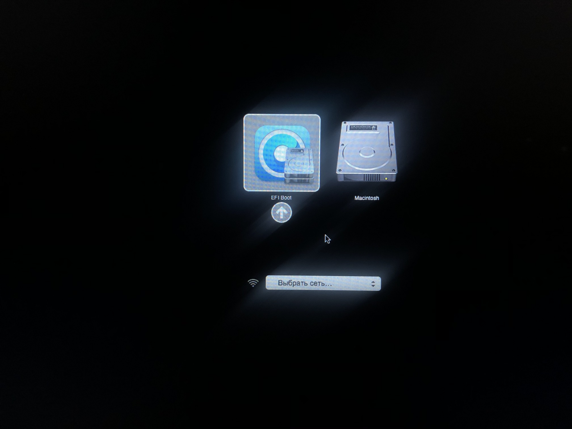

Hi guys,
I'm trying to install Big Sur 11.2.3 on my iMac 13.1 via OCLP 0.22, but I cannot start the installation process from the bootable USB. When I click on the "EFI Boot" I don't see an option to "Install Big Sur".
Maybe you know what's wrong?
Step by step:
- I use 32GB USB, GUID, Mac OS Extended
- Downloaded MacOS and made a bootable USB via Termnial
- Downloaded OCLP and 1) build Opencore; 2) install opencore to USB
- Restart iMac with the option button
- Select "EFI Boot", but then I don't see an option to launch the Big Sur installation process.
I'm thinking about reinstalling Catalina and trying to install Big Sur on the "clean" machine.
Any ideas and thoughts are highly appreciated.
Thanks!

Hi guys,
I'm trying to install Big Sur 11.2.3 on my iMac 13.1 via OCLP 0.22, but I cannot start the installation from the bootable USB. I click on "EFI Boot" and I don't see an option to "Install Big Sur". Maybe you know what's wrong?
Step by step:
- Downloaded MacOS and make a bootable USB via Termnial
- Downloaded OCLP and 1) Build Opencore > 2) install opencore to USB
Thanks!
Generally if you cannot see the Big Sur USB in the mac's native picker then that means the USB either is broken or the installer was corrupted during flashing
I would recommend redownloading macOS and trying on a new USB
