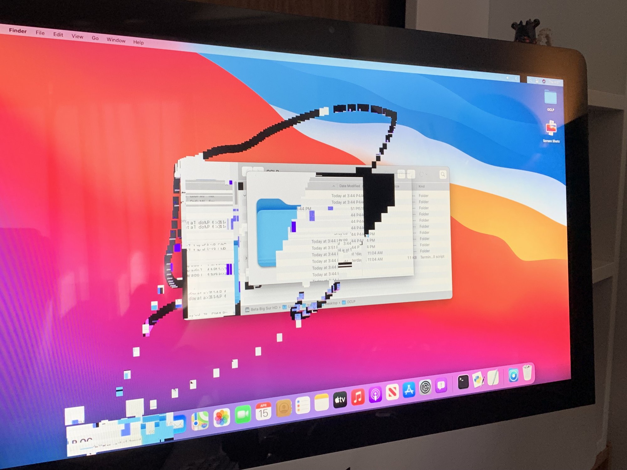

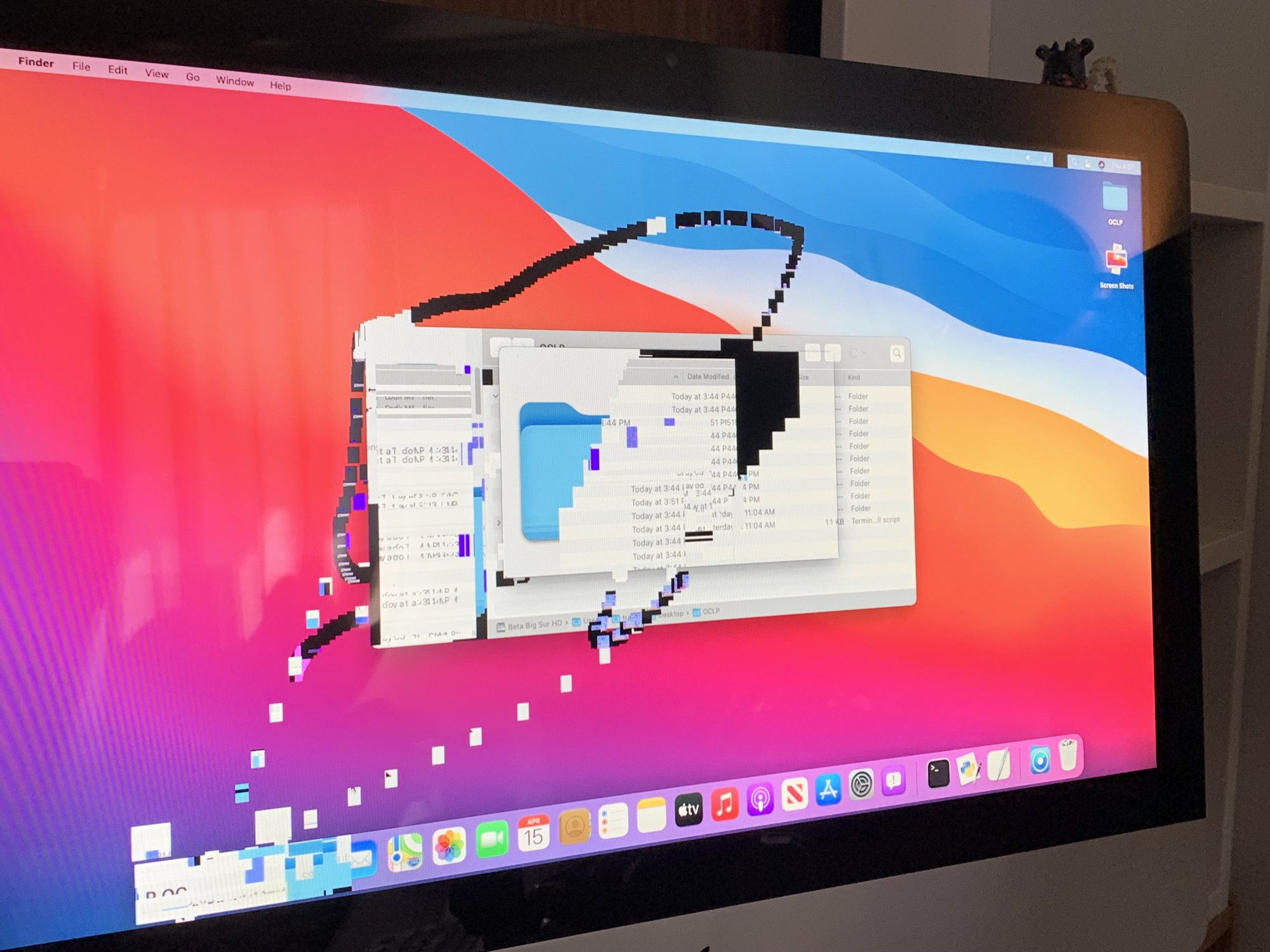

Acceleration patches are not public, and likely won't be for another few months. We highly recommend users with non-Metal GPUs to run older OSes such as Catalina or Mojave
Even once acceleration patches do release to the public, we do want to ensure everyone's expectations are low. It will be worse than Catalina, there will be a lot of visual bugs and stability is still unknown.
For example, this is what happens when you sleep wake with an ATI/AMD GPU with our current private acceleration patches:View attachment 1758524
Already looks good (despite the wake-up flaws), I´m not shocked at all but pleasantly surprised instead. Keep going! ;-)

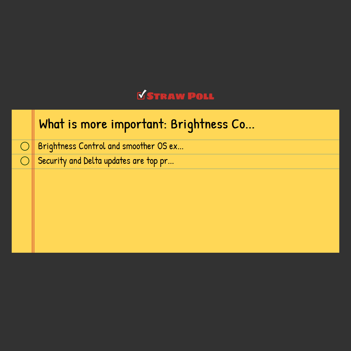

Hello everyone, with OCLP v0.0.23 right around the corner we decided to hold a poll regarding how defaults should be handled for non-Metal GPUs.
Currently, OCLP defaults to SIP and OTA Delta update support for all models and requires users to manually disable these options in patcher settings if they desired root patching (ie. brightness control)
With 0.0.23, we've added the framebuffers for legacy GPUs allowing brightness control support for the majority of machines however this comes at the cost of SIP and Delta update support. The biggest benefit for adding these framebuffers of legacy GPUs is providing better overall cursor and OS usage. Note that this is still unaccelerated, and will still be unbearable compared to Catalina and Mojave's current acceleration state.
So we ask:
Would users prefer brightness control and slightly smoother OS usage or delta updates with all the bells and whistles of SIP, AMFI, etc?
Please respond to the straw poll below:
To clarify, the above settings are merely defaults. They can be override by the end user. We're mainly trying to decide what the default logic of OCLP should be
Reactions: iMac-iPad
When installing a new OS, probably want SIP and OTA updates enabled, then when the updating is done, switch to better Framebuffer, and repeat occasionally.
SIP and OTA updates remains the default for metal GPUs? So maybe should be the default of other GPUs too.
Maybe I would have an OpenCore partition for each. Does OpenCore work well from an HFS+ partition (HFS+ is read-only in EFI so logs and screenshots would need to go to a FAT or EFI partition)? I prefer HFS+ because Startup Manager will show a disk label + icon instead of "EFI Boot" + icon.

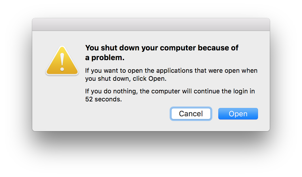

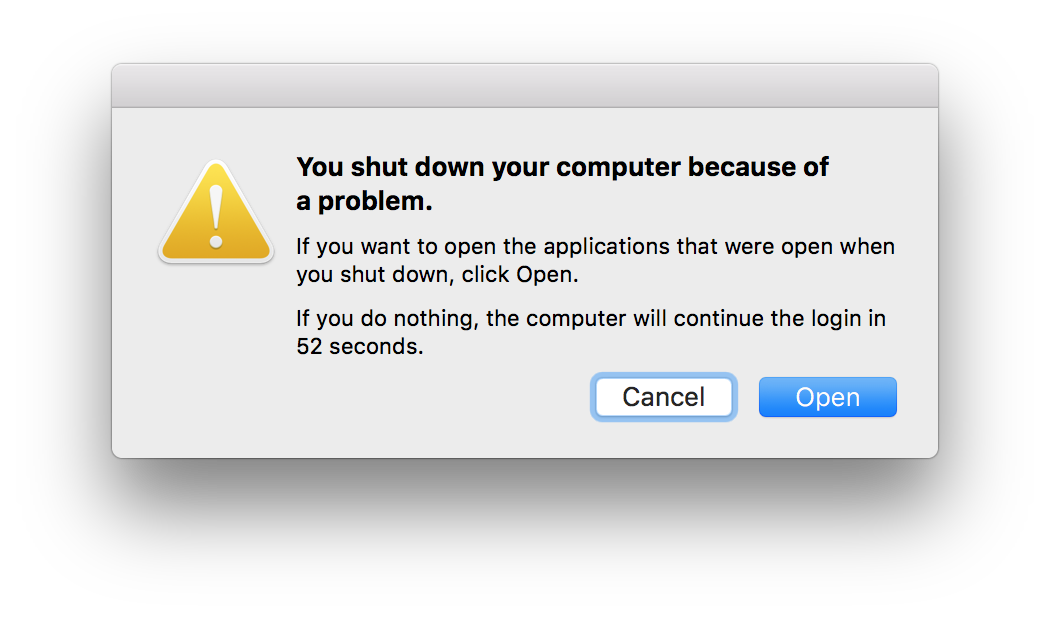

Every time I close my 2012 Air and open it up again, I get this message. Is there a way to fix it?
I installed Big Sur through OCLP and also patched the EFI to boot without an USB drive.
I believe @A4orce84 had a similar issue?

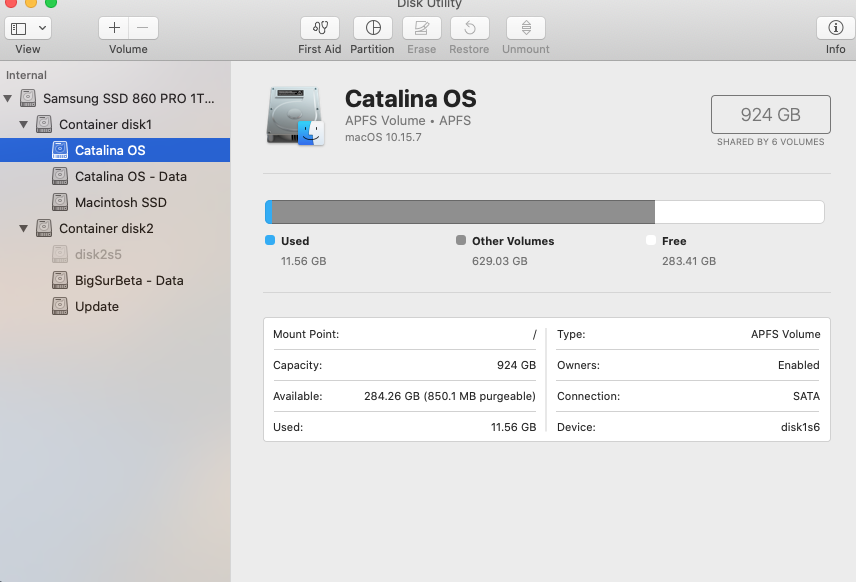

MacBook Pro 5,2 (17-inch, Mid 2009)
3.06 GHz Intel Core 2 Duo
8 GB 1067 MHz DDR3
NVIDIA GeForce 9600M GT 512 MB
Samsung SSD EVO 860 1 TB — two partitions: 1st has Catalina and Mojave OSs installed, 2nd has Big Sur.
Hello,
In spirit of feedback and testing ...
Installed 11.3 beta8 with OCLP 0.1.0:
Installation of the OS was similar to experience described in post #9678 above.
There was an improvement in rate of account set up, due to (now) active framebuffer(?)
Currently functional are sound control, key brightness and iSight camera.
Still Unavailable are screen brightness control and choice of screen resolutions.
Overall, after OS finishes the usual post-install housekeeping, and system animation is disabled, the response and usability almost rivals that of OS installation via BigSur BaseSystemFixes.
Hope this may be of help.

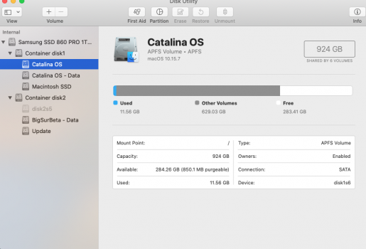

An addendum:
Just booted into Catalina and found that Big Sur partition does not show up on the desktop, nor is it visible via disk utility menu. Booting back into Big Sur requires OCLP EFI boot process; selecting Big Sur in Apple Picker leads to prohibitory sign. The degree of lag also varies while moving through Big Sur. Unless something unusual occurred during installation, it would seem that OCLP 0.1.0 still needs some "tweaking", at least for my machine(?)
Attached: screen shot of disk utility listings from Catalina OS - note: container 2, is the partition with
BigSur installation (currently missing from listing)
