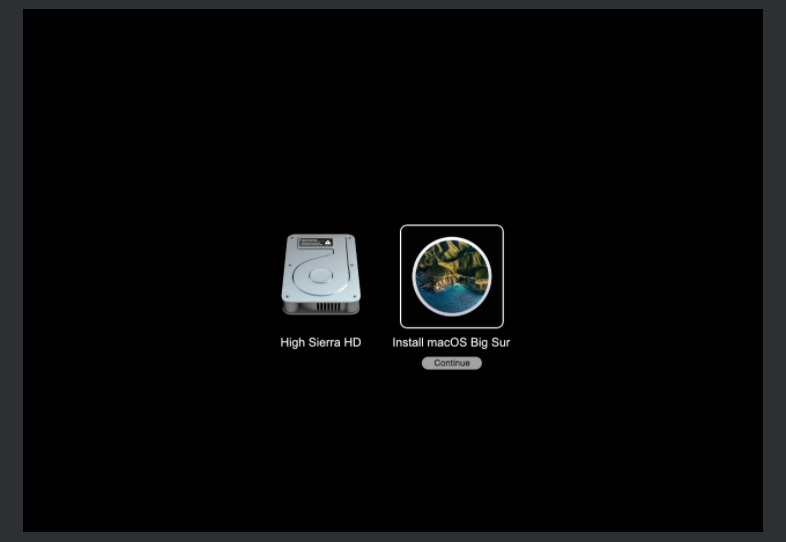

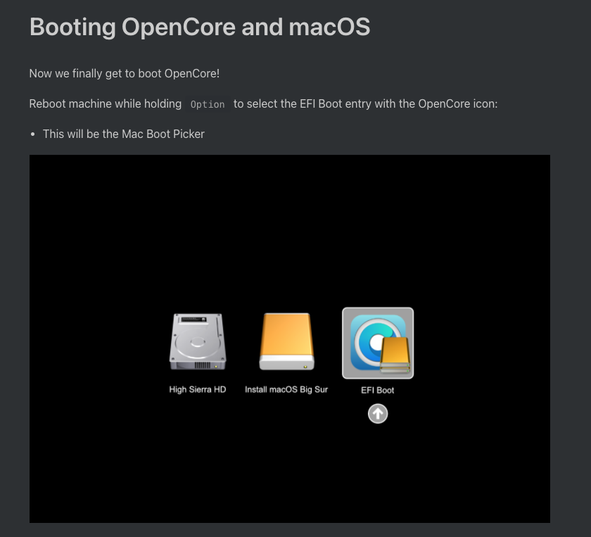

@Ausdauersportler following your advice from another thread i have gone ahead and created OCLP USB bootable Big Sur installer, I also created EFI boot SD card with OopenCore.
I get to View attachment 1761256
with no issue and when i select the EFI, it briefly shows
then the script runs over it, it reboots with the Apple logo but that is where the story ends.
Is it supposed to sit around with the apple logo for over an hour??? I guess not.
Is there a physical requirement for the SD card (i just used a 512MB card i had)
Please help me to bring this home.
Thanks
@Ausdauersportler
So after some tinkering I finally got it to work, had to quickly click on the Install macOS screen before it reloaded.
So it working as expected now.
A quick question the SD card now needs to be present for every boot? or did i miss something?
Without the SD card i get a white screen with a crossed out circle.

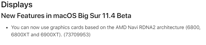

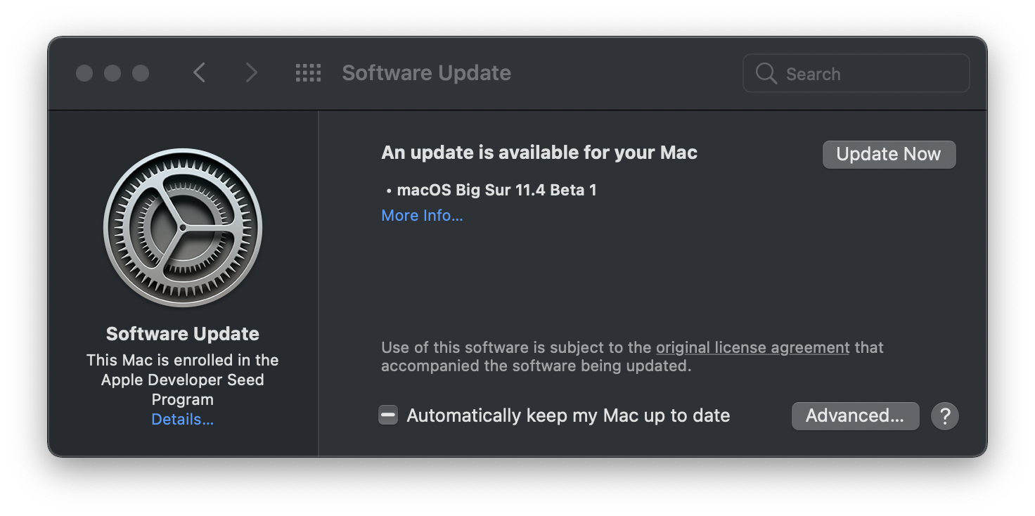

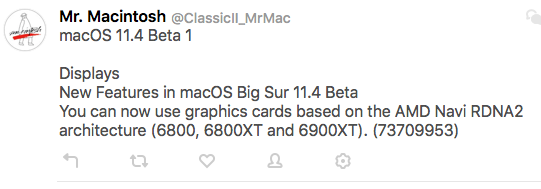

macOS 11.4 Beta 1 (20F5046g) has been seeded to developers. Apple has kindly provided an InstallAssistant.pkg at the same time:
Edit: Apple removed the InstallAssistant out of nowhere

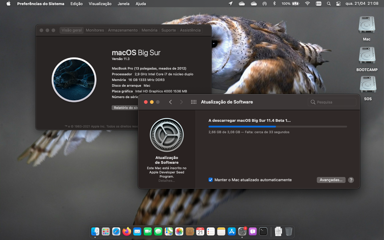

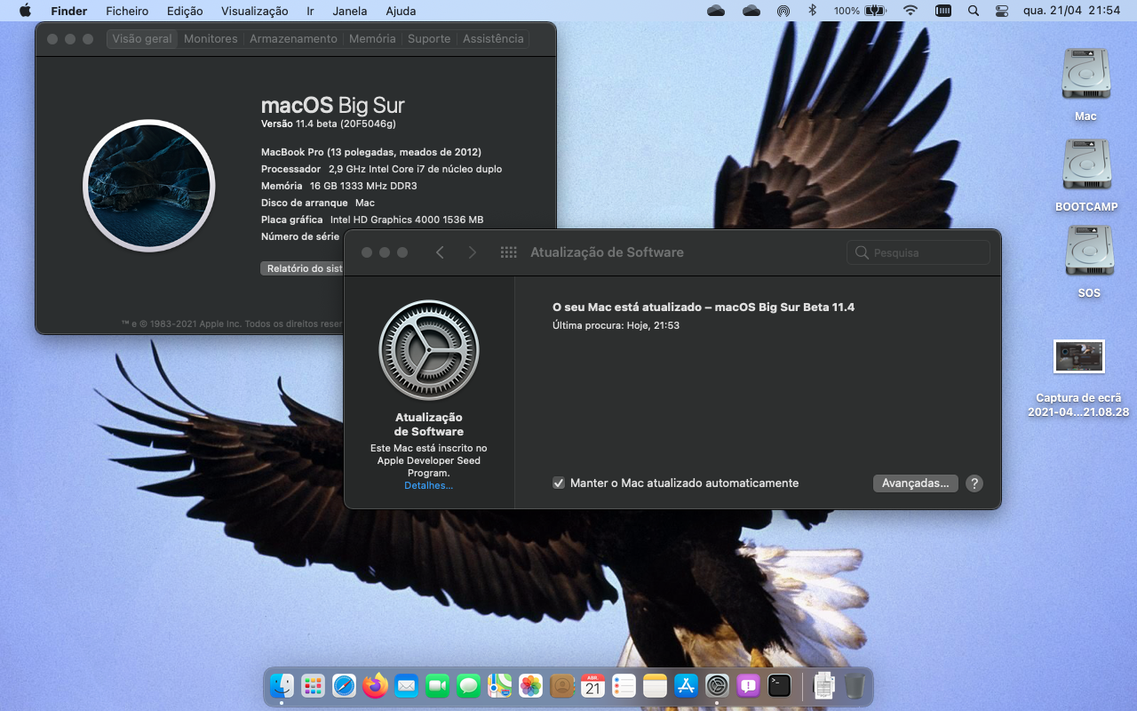

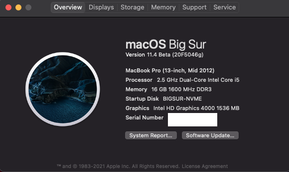

MBP9,2 no retina display OCLP0.1 - OC069 - BS11.4 b1
Working fine
