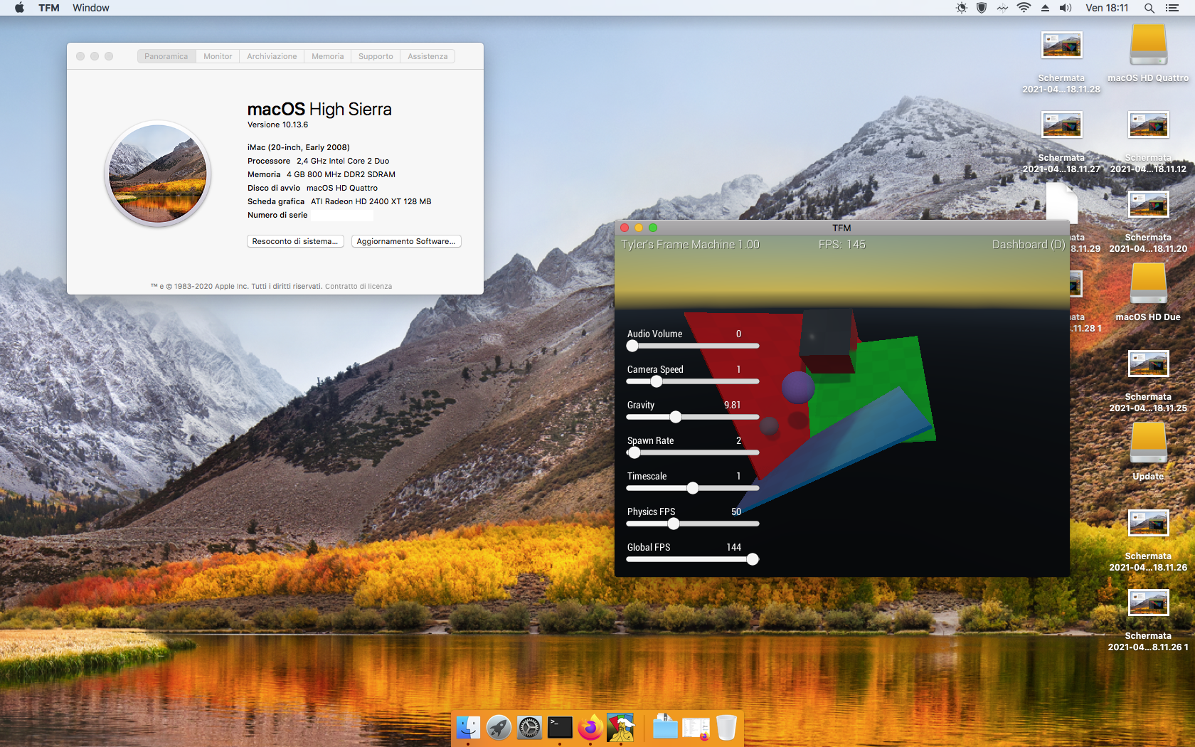

GREAT WORK! Installed Big Sur and High Sierra with OLCP 0.1.0 on iMac8,1. Big Sur painfully slow, High Sierra is amazing fast!

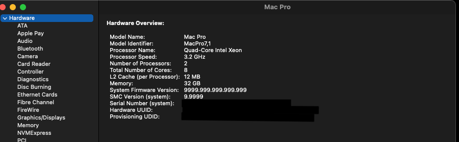

To help out, we're mainly asking for the following:
- Machine model (ie. iMac14,2)
- Patcher version (ie. 0.0.21)
- Any extra mods done to the machine (ie. Wifi or GPU upgrade)
MacPro5,1 (Mid 2010)
OCLP 0.1.0
MacOS 11.2.3
970 EVO SSD NVMe
Radeon RX 5700 XT 8 GB
I DON’T recommend to anyone install BigSur right now with a non metal GPU. It’s only to test the patches.
And DO NOT INSTALL THIS AS YOUR MAIN SYSTEM, it’s buggy, a lot of errors and more.
Only for testing and in another partition/external drive

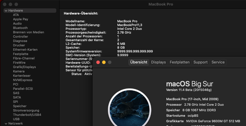

Installed 11.4b1 over 11.3b8 on my MBP5,2 17", on an external (USB) SSD, using OCLP 0.1.0. Working well.
Then also tried the OCLP public beta. This is very promising, to say the very least!
The system is using an NVIDIA GeForce 9600M GT.
Big thanks khronokernel, ASentientBot and all involved.
(Of course I left the internal (SATA) production SSD, with Catalina 10.15.7, untouched).
