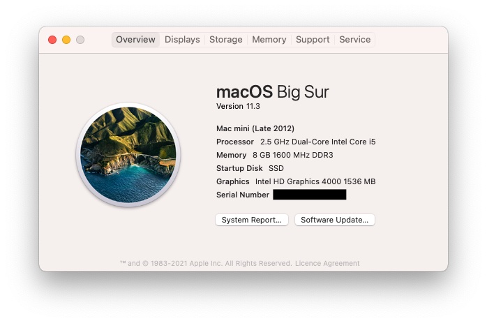

I just want to report success with updating my stock Macmini6,1 with OCLP 0.1.0 from 11.2.3 to 11.3 via "Software Update". It was my first OTA Update after switching from barrykn's micropatcher to OCLP, it feels like my Mac Mini is still part of the official game now. 🙂

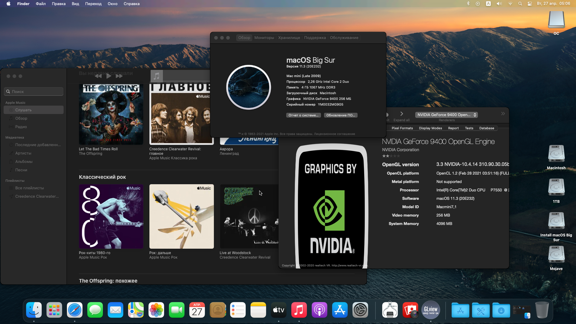

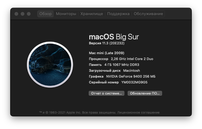

Successfully updated my old mac mini 3.1 (late 2009) to MacOS Big Sur 11.3
Patcher - OCLP 0.1.1
Options - default + system volume postinstall patch
issues - without issues, just pushed - Update =))
All works fine, nvidia 9400M acceleration (with some artifacts), WIFi and Bluetooth, sound.
It's awesome and great work guys!!
Great thanks for your hardest work!

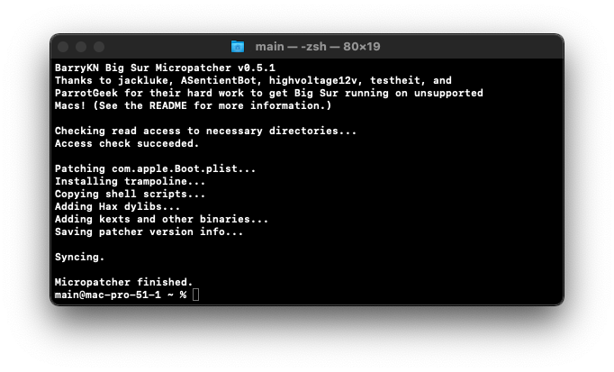

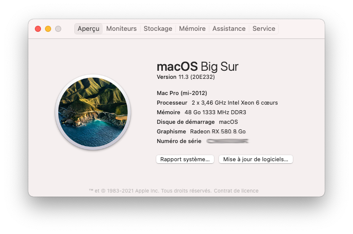

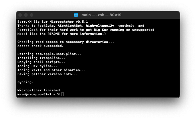

Successful installation of Big Sur 11.3 on cMP5.1 (SSD in SATA port, I didn't try with NVMe), with Barry's micropatcher 0.5.1
But I encountered some issues, during the update from 11.2.3 to 11.3, on the first reboot, remained frozen on the boot screen (gray apple), progress bar at 50%, impossible to get white apple screen and continue the the second part of installation, I forced the shutdown and started again, I tryed 4 times with the same problem each time.
So I decided to format the SSD and perform a clean install, but also encountered some issues.
During the installation, on the third restart, remained frozen on the boot screen (2 times with the progress bar at 50% and once with empty progress bar) I therefore forced the shutdown 3 times. Then on the fourth attempt, the progress bar went quickly to 100% then restarted and still got frozen on the boot screen with empty progress bar, so I forced shutdown and then start once again. At this time everything went correctly and I finally got the Big Sur configuration screen.

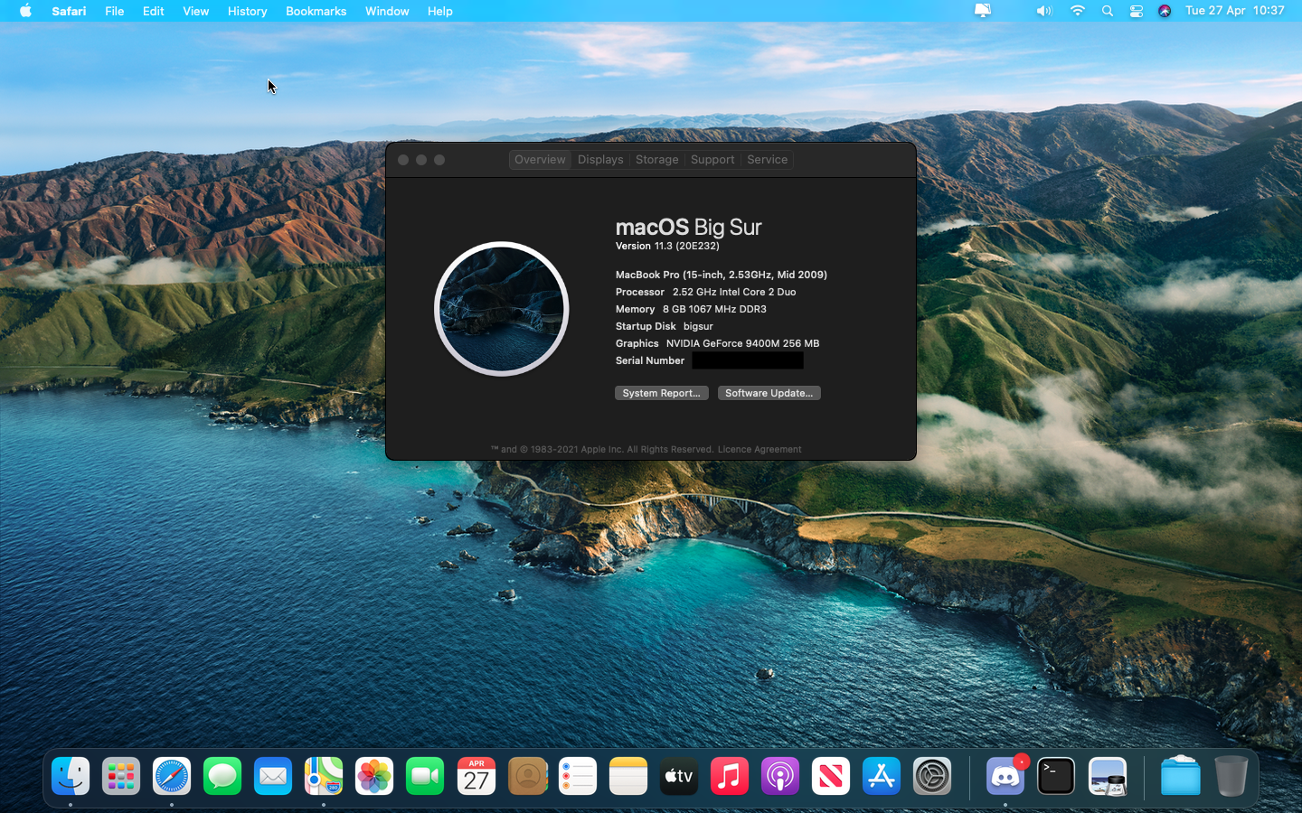

I had installed Big Sur when it 1st came out for testing purposes on my mid 2009 McBook Pro ( 5,4) Though as there was no acceleration it was unusable so I had given up on trying again with an installation.
Recently though I had noted developments in OpenCore and my hopes were raised further when ASentientBot had been working on acceleration patches bundled into the latest OCLP v0.1.1.
I am now rocking Big Sur 11.3 with BT , Wifi and acceleration (working almost perfectly - just a few very minor issues with artifacts).....could almost be used as a daily driver.....but still just using for testing purposes.
Many thanks for all concerned with OCLP for your amazing work.

Hi all
it will eventually install on cMP5,1, but boot success rate is 10-20%. If you don't reboot you should be ok.
