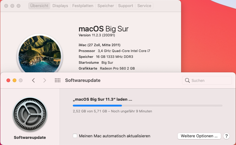

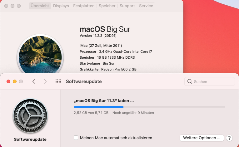

Fine that you got there! But you need no new and additional GUI and new process to replace the standard apple software update.
The only thing I do (right now) and did in the last 4 month with OpenCore and OCLP is this:
A few (automatic) reboots later I am on the next (most recent version). What can be more easy?

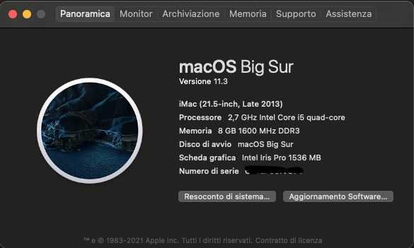

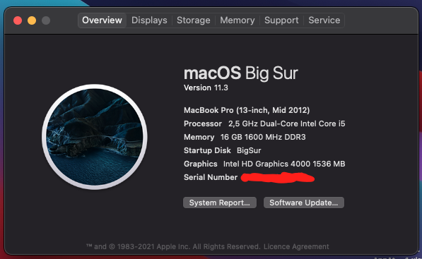

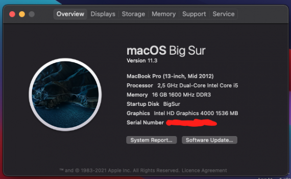

Big Sur 11.3 installato con micropatcher 0.5.2. Tutto perfetto.

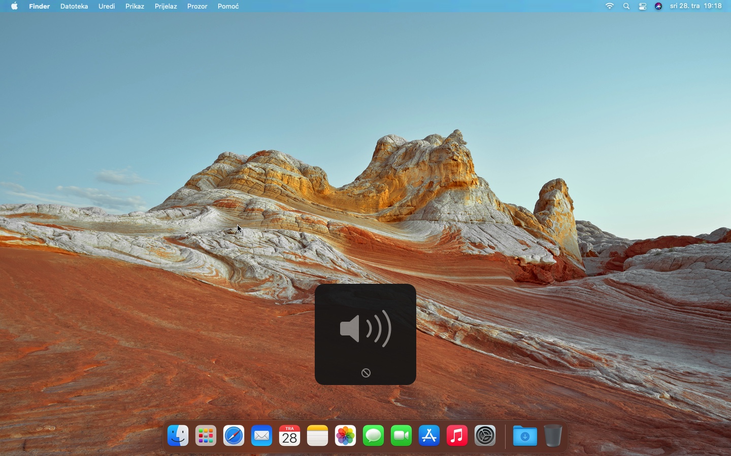

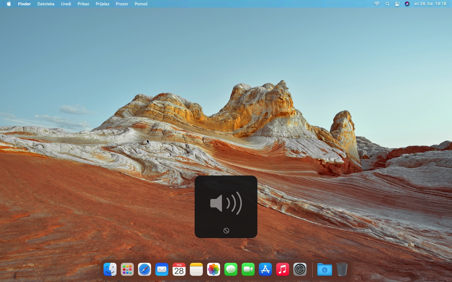

Hi guys. I just installed macOS Big Sur on my MacBook Pro 5,4 15” mid 2009 with OpenCore Legacy Patcher and everyhting works, except some graphical glitches which is expected, but I can’t get sound to work. I tried post volume patch a couple of times but can’t seem to get it working. Headphones plugged in also don’t work but AirPods do but only for a couple of minutes, then they disconnect. Maybe I am doing something wrong. Any help would be appreciated. Thank you.

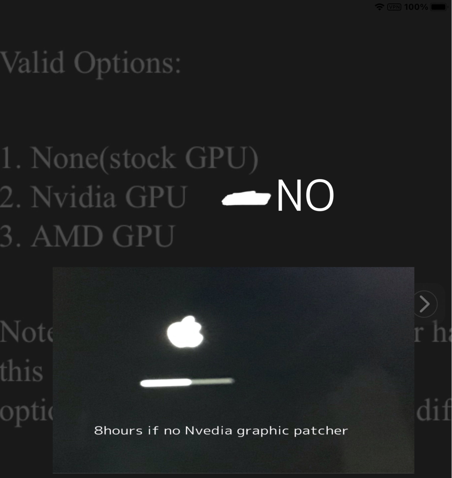

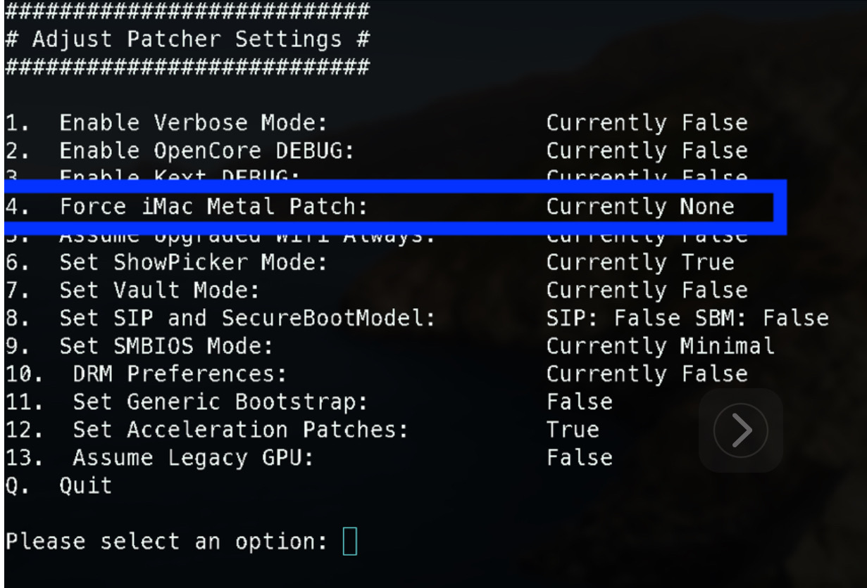

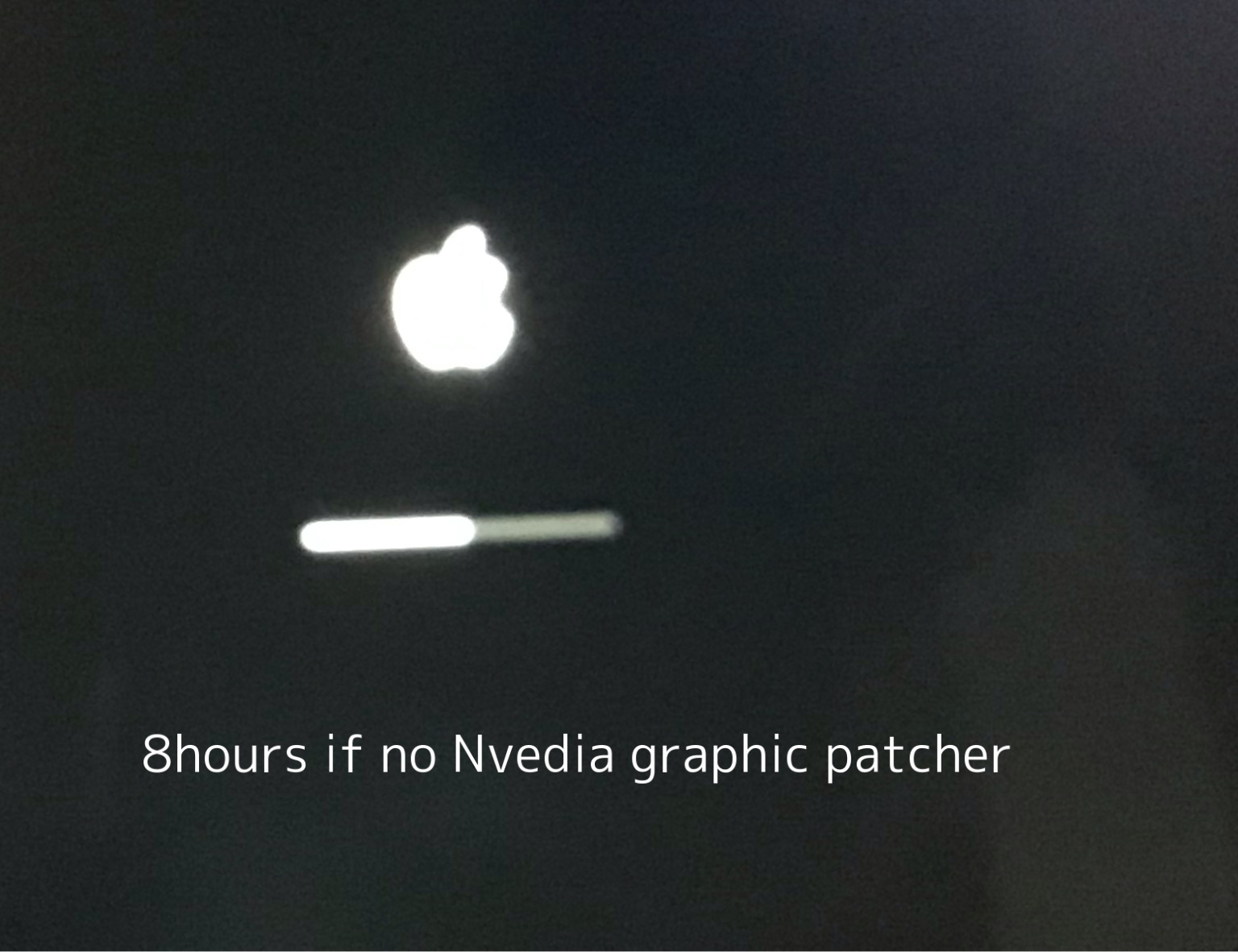

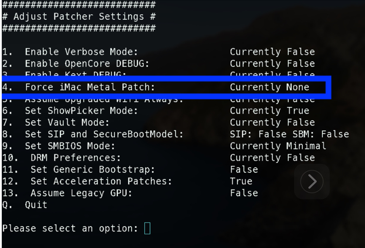

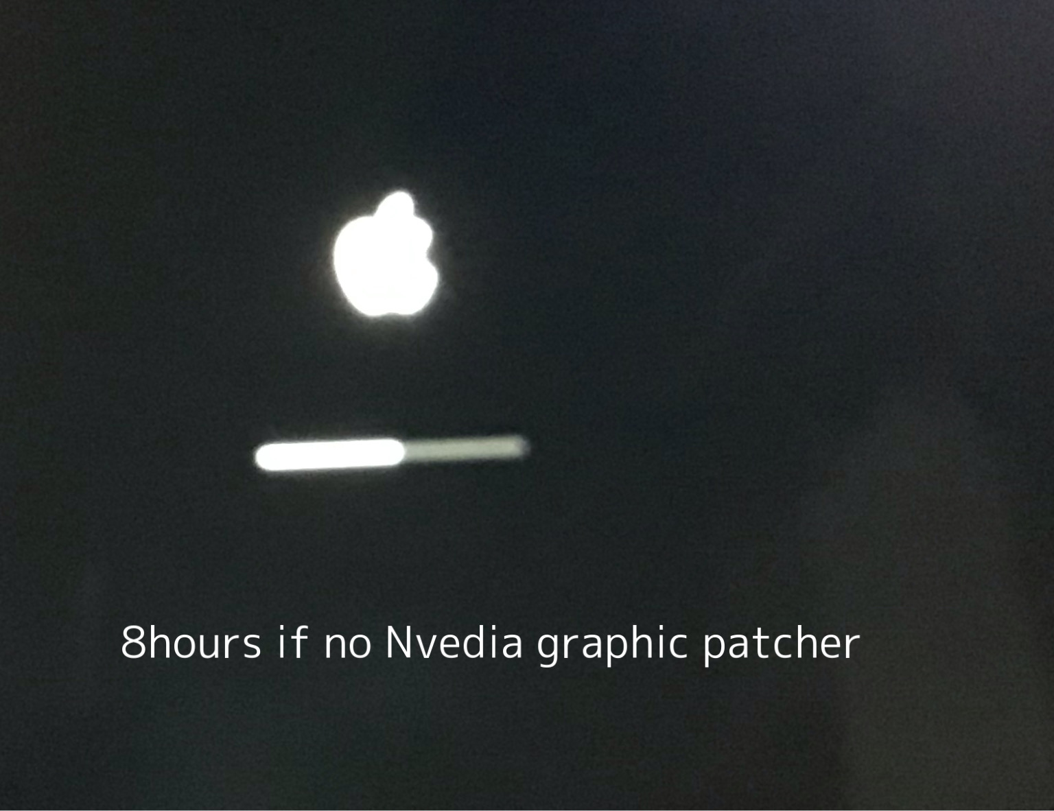

Can you please describe in a few words what your did, which hardware you were using, which version of Big Sur you were trying to install and which version of OCLP?
Sometimes a picture tells us more than a thousand words - but not here and now.
thank you for replay
-iMac10,1
-BigSur 11.3
-OCLP latest version Link
-I tested with default sitting that is mean No Nvedia patcher the result NO boot at all
the patcher depending of this active sitting ONLY!
I have all versions of BigSur that testing need too much time
this process has 2 copy
1 for recovery
2 for install
this problem happenEd after second copy”30min” but takes more than 50min
after restart this problem happening

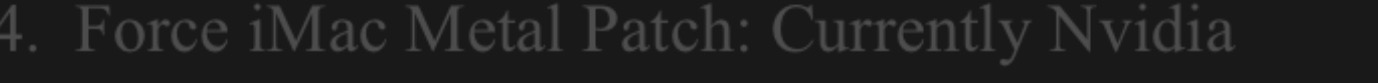

if force graphics card Nvedia is active this problem will not happen but frame buffer YouTube,and any Vedio not work also mouse very slow I sent my test in last post
if the graphic not work we can give up
i hope developers will fix it

-iMac10,1
-BigSur 11.3
This iMac metal setting is only for iMac11,x and iMac12,x modded with an NVIDIA Kepler MXM GPU. I doubt you made this with your iMac10,1.
On the last post @khronokernel made here he published a link to the last 11.2.3 Big Sur version. Since you will need to do the post install patching (for legacy GPU support) and all tests have been made with the former Big Sur version please use this version.
And do not use settings not intended for your iMac. There is a pretty detailed documentation available on the OLCP Github page. You surely passed there quickly by on the rush to find the download link.
Read the docs and give it another try. Read the docs and...read it!

I can’t see my replay not active after more hours
this default sitting can you write your advice sitting for iMac10,1
Do you mean stock sitting is default patcher sitting
thats mean “FORCE IMAAC METAL PATCH:NONE”
this property is the magic sitting for boot success OR not
NONE means 8 hours
but if patched with Nvedia the boot loader will run
I have BigSur 11.2.3 I will try the doc is big
I think you mean this link to read Link
too long and good information
let’s try!test
NONE means 8 hours

note:
{all version of apple OS work except BigSur so graphic card is not bad ?
now I have Catalina 10.15.7 latest graphic work good frame buffer not delay.}

Test Result
BigSur 11.2.3 work boot without Force iMac metal patch
latest OCLP
BUT graphic and mouse problems are not fix at all
It’s first time to boot with no Nvedia patch I think update patch solve it
but any latest of BigSur need patch Nvidia,
but after that we need to fix graphics problems
