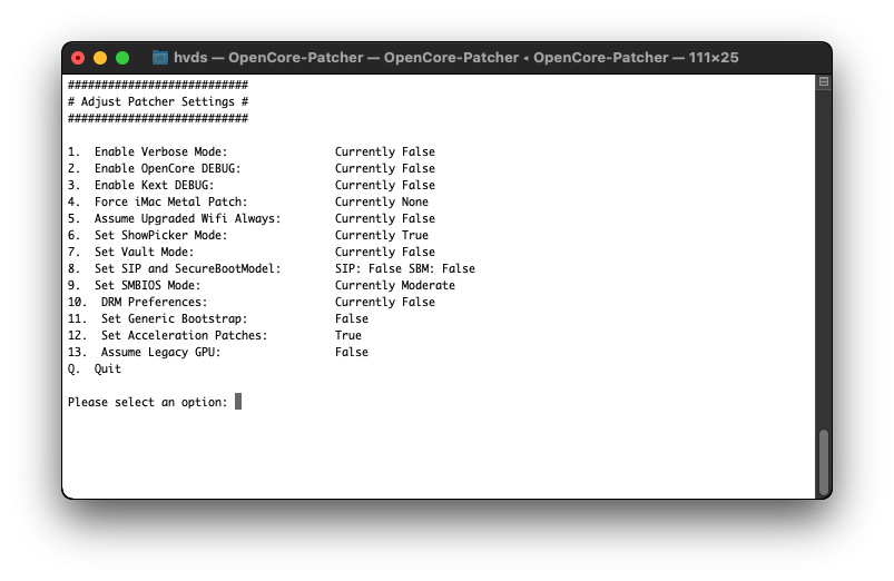

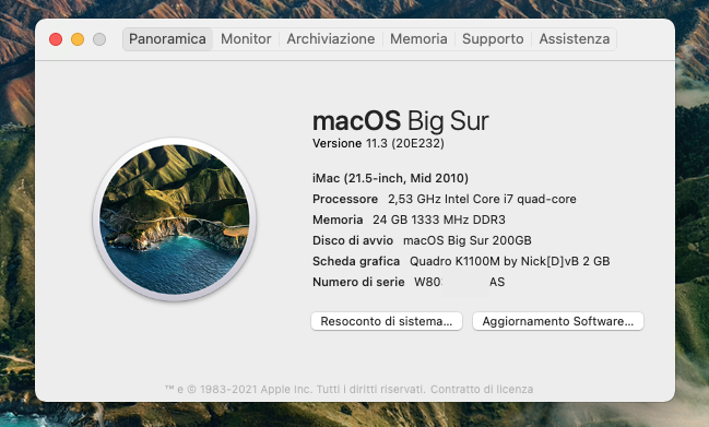

Hello everyone,
today I installed macOS 11.3 from full USB stick installer on my iMac11,2 21.5" Mid-2010 with i7-860S, flashed K1100M and upgraded BCM94360CD (see photo attached), using OCLP 0.1.1 on internal SSD EFI.
Everything works perfectly fine, except for one thing: brightness control. No way to get it working.
In "Patcher Settings" I disabled point 12 "Set Acceleration Patches" and even set point 4 "force iMac Metal Patch" to "NVIDIA GPU", as I have a K1110M.
When I build OpenCore it detects my card and says that it installed the relative patches, but when I reboot (with or without SMC/PRAM resets), I always have brightness at full tilt.
Previously I had macOS 11.2.3 installed with OCLP 0.0.22 over a pre-existent 11.2.3 partition installed with barrykin's big-sur-micropatcher.
Everything there worked absolutely fine AND I had brightness control perfectly working too.
I've tried 0.0.23, 0.1.0 and 0.1.1, none of them gave me brightness control so I reverted back to 0.0.22 and now everything works fine, even in macOS 11.3.
I assume for some reason OCLP after 0.0.22 doesn't create config.plist correctly for my machine for some reason, or I'm doing something wrong.
I've got no problem staying on 0.0.22, but I reported my case hoping it can be helpful for future developments 🙂
You all are doing an amazing job with this patcher, thanks a lot for your immense efforts to keep old machines like mine in touch with 2021 ^^

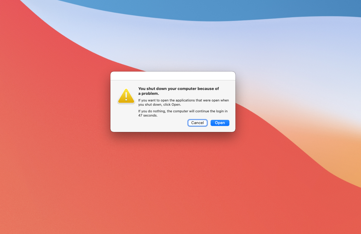

I upgraded to 11.3 via the Micropatcher and after applying the wifi patch, I get the following message after logging into my Mac. How can I address this as I haven't seen this before after upgrading on my unsupported Mac.
Hello everyone,
Hi, could you open an issue on Github regarding this? Forums are an absolute pain to keep track of issues from our end, so having a consolidated area is much appreciated. When you open the issue on Github, please upload an IOReg of your machine (file -> SaveAs):
Thanks in advance,
- Mykola

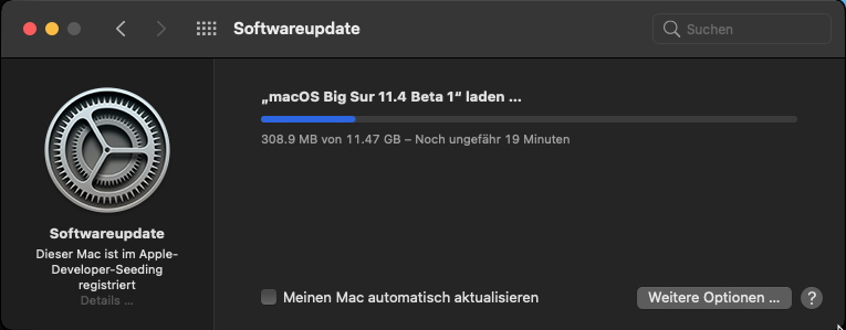

One question, macOS now always asks me to update to 11.4 Beta 1 which I don't want to do and I didn't use Beta versions before. I tried to leave the Beta program in the update dialogue under settings but that didn't help. How can I make sure the OS only looks for updates of the stable version?
Reactions: webg3
Reboot once more. Same issue? Check log files. Note time stamp.
Done, same issue. timestamp was 10:39 - 10:40am. Looks like a lot happened in the background and hope it's not too much information. I copied the log from that minute but let me know if you need something specific. Hope this helps.

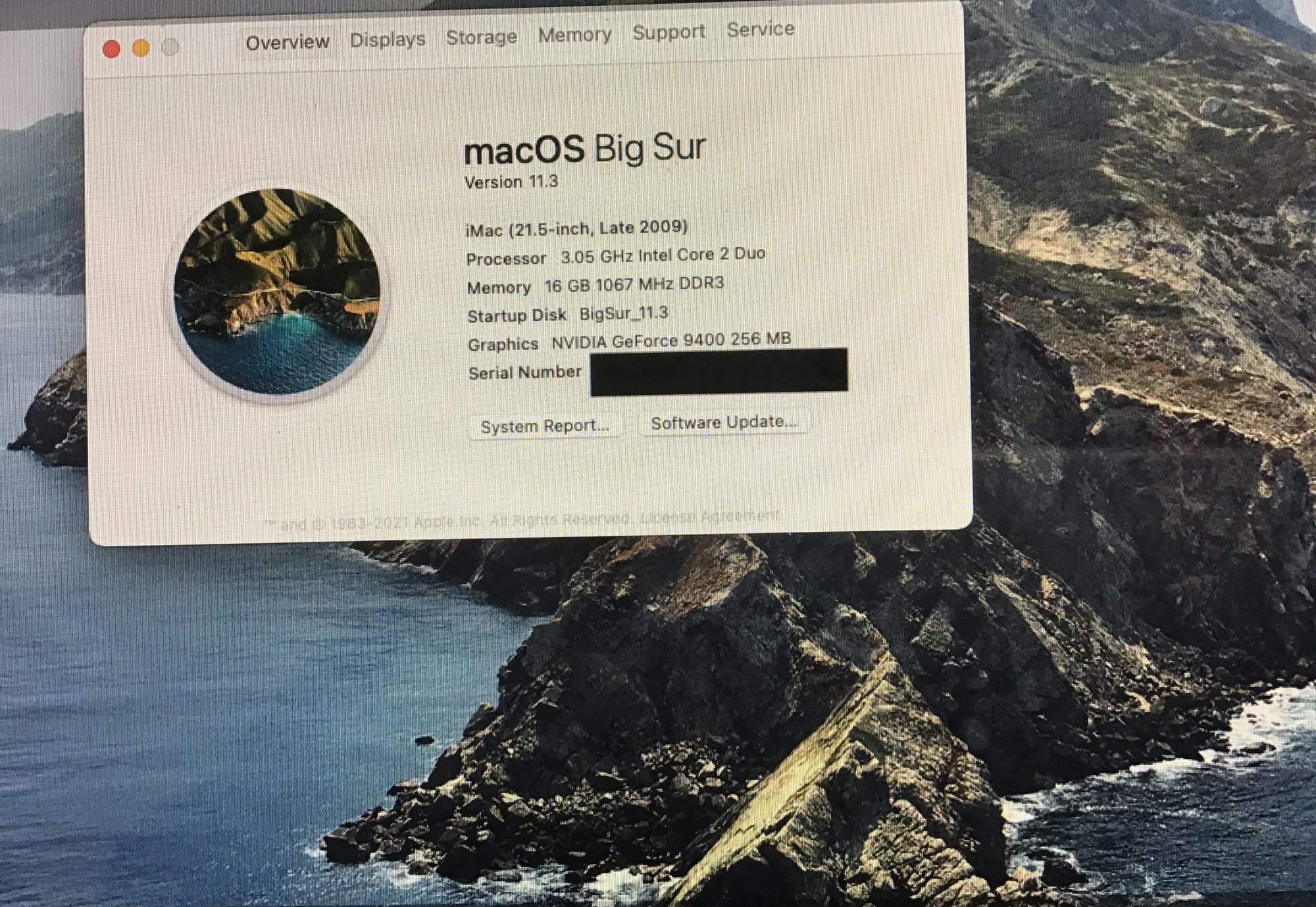

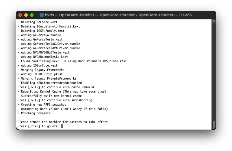

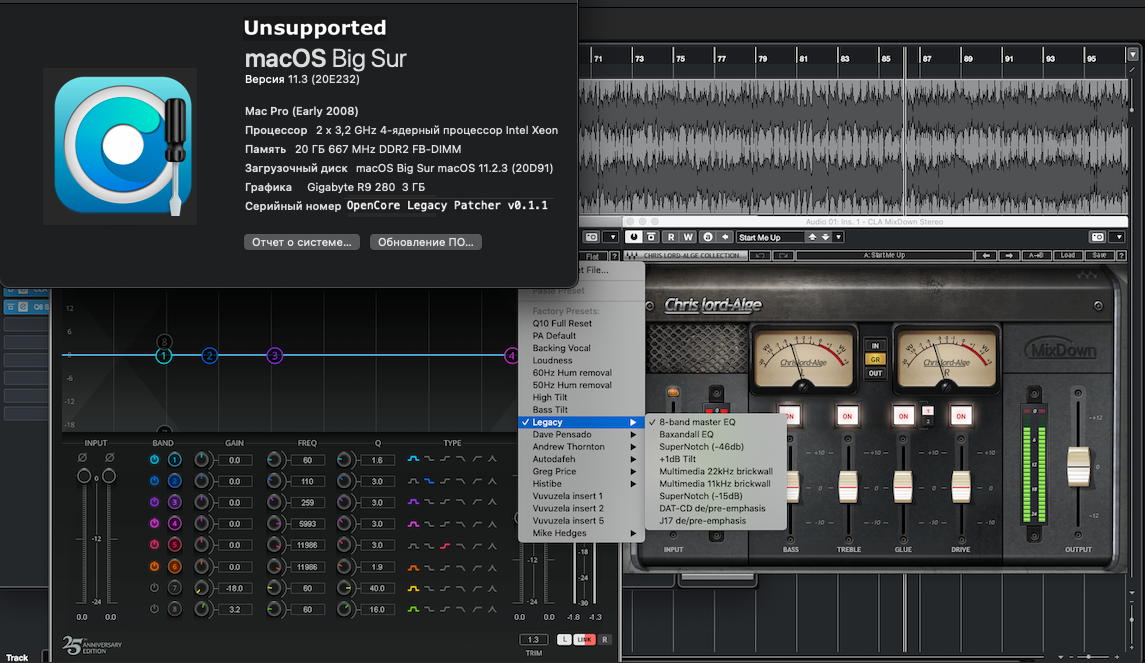

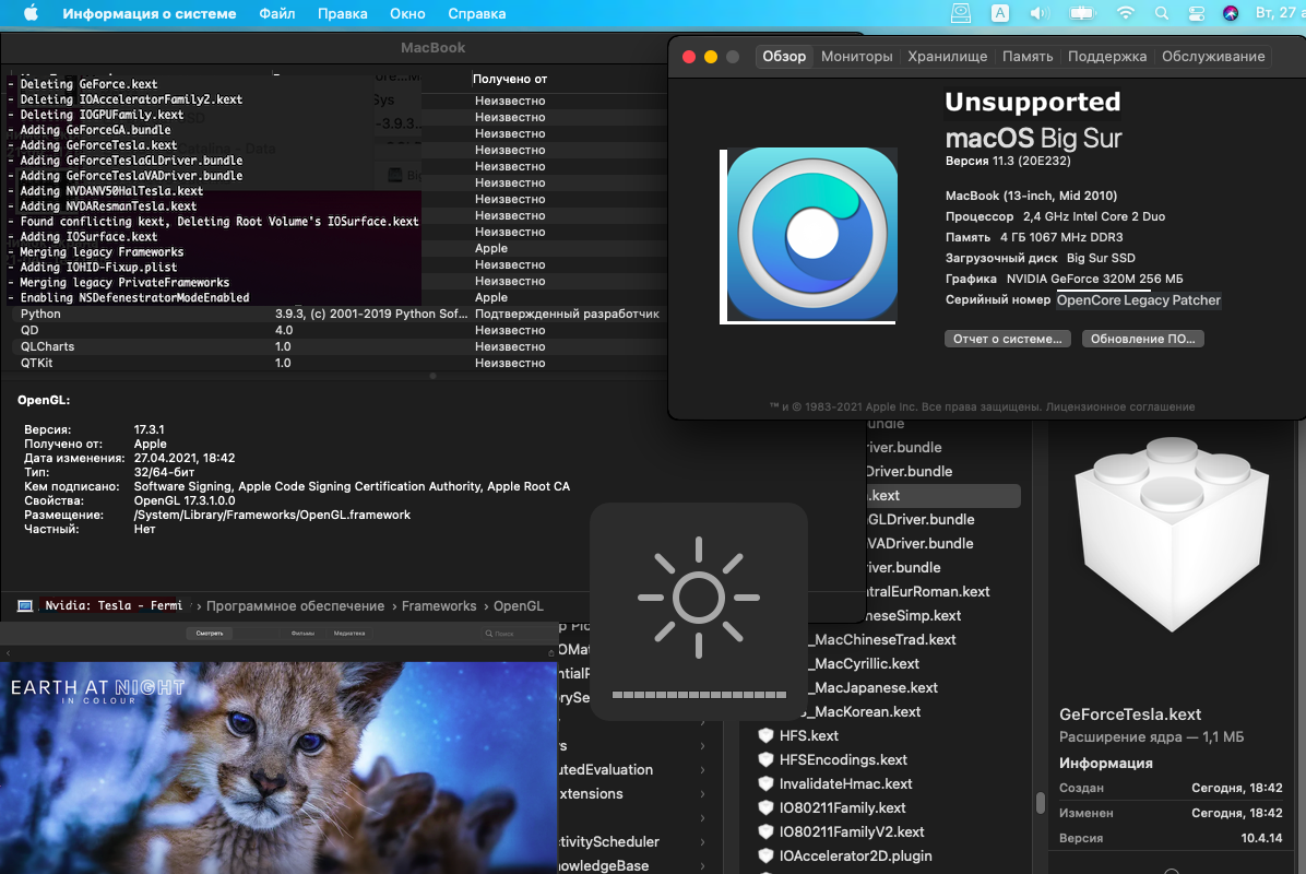

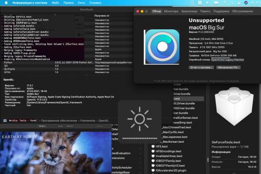

Hello, it's very nice, thanks to your knowledge, I almost fully use the old unsupported computer technology apple. I updated the installed MacBook and MacPro system on top. Everything is ingenious, aerobatics is like a new real computer technology apple. Super Opencore Legacy Patcher👍💫🏆
Thanks to khronokernel, SentientBot, dosdude1, Ausdauersportler and the developers🙌😊

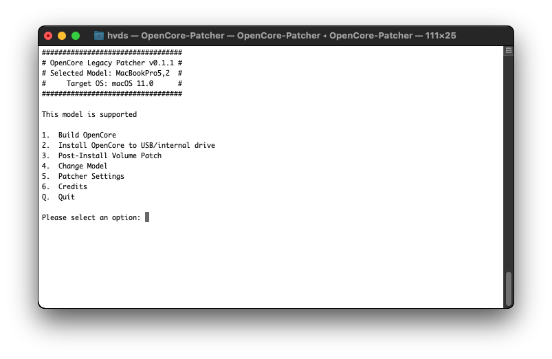

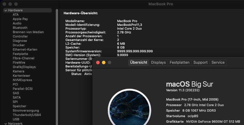

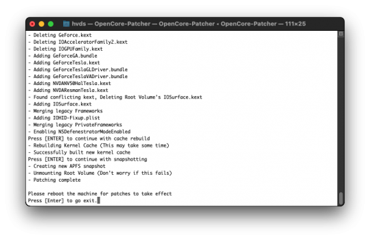

Just did a clean install of 11.3 on an external SSD using OCLP 0.1.1, on my MBP5,2.
- needed a manual reboot once at start of stage2, then it proceeded right to the setup screens
- setup executes a bit slow as graphics acceleration comes in later - but works
- used migration from Catalina 10.15.7 (on the internal SSD). (A posteriori migration to my previous installation of BS didn't work, hence I reinstalled, and also to go from 11.4beta to released 11.3)
- then applied the Post Install Volume Patch of OCLP 0.1.1, reboot and boom - acceleration!
- update to 11.4beta is still offered despite patched system volume, as khronokernel has indicated earlier (but I cancelled the download).

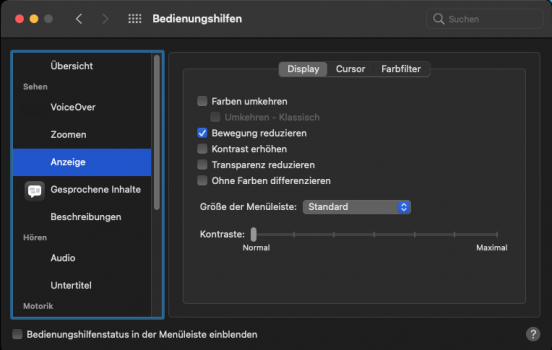

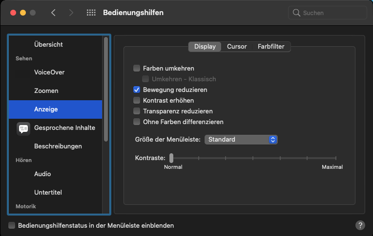

One more small remark: don't select "reduce transparency" as otherwise the left part of the menu bar isn't updated correctly. Plus small other graphics glitches which don't hurt.
That all looks so good that I'll soon swap this BigSur SSD with the Catalina SSD and use it on SATA for more testing.
