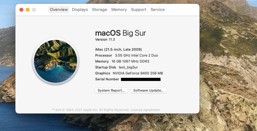

Test Result
BigSur 11.2.3 work boot without Force iMac metal patch
latest OCLP
BUT graphic and mouse problems are not fix at all

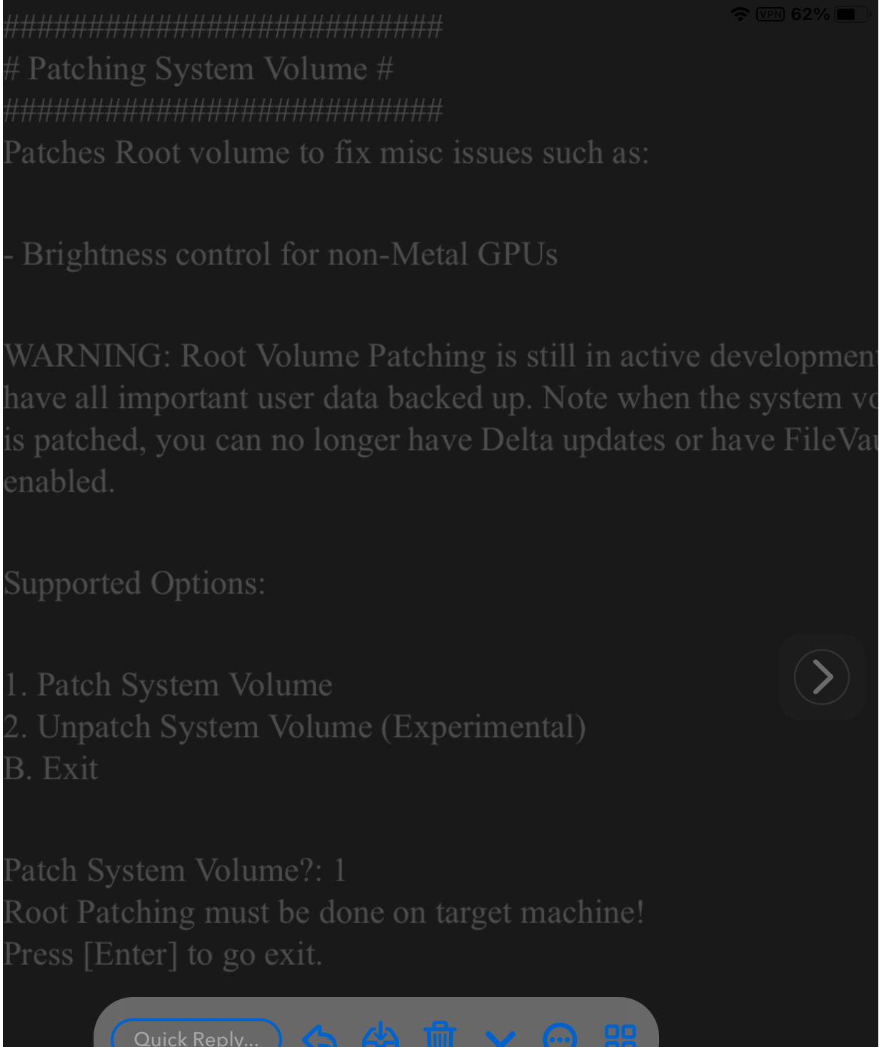

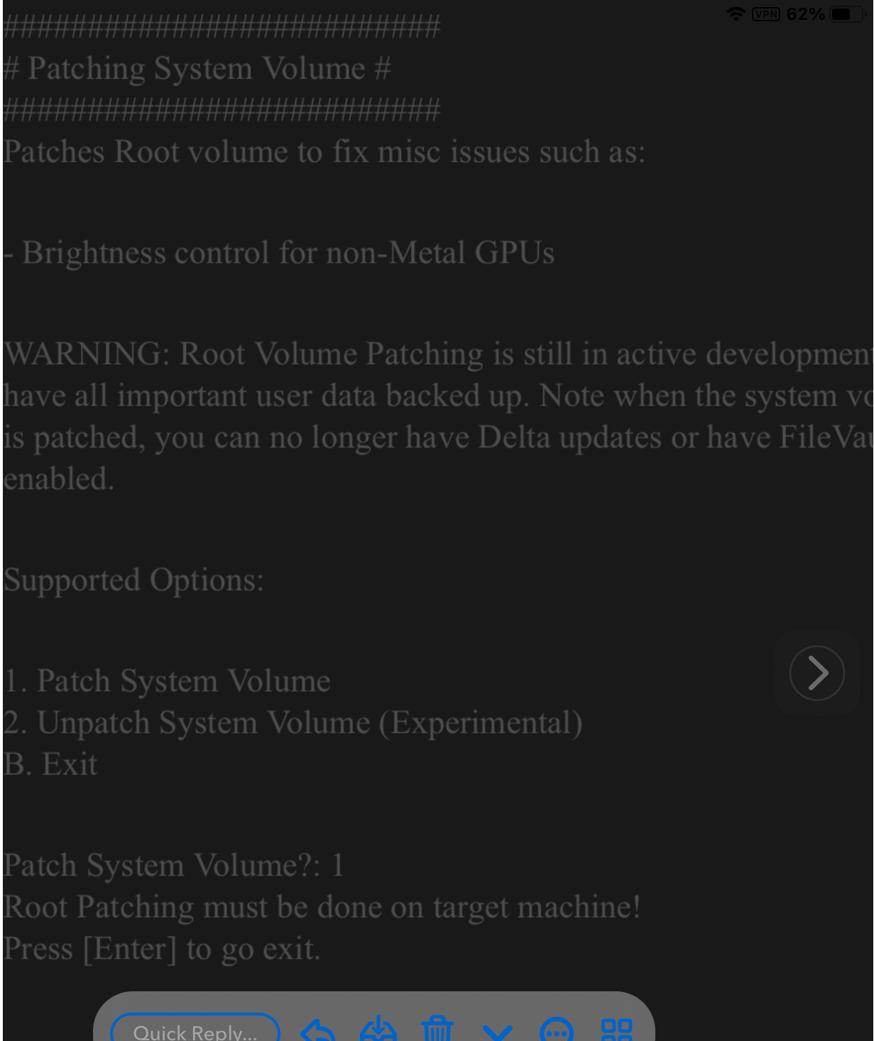

Again, using the phrase NVIDIA metal patch at this point in the patcher is a misconception and using it with your system is another. It is meant for a system having a new metal NVIDIA card which your iMac DOES NOT HAVE! Using a native Metal GPU (either AMD or NVIDIA) does not need any patches, just some settings to make it fully working which is done by selecting this point).
The graphics acceleration patches needed for your system will be applied after installation of Big Sur by using the OCLP patcher app, again.
Start the OCLP app again, choose
3. Post-Install Volume Patch
then
1. Patch System Volume
Let the patcher app patch your system and reboot the system after the patcher did it's job. After reboot graphics acceleration should work to some extend (this is still beta software and we do not know if it will be ever fixable as for Catalina. BTW it is the very same guy @ASentientBot creating this patches as for Catalina before).

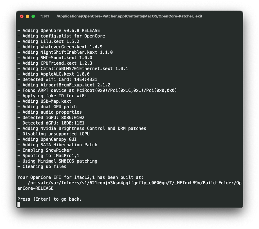

Just a preliminary report of at least some success with OLP on a Macbook Air 3,2 late 2010.
Big Sur 11.3, OLP 0.1.1
Using the standard docs it definitely works as-is so very happy with that so far.
One issue that I still see is the reported issue here of having to use option during boot both during the install, for every reboot and now after every manual reboot.
But once up and running it is so far pretty great for general use on an old machine off the bat.
Will keep testing

Proposed already a change to the docs!
The magic is using the CRTL key when selecting the OCLP EFI for the very first time. This way it becomes the standard boot object and you do not need to wait for reboots. This is standard Apple system administration :)
then

I used OCLP 0.1.1 and a USB stick with Mac OS 11.3 to update from patched 11.2.3 and the update was successful!
I didn't patch my system this time. It seems to work fine. It's been only a few hours and I haven't found any bug. Tell me if you want to me to check anything in particular.
I noticed that the default settings in OCLP for Metal patch and upgraded wifi were "None" and "False" although I have upgraded both. I didn't change anything in the settings. Should I change them? I have installed it in the internal drive and it boots fine.

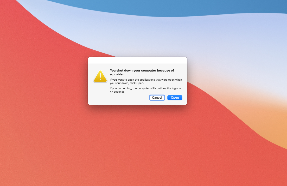

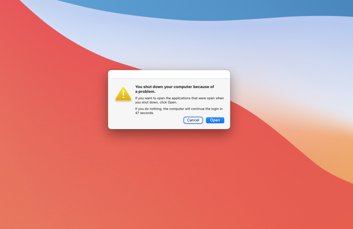

i run software update “BigSur 11.3 take 2 hours” and restart fail
and again with boot issue like this may be I wait again more hours
i Shutdown it and restart it again progress not run completely and succeed with BigSur 11.3
There came now a few some messages in of broken installations. When such a thing happens it is time to enable verbose boot with OpenCore instead of sitting blindly for hours in front of a system.
And please stop posting those pictures showing nothing! We believe you telling us the boot sticks for hours, now.
And as I wrote before it is known that 11.3 with legacy video has and had it's problems. This comes close to masochism, now. But what do I know about humans...
then

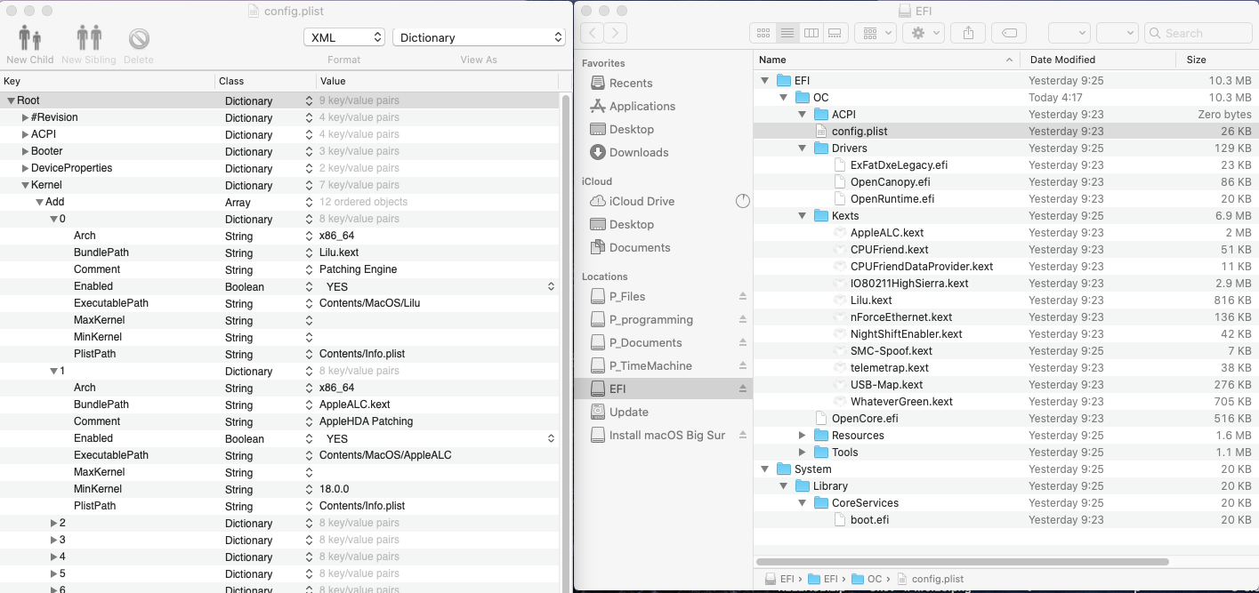

How well would my late 2012 iMac (3.2 GHz Quad i5 with GTX 675MX) work with unofficially installing Big Sur?
I am surprised this is a problem... The late 2012 retina display MBP is almost completely supported by Big Sur, even without OpenCore (if you physically upgrade the Wi-Fi/Bluetooth card then in terms of hardware it is completely supported; but you need OpenCore or a patcher to force it to install, because Apple still detects it as an unsupported model).
I use Big Sur and OC on the same model all the time with no problems at all. I've gone through every single beta version of Big Sur (at least, since late last year) and am currently on 11.4 beta 1. So I'm thinking that with more info, this should definitely be fixable..

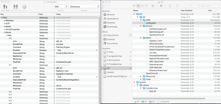

When you say "can't boot from internal drive" what do you mean? That it doesn't even show up as a boot option? Or that it does, but then when you select it, it crashes, hangs or otherwise doesn't work in some way?
Hi, thanks for your input.
If I don't have my OC USB installer plugged in after reboot, it'll just show a black screen and a warning sign with mac startup URL if I hold the power button.
FWIW I was on the original 11.2, not 11.2.3.
I think I'll try to install 11.3 with micropatcher on top of it now then 11.3 with OCLP now. At worst I'll start from scratch then recover from TM backup.

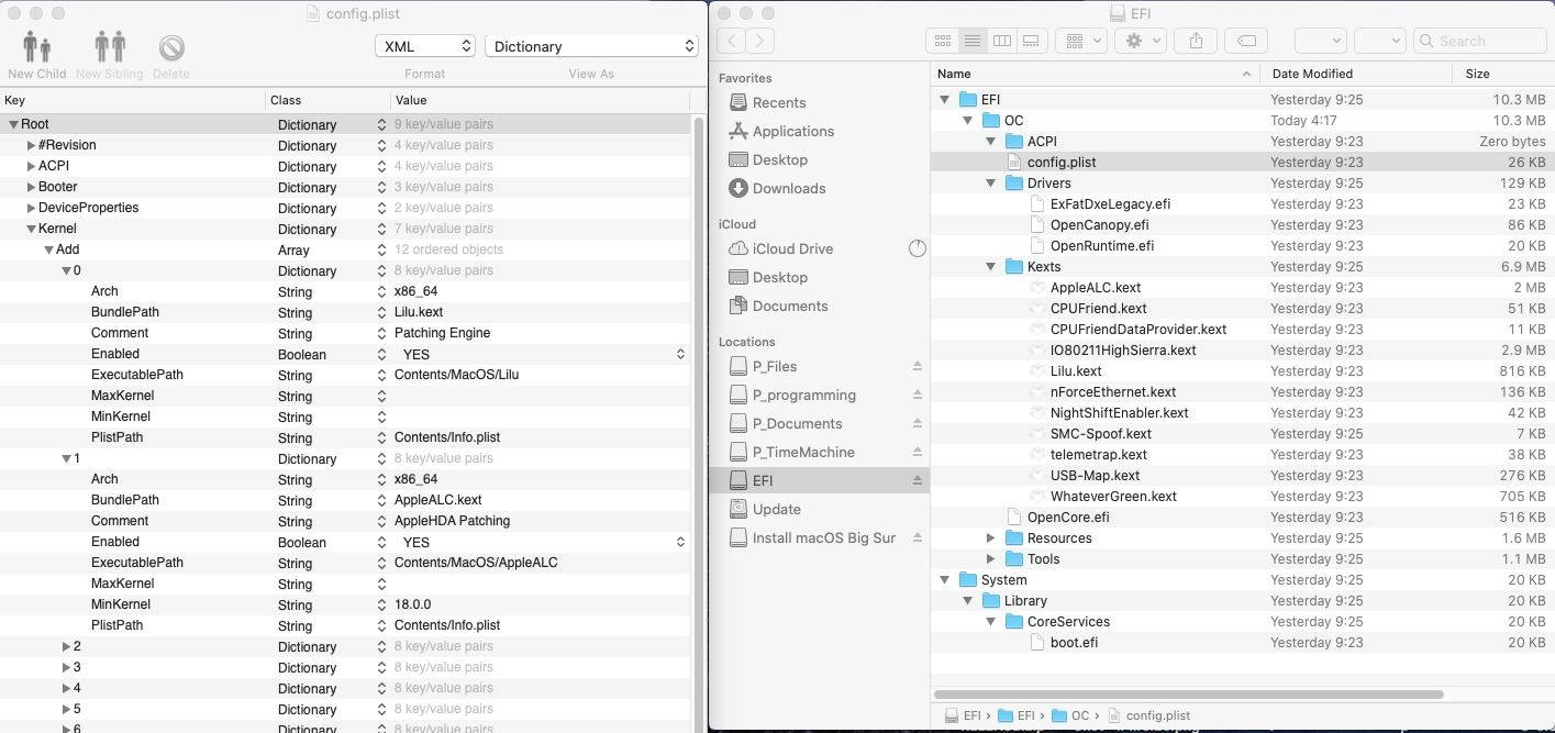

If I don't have my OC USB installer plugged in after reboot it'll just show a black screen and a warning sign...
If it works fine with OCLP EFI on USB stick, it probably means you did not complete the EFI install on internal disk properly.
Did you follow all the steps? Including reboot with option and selecting EFI on internal disk?
