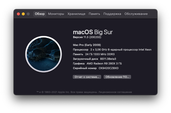

Successfully updated to 11.3 RC from MacOS 11.3 beta 8. Mac Pro 4.1 (early 2009) flashed to 5.1
Patcher: - OCLP 0.0.22
Issues: Freeze on boot and reboot while update installs (NVME and Soonnet USB 3 expansion card bug (fixed by remove expansion card))
Mac Pro 3.1 updated without issues via OCLP 0.0.22
Works fine!
Thank you guys!

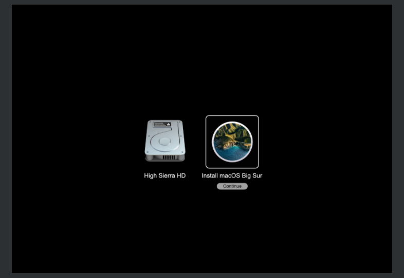

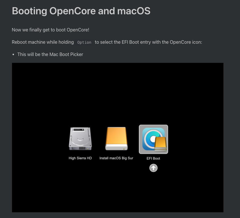

@Ausdauersportler following your advice from another thread i have gone ahead and created OCLP USB bootable Big Sur installer, I also created EFI boot SD card with OopenCore.
with no issue and when i select the EFI, it briefly shows
then the script runs over it, it reboots with the Apple logo but that is where the story ends.
Is it supposed to sit around with the apple logo for over an hour??? I guess not.
Is there a physical requirement for the SD card (i just used a 512MB card i had)
Please help me to bring this home.
Thanks

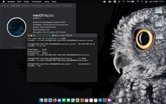

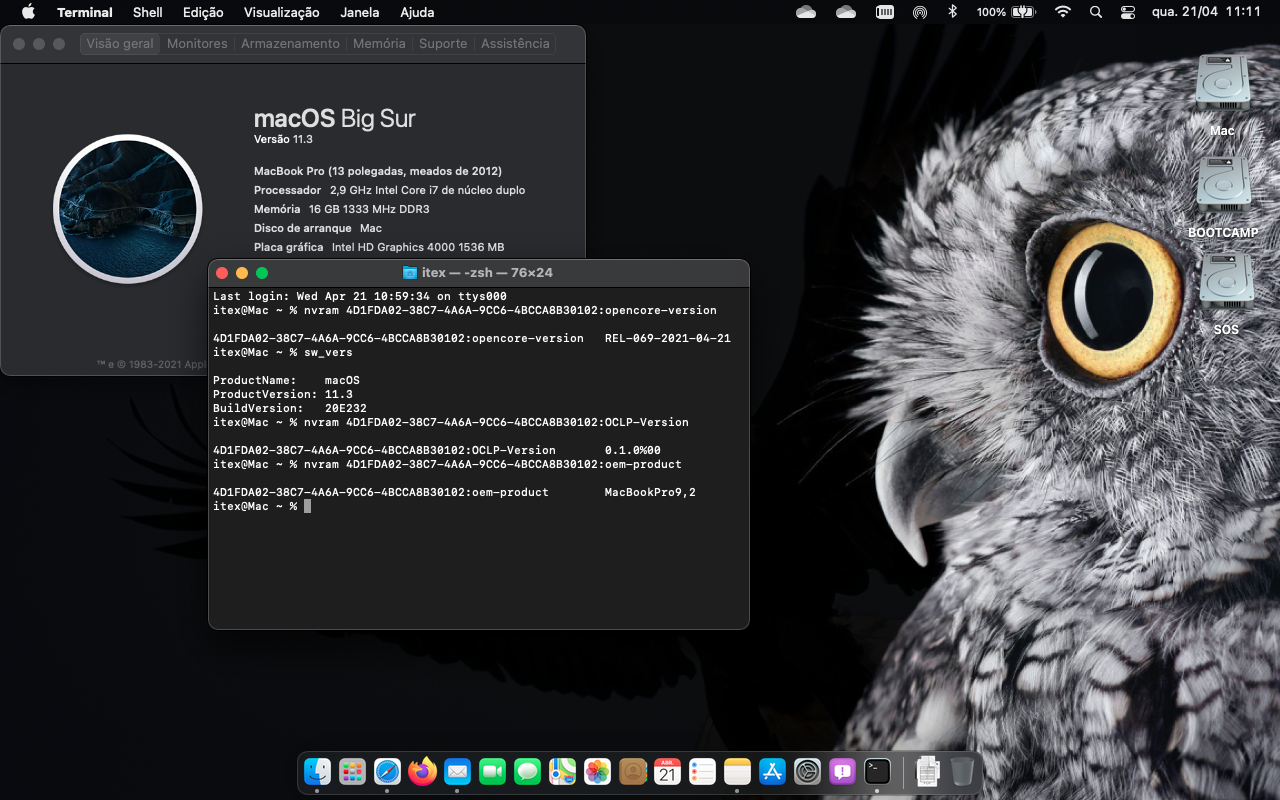

MBP9,2 non-retina working like a charm with OCLP 0.1.0 - REL-OC069 and BS11.3 20E232 no issues.
Thanks, @khronokernel and the team of OCLP excellent work.
