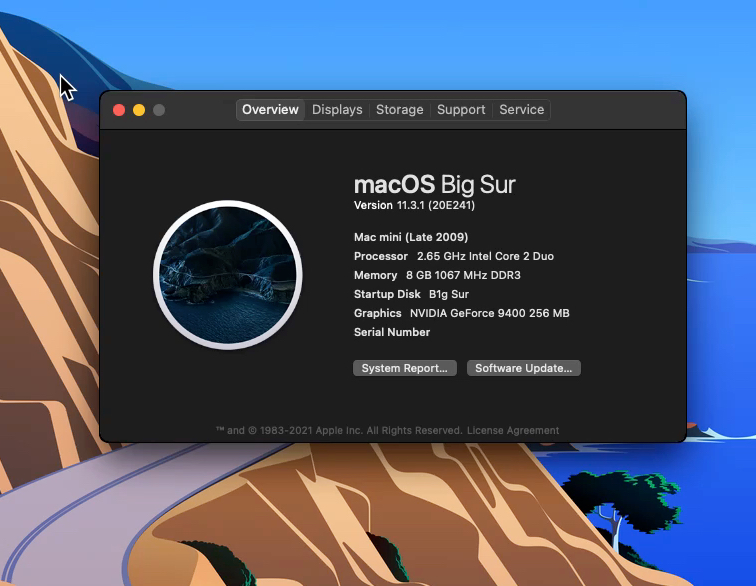

See below post from fellow 2012 MBP user that switched to OCLP, using the official OCLP user guide as well as a simplified guide that I posted.
I would definitely recommend OCLP for yourself, as the 2012 MBP is fully supported. End result, you can do software update (OTA) as per normal means.

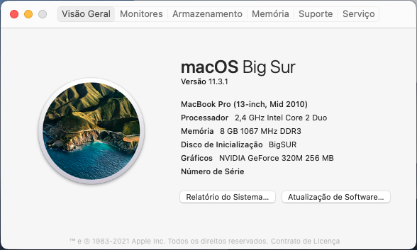

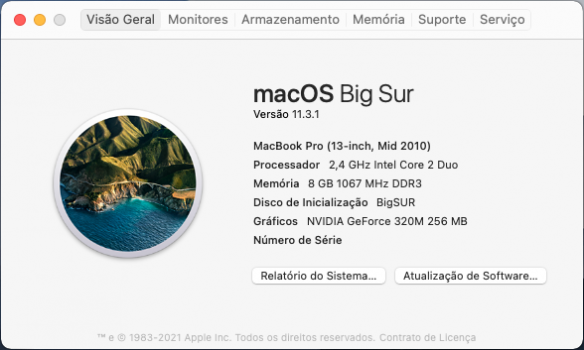

Congratulations to the developers for the excellent work. Thank you very much for reviving my 2010 Macbook. Working very well so far. Some small graphical problems but it is very well.
I'm trying to activate SIP, I've tried it from the terminal using 'csrutil enable' through the boot disk and also through the OpenCore-Patcher app. Does anyone know how this can be done?

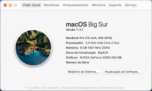

Likely required to be disabled due to graphics patches installed by OCLP v.0.1.2. See Item 8 in the OCLP app set-up menu.

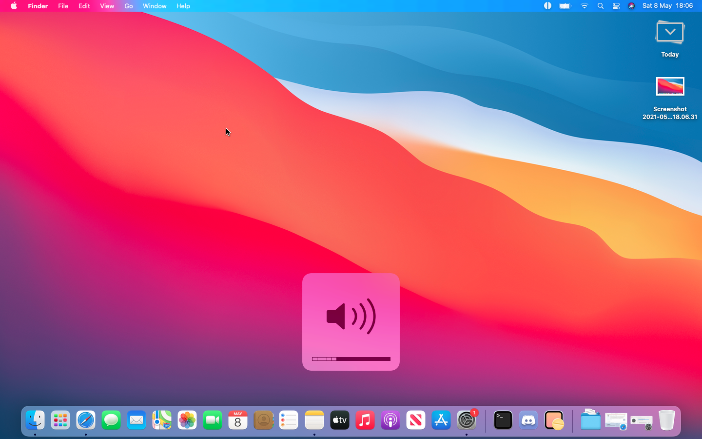

Hi guys. I just installed macOS Big Sur on my MacBook Pro 5,4 15” mid 2009 with OpenCore Legacy Patcher and everyhting works, except some graphical glitches which is expected, but I can’t get sound to work. I tried post volume patch a couple of times but can’t seem to get it working. Headphones plugged in also don’t work but AirPods do but only for a couple of minutes, then they disconnect. Maybe I am doing something wrong. Any help would be appreciated. Thank you.
I have the same machine and had the same issues with no sound. I mentioned this in the Github page under issues and was sent , the not yet released to the public OCLP 0.1.3 , which has resolved this problem. I am sure in the next few days a full release will be downloadable.

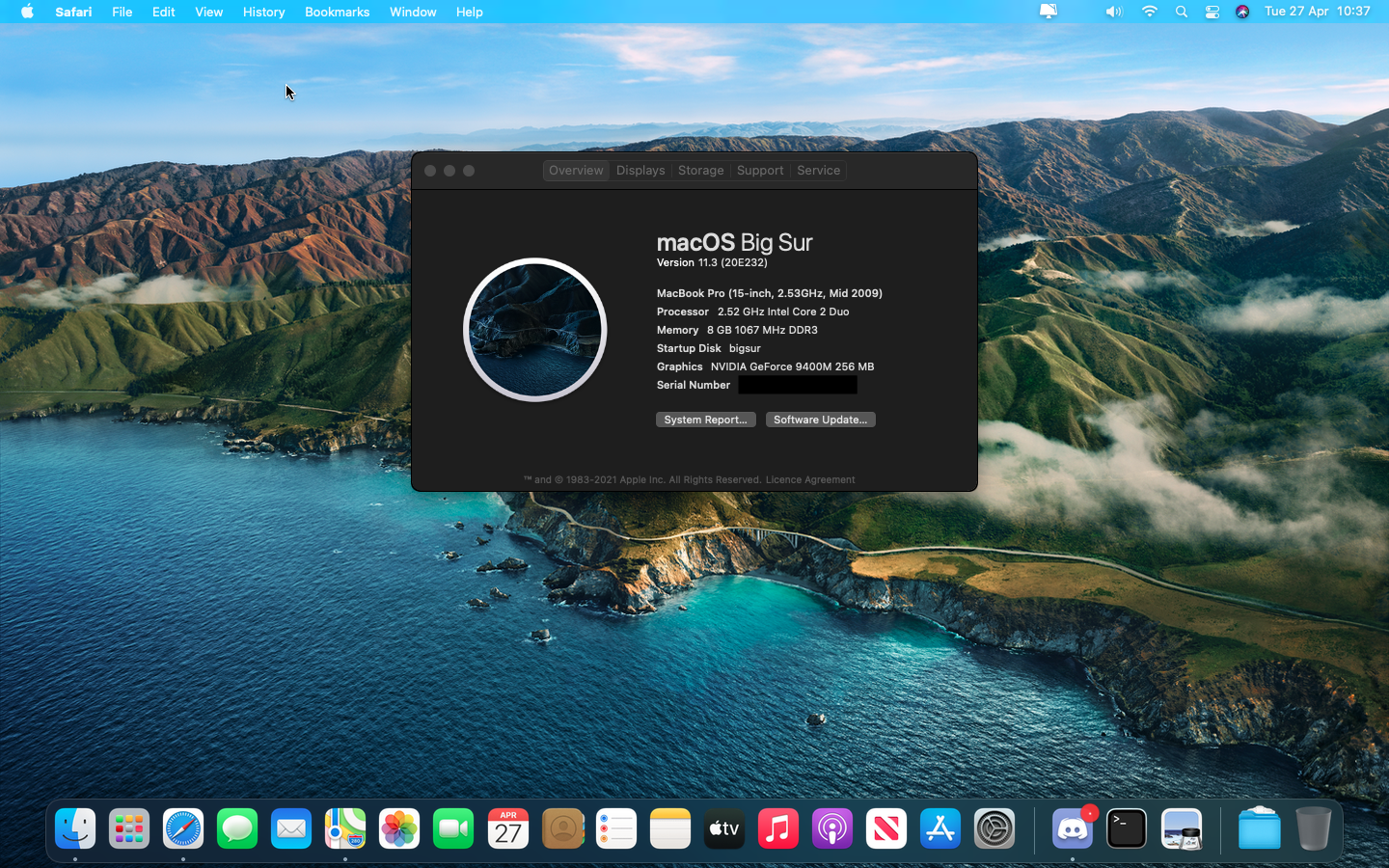

Overall working very well! MBP5,2 completely usable with BS now.
I've seen a problem when enabling transparency reduction: then the left part of the menu bar is not updated correctly when changing the foreground window.
Once I shut down with transparency disabled, then after booting the left part of menu bar remained blank so couldn't do much from there on. Then I remembered jackluke's reducetransparency fix command which he provided long ago #2,275 .
Changed the setting in there from true to false, applied, rebooted - that was the rescue.
Some small graphics glitches, like not displayed symbols in some system settings, really don't hurt.

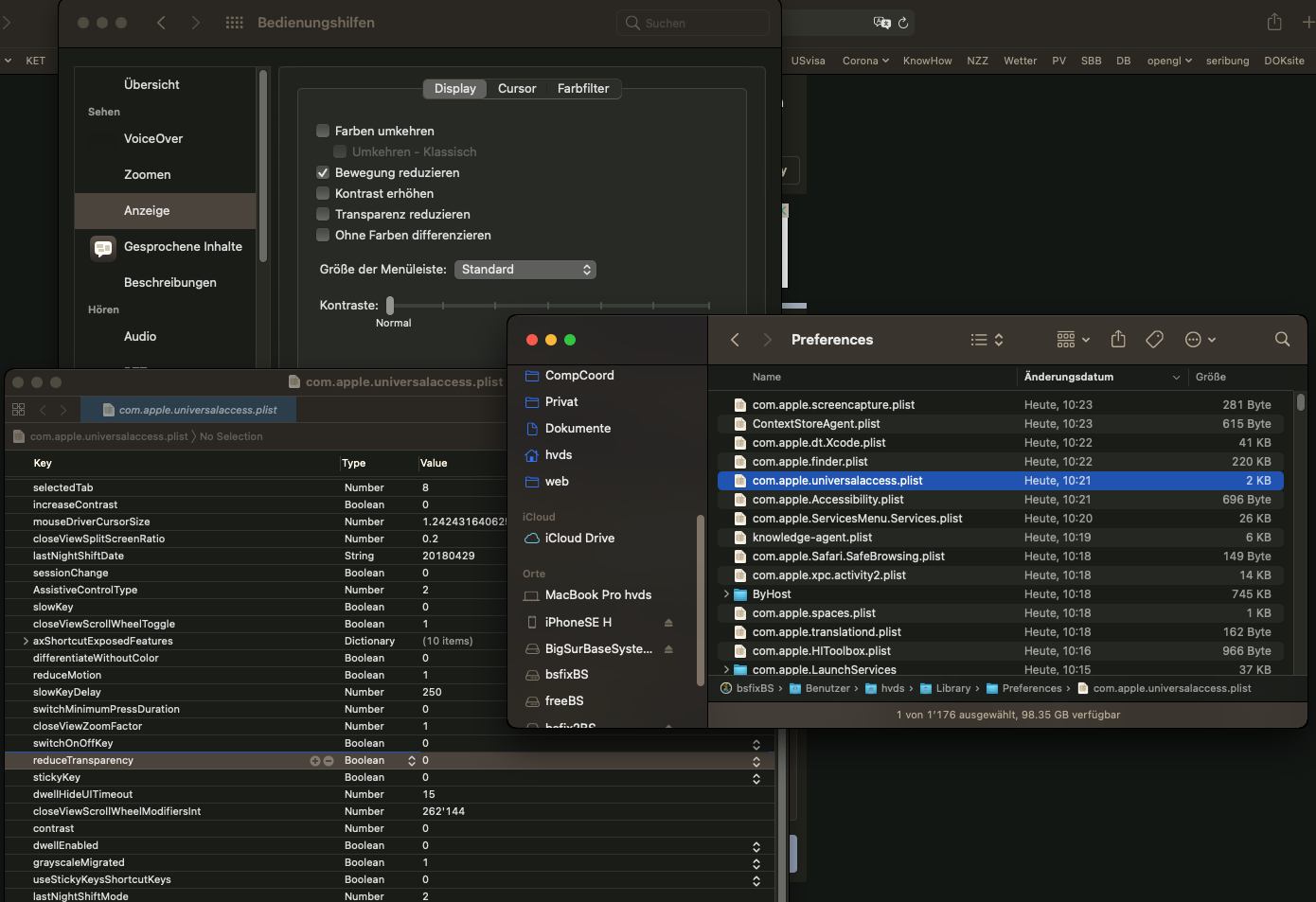

Re: reduced transparency and present release of the non-metal acceleration.
Just to show the place one can switch transparency reduction, should the appropriate system setting not be accessible. The universalaccess.plist is binary so less easy to change without Xcode. In this case use jackluke's command mentioned above.

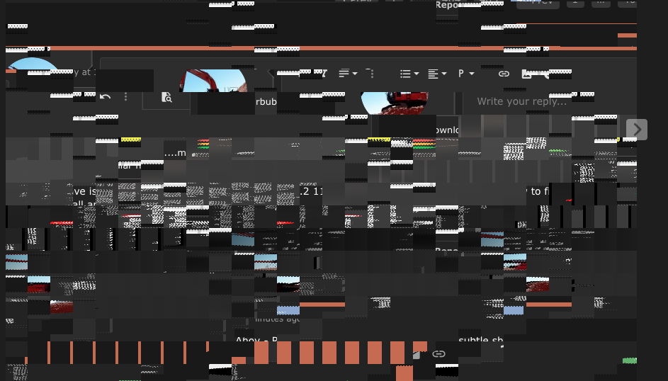

Ahoy - ResXtreme was able to eliminate the subtle shimmer in Big Sur 11.3.1 w/OCLP graphics patches. 😎
