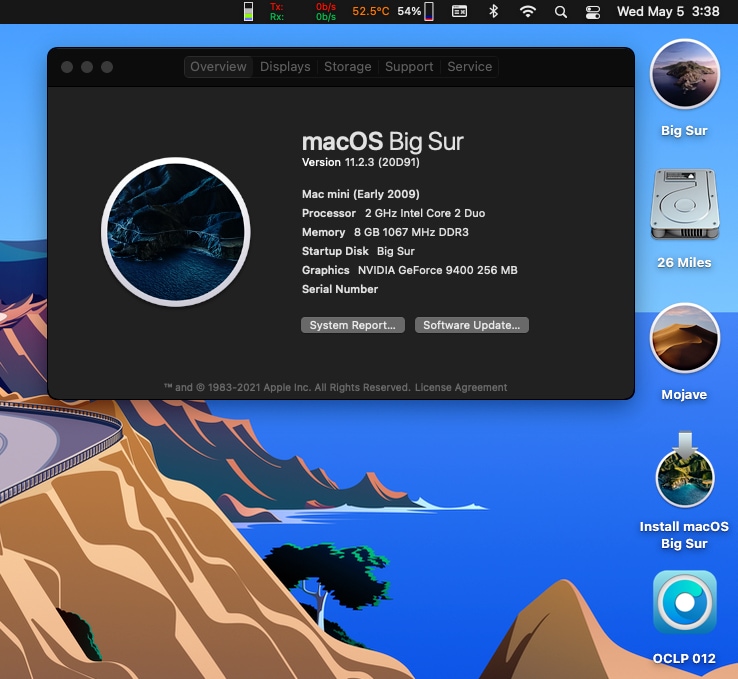

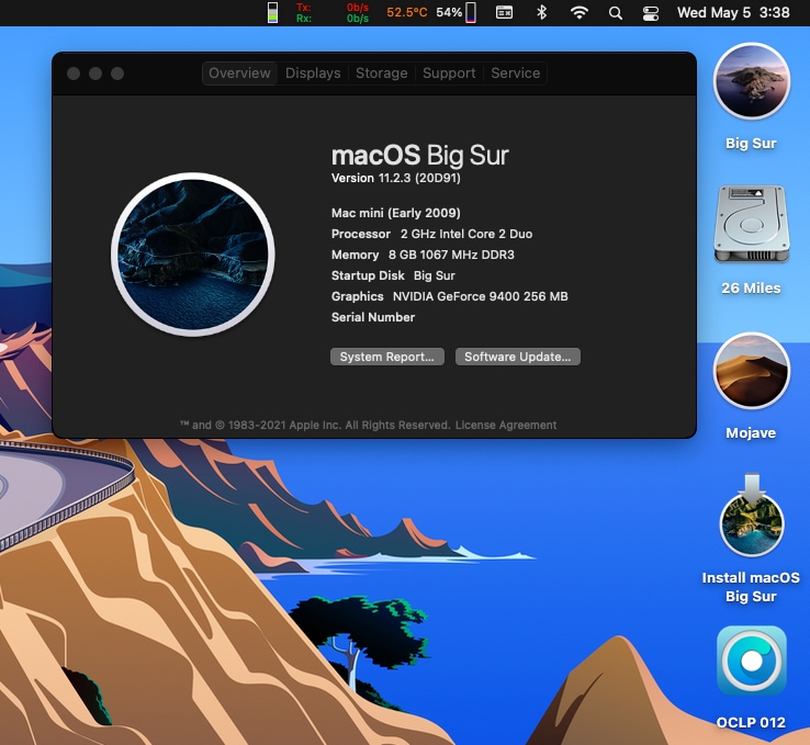

Big Sur success 11.2.3 on Mini3,1. OCLP 0.1.2 as nimble as Catalina running from external SSD. Worth the effort.

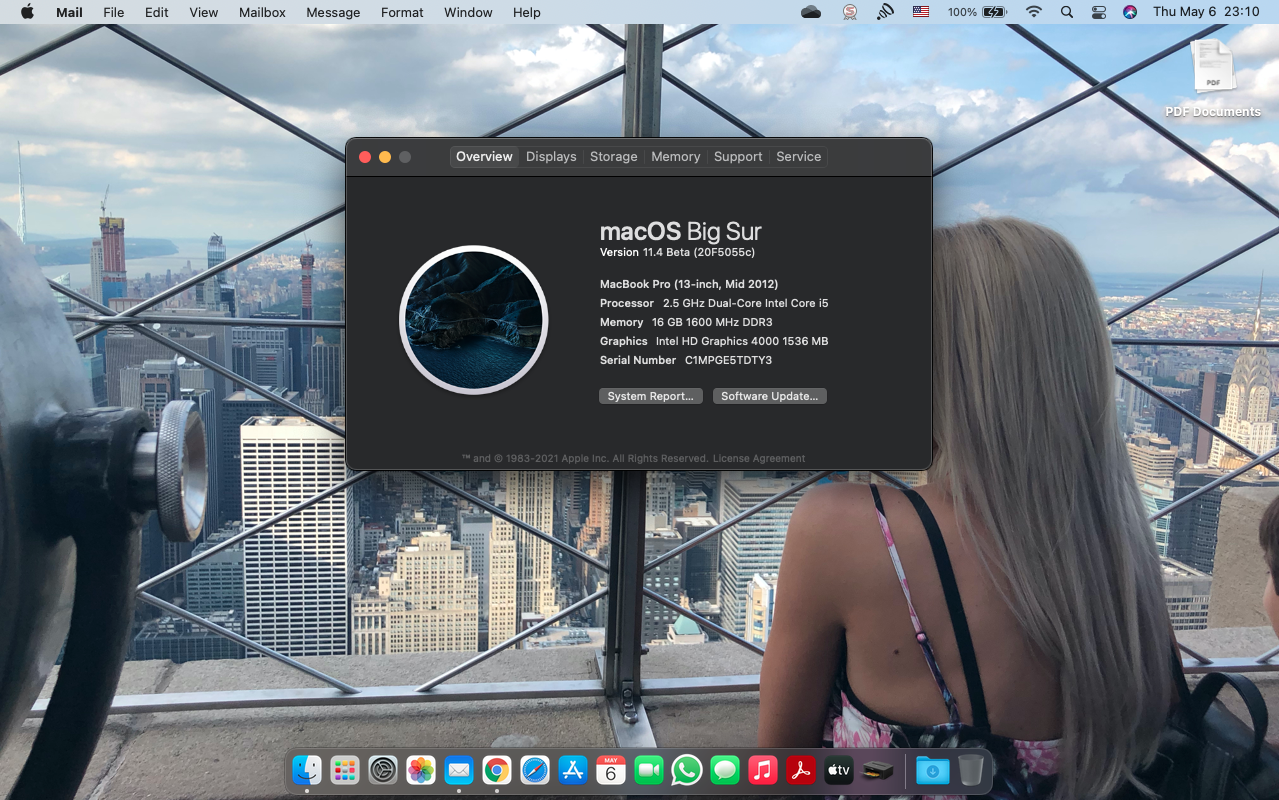

Successfully updated to macOS Big Sur 11.4 Beta 2 my MBP mid 2012 - 13" using Barry's micropatcher v.0.5.1. Everything working perfect.

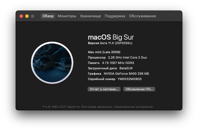

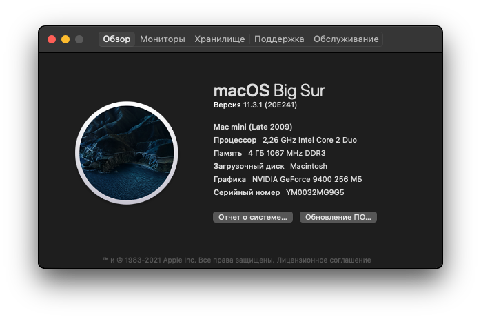

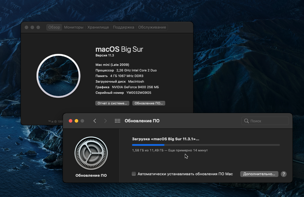

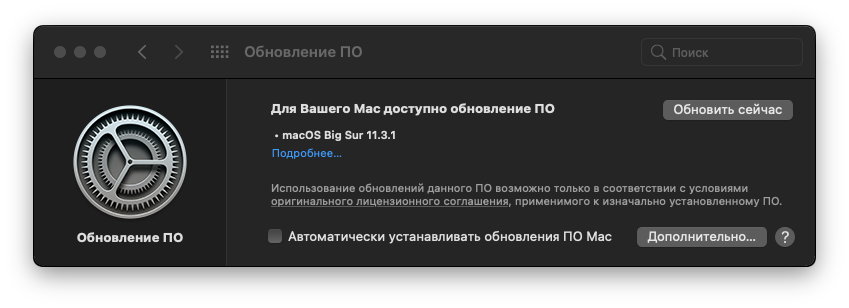

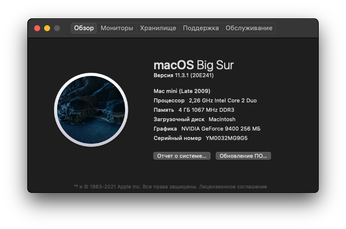

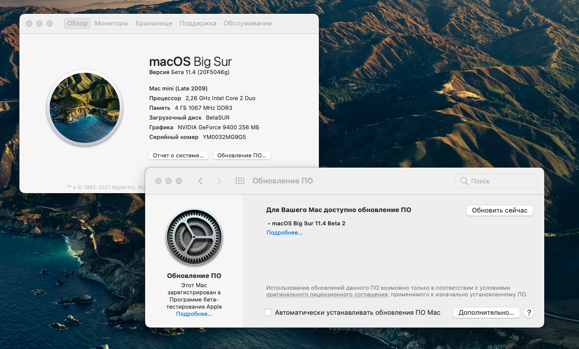

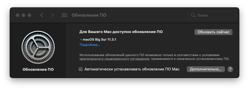

Successfully Updated both system on my Mac Mini 3.1 (Late 2009)
From 11.3 to 11.3.1
No issues.
P.S Updated OC config by OCLP 0.1.2

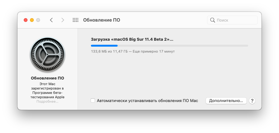

View attachment 1770413View attachment 1770414View attachment 1770415

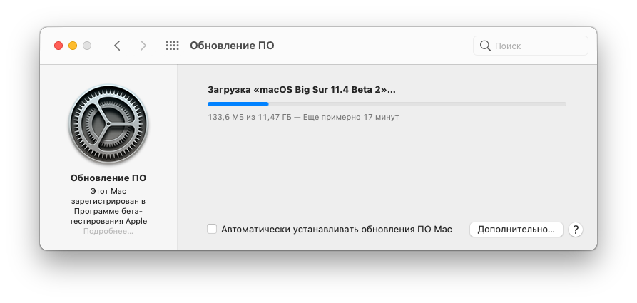

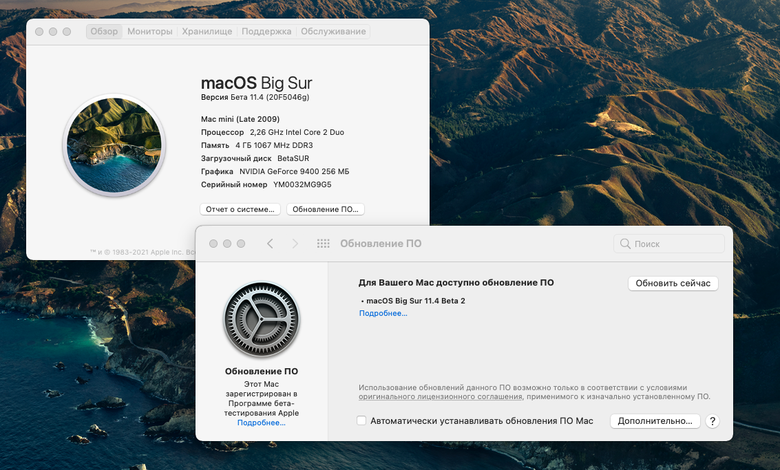

From 11.4 Beta1 to 11.4 Beta 2
Issue - freezes on every reboot in update process.
After update and applying system volume patch - works fine.
View attachment 1770416View attachment 1770417View attachment 1770418
Screenshot app is broken in 11.3.1. No controls gets stuck open, use esc to dismiss. Was OK in 11.2.3. OCLP 0.1.2 into Mini3,1. Can you confirm?
Reactions: macinfo and Pri-est
Cmd-Shift 5 opens Screenshot for me on 11.3.1; or you can click on the App in the Launchpad. All functions seem normal.
Also Preview->File->Take Screenshot works.
