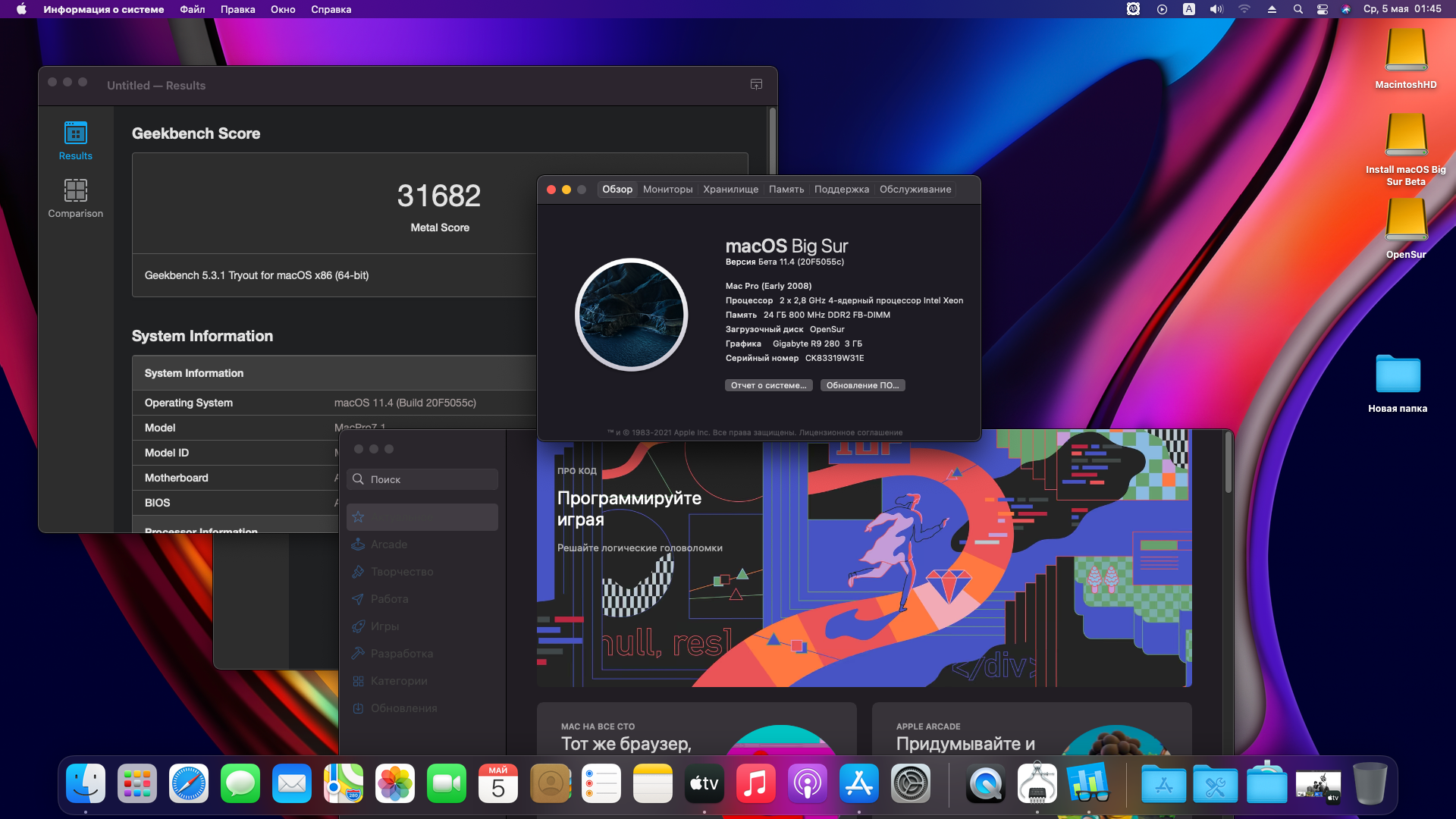

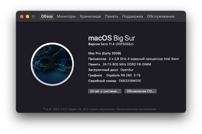

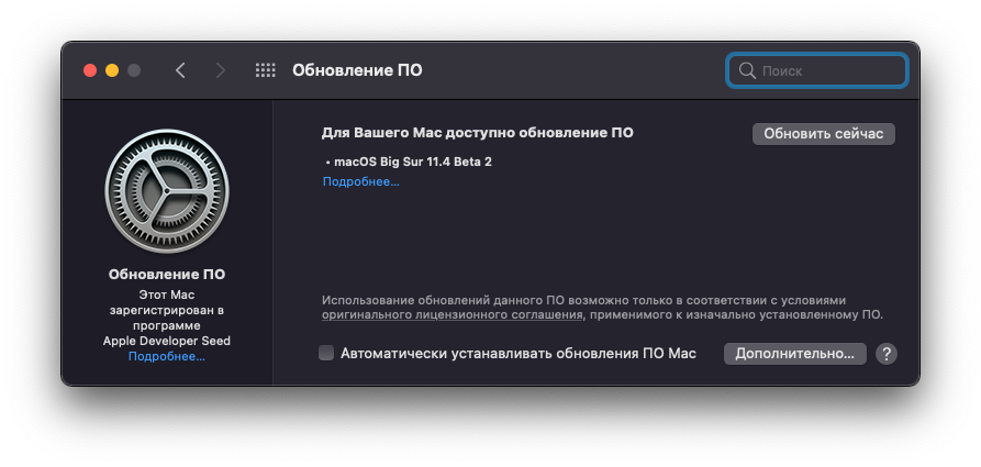

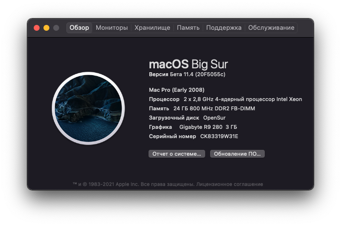

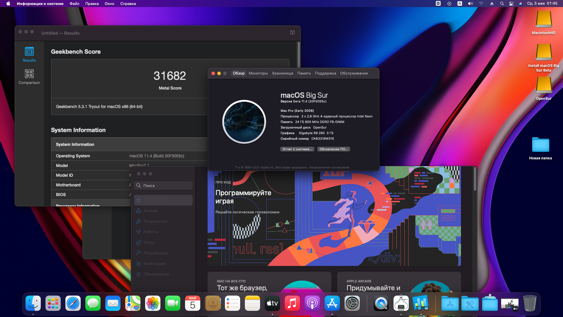

Hi!
Successfully got update 11.4 beta2 on my Mac Pro 3.1.
Just pushed - "Update" and waited some time.
P.S Previosly i updated OpenCore config by OCLP 0.1.2
Mac Pro 3.1 Specs
CPU 2xE5462 2.8ghz
RAM 24GB (6x4GB) 6400f DDR2
SSD M.2 PCI-AHCI Kingston HyperX Predator 480GB (with cheap orient M.2 - PCI Adapter)
GPU Gigabyte R9 280 3GB (Mac Efi flashed)
BootRom mods - APFS support, NVME support.
View attachment 1769833View attachment 1769830View attachment 1769832

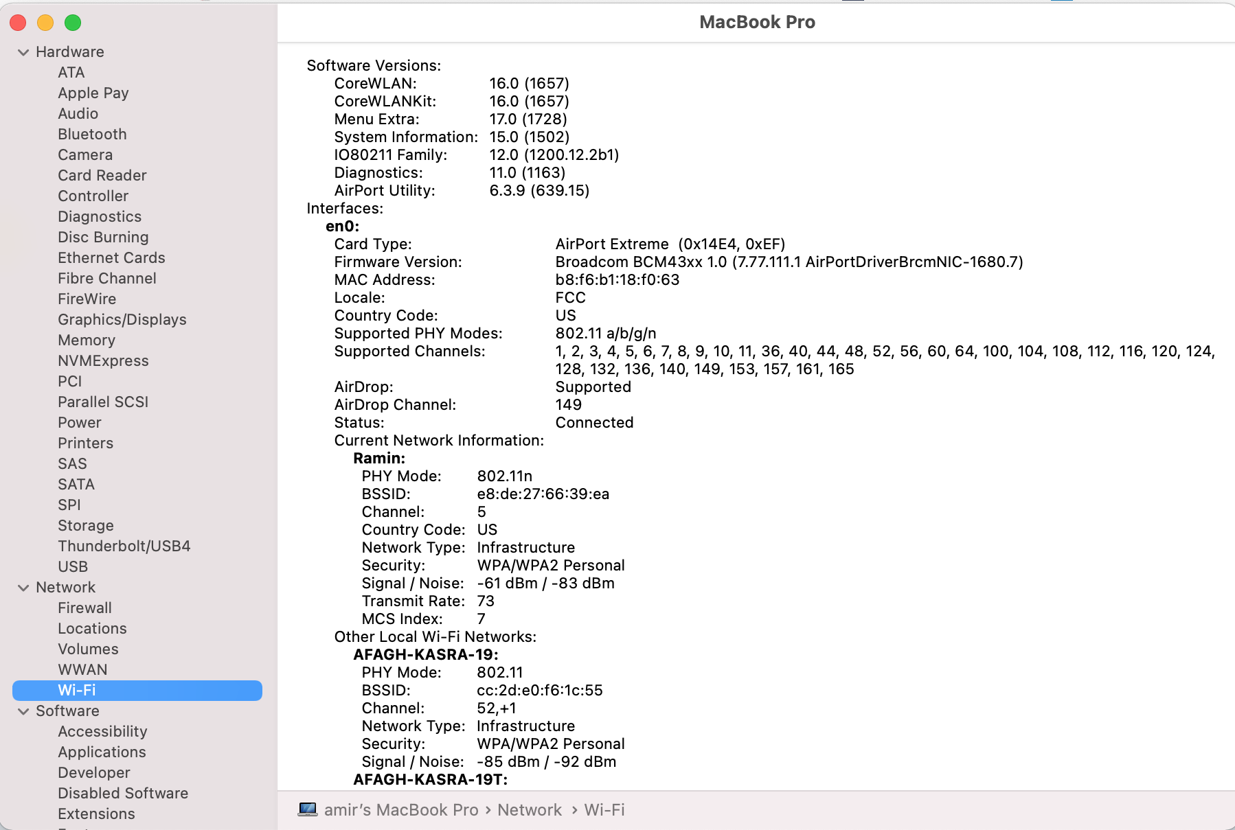

hello everyone
I am an amateur and unfamiliar user
after install Big Sur 11.3 on my MBP 10.1 (retina 15" mid 2012) by OpenCore Legacy Patcher v0.1.2
my WiFi country code has set to US. i live in Iran. coz of this, my macbook location services unable to determina current location at this time and i cant use Location services.
two days ago Mr @khronokernel guide me what should i do for fix this.
he said :
"you can set brcmfx-country=XX to change the country code to other regions. For Iran, I believe it's IR
So in your config.plist, open it up and look for boot-args. In the entry, add brcmfx-country=IR and reboot. Then check System Profiler -> Network -> Wifi and see if the country code correctly updated
If you're unfamiliar how to get your config.plist, you'll need to find the drive you install OpenCore on and mount it with MountEFI. Then, go into EFI/OC/config.plist and edit from there"
i could find and mount my mac EFI by MountEFI and i found config.plist.
but as im an amateur and unfamiliar user,i cant configure and write code in config.plist to chang my WiFi country code.
i attached some screenshot and too i uploded my config.plist
anybody here can help me and edit my config.plist right , plz help me or guide me how should i do
thx

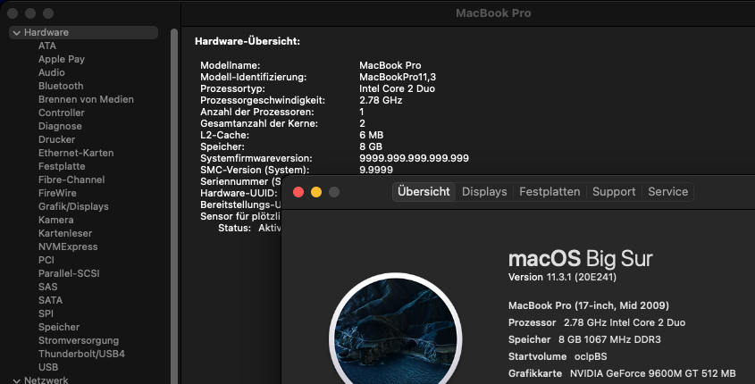

Updated MBP5,2 to 11.3.1 from 11.3.
This is a system-volume-patched system, to have graphics acceleration.
The update was offered in system settings. Download a little above 11GB, I stopped it to use the full installer.
Started the 11.3.1 installer app. Stage 1 is announced to take about 1.5h, so stopped this as well.
Then made with createinstallmedia a new USB installer for 11.3.1, and installed this via OCLP 0.1.2. One freeze during installation, retried with manual power-off and reboot od macOS installer via 0.1.2, then proceeds right to login. Ran 0.1.2 in booted system to re-apply graphics acceleration patches.
All running fine. Setting up prior to graphics acceleration patching is a bit slow, but once done, the MBP5,2 is still a very usable system with BS.

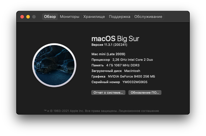

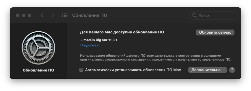

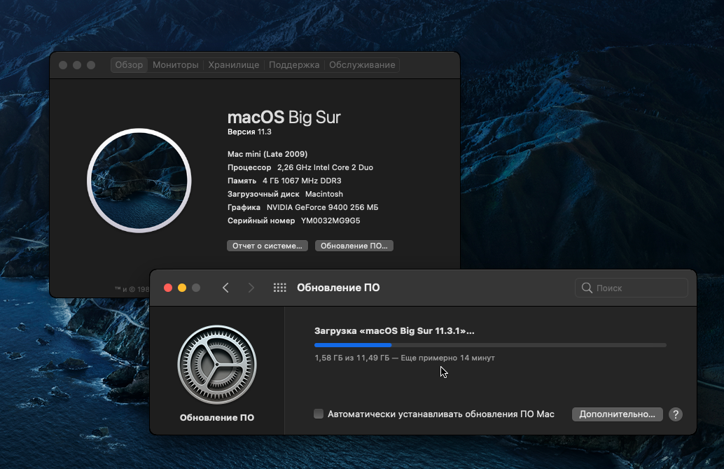

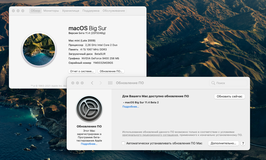

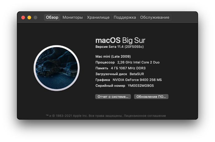

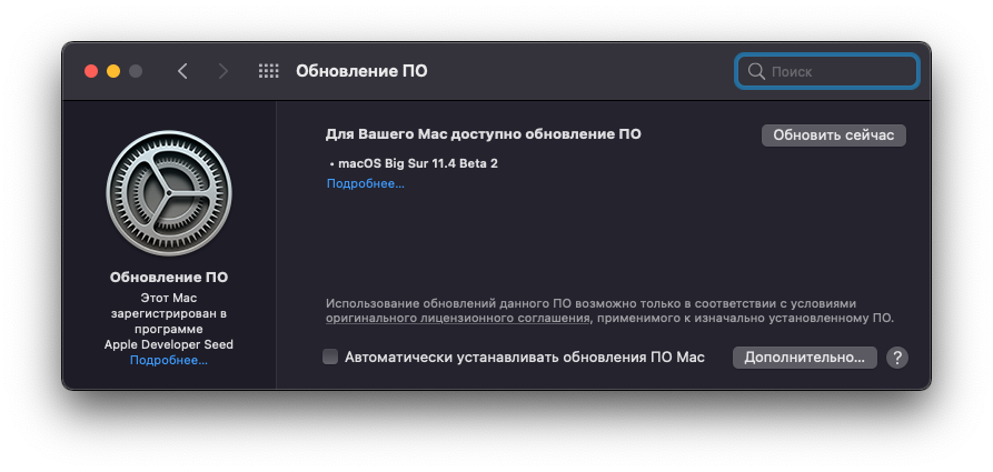

Hi!
Successfully Updated both system on my Mac Mini 3.1 (Late 2009)
From 11.3 to 11.3.1
No issues.
P.S Updated OC config by OCLP 0.1.2

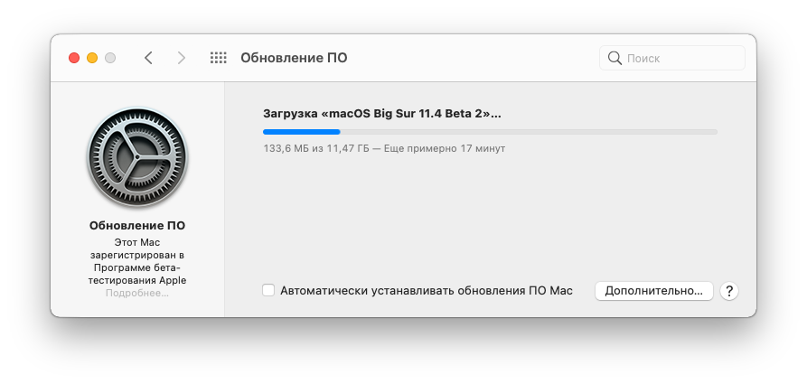

From 11.4 Beta1 to 11.4 Beta 2
Issue - freezes on every reboot in update process.
After update and applying system volume patch - works fine.
See this my reply, few pages ago.
Thank you. Just did this, including removing the USB; everything seems to be working fine.
