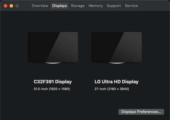

So, I did it. Installed 11.3.1 OCLP 0.1.2 over my 11.3.1 BarryKN micropatch 0.5.1. on my iMac 14.2 late 2013.
And have a problem. There is no signal on my 2nd monitor NEC PA301w wia TB. It was OK before OCLP installation. Need HELP!
If you are able to edit the boot-args within the opencore config.plist file or the config.plist at all (now please read the full OCLP docs) than you might try to add this agdpmod=vit9696 to the boot-args. If you have there already an entry (or in the DeviceProperties section) like agdpmod=pikera just replace the pikera with vit9696.
If these instructions sound like Böhmische Dörfer to you than please just wait for a fix in the official distribution. There is already a quite similar issue open and under exploration.
And I advice clearly against this installation over an existing patched one. The patching destroyed the cryptographic integrity of the root file system and other used hidden partitions and you can experience problems later on.
Backup, delete the APFS container/partition holding the complete Big Sur stuff, do a clean installation and do a restore. I have been though this several times on my test systems during the migration tests. The last installation with such problems has been deleted just a couple of hours, ago.

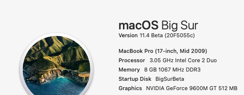

Right, also here on MBP5,2 (on 11.4b1), the icons are invisible, but when placing the mouse over them, the descriptive text shows - so one can still select the desired option. Just above the dock.
Hello hvds:
I was actually able to install 11.4 beta 2 via OCLP 0.2.1 (see post on page 405). (My CPU is near twin to yours)
Jacklukes's method did not work for me to install 11.4 beta 2, but worked perfectly for 11.4 beta 1 installation;
I did not have a chance to investigate why this was the case.
The icon problem does exist in some windows, but majority of icons are fully "drawn".
Hope this helps

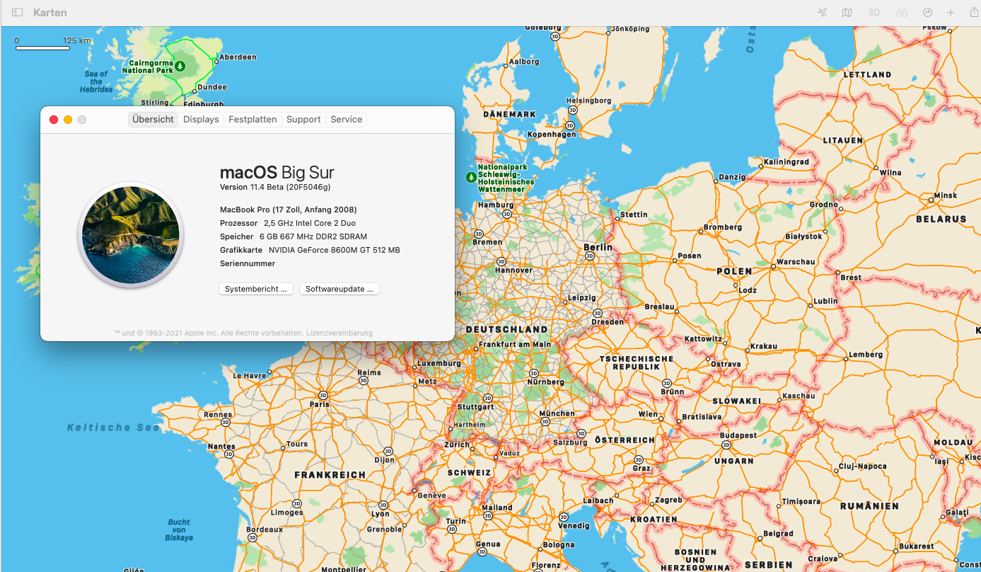

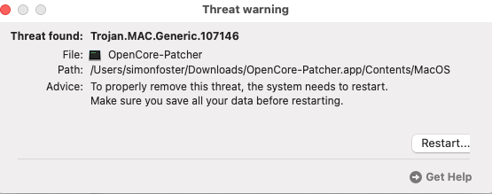

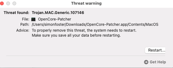

Has anyone else had a virus warning when downloading and unpacking open core from GitHub? The anti-virus is Bit defender. I've been using an earlier version and it has been no trouble so not in a hurry to upgrade just thought I'd ask

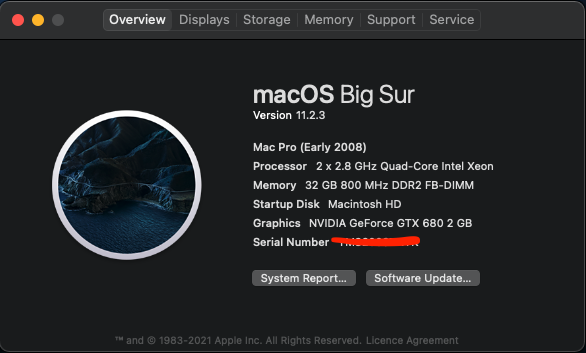

Hi! I just installed Big Sur using OpenCore successfully on my iMac Early 2009 and I hear no sound and no brightness control. Can someone please help me fix those two? Thx! Apart from that, just a few graphical bugs and everything is working fine!!!

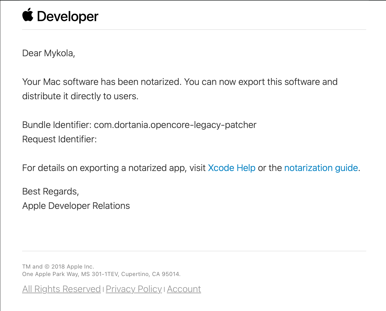

I also had this. I assume it is just a false positive. Can anyone confirm? I added it to the exclusion list.

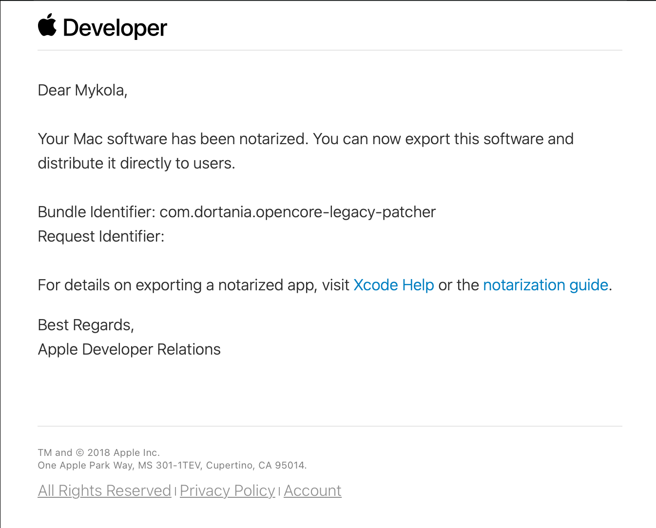

For reference, Apple themselves notarize OpenCore Legacy Patcher. Our source code is also all public and built with pyinstaller to make the simple .app you see. Each time we commit or do a release, we have our server build the app, sign with apple and have it hosted on our repo through Github Actions.
Not entirely sure why Bit Defender would flag us, though I know on Windows all pyinstaller binaries seem to get flagged by Windows Defender. My guess is they copied Defender's rules and applied universally
 .png
Thanks for the confirmation. And double thanks for OCLP! Looking forward to at least one more year using my Mac Mini. :)
