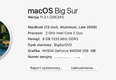

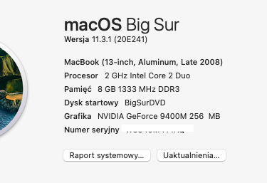

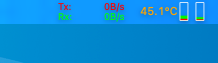

I sucessfully installed Big Sur 11.13.1 on MBP Pro 5,1 with OCLP patcher 🙂 Many thnaks to khronokernel, dosdude1, ASentientBot and other devs for this great work which is making such old machines like mine to work with newest systems 🙂
My MBP is preety usable for internet browsing and other light tasks 🙂 works similary like od Catalina from dosdude1 patcher.
During installation installer stuck on half of progress bar, I had to reboot computer two times, but finnally installation was finished. 🙂
On version 11.2.3 the installation proceeded automatically.

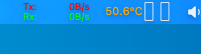

I noticed one thing odd thing. When running Catalina, computer was idling with temperature about 43*C on CPU.
On Big Sur things are different. I noticed that idle temperatures rising after screen goes sleep and are about 50*C.
When I disable screen powering off in power preferences computer idling with temperature about 45*C which is fine 🙂
On Catalina I not observing such behavior.
Maybe someone has an idea what could be the reason?
Regards! 🙂

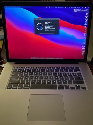

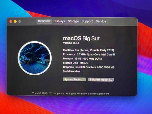

I recently got a pristine Early 2013 15-inch Retina MacBook Pro (10,1) and used OCLP vers 0.1.4 to install Big Sur 11.3.1
Method Used: OpenCore-Legacy-Patcher by @khronokernel and @dhinakg (vers. 0.1.4)
My wifi card installed is a Broadcom BCM43xx 1.0
I found the process very easy to follow and straightforward.
Awesome work to dosdude1 for compiling all the info to make this thread and allow us to have the info at our fingertips so to speak, also to everyone involved in developing OCLP my thanks for taking the time to develop this app to make installing Big Sur an easy process
I can now say that all the laptops listed in my signature below are running MacOS Big Sur
Everything is running perfectly after this install. No issues.

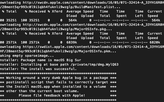

Today I updated my MacBook Air 4,2 mid 2011 using OCLP 0.1.4 patcher to version 11.3.1. However, I sighted this last paragraph on the terminal window. Will it make any difference? Just curious.
Also OCLP made the MacBook air boot thrice and took a very long time to upgrade from 11.3 to 11.3.1 but finally I was on the Login page of BigSur.🙂 Only important element missing is the brightness slider in display. Cannot adjust display brightness. Guess I have to download a 3rd party slider from apps store

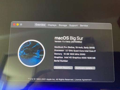

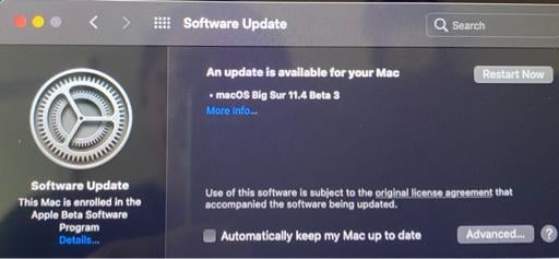

EDIT: I did a successful OS update to 11.4 Beta 3 this afternoon. 🙂
Hello to all,
1) Successful installation of 11.4 beta3 on iMac 13,2 (late 2012)
Method: micropatcher by @Barry K. Nathan. (version 0.5.1)
All system functions operational.
2) Successful installation of 11.4 beta3 on MacBook Pro 5,2 (17" mid-2009) with an SSD
Method: OCLP version 0.1.2 - see post 10107 on page 405 for instructions.
Graphic acceleration is present with some minor glitches.
Keyboard lighting is absent, but can be activated using application LabTick (no association with that program).
Maps do work, though I can not use main address search bar (maps crash). However, choosing (clicking-on) one
of the old addresses (listed in original search window), opens another small window which will accept new address
in its search-bar, and functions as expected.
Hope this may be of help.

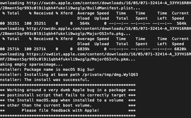

That "Working around a very dumb Apple bug ..." was a subject I posted about some time ago. It comes from a python script called "installinstallmacos.py".
If your install went without problems, then you have nothing more to do. As I understand, the bug requires all peripherals to be unplugged, even microSD cards, lest the installer confuse them with your intended target volume.
