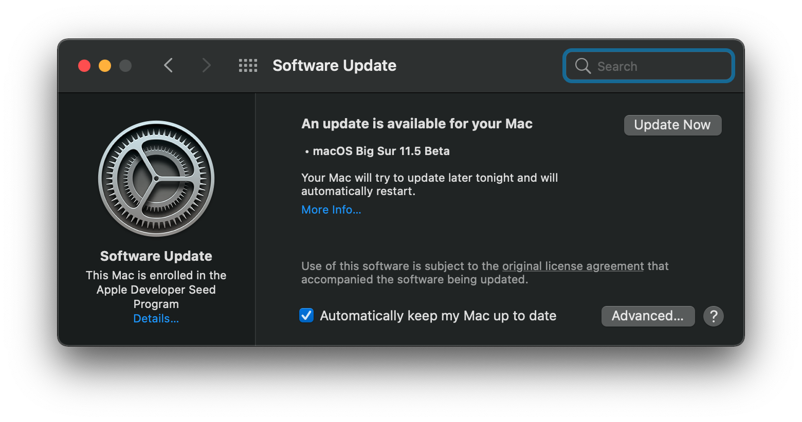

macOS 11.5 20G5023d Beta 1 has been seeded to developer channels, as usual no InstallAssistant yet
