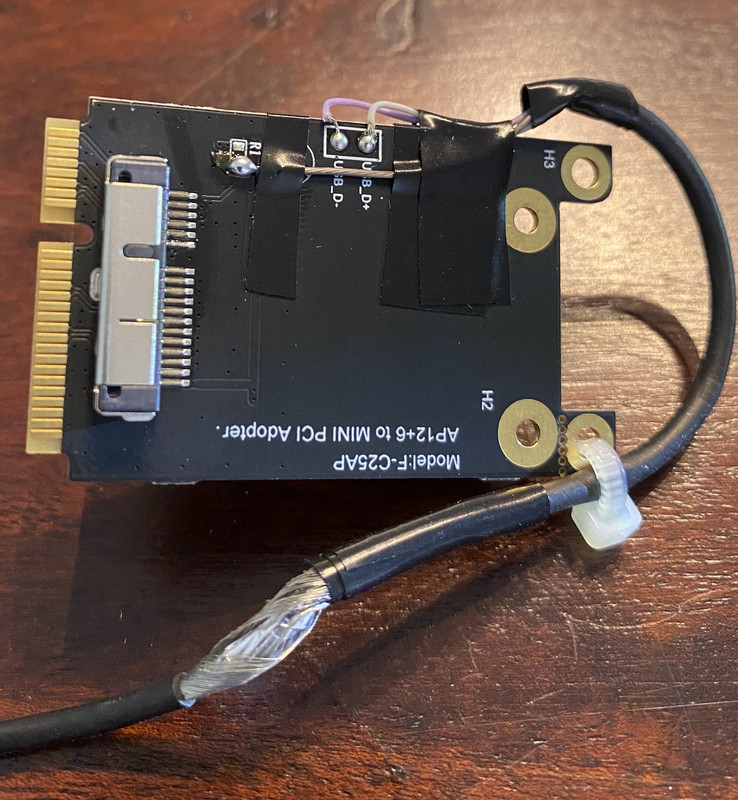

My guess: Check and change the Mini PCIe carrier board and check the soldering of the D+/D- cabling.

Yes, it ran fine on High Sierra. Picture of my (own) PCIe carrier board is below. I also triple checked all BT antenna connections. The most obvious issue would be the card itself, but the behavior is the same with a completely different card.

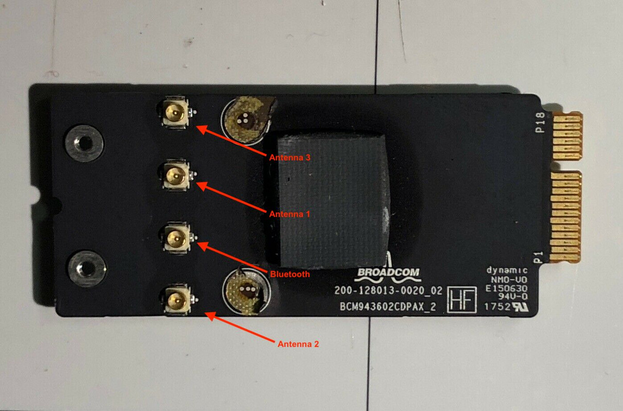

Also, I've always connected the BT antenna to the connector below. I even tried connecting it to different connections, but that didn't work at all:

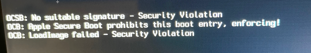

After removing the HS boot SSD (external), I seem to have mangled my OCLP booter with this this message:

Exchange the PCIe carrier board and redo the cabling. The odds you got to BT/WiFi cards with dead BT are low....although all these (used) cards might end up on the used parts market for a reason.
About the security violation: Disable SBM, again. Booting into High Sierra can mess the Big Sur Preboot I am told. How to fix this using the /etc/fstab has been published some posts ago...To fix the Preboot you can re-install Big Sur or wait for the next update (11.4). Meanwhile fix HS auto mount of Big Sur partitions. Do not mount a single one within HS.
