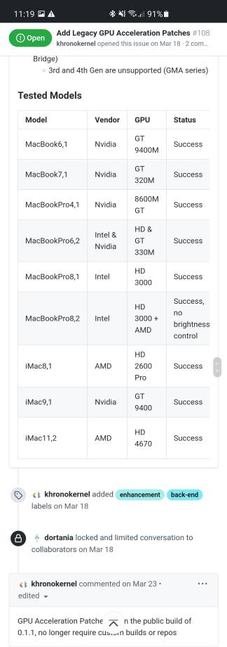

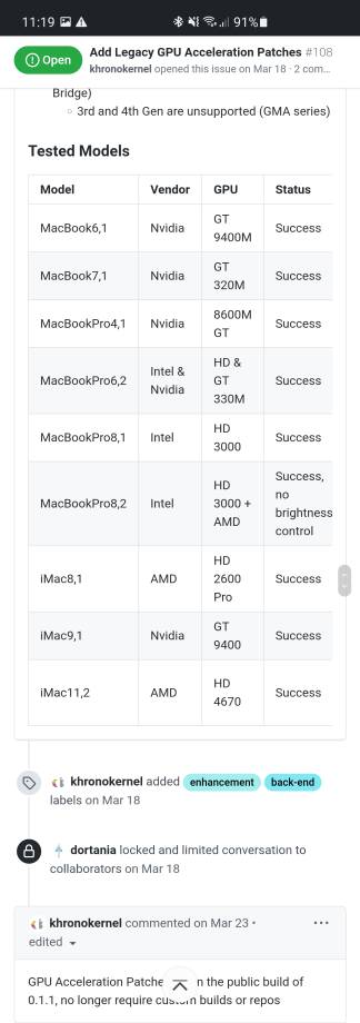

The support list within the OCLP docs clearly states which systems are fully supported and which do not have a metal capable GPU and need patches.
You should probably edit your post because if leaves the wrong impression this system would run (barely usable) slow.
I was writing about the official OCLP docs linked in on the first post of this thread, on the OCLP GitHub page.
* Not officially supported in macOS Catalina, but are fully capable of running both Catalina and Big Sur with a Metal-compatible GPU and upgraded WiFi/BT card.
+ graphics acceleration added back by @ASentientBot (
OpenCore Legacy Patcher list of GPU support)
So I am pretty sure you ignored the lines I wrote as best as you could :) Sorry about that.
