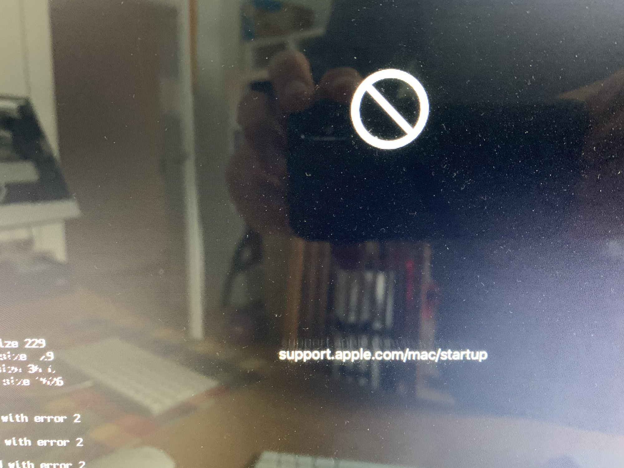

Updating my iMac11,3 with AMD RX480 and BCM943602CDP to 11.4 via software update was quite a journey. Needed several forced reboots to get id done.
OCLP 0.1.5, minimal spoofing
Edit: Same with Late 2009, WX4150, stock BT. A single forced reboot necessary after this screen came up.
