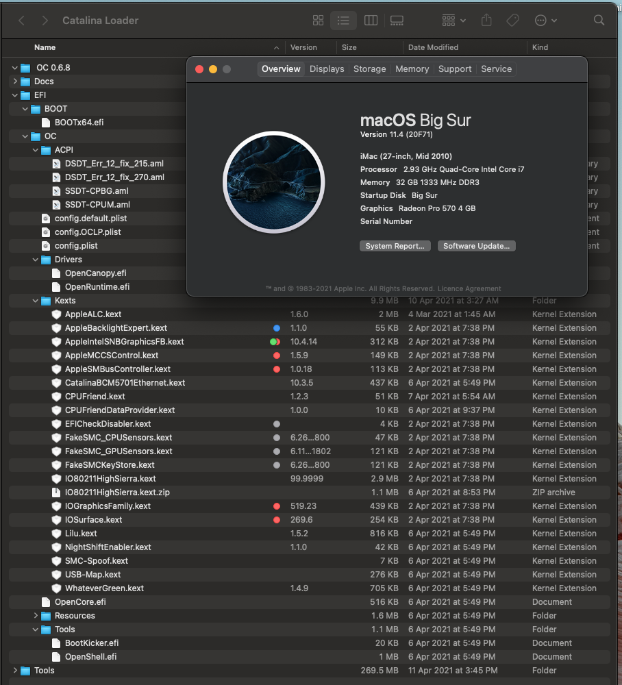

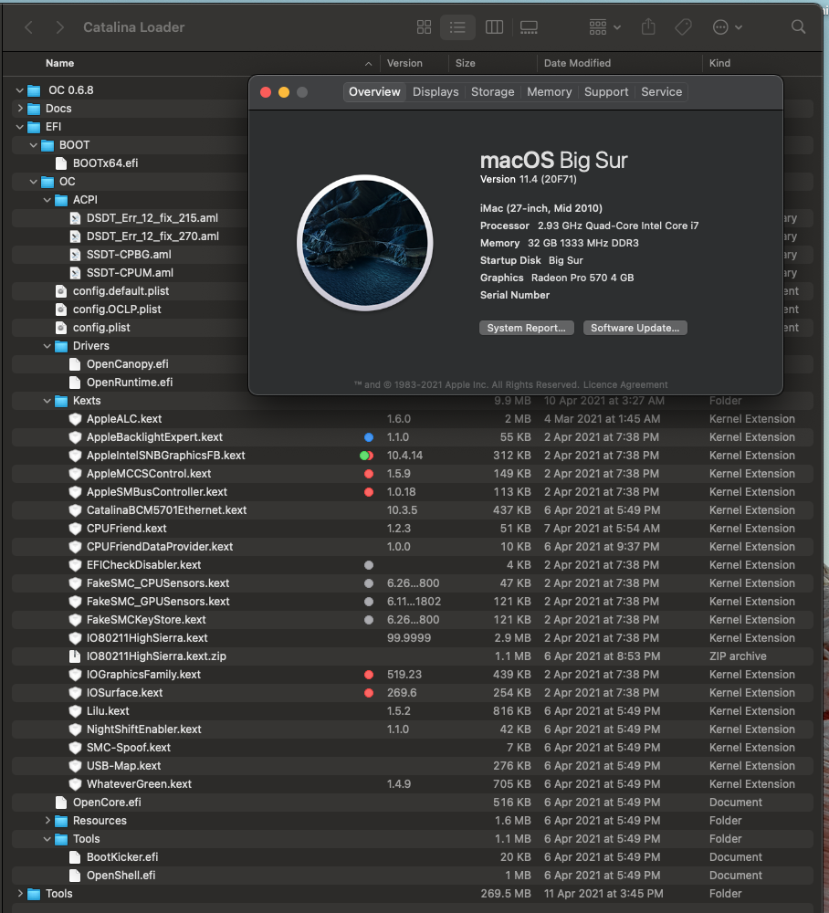

Got my iMac 2010 with RX480 updated from BS 11.2.3 directly to 11.4.
A bumpy road.
The BS 11.2.3 was installed with help of OCLP 0.1.2 on an SD card, which was later updated to OCLP 0.1.5.
With OCLP 0.1.5, I created an USB BS Installer of 11.3.1 initially and later 11.4, but both cannot upgrade my BS due to hanging in middle of 2nd stage of installation (running the mac OS Installer). Despite multiple reboot, it just couldn't pass thru the second stage.
Finally, to see what is causing the problem, I enabled the verbose mode of OCLP 0.1.5. Surprisingly, as the texts flew thru on screen, I could see the 2nd stage installation with an Apple icon above a display of time to finish (~27 minutes) with count down which was absent in prior reboots. However, it finished with a stop sign and messing up the text display on screen.
I thought it failed and swapped out the SD card of OCLP 0.1.5 with verbose mode ON to one with OC 0.6.8 from the older days of using iMac Micropatcher to install Big Sur 11.1. I got my second surprise that the system booted smoothly to 11.4 ! I then rebuilt the OCLP 0.1.5 (AMD with minimal SMBIOS patch and full SIP & SecureBoot) with verbose OFF and exchanged with the OC 0.6.8. Everything still works fine. What a puzzle ....
I can confirm that there are situations (quite frequently) when I have to boot my iMac 11,1 in verbose mode for the boot process not to hang early.
full fan power button re-start, then OK at next boot

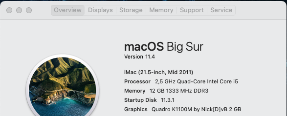

Successful OTA update iMac 12,1 from 11.3.1 (fresh install OCLP 0.1.5) to 11.4 from the second attempt.
1st attempt: all went like it should, but after final reboot update was not installed and OS start to download and prepare update from scratch.
2nd try gone without issues.

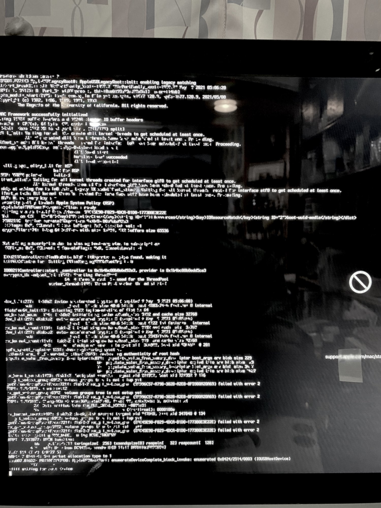

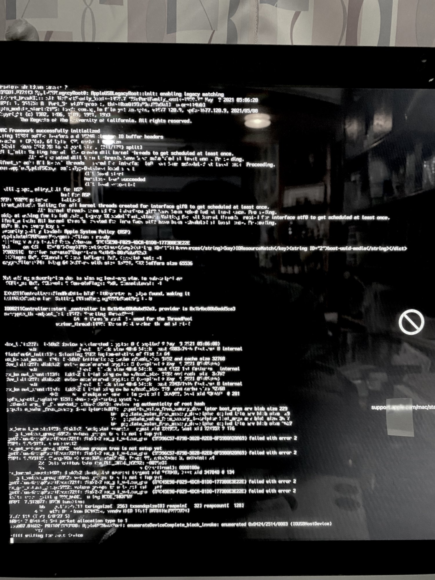

I am using the Micropatcher Automator and have a peroblem. After I finished the Big Sur install I got a kernal panic. I then booted holding the option key and had the following: EFI looks like a ndisk, my HD, Install Big Sur and another EFI looks like the SD card. How do I boot to the post install utility? This is on a MacBook Pro
Hello @khronokernel . If you happen to see this message please let me know your thoughts on an issue I am facing.

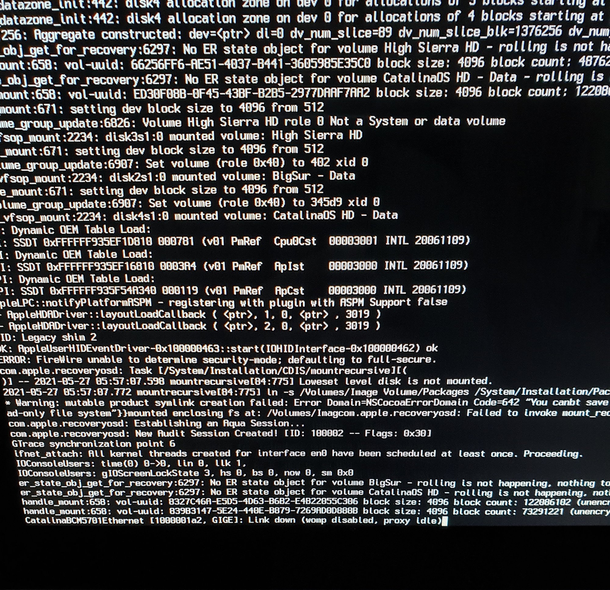

I have my OCLP installer ready with 0.1.5 version and OS 11.4 to install over the exiting BIGSUR version 11.0.1 on my iMac 12,2 mid 2012 27inch. Every time I try after pressing option key, selecting the EFI and starting the bigger installer I get stuck after progress bar moves just before the apple logo. See image.
I tried with verbose mode enabled and the screenshot will tell you more as I am no developer and cannot make out the issue.
I wait for almost 5-8 mins and then have to force shut the machine.

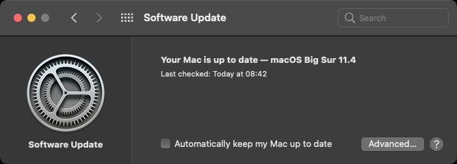

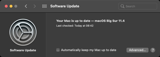

Not sure what I did right to some others but I went from 11.2.3 to 11.4 without a hitch, just like a regular upgrade on my Mac Pro 5,1 (Mid 2010), Radeon 5700XT, PCIE NVME drive, USB 3 PCIE card.
The only thing I did was to detach all the other drives from the sleds so only the NVME was attached.
Rebooted a couple of times and did give me a warning symbol but I did nothing the machine restarted itself anyway and am now writing this message on here via the Mac Pro.
Using OC 0.6.7.

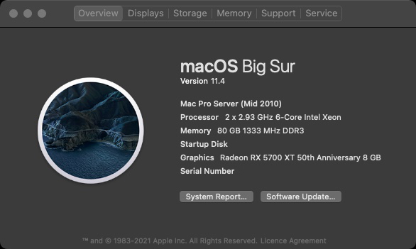

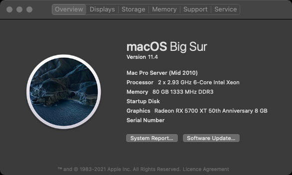

This is hopeful for us MP5,1 users. I haven’t tried updating so am still on 11.2.3.
I was pointed to this separate thread https://forums.macrumors.com/threads/mac-os-11-3-has-broken-support-for-older-mac-pros.2289056/ for all info on the 5,1 issues; might be usefull to post your experience there as well.

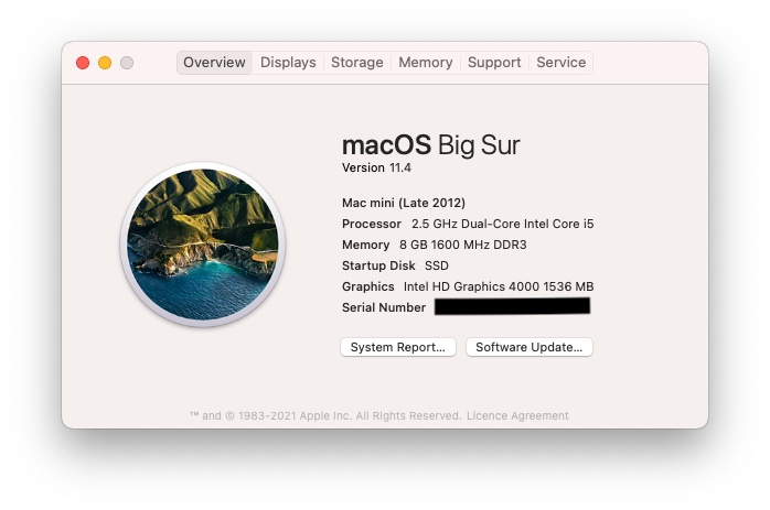

Quick update on my 2012 macmini6,1.
Did the OTA to 11.4 today. Went perfectly.
Also updated OCLP to latest release 0.1.5 just before triggering the OTA. All good.

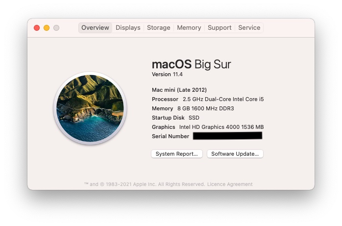

Finally here with a 2.3 GHz Intel Core i7 four hearts (Macmini6,2) with 16 GB of RAM, i decide to came back to Catalina, because my mid 2012 was starting to heat more than usual and turn the fan, with in the activity monitor a kernel-task a little high.
Not sure what fixed the intermittent crash on re-boot but OCLP v.0.1.6 nightly, giving OCLP Full Disk Access and running Killall Finder in Terminal before re-boot erased the problem in 11.4. 😅
There were several random crashes with Big Sur 11.4 and OCLP 0.1.5 on my 6,1 MacMini. I downgraded the OCLP to 0.1.2 and it is a little better. Still, Safari and Zoom crashes occasionally.
