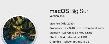

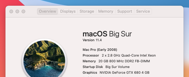

Successfully updated Mac Pro 3,1 from 11.3 to 11.4 (install and update using OCLP 0.1.2)
The only problems I've noticed (in general, not specific to 11.4) are:
  • Rebooting - often freezes during boot, and need to restart.

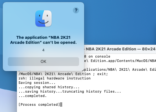

  • NBA 2k21 Arcade Edition won't open (and I suspect there would be other games with the same problem, but haven't tested):
Other than those things, Big Sur is running great on this Mac - massive thanks to all who have helped make this happen.

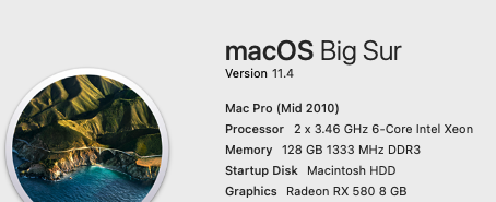

In my quest for getting the most recent version of Big Sur to install on my MacPro 5,1 another milestone has been reached.
After erasing the HDD (connected via SATA2 bus) used for a successful installation of 11.3.1 after a failed update to 11.4 it seems to work some of the time. There was no way I could get it do anything useful by booting a 11.4 USB and formatting/installing it from there. What I did was format it from 11.2.3 (2.5" SSD connected via PCIe adapter) and run the installer after that.
After it does the normal reboots to install 1 of 6 things happen:
1. At 1/3 progress it will hang indefinitely.
2. At 1/3 it will show forbidden symbol.
3. At 1/3 it will slowly creep to 1/2 and hang indefinitely.
4. At 1/3 it will reboot for some reason.
5. At 1/3 it will do a resolution change, quickly finish up and go to login screen (success).
6. It won't even get to 1/3.
There seems to be no way to get anything higher than 11.2.3 to boot from the SSD... but that's fine since the HDD is only for "testing" purposes.
OCLP 0.1.4 was used.

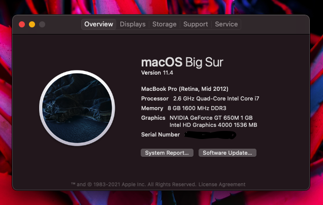

cMP mid 2012 5,1 updated BS 11.14.3 to 11.15 Beta 1 with OCLP 0.1.5 no issue at all.
Hardware:
  • Samsung 970 EVO NVMe M.2 with WINGS PX1 adapter.
  • GPU AMD Radeon HD 7950 3 GB
  • Broadcom BCM43xx 1.0 (7.77.111.1 AirPortDriverBrcmNIC-1680.8)
It looks like we have the "exact same machine". I too have the Radeon HD 7950 and the same Broadcom chip - only difference seems to be the firmware - mine is version 5.106.98.102.31, yours is 7.77.11.1 - I'll look into updating that.
I als have a Samsung 970 Evo M.2. sitting idle, waiting for me to put it onto the Wings PX1 that I currently use to boot Catalina - I've been holding off updating my Big Sur beyond version 11.2.3.

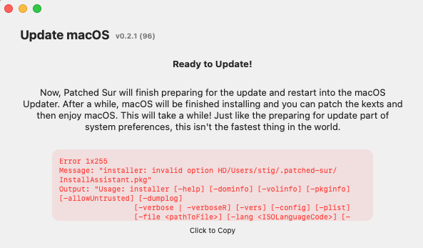

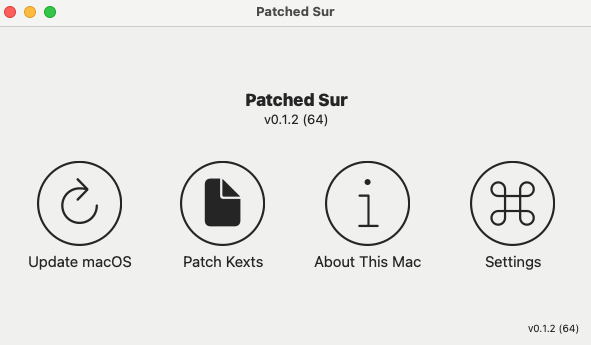

Possible Trojan virus delivered with Patched Sur patch? Has anyone else experienced this?
iMac14,2, Quad-Core Intel Core i7, 3.5 GHz (2013) - Operation system is on 1GB SSD, Home folder is on hard disk HGST 8TB (this is NOT a "Fusion Drive" arrangement)
A month ago, I successfully upgraded my iMac to macOS Big Sur Version 11.2.3 by using Patched Sur. Everything went smoothly. At that time I installed the "Patched Sur" app.
A couple of days ago I wanted to upgrade to Big Sur version 11.4. First I upgraded the app to Patched Sur v0.1.2 (64) and followed every step (including Terminal use) as described. I solely used Patched Sur v0.1.2 for downloading the necessary files for my upgrade.
This ended with an error screen saying Error 1x255 (see uploaded screenshot) I also tried to download and install USB on a USB thumb drive (64GB), but screen instructions did not show the thumb drive, but instead indicated that I should erase one of my hard disks.
Giving up until I could collect more information, I ran a virus scan with ClamXAV 3.3 and found the existence of a Trojan.OSX.Flashback which showed up for the first time. I also ran a confirmation wider range scan overnight, but found hat this was the only virus present. It was quarantined by ClamXAV and I proceeded to trash and delete it.
However, the interesting part is the information that came out about the path of this virus:
File Name Infection Name Status Current Path Original PathHax6.dylib Trojan.OSX.Flashback
Deleted /usr/local/lib/Patched-Sur-Patches/InstallerHax/Hax6/Hax6.dylib /usr/local/lib/Patched-Sur-Patches/InstallerHax/Hax6/Hax6.dylib
I hope to hear from others who also may have experienced this? And I am also wondering how to proceed with updating Big Sur to 11.4 after this? Obviously I am not eager to download more copies of this Trojan to my iMac.
