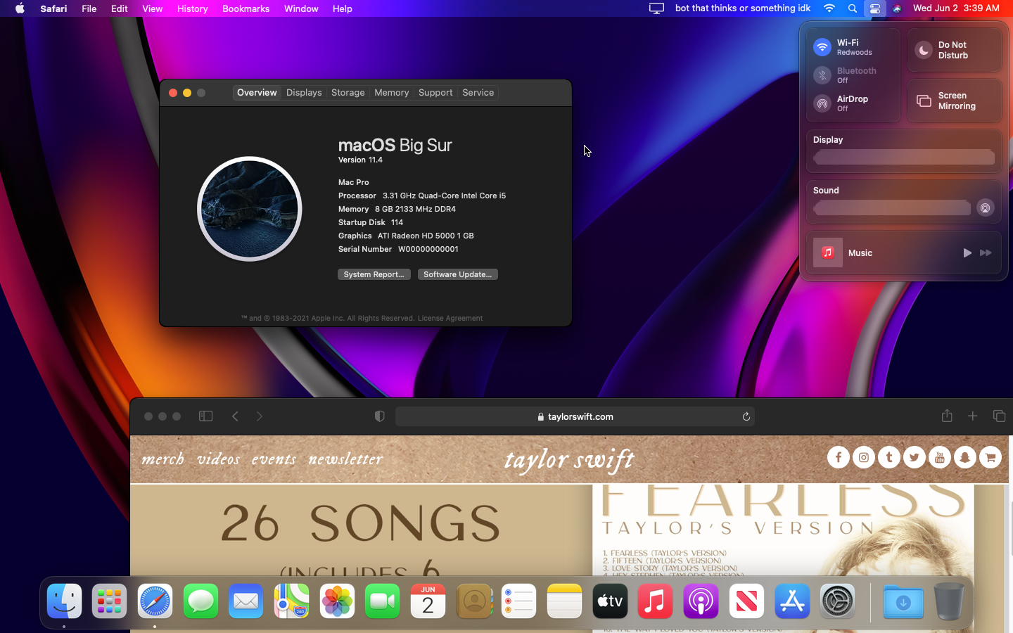

Also, for anyone not on the Discord servers, we -- myself, OCLP devs, and @moosethegoose2213 -- have been recently experimenting with AMD Radeon 5xxx/6xxx accel.
Consider it pre-alpha at this point, but hopefully it'll be a viable upgrade from High Sierra in the foreseeable future.
