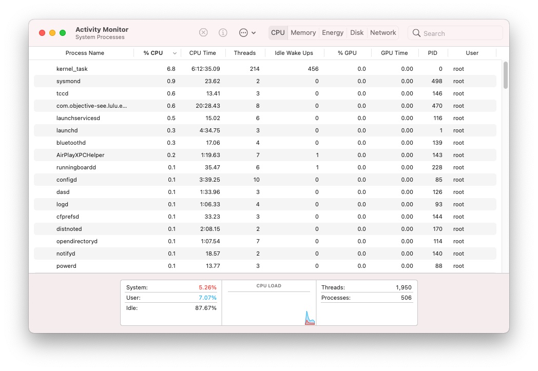

On my mac mini 6,2 (i7 2.3 on 11.4 w/ OLCP) I found that mdsync was hogging 99% cpu. Theoretically with quad core + hyperthreading, that isn't ... terrible ... but it does seem excessive. Killing the process fixes the problem, but that makes for long term spotlight problems. I figured it would eventually go away, but it stayed high for over a day.
Rebooting doesn't seem to help.
kernel_task seems to sit at around 2.5% which seems reasonable.
A Time Machine share will cause MDS and it's hoard of attendants to hog your Mac CPU. It can't be excluded from Spotlight.

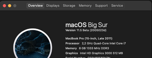

Panics began.
I wonder is there 11.5 beta as main reason or maybe kind of conflict with OCLP.
Do you have WIFI enable ?
On my mini 6,2, as soon as i put the wifi on, kernel_task jumped 2.7% to 12% to make spikes at 18/20 and stay there at the top of the list ...
No slowdown and overheating CPUs with your i5?
Nothing like that. No high kernel_task CPU util.
Reactions: tchek and K two

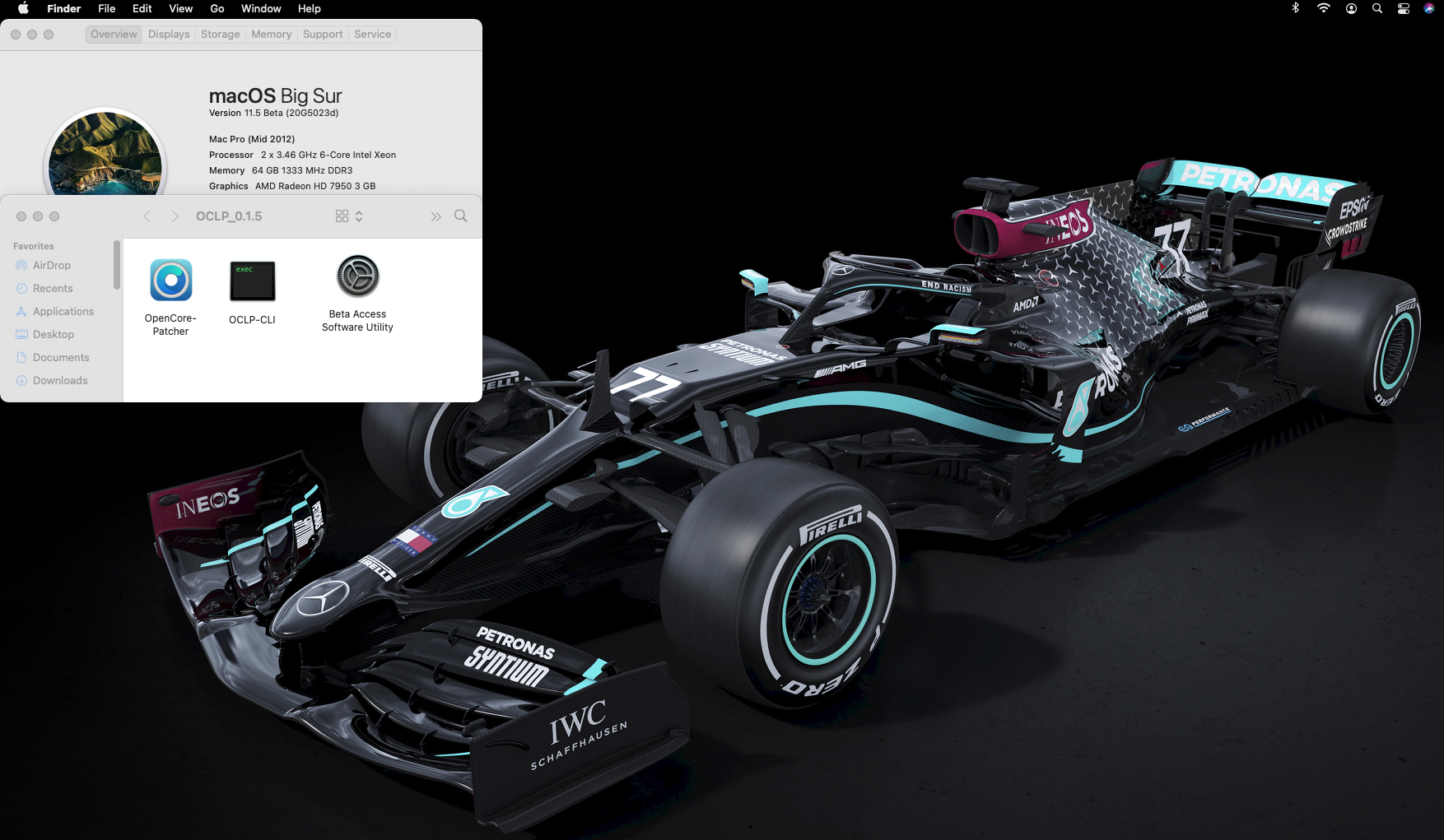

cMP mid 2012 5,1 updated BS 11.14.3 to 11.15 Beta 1 with OCLP 0.1.5 no issue at all.
Hardware:
  • Samsung 970 EVO NVMe M.2 with WINGS PX1 adapter.
  • GPU AMD Radeon HD 7950 3 GB
  • Broadcom BCM43xx 1.0 (7.77.111.1 AirPortDriverBrcmNIC-1680.8)

Today I updated from 11.4 to 11.5 beta. Everything works perfect except the glitches , screenshot. Iused the oclp 0.1.6 and photos work ok. I have brightness. I can use it for daily use. Don't hear any fans. You are a great team. The glitches I have are on Safari and finder.
WiFi is enabled, but kernel_task stays fairly low ...
Reactions: tchek
