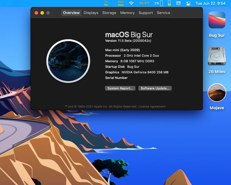

Just like to add for documentation/advice (@khronokernel) that I have two sucessful installs marked as "not reported" yet.
OCLP 0.1.9 - BigSur 11.4: MacBookPro5,5 - Expected slight graphical glitches, works perfectly well as an accelerated FaceTime Machine
OCLP 0.1.9 - BigSur 11.4: MacMini3,1 - Expected performance, great as a file/print server with occasional access over Apple Remote Desktop
SSDs in both made them significantly more useable.

Try 11.5b3, runs as well or better than 11.4 on the Mini3,1 OCLP 0.1.9.

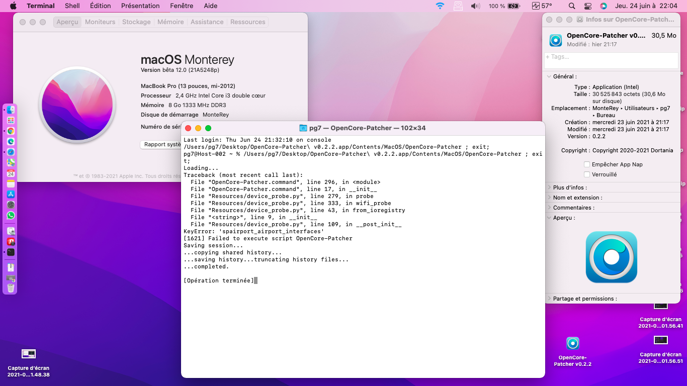

Hello good Morning
Would anyone have a solution for this error of not being able to continue the patch with OCLP v0.2.0 / v0.2.1 and v0.2.2
with v0.1.7 / v0.1.9 I can get it normal but I don't have the latest fixes!
thanks for any solution
@PG7 You posted in the wrong thread. Issues with OCLP and Monterey should go in the Monterey for unsupported Macs thread.

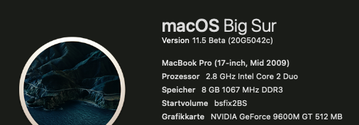

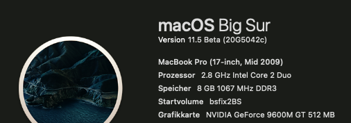

This time I updated an installation used for beta tests, made with jackluke's BigSurBasesystemFix. With his tool injected the new SharedSupport.dmg into the existing installer and used it to install over 11.4b2. This method works well since 11.0, and still does.
Updated the MBP5,2 to 11.5b3 from 11.5b2. Using the full installer. Updated two installations:
- one made with jackluke's BigSurBasesystemFix on a partition of internal (SATA) SSD
- one made with oclp, now using 0.2.2, on an external (USB) SSD.
Both working fine. Using 11.4 as production system on a separate partition of the internal SSD.
Catalina, on another external SSD, still kept up to date (with a set of rsyncs for user data), just in case.
Also using 12.0 beta experimentally (because of no graphics acceleration) on yet another SSD, again installed both ways via oclp 0.2.2 and via jackluke's fix/fix2 method, resp., plus using jackluke's BigSurmountsrw.app to inject additional kexts I need.
