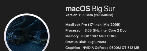

Hello,
Successful installation of Big Sur 11.5 beta3 on 2009 MacBook Pro 5,2 -- 17 inch, 1 TB SSD ( on June 15th)
Method: OCLP 0.1.7 combined with USB based full installer (see post 10,805 above for link to installer package)
Originally I used OCLP 0.2.0 to initiate 11.5 beta3 update, however, the postinstall volume patch did not work and there was no graphic acceleration. I reverted to OCLP 0.1.7 and used that version to install the "volume patch", this time with success. I noted that there were posts detailing similar problems with initial OCLP 0.2.0 release; I have since updated to 0.2.2 version.
I tried to use software update, but the installation did not complete successfully. Full Installer method worked without problems.
Hope this is of help.

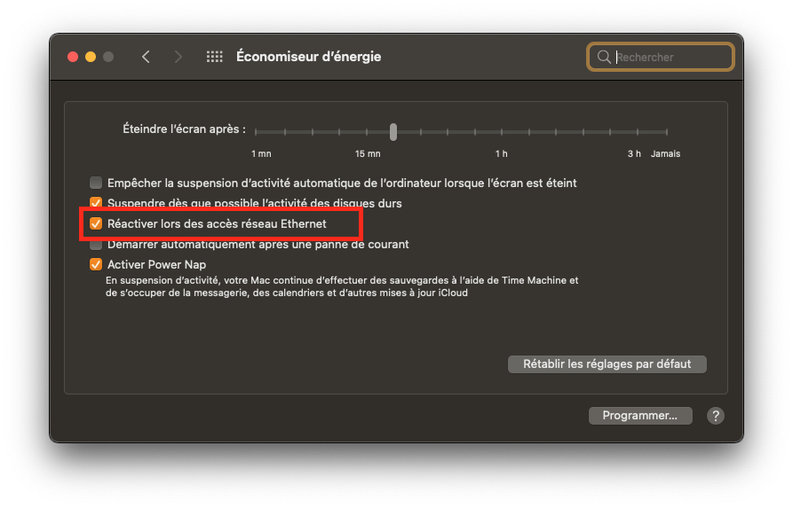

Hi everyone,
I use quite a lot my iMac late 2013 (iMac14,3) as a hub for file sharing. It worked perfectly well with Mojave. But I installed Big Sur using OpenCore Legacy Patcher... and now in System Preferences --> Energy saver, I only see the option "Wake up for ETHERNET network access". It doesn't seem to work over WIFI and that's really annoying to me.
Is there a workaround or a way to fix this please ? I’m using the last version OCLP 0.2.2 and I did a clean install of Big Sur 11.4. I really hope you’ll be able to help me as this is for now the only issue I encounter with Big Sur, but that’s a huge issue for me and I don’t want to downgrade back to Mojave… and entirely prevent my iMac from sleeping is not the best solution as well.

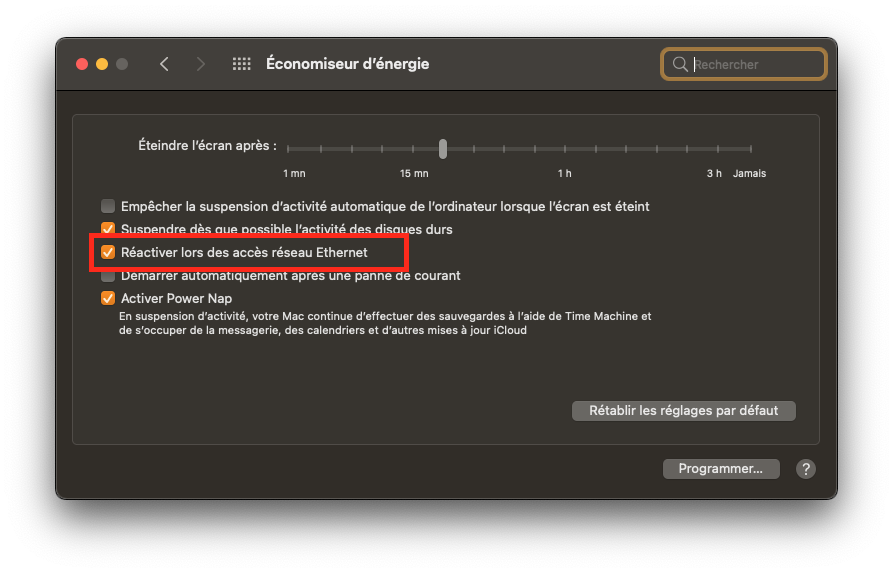

Hi everyone,
Thanks a lot
SMC reset will likely fix. 😎 OCLP 0.2.3 is here: https://nightly.link/dortania/OpenC...s/build-app/main/OpenCore-Patcher-TUI.app.zip FWIW
Sometimes Onyx/Maintenance fixes weird stuff. Try v.0.2.3?
I also tried Onyx… The bad news is that I’ve justed tested to boot on my external ssd with Big Sur betas and the same issue occurs. When I take the same ssd and boot into my MacBook Air the option « Wake up for WIFI network access » appears, though.
So that seems to be a deeper issue, what do you think ? I opened an Issue in the OpenCore Github, but not received any answer for now…
I hope I’ll be able to fix this soon, otherwise the downgrade will be harder (and I don’t want to downgrade as - except for that issue - I love Big Sur on my iMac). If you have other ideas I’ll be more than pleased to hear them :)

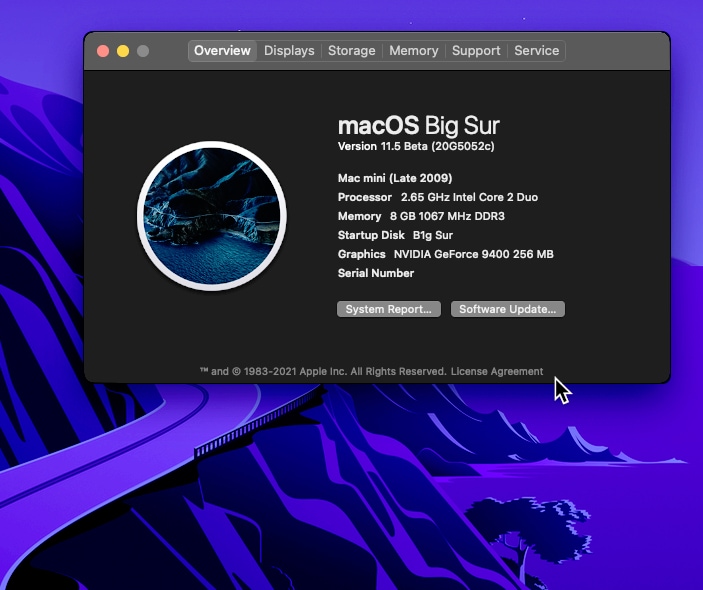

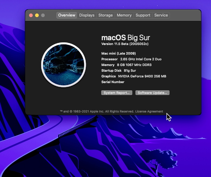

Dear Sir,
I received Restart message from Auto update and Auto restarted 3 times.
Thank you dosdude1,khronokernel,ASentientBot and other developers for hard working.
I upgraded successful my both MacBookPro 8,1 & 5,5 with OpenCore Legacy Patcher 0.2.3 Nightly.
Nice day & all the Best!
Reactions: Dilli and K two

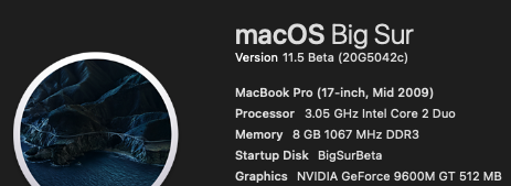

Successful update from 11.5 Beta 3 to 11.5 beta 4 (20G5052c) on 2009 MacBook Pro 5,2.
Method: Software Update (via system preferences) and OCLP 0.1.7 installed on internal drive.
Applied Volume Patches for Graphic Acceleration with success.
Several reboots required just as for 11.5 beta 3 update . (See https://forums.macrumors.com/thread...unsupported-macs-thread.2242172/post-30058979 for some details).
If during the installation-reboot process machine boots into the Apple Drive Picker (rather than OCLP picker) just choose OCLP internal icon (EFI boot) in Apple Picker to access OCLP drive picker. Once in OCLP environment pick MacOS Install or Macintosh HD icon, whichever one's icon is visible; the latter choice may be related to using OCLP 0.1.7 rather then the 0.2.2 version(?)
System functions as expected.
Hope this information is of help.
