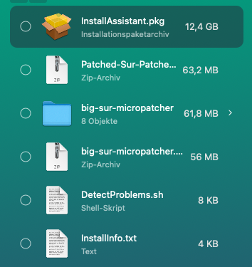

I was wondering why my Mac storage is more full than expected and I found this hidden PatchedSur folder with over 12 GB of data. Anyone know if I can delete this folder without breaking my installation?
