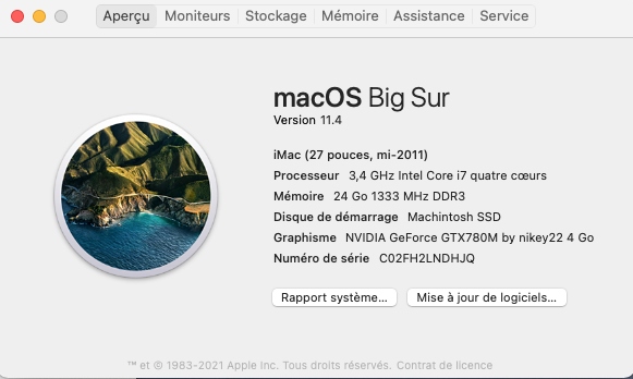

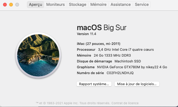

Just updated my mid 2011 iMac 12.2 from High Sierra to Bug Sur 11.4 with OpenCore using the OpenCore Legacy Patcher with OLCP v0.2.2
My first time using OpenCore. All went quite smoothly nothing difficult at all.
A big thank you to you all those who contribute to this thread and others 🙂🙂🙂. that my 10 year old iMac is today running the lastest version of macOS Big Sur.
All seems to be working except for one thing.
The iMac will now not recognize a USB connected UPS, there’s no button / sub menu in System Preferences > Energy Saver. I have tried 3 different UPS and different USB cables none work. UPS connected by USB worked fine with hIgh Sierra.
Any ideas on solving this appreciated.
Thats because BigSur has Compatibility issue with your UPS. Try to visit UPS site and see if they have any firmware updates for BigSur

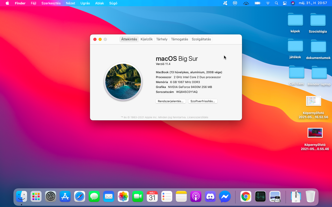

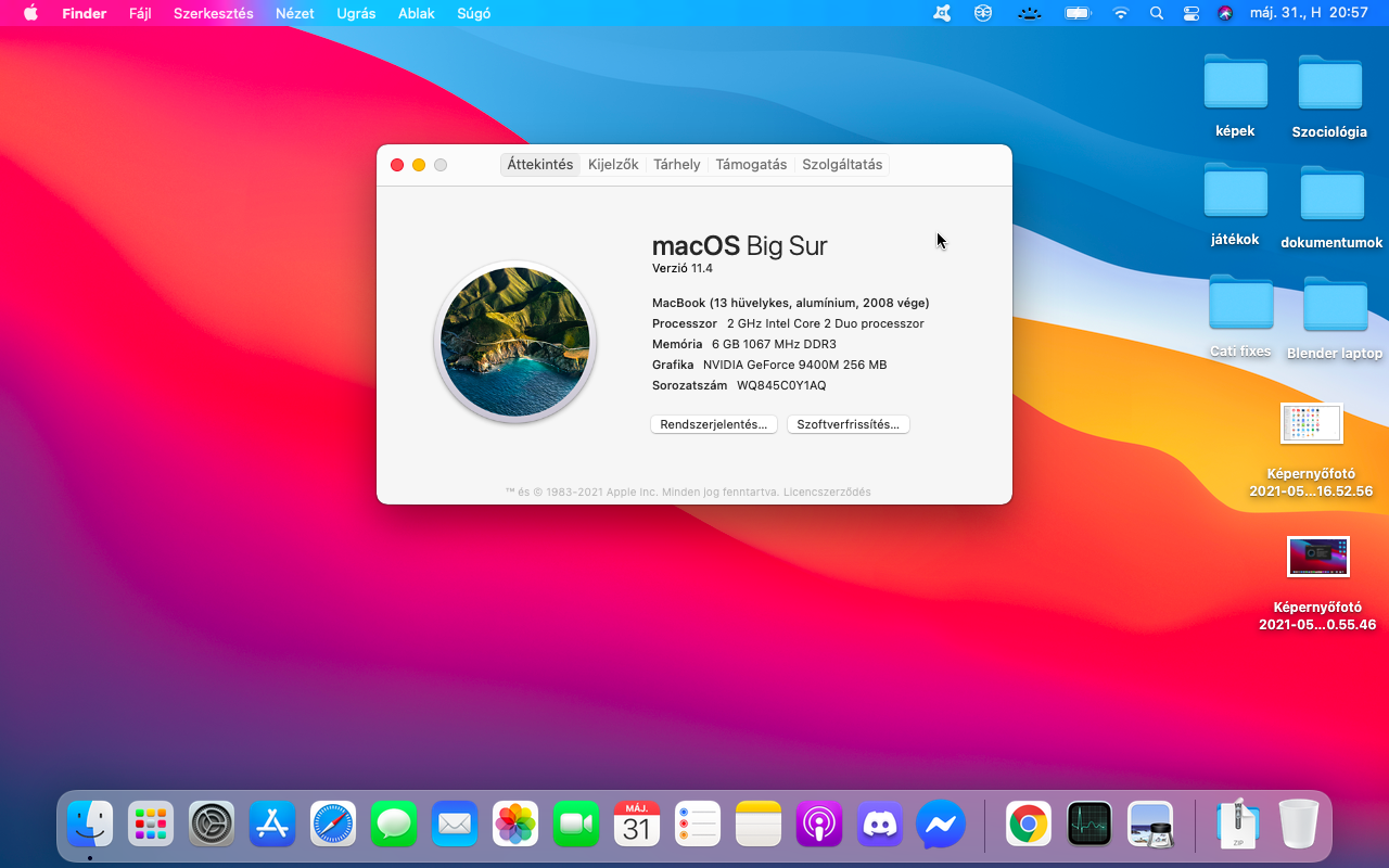

I've been using Big Sur on my MacBook 5,1 (late 2008) since May with the OpenCore Legacy Patcher (0.2.2 as of now). Never had any problems other than the known issues like the keyboard backlight (using labtick) no nightshift (f.lux) and the transparency issues.
Reactions: PG7 and Dilli
The issues you mentioned is already mentioned in the documentation. Its good to see you having a good time.👍

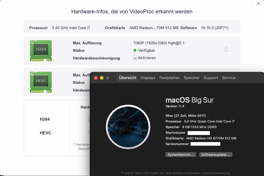

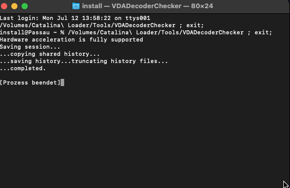

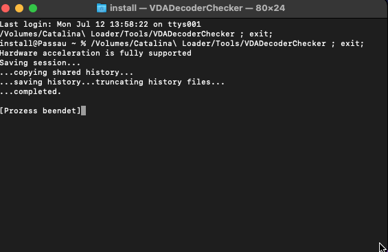

HD3000 VDA decoder back on Big Sur:
After installing the latest High Sierra version of the AppleGVA.framework and the latest Catalina version of the AppleGVACore.framework, a reboot and this command line
Code:
defaults write com.apple.coremedia hardwareVideoDecoder -string force
I got finally this working on Big Sur:
Thanks to EduCovas (his recipe using AppleGVACore, too), @jackluke for his incredible help and patience and finally @webg3 who reminded me using the force command....
If your want to check this yourself on an iMac with either TS2 patches through OCLP or with an NVIDIA metal dGPU follow this recipe to modify the root system volume. Of course you need to apply the chmod/chown commands to the both frameworks placed in /S*/L*/P*F* 🙂
Code:
On some my earlier non Metal and Metal testing, just removing com.apple.coremedia automatically sets VDADecoder enable (assuming that there is AppleGVA* binary in folder), but maybe for enabling VDA on TS2 AMD GPU you need the force command that seems mainly required for the AMD GPUs either non Metal and Metal.
Could you try AirPlay display mirroring ?
Anyway great work in mixing HighSierra AppleGVA (for IntelHD3000) with Catalina GVACore (for BigSur and TS2 AMD).
AirPlay:
This particular iMac finds now after these patches my 4K AppleTV, it exchanges the four digit pass code but the TV remains black. I guess this is more an issue with this particular AirPlay device.

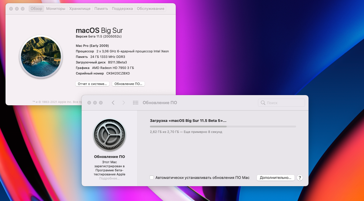

On two Beta 5 OTA updates from Beta 4 the Messgaes app starts to run and then quits after a few seconds, no AppleID needed to see if it runs. Thanks. 😃

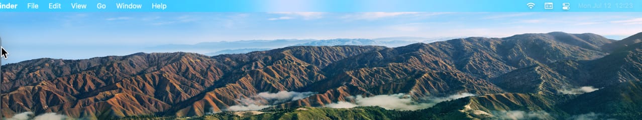

Is there any method to change the Big Sur Menu Bar to be more useful? A Catalina black bar or by manipulating the transparency of only the Menu Bar, itself? Tried every possible Accessility/Display option, changed Desktop Pictures, nada. 😏
