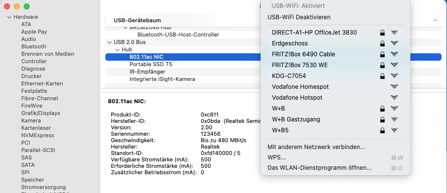

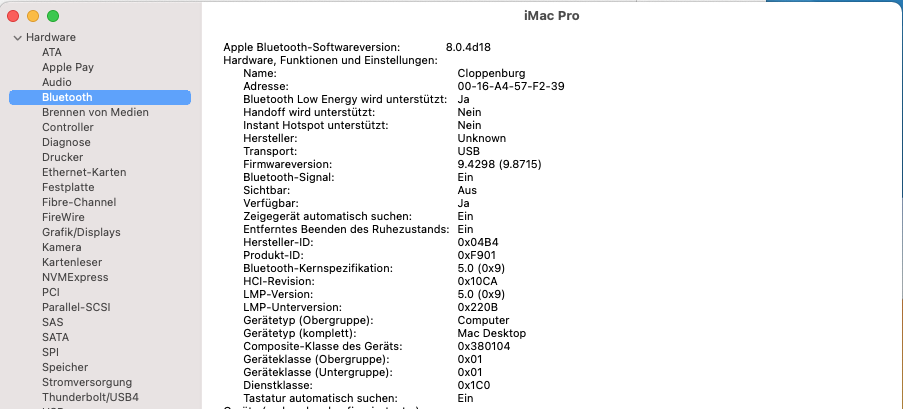

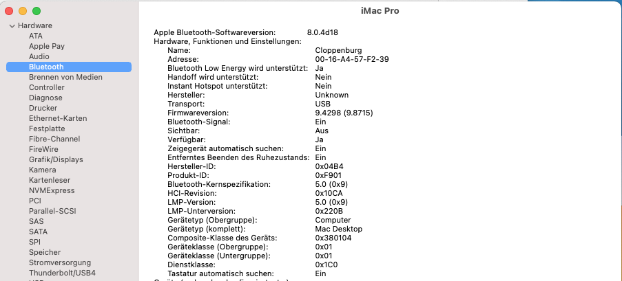

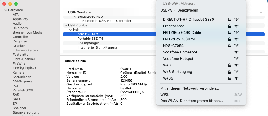

About external USB solutions (WiFi and BT) using an iMac11,2 with Nvidia K610 metal GPU
WiFi:
Using the a cheap WD-4503AC WiFi USB dongle (Realtek) breaks booting on Big Sur 11.3.1 (iMac11,2, metal GPU) in a similar way you can observe it on MacPro5.1 systems. Plugging it it after successful booting to the login screen works fine. You have to add the kernel extension from this package to you OCLP config and install the package on your system, it will add a utility to enable and disable the USB WiFi module from the menu bar.
EDIT:
Using the Realtek kernel extensions RtWlanU1827.kext and RtWlanU.kext with iMacs 11,x and 12,x breaks booting of Big Sur and Monterey at the same time. Boot always hangs at the BCM5701 Ethernet card init routine.
BT:
At the same time I tried a Laird BT851 compatible USB 5.0 dongle (20704A2 chipset). It is working with Big Sur replacing my stock old BCM2046 module (to use it you have to plug it in before booting!).
One can try to use the extensions from this package as mentioned it this post additional with Big Sur and Monterey. Not sure if the broken boot is related to this kernel extensions.
Test runs on Monterey will follow.
