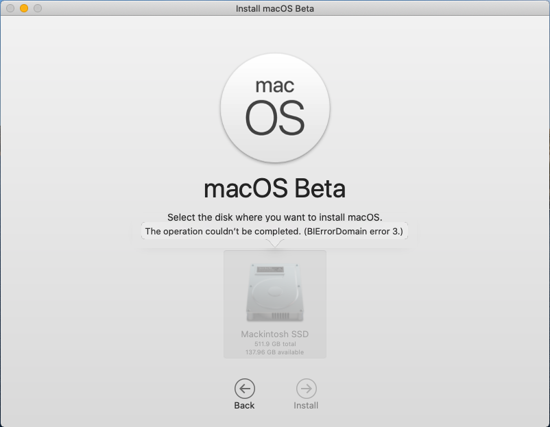

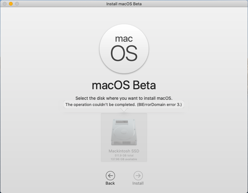

When I try to install the beta update using the steps MacGuy2020 used, I get this error message:
How can I fix this???

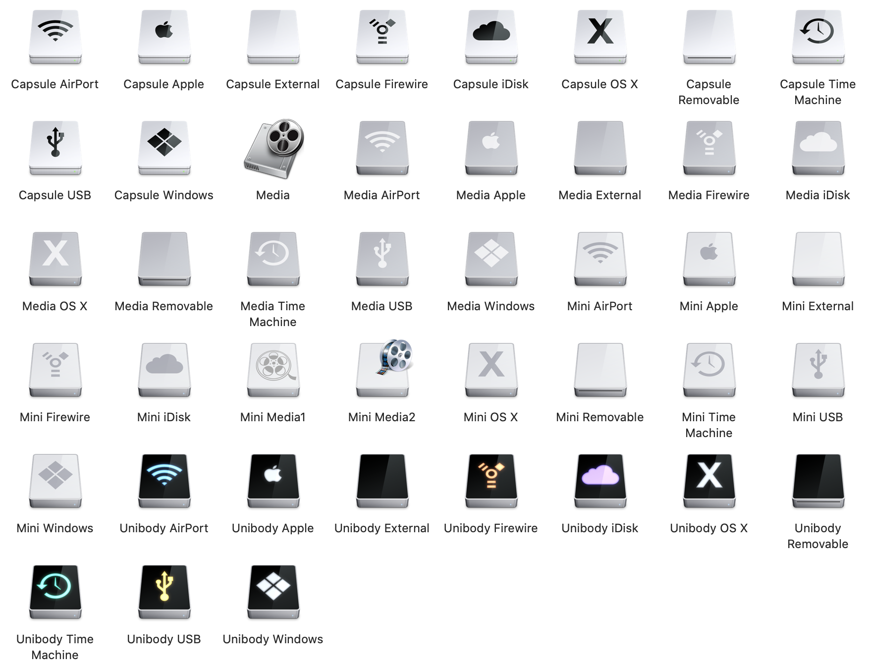

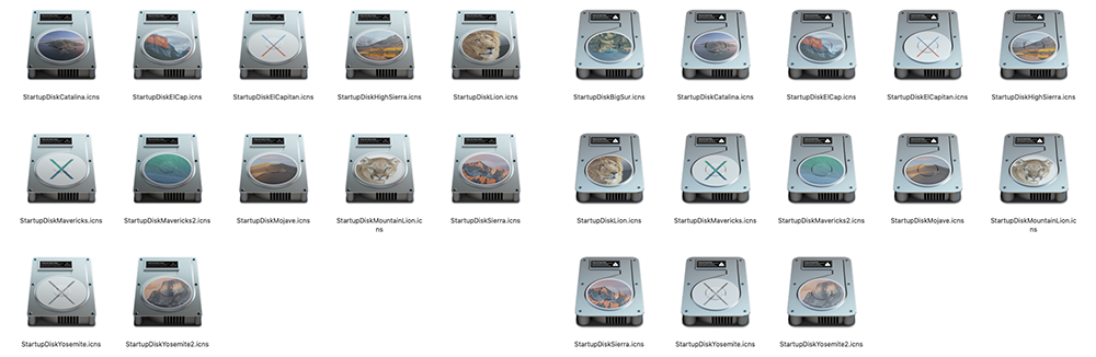

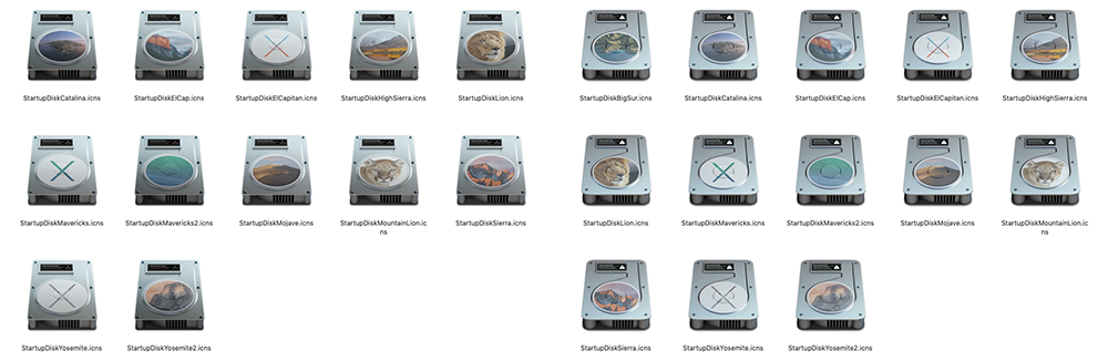

Hi all
I'm going out of context a little bit but following my message #838
Regarding the HDD and SSD icons, I thought I understood that some people were very interested ;)
View attachment 928817View attachment 928818
So I shared them in a GoogleDrive folder here.
All of these icons are .icns
Sorry for the delay, I left for the weekend and I'm only coming back now
Do you have a plain one for the SSD? I'd love to use it but I'm not a fan of the OS icon on there.

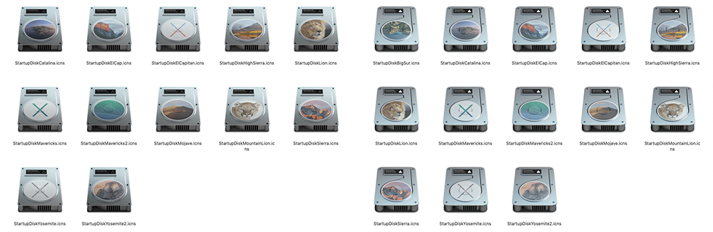

For anyone interested these are the drive icons I use, they are called Ive Drives icons from the Icon Factory.
So this reminds me of a question. Is updating the drive icon in Big Sur the same as it was in Catalina, do a command-key i-key, paste the icon in the info window?

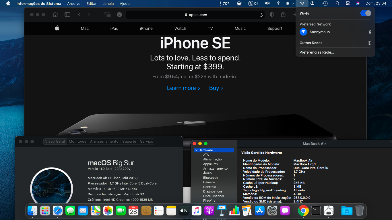

About Wifi (MacBook Pro/Air 2012), working => https://medium.com/@andv/making-wif...d-macs-with-failed-with-66-error-36c98e3f7965
try to read the pages, I know it takes a little time, but in order not to screw up, I recommend reading it before any action.

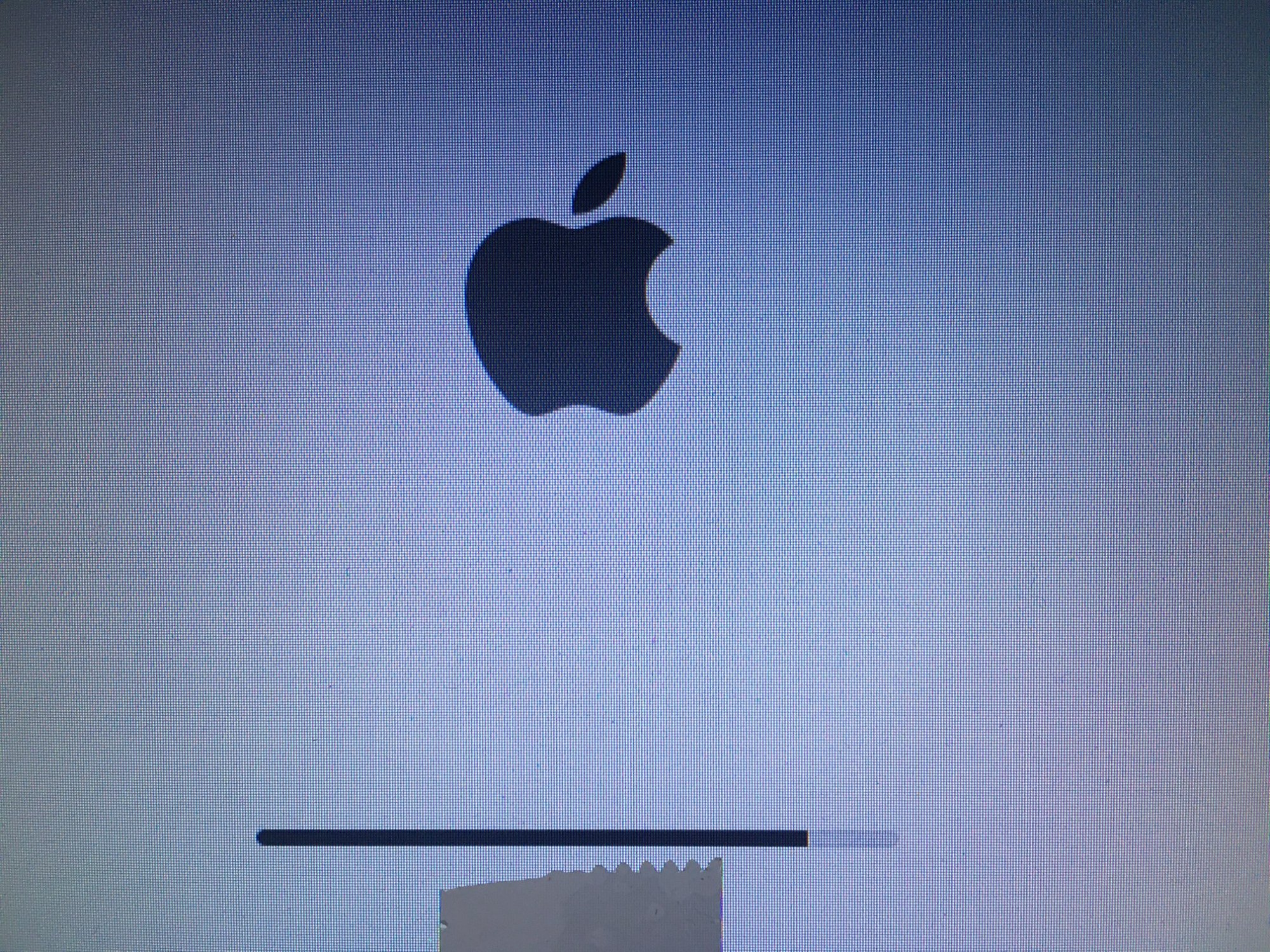

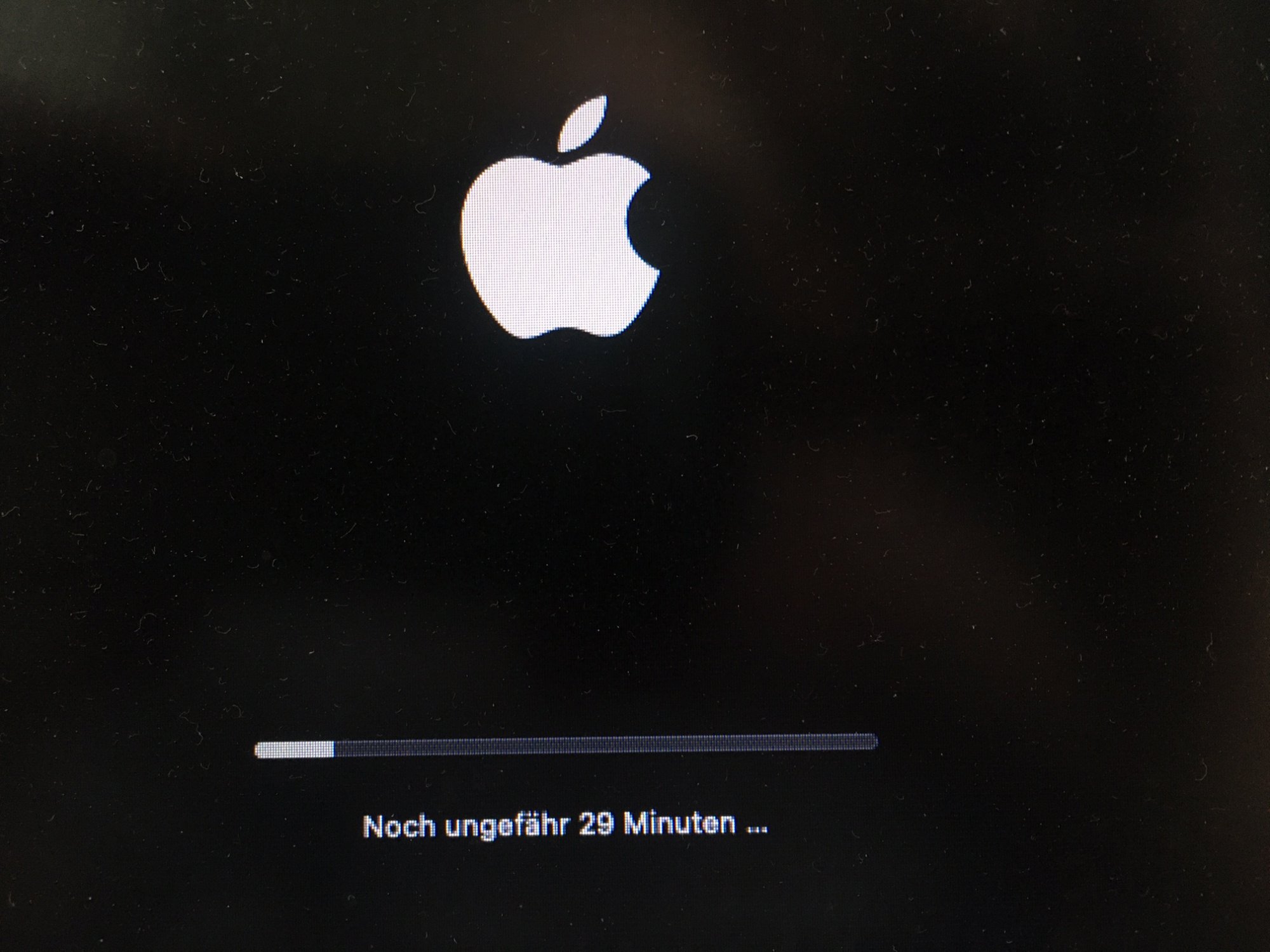

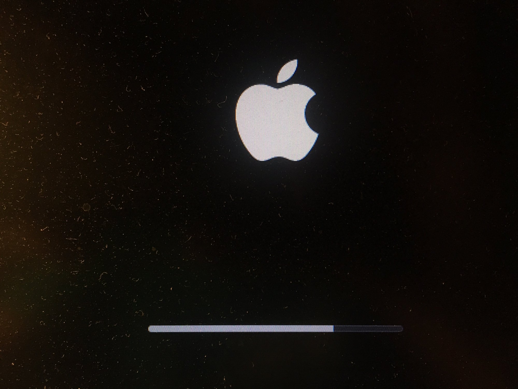

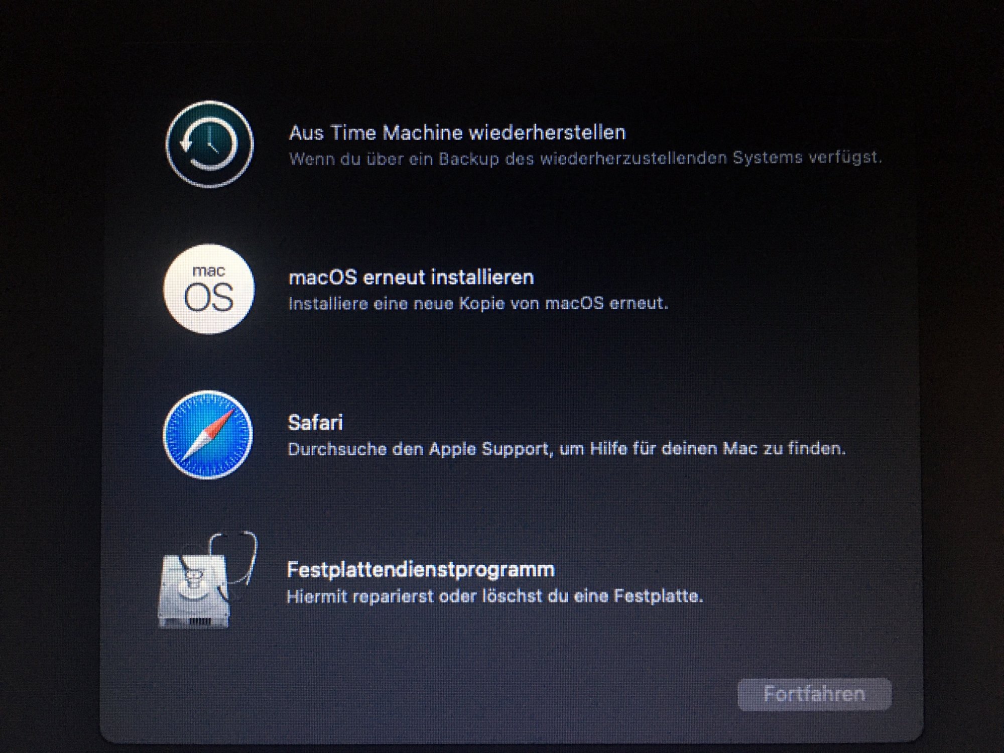

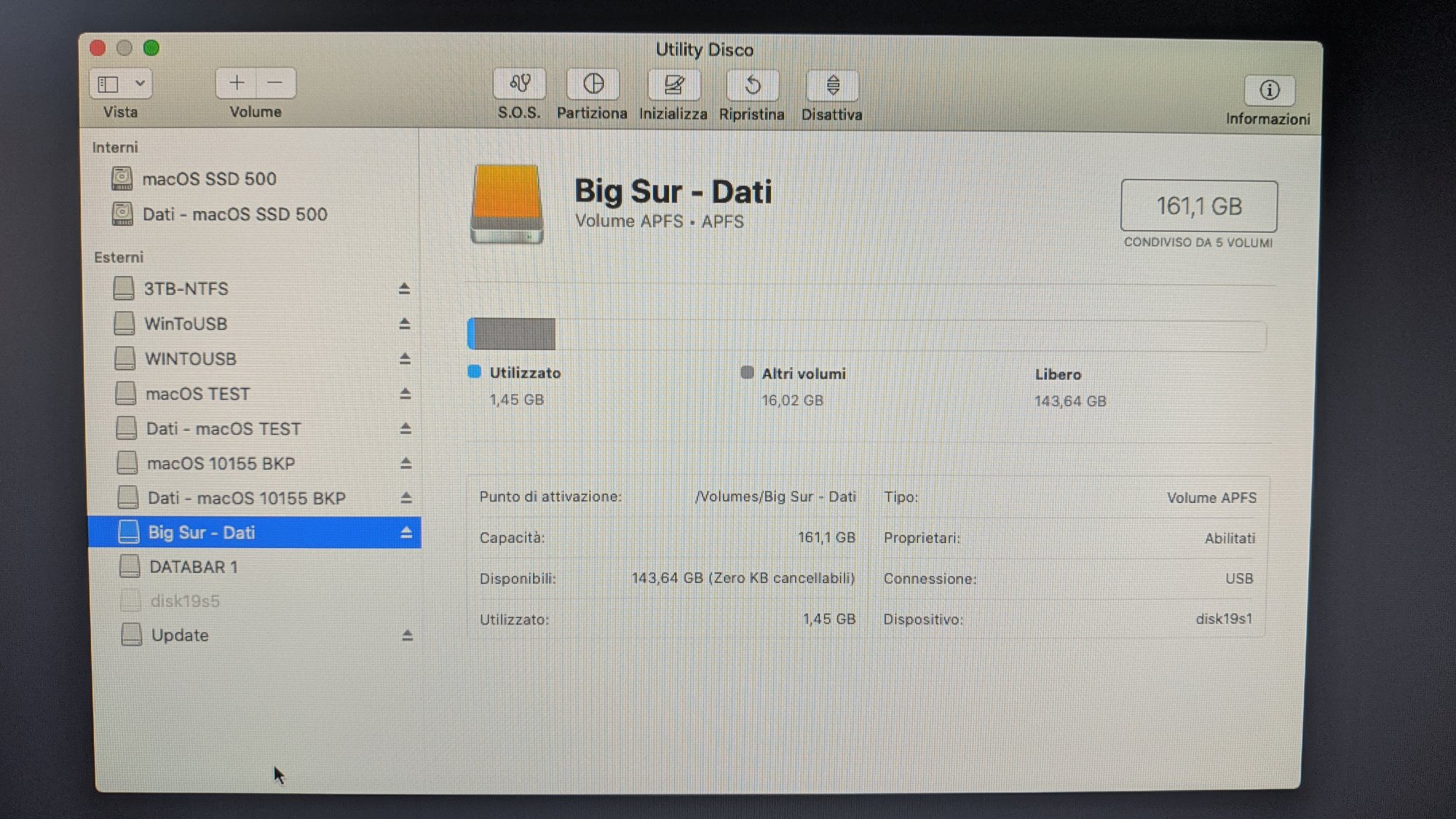

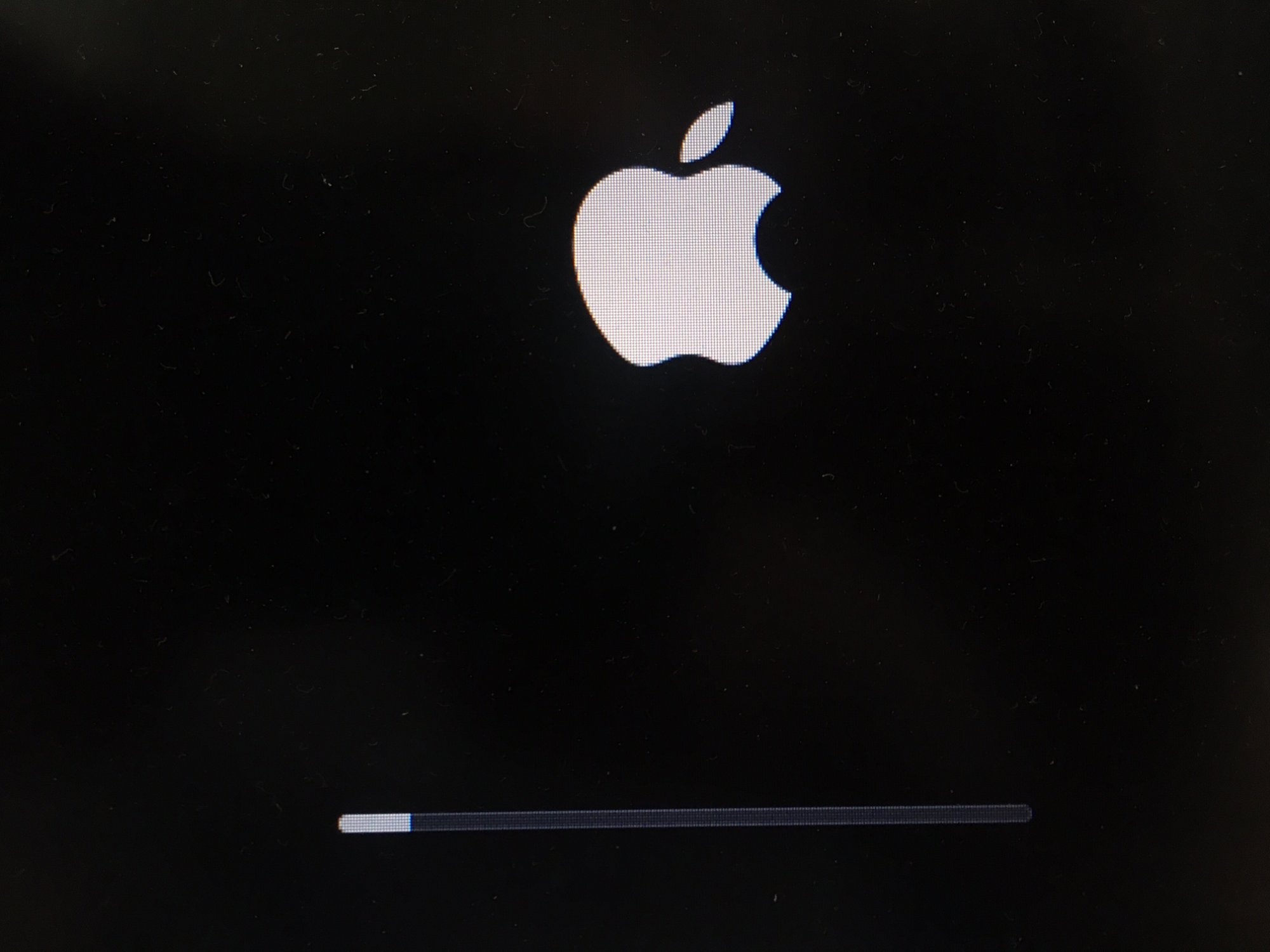

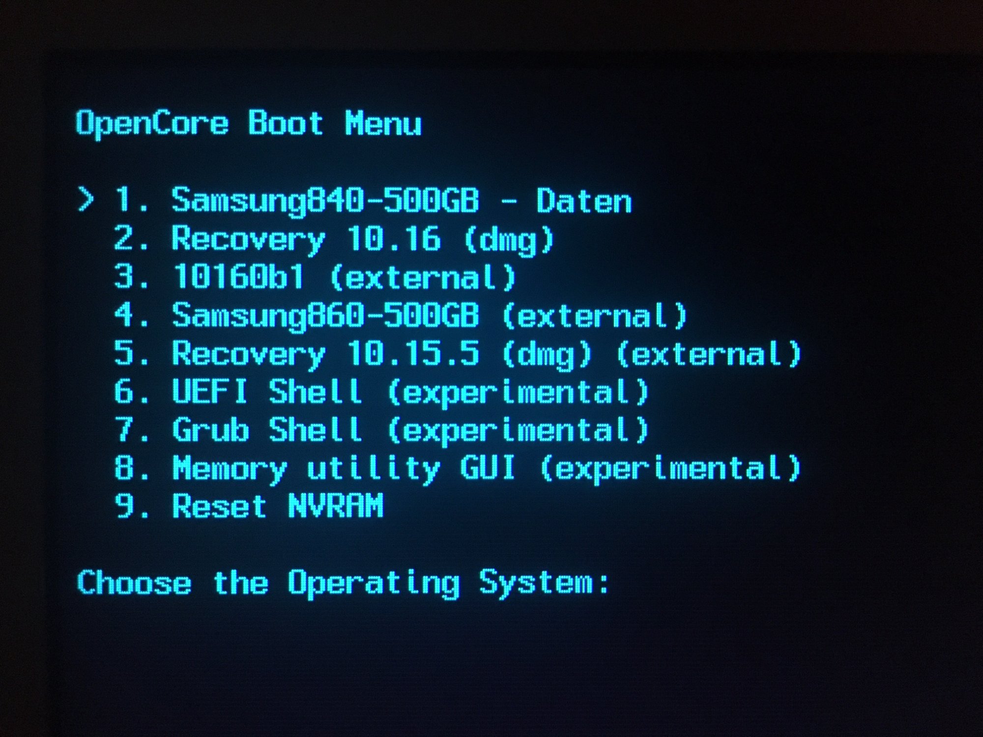

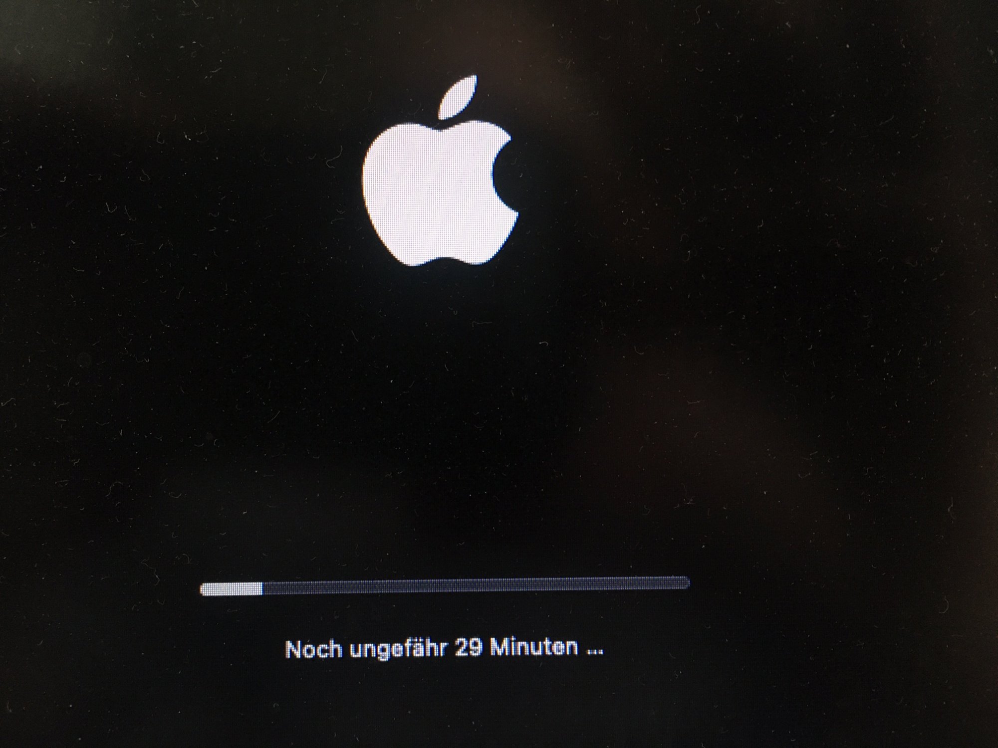

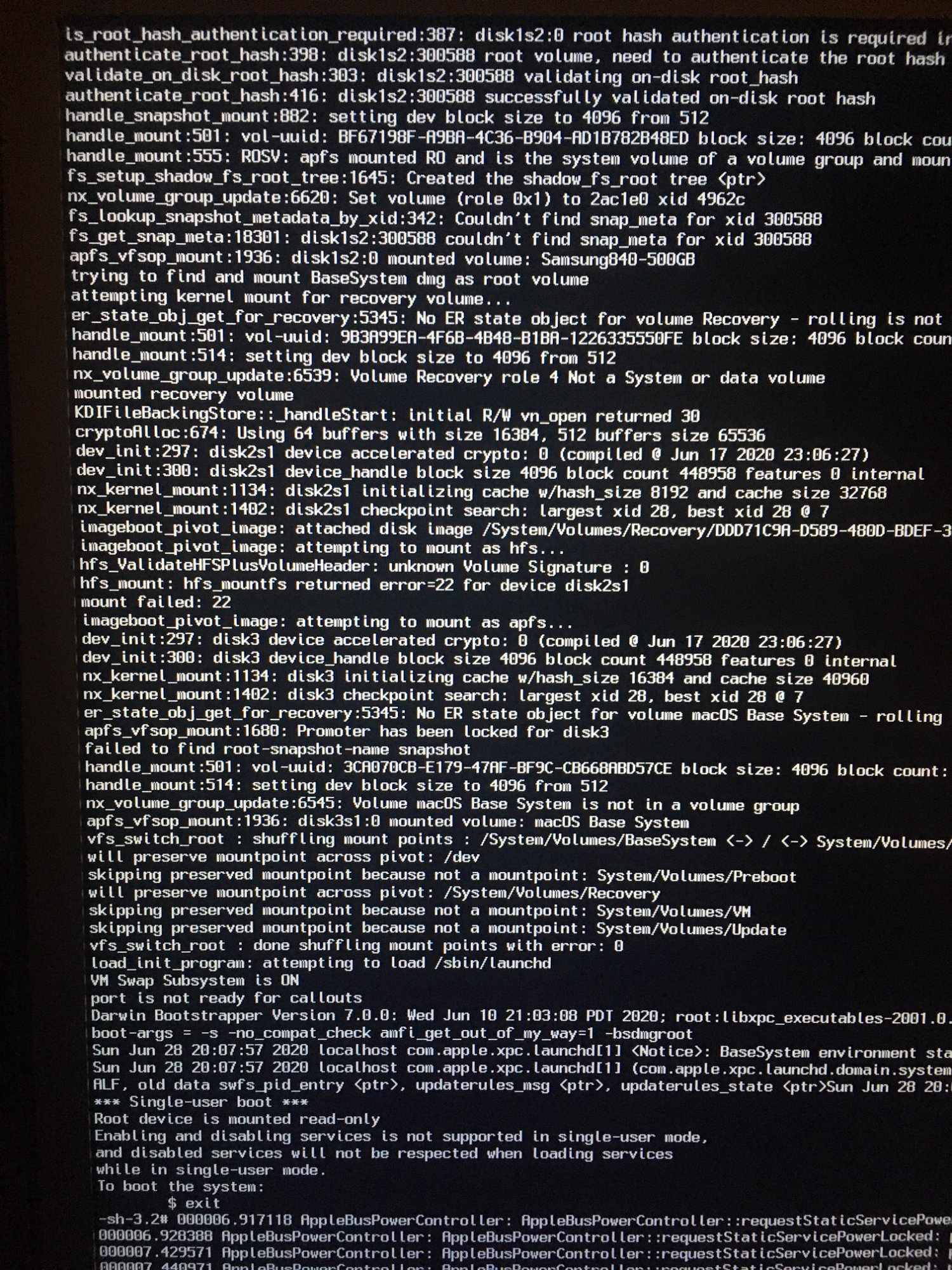

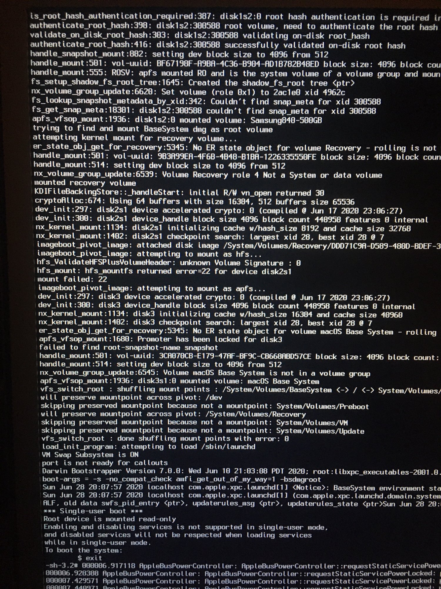

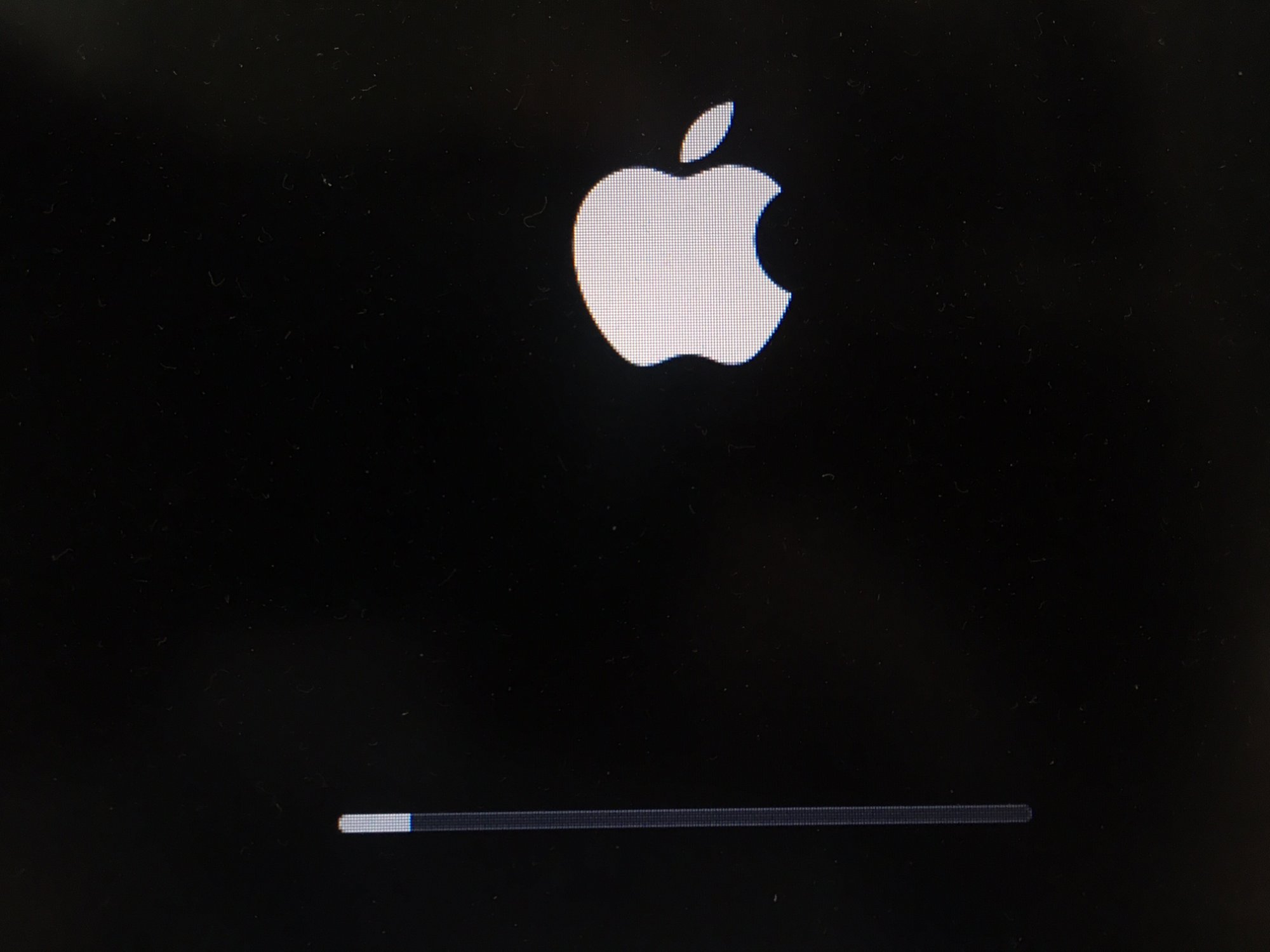

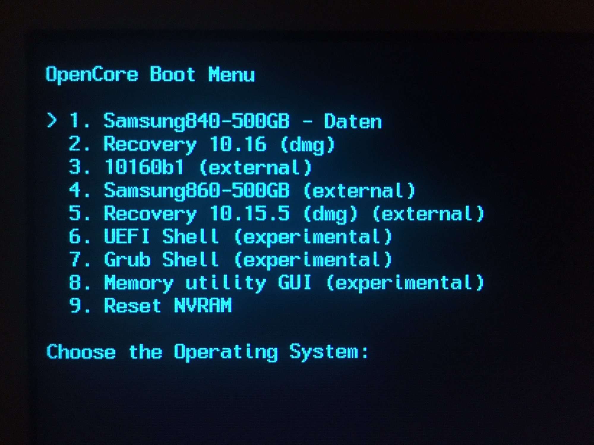

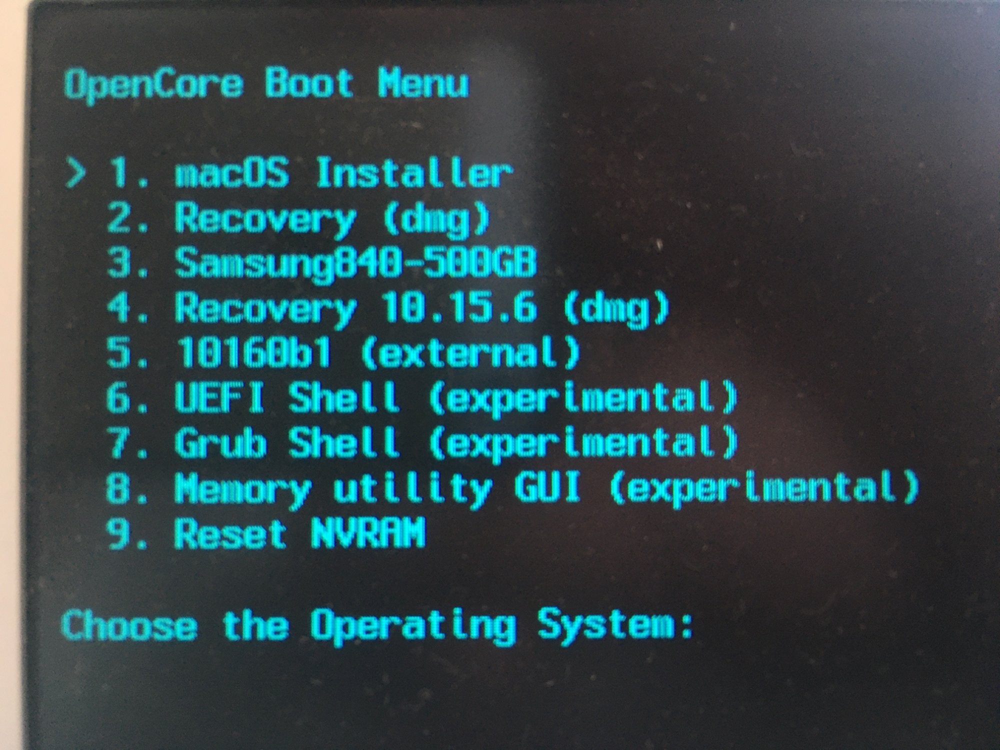

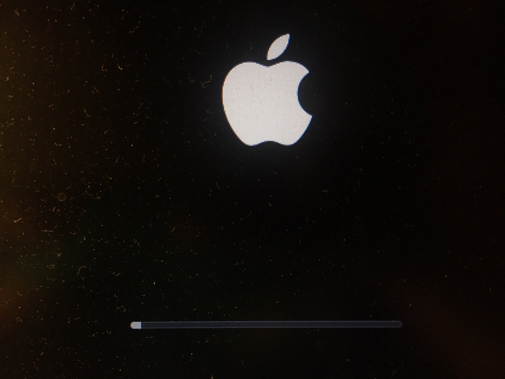

I was a bit hesitant to post this to all, because it could just be a partially failed installation, but here it is.
So BS installation completed apparently fine, after moving the BS SSD to internal SATA from USB. But then couldn't boot. Recovery boots though, but trackpad not responsive. (A lot of) details:

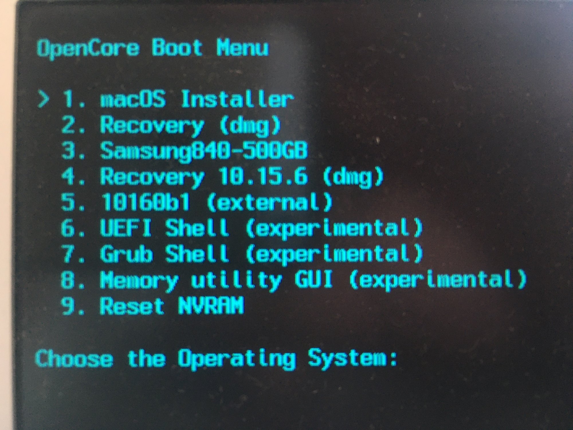

- Booted into the macOS Installer of the (now internal) BS disk. Using OpenCore for this, with spoofing still enabled at that point which may be wrong (first 3 pictures). Had to leave the installation unattended unfortunately.

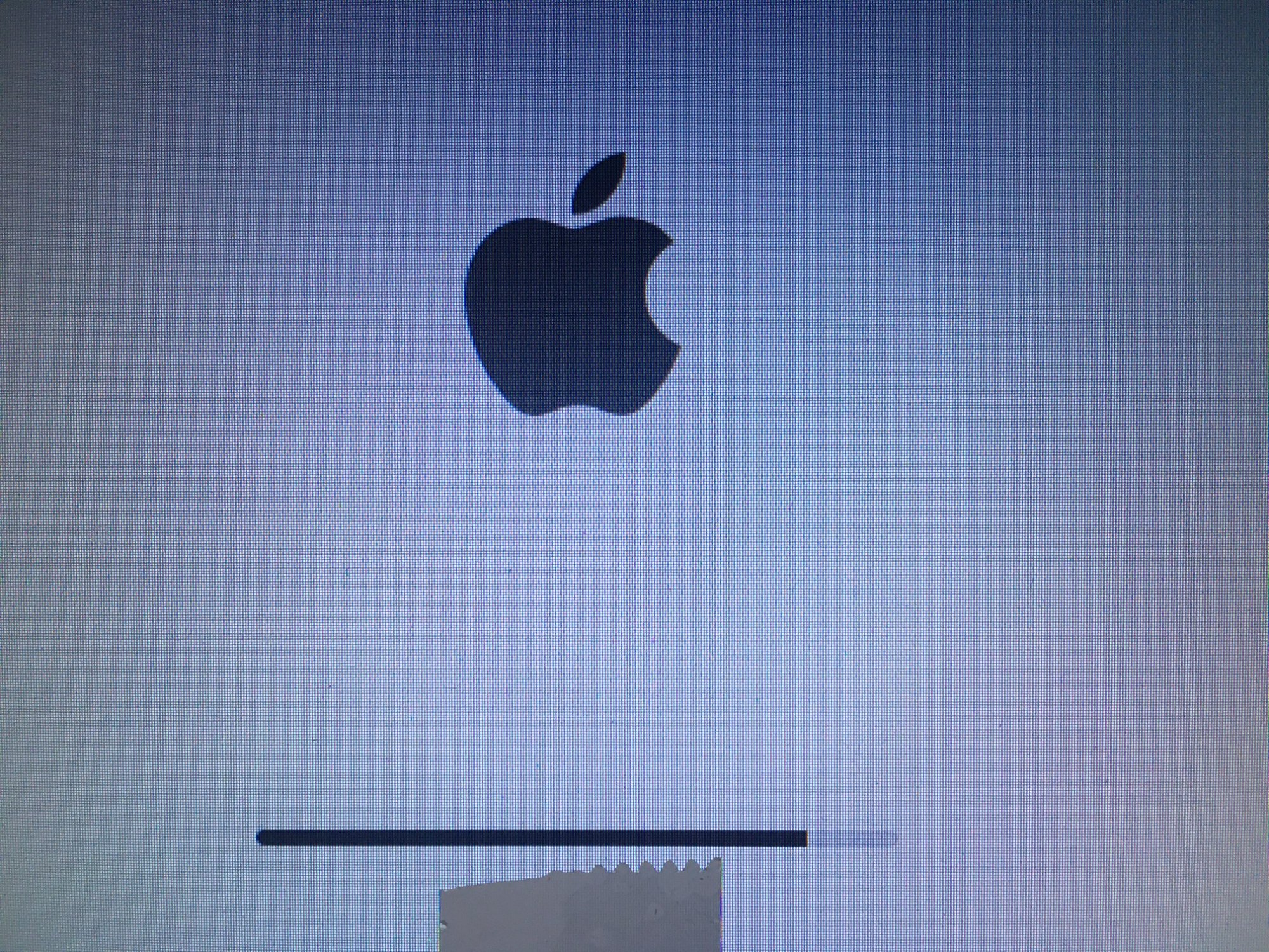

- Hadn't booted when I came back, sitting there with a dark-on-white apple progress bar. Not a surprise because booting didn't go via OpenCore, so no telemetry and IOUSB legacy fix (photo 4)
- Then switched off spoofing in the USB OpenCore loader, and changed com.apple.Boot.plist to reflect usage of prelinkedkernel

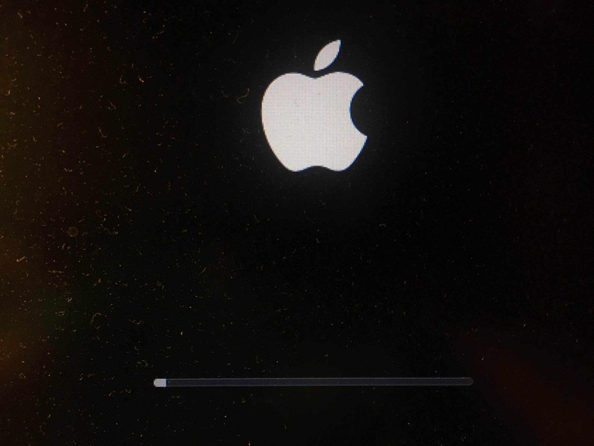

- Used OpenCore it to boot BS. First without single-user mode, showing two phases of white-on-black apple progress bar, then stuck there. In single user mode, shows that it repeats an AppleBusPowerController message (photos 5-8)

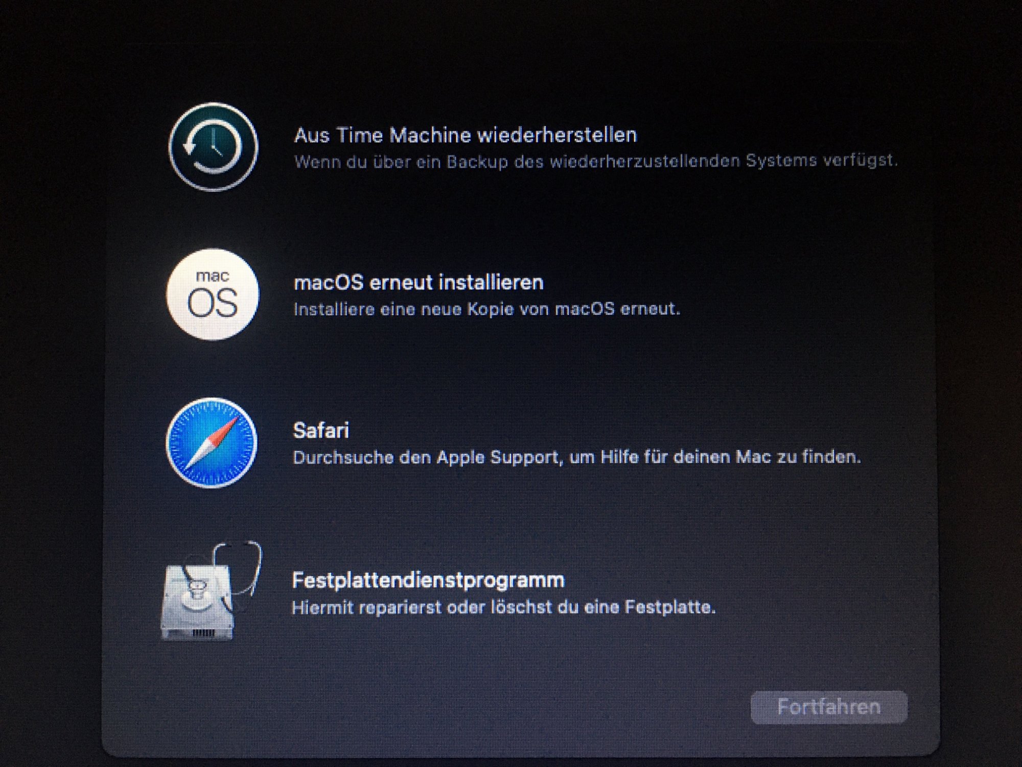

- Just to see what happens, booted into BS recovery with OpenCore. Took a while as usual, then showed the graphical recovery menu and the menu bar correctly, but trackpad didn't react, so can't test it further at this point (photo 9).

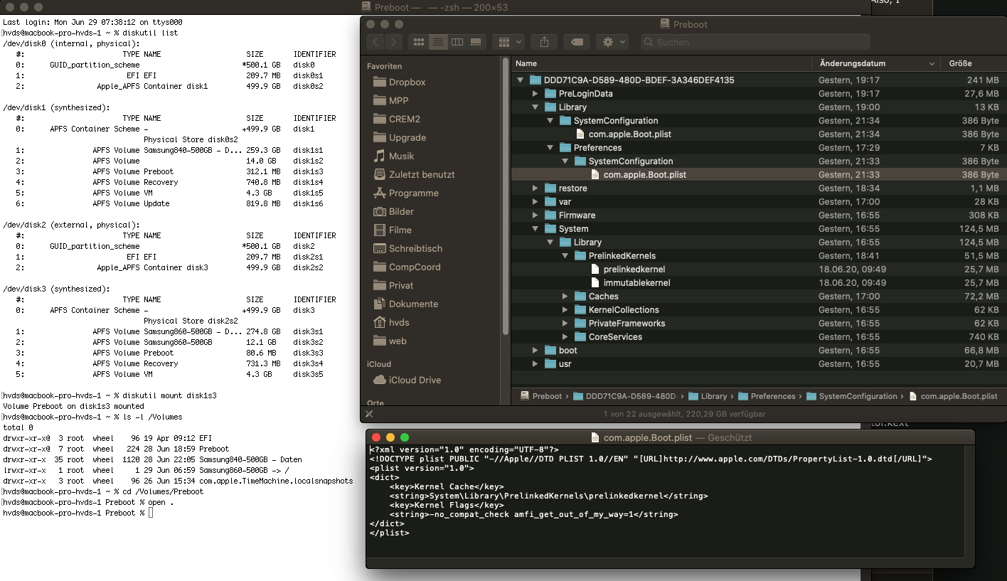

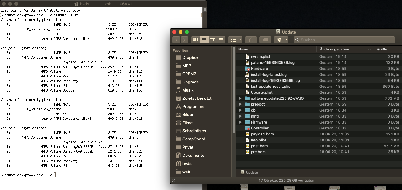

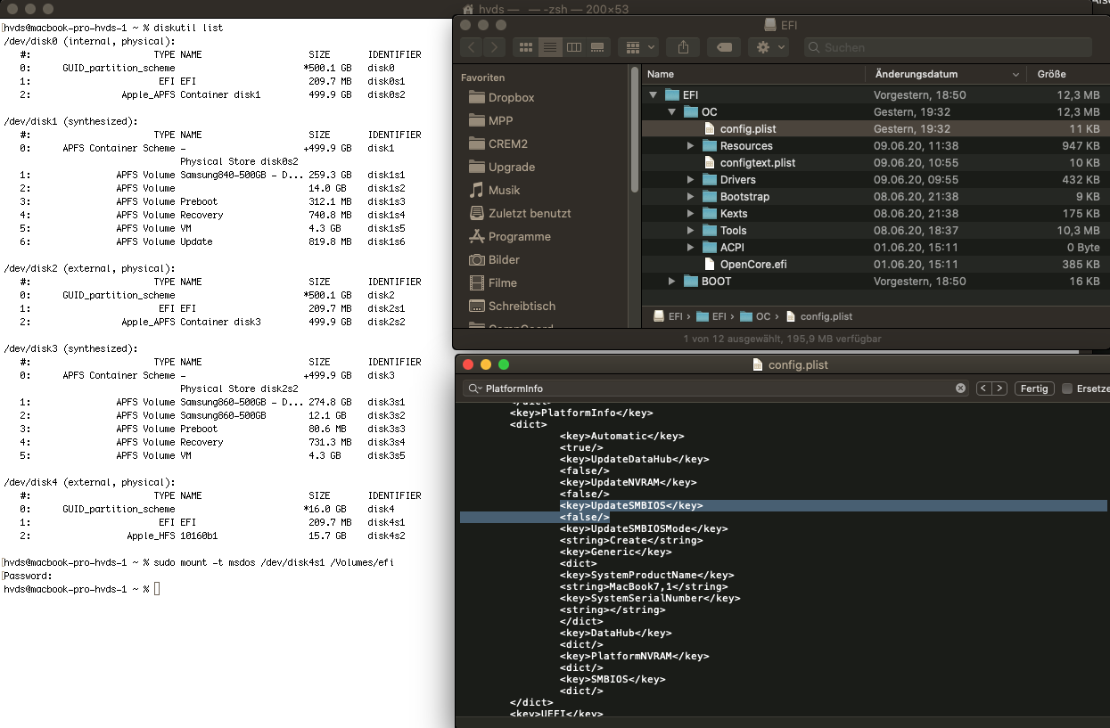

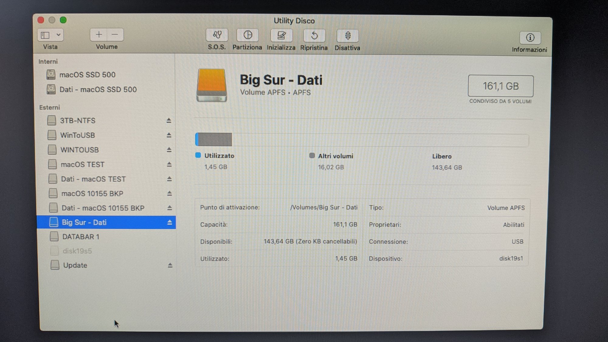

Bear with me - more details about the state of the BS disk. Screenshots taken with 10.15.5.02 hooked on USB.
- the BS Data part is shown with diskutil list, the other is there but unnamed. The structure of Preboot shows prelinkedkernel and two Boot.plists. I've modified both as shown. On the finder desktop only the Update part is shown, which includes a Firmware folder (photos 10-11; 11 and 12 are in my next post as 10 photos is the limit)
- in the USB OpenCore I've disabled spoofing by just setting UpdateSMBIOS to false (hopefully correct) (photo 12).
Anyway I'll leave the BS disk on SATA for now to allow further testing of BS on my MBP5,2, which I'm looking forward to. Catalina production disk works quick enough on USB.

/Volumes/UUID-BigSur/Library/Preferences/SystemConfiguration/com.apple.Boot.plist
/Volumes/UUID-BigSur/System/Library/CoreServices/com.apple.Boot.plist
and maybe also here:
/Volumes/YourBigSurSystemLabel/System/Library/CoreServices/com.apple.Boot.plist
(this step is not necessary because are used those from Preboot)
Then through USBopencore boot BigSur but with CMD+S and check if in single user mode you can use keyboard to type "exit" (using single user mode should work also on an external BigSur install with Legacy IOUSB).
Currently the only limit for non-APFS mac of LegacyUSBInjector.kext is on the USB BigSur Installer or BigSur Recovery, (and mainly on the fact that IOUSB legacy doesn't prelink on BootKernelExtensions.kc ).
Optional step from Catalina, if you can mount the BigSur System volume, remove also the telemetry plugin:
/Volumes/YourBigSurSystemLabel/System/Library/UserEventPlugins/com.apple.telemetry.plugin
edit:
@hvds from your pictures your BigSur bootable label from opencore is "Samsung840-500gb - Daten" (because on some unsupported install BigSur use the SSD label - Data label) so target this volume from opencore to boot it, unless you done a clean install on an empty volume with a separate APFS container in that case it has a different name rather than "SSD - Data".

Install on MacBook pro retina early 2013, wifi working, but system very slow.
It´s Beta. And the first. That´s normal.
