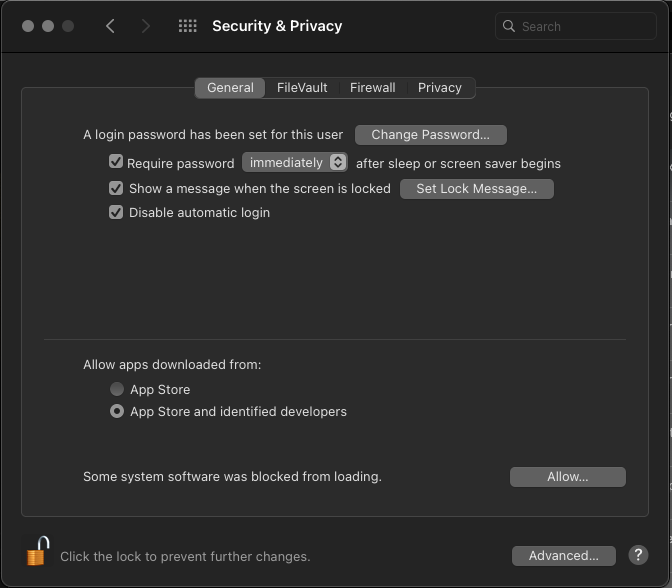

Somewhat related to this topic, the below screenshots confuses me, I unlock the preferencePane, there's a button called allow, so I suppose that's what it does but then have to tick or untick a box to allow the extensions.
Should I tick the box to allow or untick. /confused
*They were ticked, but the text above says they were blocked from loading.

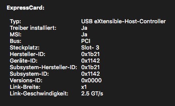

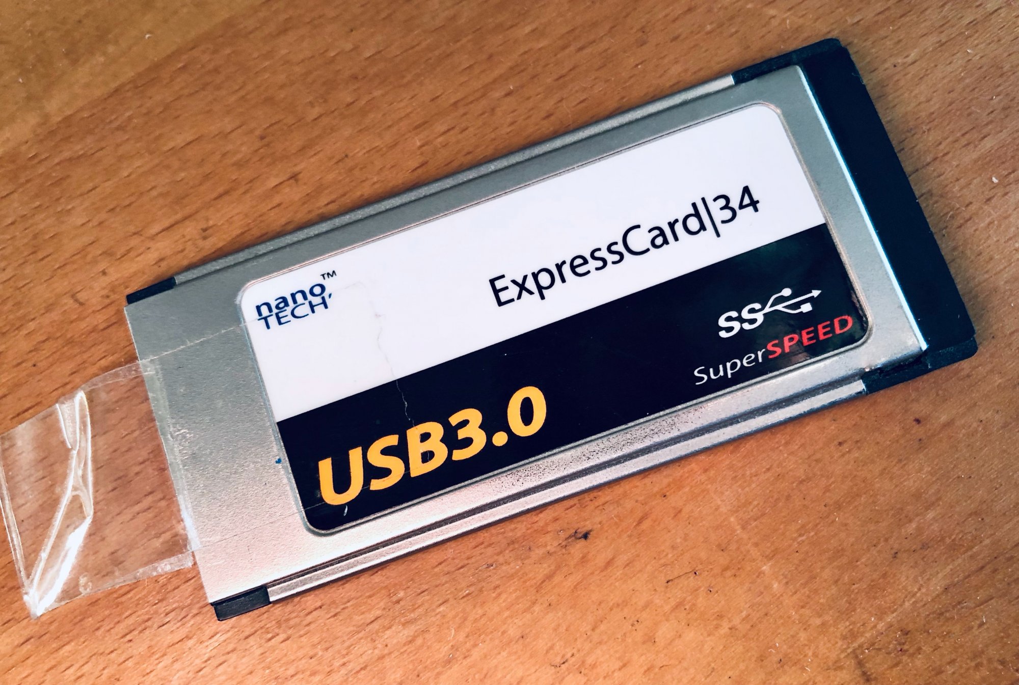

Strange but may be promising - which express card do you use?
This one, will have to check the chipset used (I think it was NEC but I have to look it up tomorrow).
edit:
See vendor/product ID screenshot. It is supported out of the box, no further kexts or plist mods required.

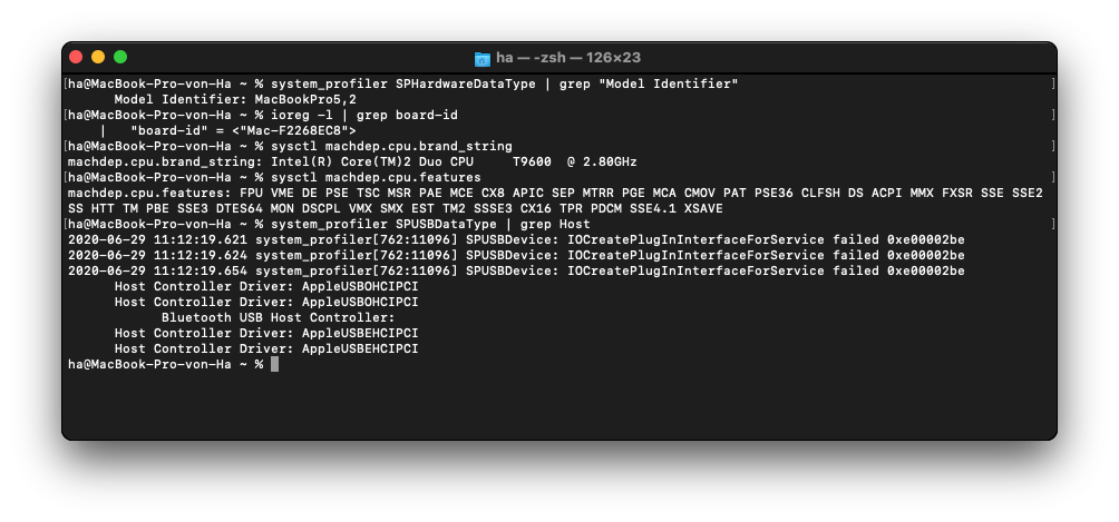

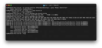

Meanwhile I asked to @Syncretic (because his AAAMouSSE and telemetrap have correctly assigned a kernel cache ID on BigSur and both work with kextstat) to upgrade that "USB Legacy injector" to allow it to prelink to BigSur (SDK and IOKit), but it's not easy to make it work with BootKernelExtensions.kc .
Also to show to others that you succeeded to boot BigSur from a non-APFS mac use these commands from a BigSur terminal:
Code:
system_profiler SPHardwareDataType | grep "Model Identifier"
ioreg -l | grep -i board-id
sysctl machdep.cpu.brand_string
sysctl machdep.cpu.features
system_profiler SPUSBDataType | grep Host
Sorry for replying late - the hardware info is in the attached screenshot.
Yes, I think the installed BS SSD would work on USB. For now I think I leave it as internal disk, to be able to repeat an installation.
Thank you for already contacting parrotgeek1 and Syncretic. In the longer BS run those upgrades/adaptations would be great.
I'll now work on the WIFI fix. Neither this nor Ethernet cable are working at the moment.
(MBP5,2 17" mid 2009, 2.8GHz Penryn T9600, Nvidia 9600M GT, 8GB, APFS ROM patch applied. APFS SSD Samsung 860 EVO for production / 840 for testing, with Catalina 10.15.5.02 / Big Sur 10.16.0 DB1, resp.)

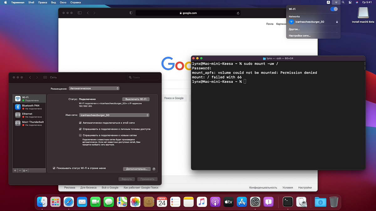

I've installed Big Sur fine on my macbook pro 2012 non retina... Now i'm trying to follow these instructions
when i type the sudo mount -uw / killall thing, i get :
"mount_apfs volume could not be mounted : permission denied
mount failed with 66"
I can't copy the wifi kext file to my macbooks extension folder ...
any help ?
Still looking for help... thanks

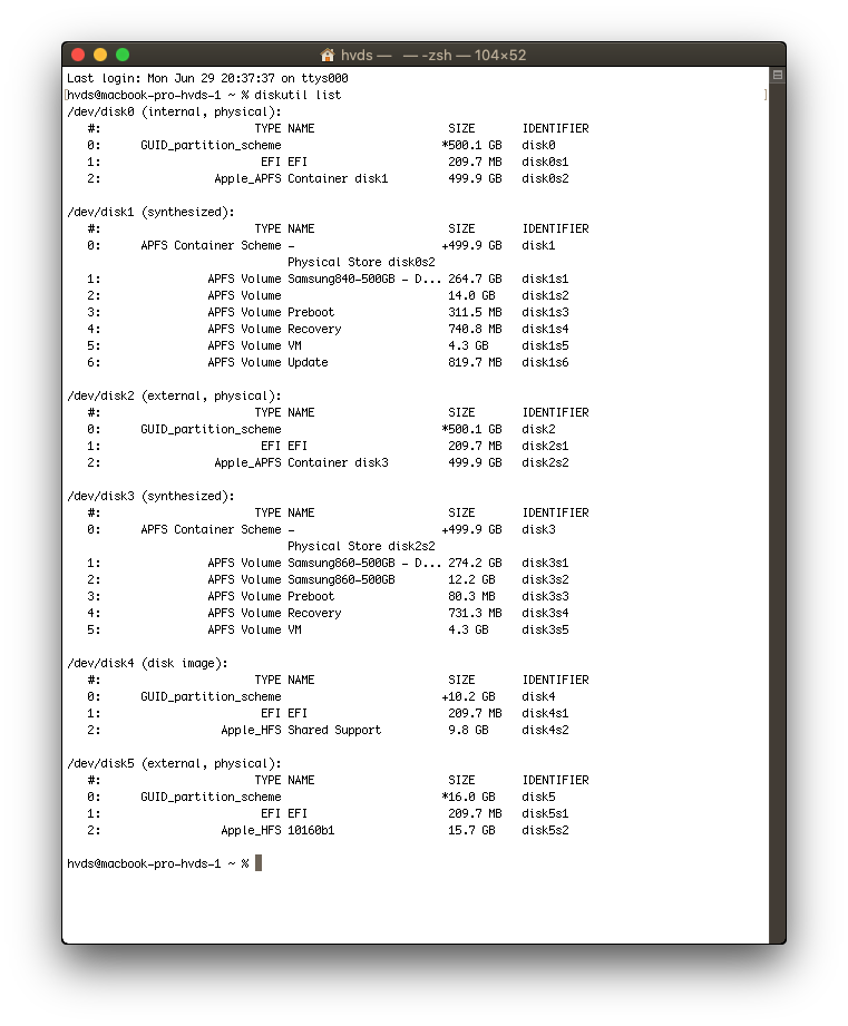

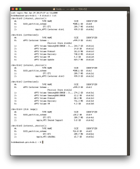

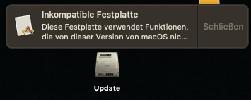

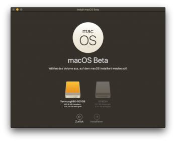

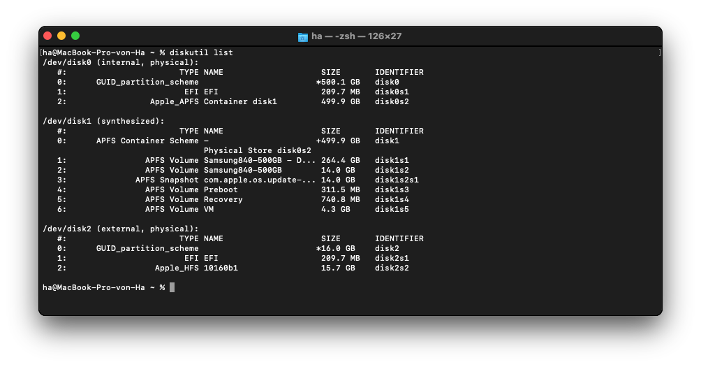

I tried it on my present setup (10.15.5.02 on USB, 10.16.0 DB1 internal on SATA (the Samsung840)). It seems the Big Sur disk isn't seen by the Installer after starting it via Hax3.
Maybe due to Catalina not recognising properly the Big Sur disk structure (white terminal window), which seems intact as BS is working, and from inside BS it looks fine (black one).
But that doesn't matter. I think I'll soon clone Catalina to the Samsung840, and repeat installation. Then the Installer will see it. But for now I'll continue playing with the existing BS installation...

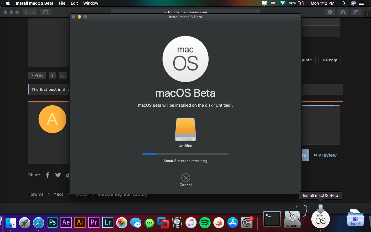

If you've read all the pages (yes I do mean all 47) - as you should have done!!! the question has been answered several times - Just wait! it can take a long, long time - well over an hour!

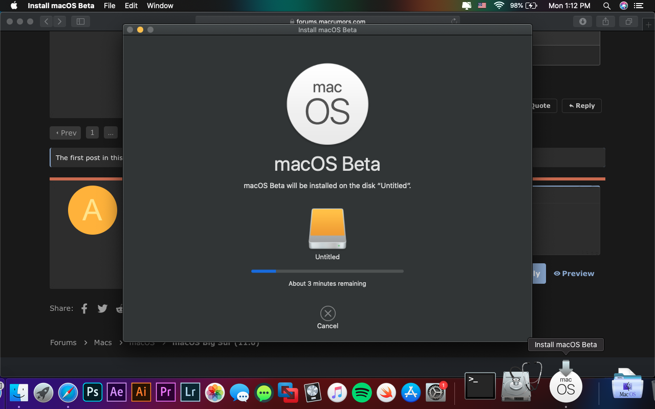

Yeah mate currently waiting for the install to finish, it’s on an external drive so I don’t care that much now

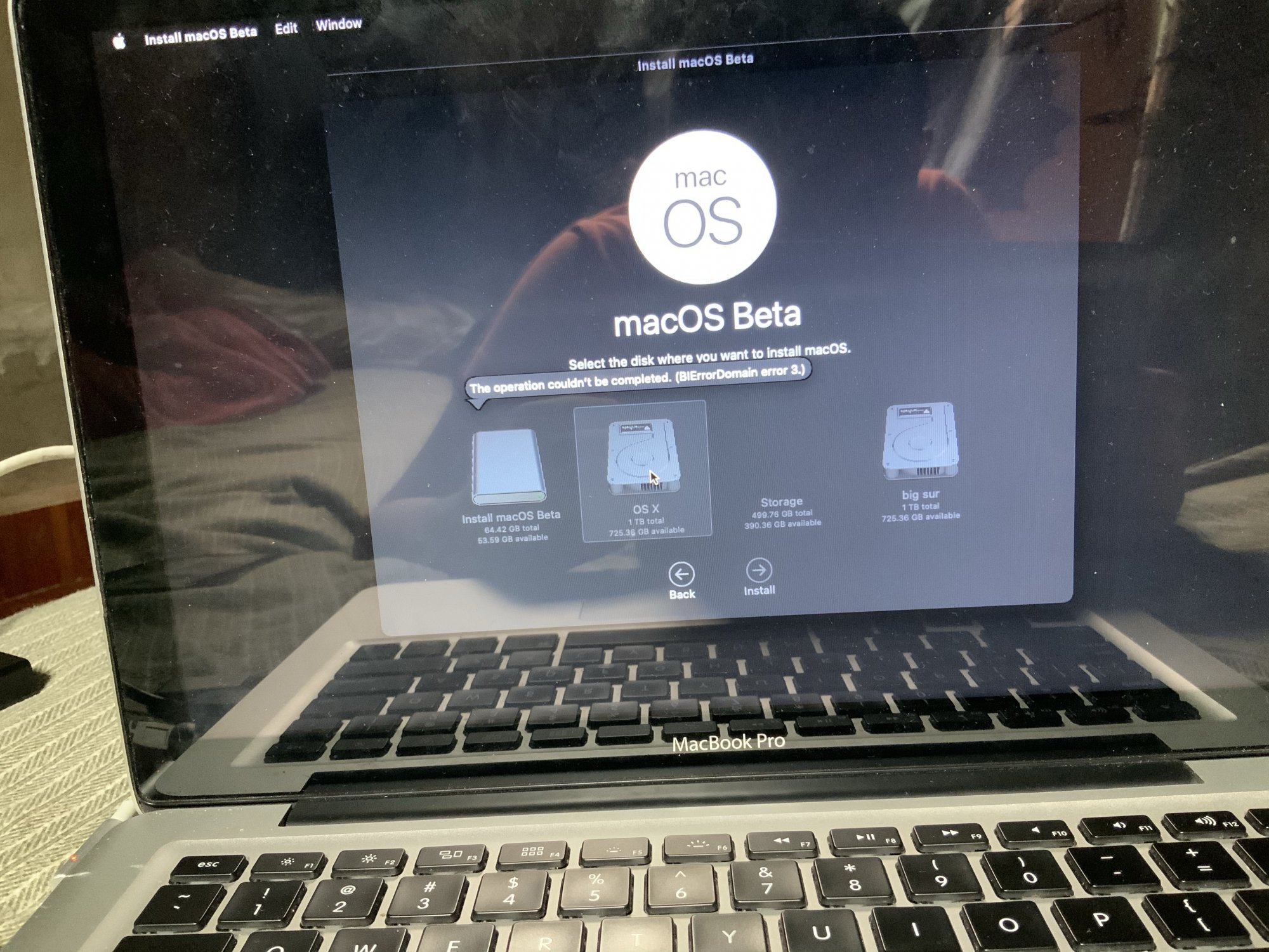

Here is my question is it possible to install Big Sur to external SSD on iMac 9,1(an Unsupported Catalina installed)?
Cause I create a normal USB installer with createinstall method and try to boot with Opt key and I got Probihited Sign never reach the installer screen.
@jackluke I also tried with your USBOpenCoreAPFSloader to reach Big Sur installer screen but I always getting Probihited Sign.
I tried to start installer inside Catalina this time I got this machine not have APFS Fireware error try to HFS+ I tried HFS+ and this time got BIError Domain error 3.
So is it possible how?
Note: I don't want to make a boot in this machine I just want to install to the external drive and when I reach the language setup screen remove it.
That's weird... the inability to mount a BS disk on Cat comes from the volume sealing feature, which my installer hack is supposed to disable.
