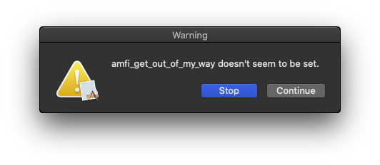

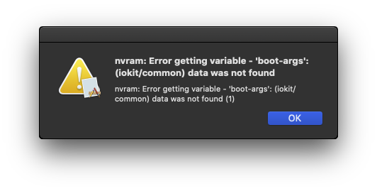

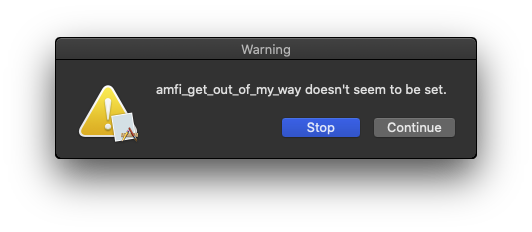

When I start this I am getting this?

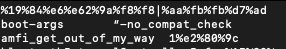

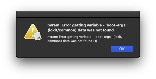

Edit: I added those boot args but know I am getting this warning;
Should I continue?
Should I continue?
You have a couple issues -- looks like a weird quote got into your boot args, and the AMFI flag is supposed to be part of that, not its own key. Copy this command exactly and it should be resolved.
sudo nvram boot-args='-no_compat_check amfi_get_out_of_my_way=1'

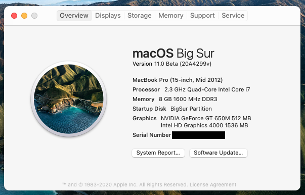

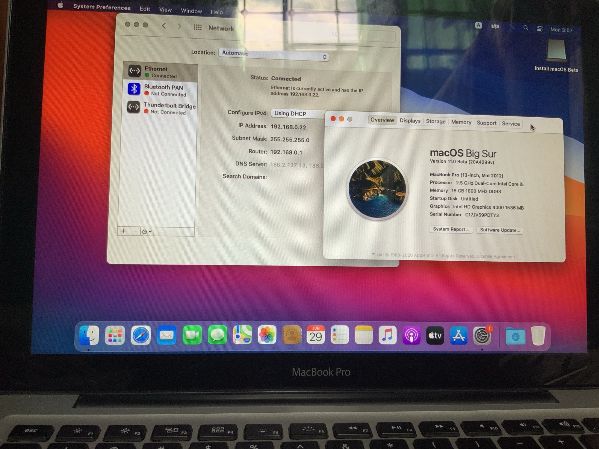

After a few tries I finally got Big Sur installed on a second partition on my MBP! Still figuring out WiFi, that looks fairly complicated. But hey, I'm one step closer to using it as my main OS once it's fully released.

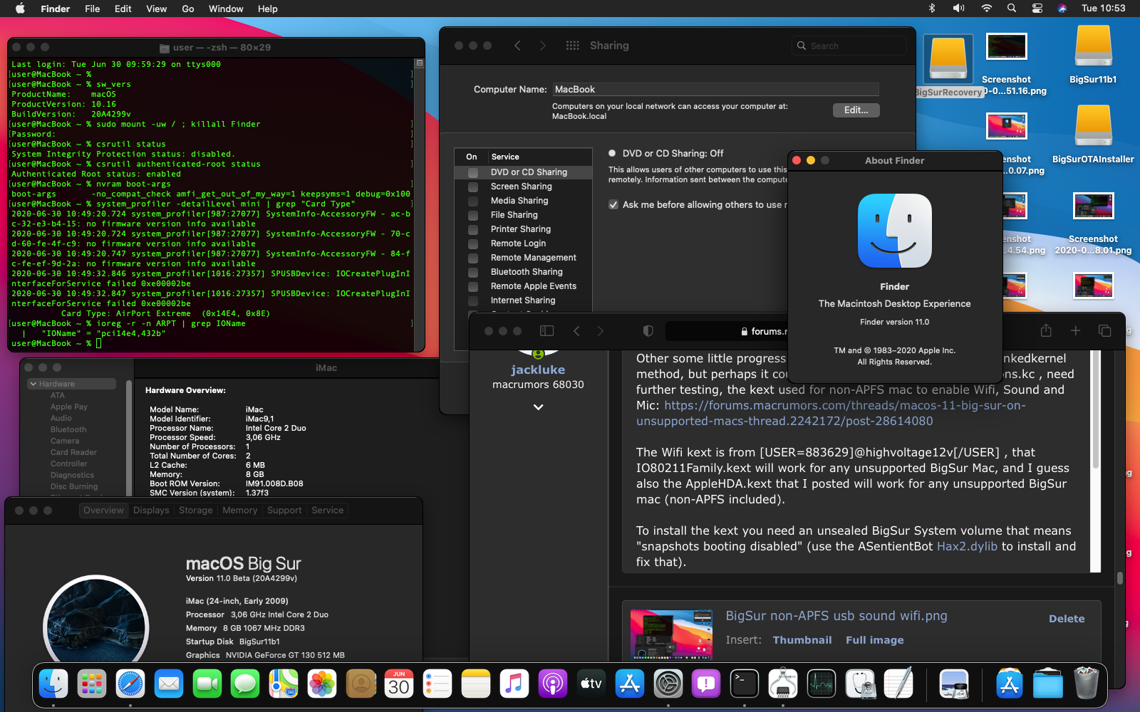

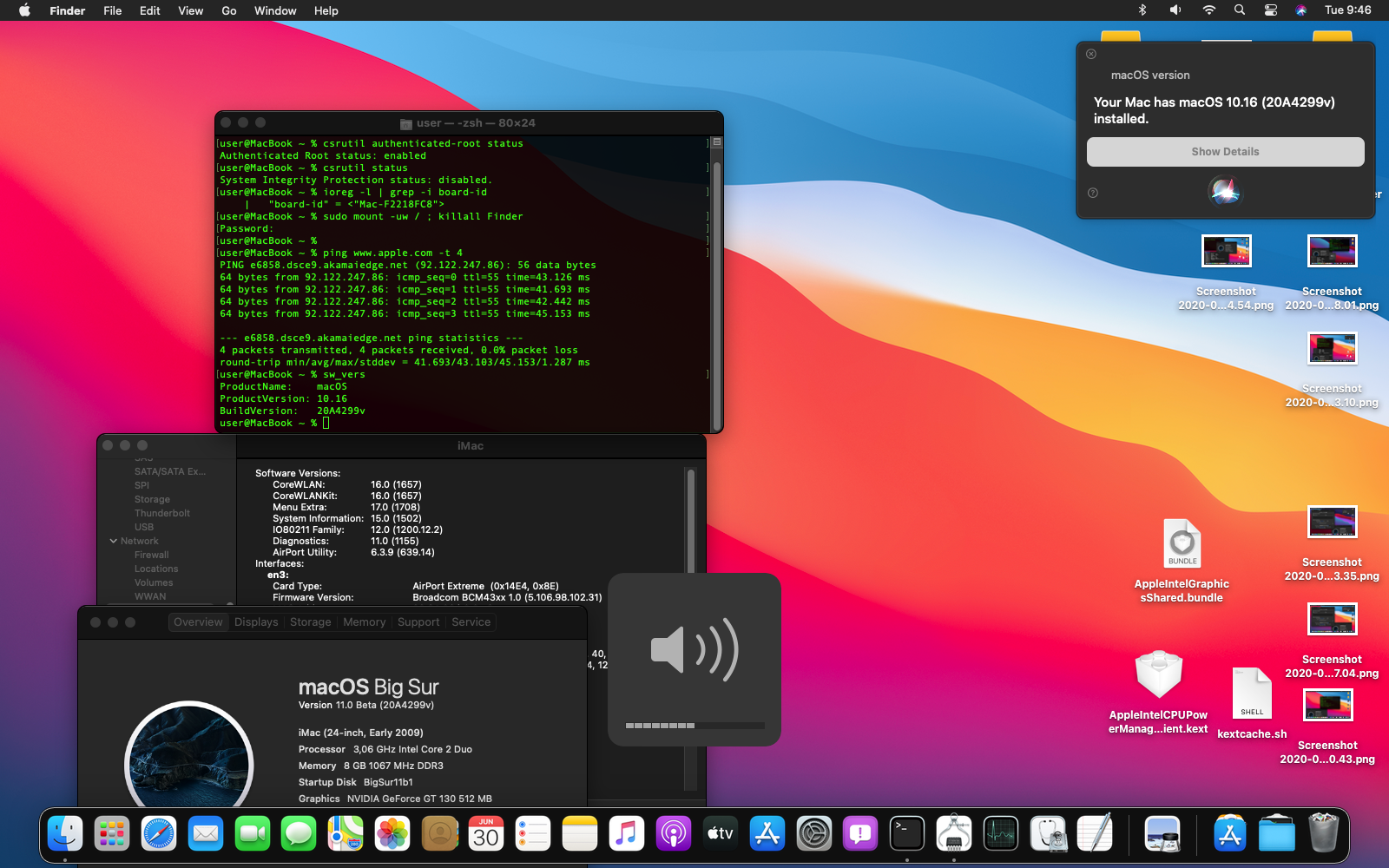

Other some little progress on non-APFS Mac, still using my prelinkedkernel method, but perhaps it could work also with BootKernelExtensions.kc , need further testing, the kext used for non-APFS mac to enable Wifi, Sound and Mic: https://forums.macrumors.com/thread...unsupported-macs-thread.2242172/post-28614080
The Wifi kext is from @highvoltage12v , that IO80211Family.kext will work for any unsupported BigSur Mac, and I guess also the AppleHDA.kext that I posted will work for any unsupported BigSur mac (non-APFS included).
To install the kext you need an unsealed BigSur System volume that means "snapshots booting disabled" (use the ASentientBot Hax2.dylib to install and fix that).
edit:
the Sharing local domain name is "MacBook", because I am using the same external USB BigSur installation.
Still trying to figure out how to boot an USB BigSurInstaller (createinstallmedia) from a non-APFS mac (LegacyUSBInjector.kext and BootKernelExtensions.kc), the prelinkedkernel method for an USB BigSur Installer doesn't work, I guess because the BaseSystem.dmg is an APFS Installer with its own Preboot volume, for this reason I guess it's very difficult to make an "USB BigSur Patcher" (unless someone can import kmutil and the new csrutil on USB Catalina Patcher).

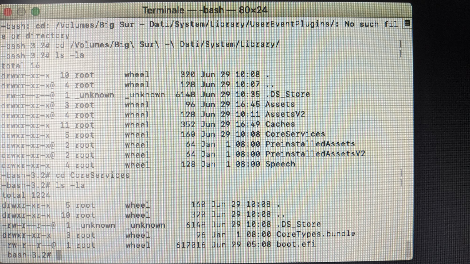

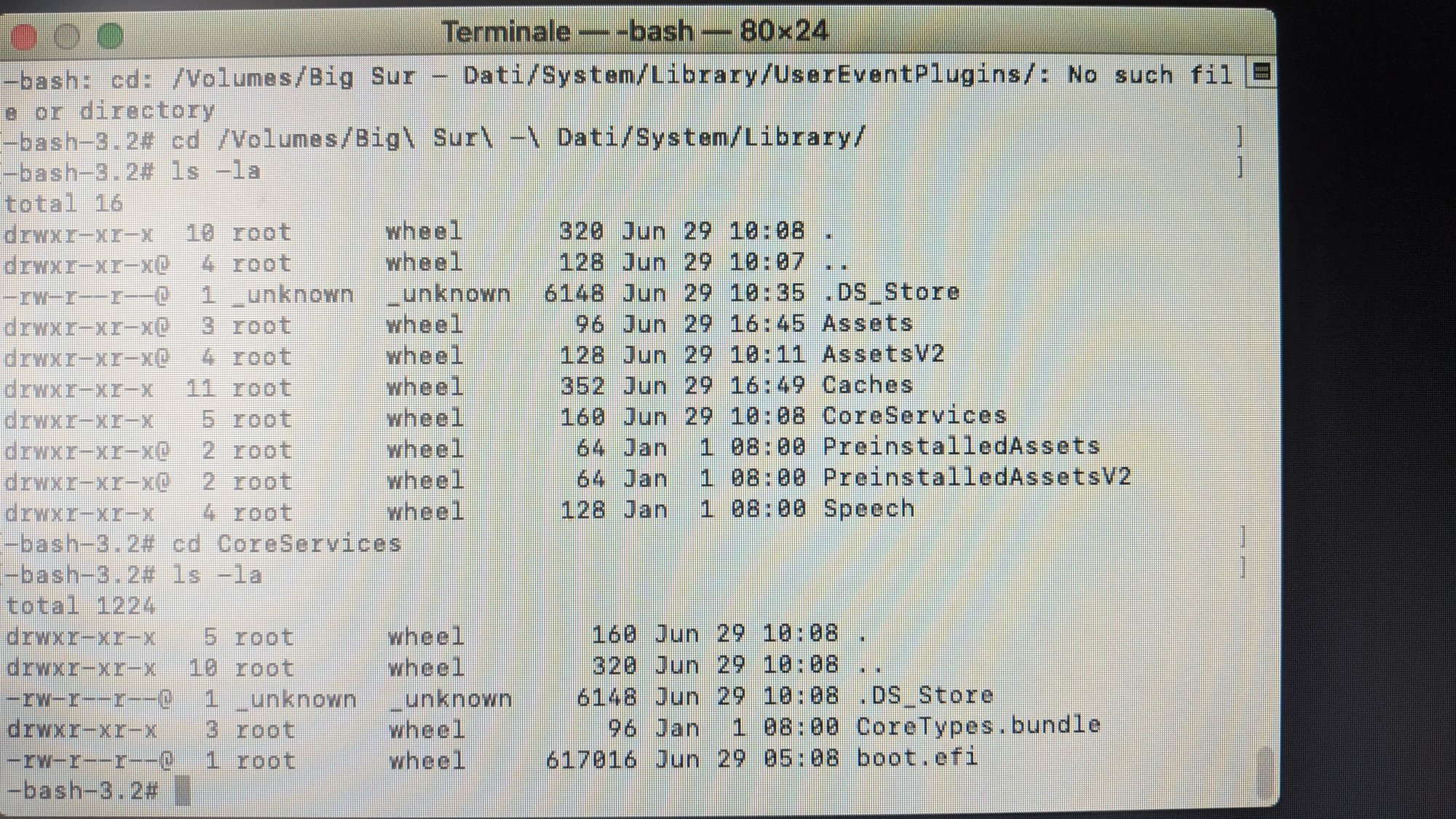

Thank you, but I cannot access the BS Recovery with Command + R. It crashes after screen becoming white from black.
But I'm avalable for all alpha/beta testing that you and @dosdude1 need for macOS Big Sur Patcher on Core 2 Duo Penryn
Using Cat Recovery, I don't have /UserEventPlugins/ folder in "Big Sur - Dati" volume... 🤔
You should re-install from Catalina your BigSur using this: Hax2.dylib
then you can remove telemetry from BigSur single user mode.
Otherwise you can make from Catalina this: USBOpenCoreAPFSloader3.app.zip
If you use an external USB that contains an Installer or MacOS installation use "Near an USB device without erasing"
If you use an external empty USB drive without any multi-partition scheme example a 16 USB drive then use the second option, don't use second option on a multi-partition USB disk.
After reboot, hold alt-option key select usbopencore (with its icon) and pick your "Big Sug - Data" label to boot BigSur on unsupported mac.
