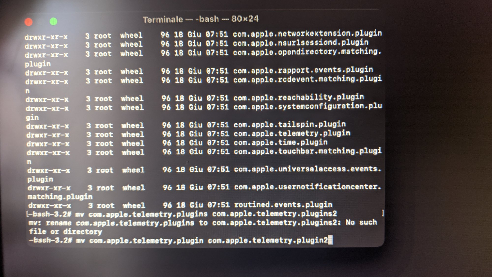

@jackluke Reinstalled BS using hax2, stoll no BS Recovery. REMOVED (renamed) telemetry with Olarila BS Recovery, BS still crashes on boot the sane way!!! I suspect that could be the graphic card Nvidia 320M 🤔 Now I try your patch 😊

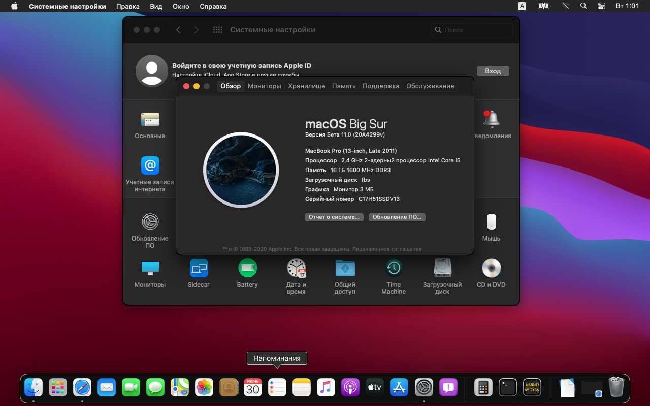

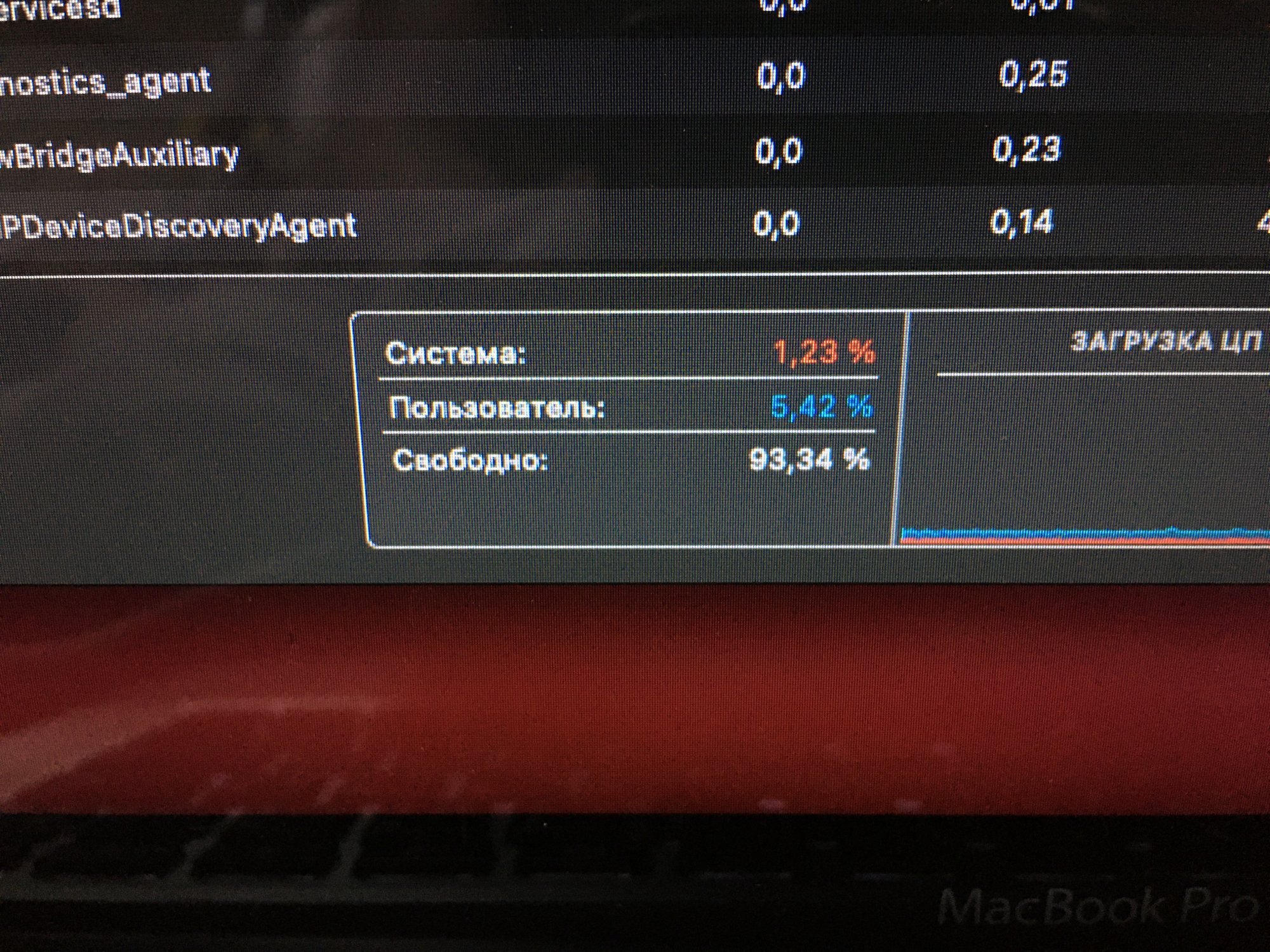

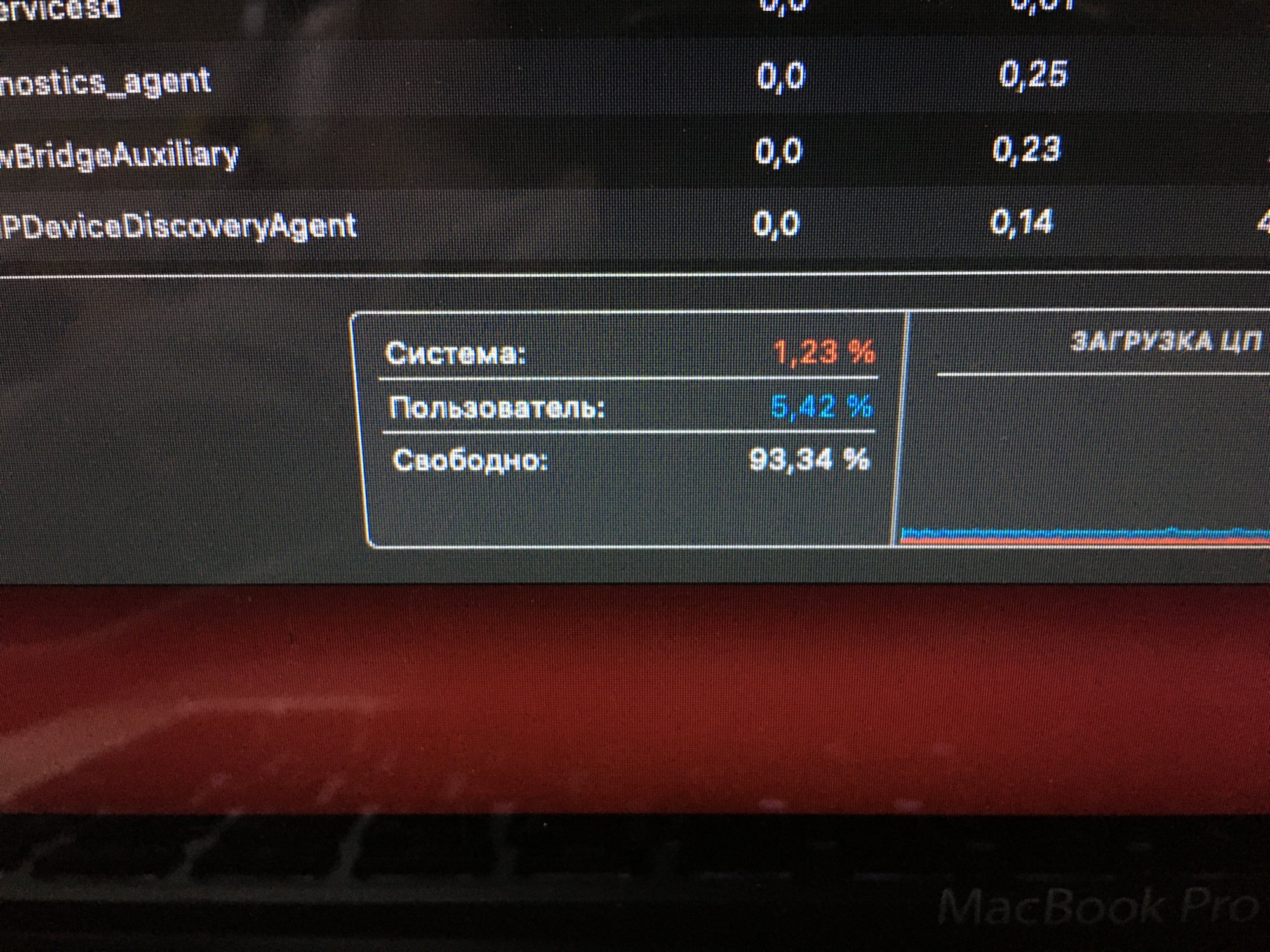

Experience of installing Big Sur on MBP 13 Late 2011 / macbookpro 8,1
I try install 3-4 times. First problem - domain error, second - abort installation with message «installation of macOS could not continue».
Solution which help in my case:
0. Make bootable usb flash drive with Catalina installer (use dosdude1 patch for creating the flash)
1. Create separate Partition (not just Volume). [Install Catalina firstly, if you haven’t yet]
2. Downloading installer of Big Sur [ http://swcdn.apple.com/content/down...kxzj3zjshu1srsh4n74a41n4/InstallAssistant.pkg ] Download, run it.
3. Downloading hax.dylib [ https://forums.macrumors.com/attachments/really-simple-installer-hack-zip.926156/ ] Copy hax.dylib to home folder (I also copy it in the folder above and in the folder beyond ‘home’)
4. Boot into recovery mode (Cmd+R after reboot; another way - boot from bootable usb with installer, for example, Catalina, then choose terminal). Run terminal, run ‘csrutil disable’. Then reboot.
5. Automated way for disabling library validation, compatibility check etc.: download scripts from https://github.com/4ndv/big-sur-plz and run it.
6. Run the Big Sur installer (after step 2 it is in Application folder)
Notification!
Some steps have alternatives. All steps write down exactly as I apply it. Check it, try and correct.
Thanks to Andrey Viktorov for manual on medium ‘How to install Big Sur to Mac Mini Late 2012 and other Catalina-capable machines’,
Thanks to GameRoof for manual on MacRumors ( https://forums.macrumors.com/thread...unsupported-macs-thread.2242172/post-28593727 )
Thanks to ASentientBot for ‘really simple installer hack’ and especially hax.dylib ( https://forums.macrumors.com/thread...unsupported-macs-thread.2242172/post-28589245 )
Thanks to 4ndv (aka Andrey Viktorov?) for automated script for disabling ( https://github.com/4ndv/big-sur-plz )
Thanks to johncaling40 for answer in PM on discord and brief step-by-step guide based on his expirience of installing BS on MBP 13 2011
And all community MacRumors and all, who name I don’t called.
Sorry for my English - it is not my native languge; I hope in general message is understandable =)
Good luck you. Thanks for attention.
P.S.
Some remarks on Big Sur using.
Model - MBP 13 late 2011 macbookpro 8,1
Troubles
system randomly log out
iCloud working (still)
Memoji in message - don’t work
Internal wifi don’t work
Accel don’t work
Sound don’t work, volume don’t work
Display’s Brightness don’t work
Icons in top menu bar are invisible if light mode (in dark mode all is visible)
Keyboard’s Backlit and brightness working
Safari - faster (IMHO)
System using fewer resources (IMHO)
